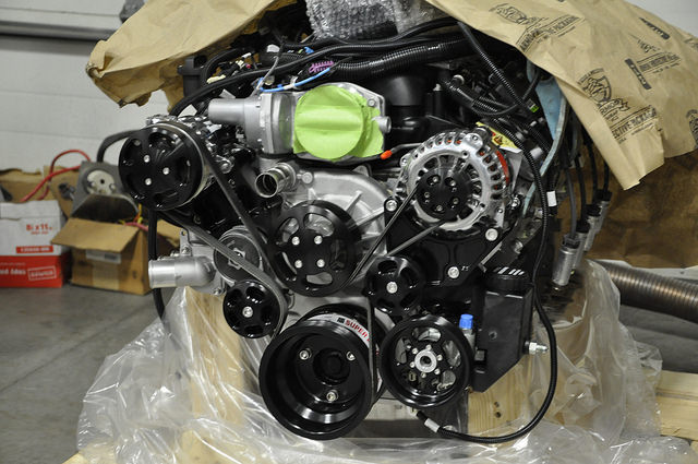

      Lol I agree with too much cleaning.
      We like the Wegner drives too, they're very high quality & we've tested to 1400hp with no problems. They're only $2395 black anodized, shipped.
      SchwartzPerformance
      Oct 2010
      Mena, AR
      287
      That's a nice clean routing of belts. I will look into that also and check on what my options will be. Still such a long way to go. Building it paper before hand helps. Have you had any experience with the ISIS wiring kits and LS platforms. I am assuming after looking over the ISIS wiring it should be straight forward with the ECM to controller connections.

      Quote Originally Posted by Schwartz Performance View Post
      That is a very good looking front drive. Def. One of my favorites!
      Quote Originally Posted by bmbrzmn101 View Post
      The ISIS works just fine with LS swaps. One of my shop customers uses ISIS on everything he does, and he swears by it. We even put some of the connectors for the ISIS on the harnesses we built for him.
