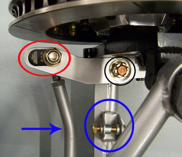

      Ron, just curious on this. What is the reason for bending the steering link? Isn't it still a straight line from the attach point on the rack to the attach point on the spindle? It shouldn't matter if it was "s" shaped, if the the ends were still at the same attaching points?
      Just for inner wheel clearance when the wheel is turned hard ... over 20°. This is from a long arm, zero scrub Track-Star suspension (see photos) ... so the hubs & control arms go deep into the wheel.
      Yup!
      You're correct. The curved tie rod tube is just for inner wheel clearance down at the lower part of the wheel.

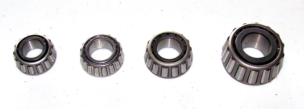

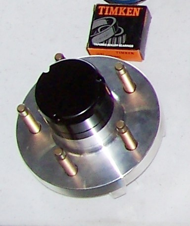

      I attached a photo below of the Track-Star bearings along with common bearings.
      That small bearing on the right is a standard outer bearing for 60's & early 70's GM muscle cars ... A-body, F-Body & X Body ... rated at 917# thrust load. The second one from the left is a Pinto/Mustang II outer hub bearing rated at 922# thrust load. The 3rd one from the left is a outer hub bearing for GM B-Body/impala/C10 truck hubs, rated at 1130# thrust load. The large outer bearing on the far right is what I use in my Track-Star hubs. It is rated at 1800# thrust load ... and is the same bearing used in Grand National Hubs (like Deebert is going to use) on a lot of NASCAR race cars for short & intermediate sized tracks, as a well as GT1 Road Race cars, Trans Am, etc.
      For that big bearing to fit in the snout of the hub, the snout needs to be 3.06" ... same as an Impala/C10 truck, same as Grand National hubs & same as Speedway Floater hubs. This snout is called the centric. The centric on most passenger car hubs is smaller. If the wheels you have were made to fit snug on the centric ... some are & some are not ... then they will be too small. Most GM cars passenger cars have a 2.75" centric ... so many wheels have centric bores of 2.77-2.79". The options are to have a machine shop open up the centric hole (providing there is plenty of material there) by .150" (.300" total).
