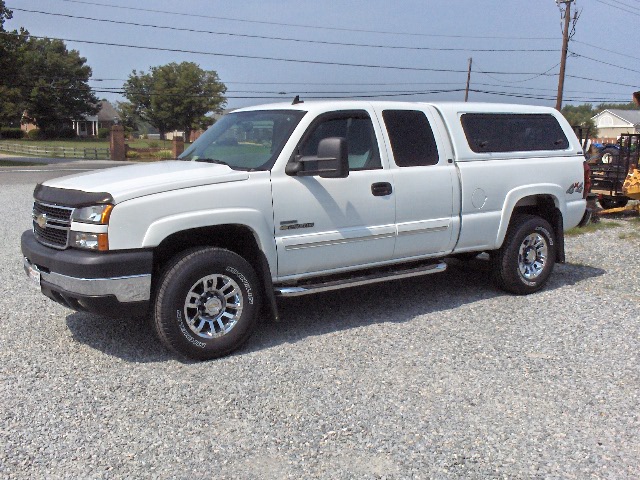

      Here's my truck.

      JD, always making it look easy! I plan to use LEDs on my '69..Will look into digitails
