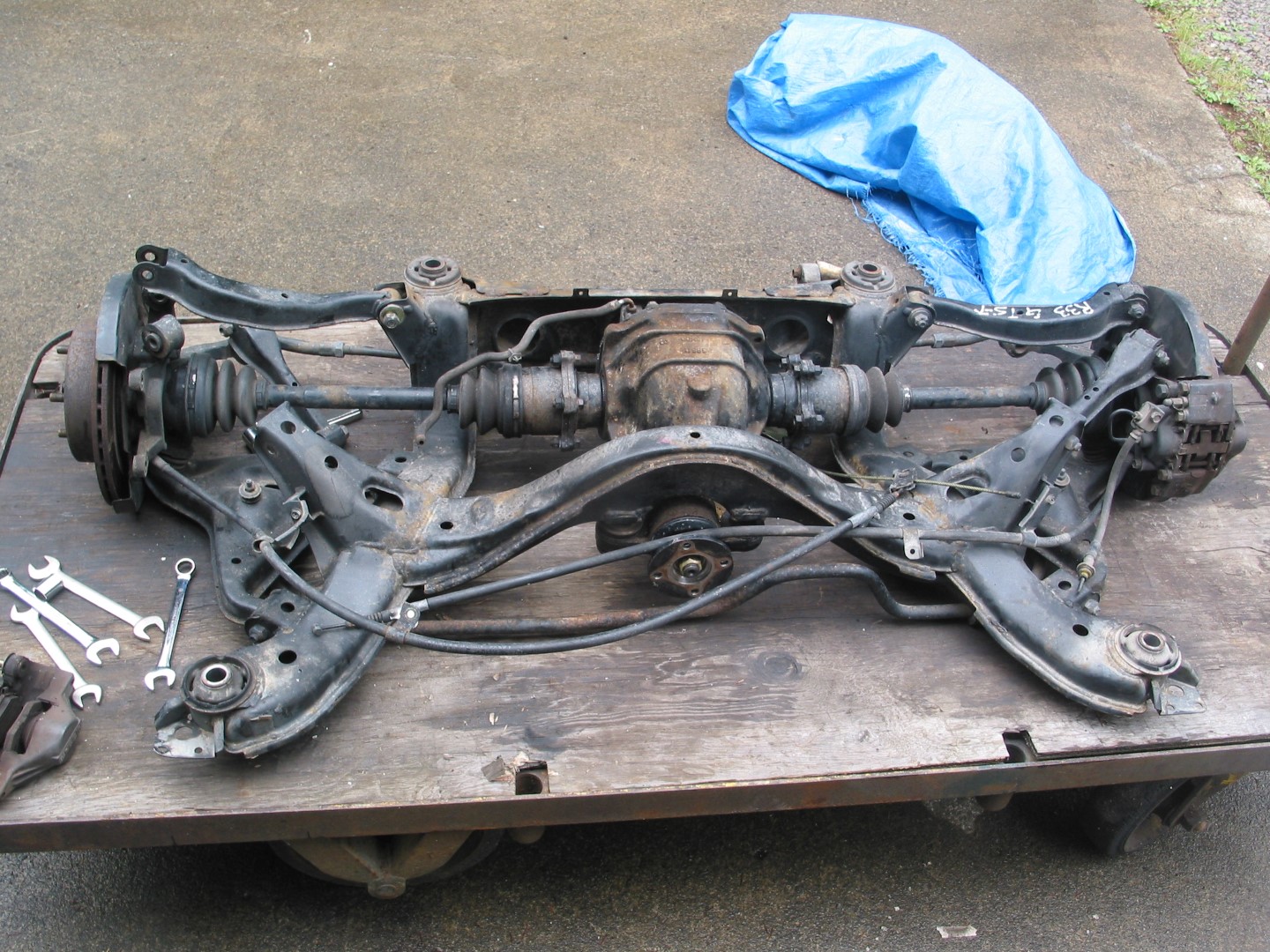

      There are some good choices, certainly including the BMW rear suspension. As I see it, there are two major considerations that would affect your choice-- 1. Ease of installation 2. Ability to handle the torque and horsepower, depending on how you will drive it.
      I personally favor the Nissan rear suspensions because they are built as an assembly, mounted on a cradle that attaches to the frame with four bolts, using rubber shock isolators. I believe some of the Thunderbirds used a similar arrangement. I used a Skyline unit in my 48 Studebaker, which is described elsewhere on this forum here
      https://www.pro-touring.com/threads/...-coupe-project
      The Infiniti J30 rear suspension is now becoming readily available in the salvage yards, as is the Q45. The JDM tuners guys say these are good for at least 400 hp, but I realize you may be going for more than that. The J30 unit is a 3.9 viscous LSD, and I think the Q45 is about 3.5, also 2 or 3 inches wider. We are just finishing the installation of a J30 rear suspension into a 68 Mustang we are upgrading. We paid $250 for the whole thing, LSD, brakes, and all.
      Some of the Toyota units are also cradle mounted, but there is a lot more variation between models. The Supra differentials can handle a lot more power than the stock Nissan units - those are the differential of choice for the JDM drag racers. Of course you probably won't find one for a cheap price.
      Some of the other choices will require locating pivot points on the chassis, which may be more difficult. I have no idea what kind of power the BMW diff will handle, but some of the V8 models should be pretty stout.
      Name:  Skyline R33 Rear suspension.JPG
Size:  469.2 KBName:  J30 rear suspension.JPG
Size:  204.2 KBName:  Q45 rear susp.JPG

      [QUOTE=Stilettoman;1099147]There are some good choices, certainly including the BMW rear suspension. As I see it, there are two major considerations that would affect your choice-- 1. Ease of installation 2. Ability to handle the torque and horsepower, depending on how you will drive it.
