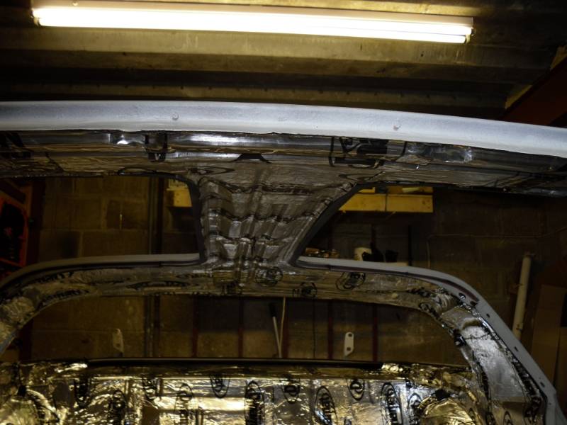

      I have the underside of my roof covered with CLD panels.

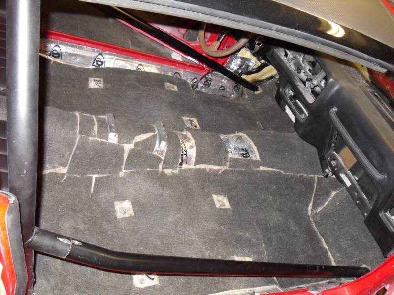

      I dynamatted every where including roof easy to do .
