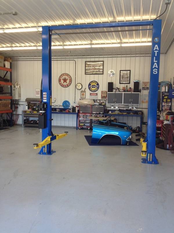

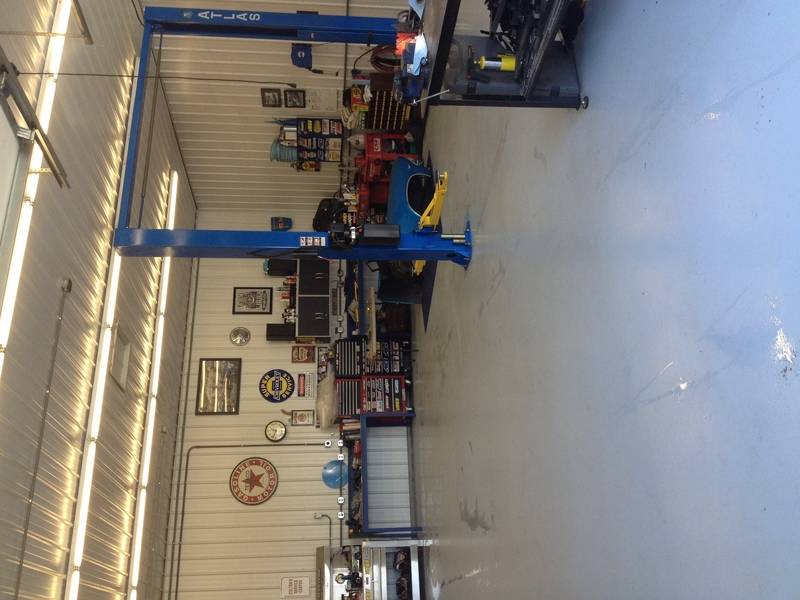

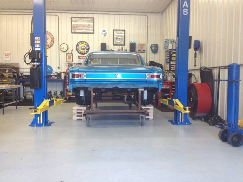

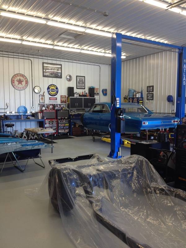

      Today we did a much needed spring cleaning. A long winter and 6 months of welding and grinding took it's toll. We took everything out and gave the walls and floor a good scrubbing. It feels new again
      Now lets get some work done!!
    5. #165
      Nov 2011
      Livermore, CA
      668
      What a great setup to work in.. My new house will have big garages or a barn for real car fun can be had.

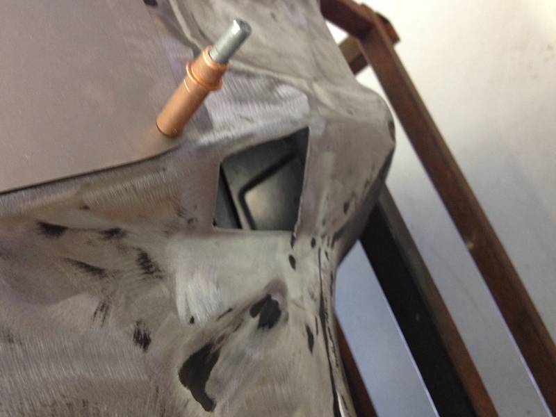

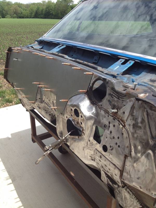

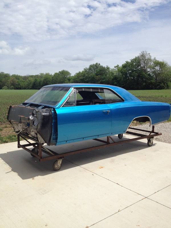

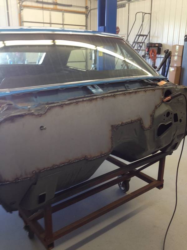

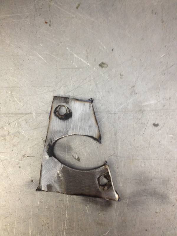

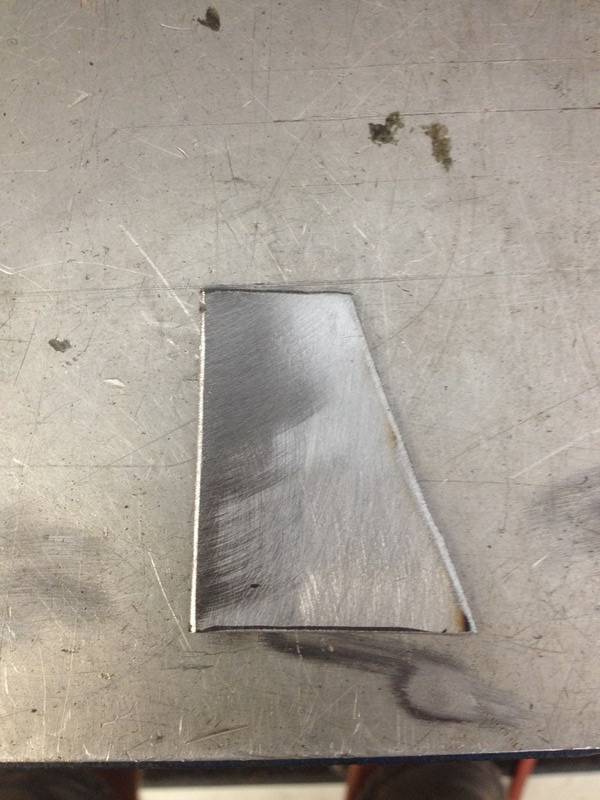

      It was such a beautiful day today so I rolled the body outside and worked on the firewall a little. I cut out the area where the stock throttle bracket is and made a piece to fill that area. I also did a final fit of the smooth panel and clamped it in place. My son drilled the firewall and used cleco's to hold it in place.

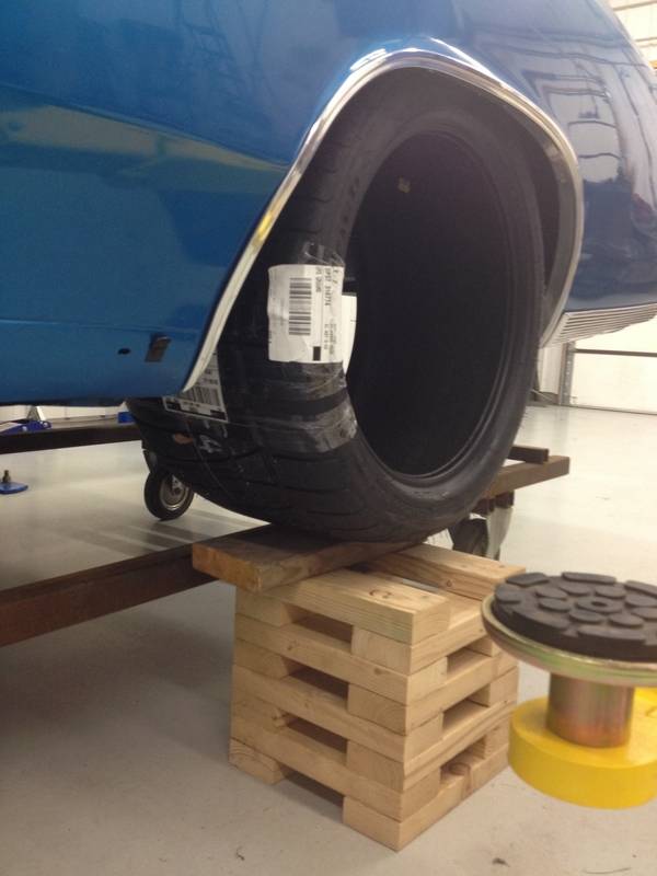

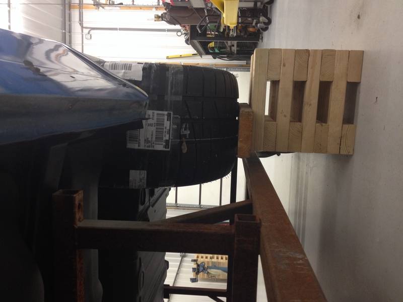

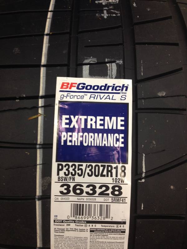

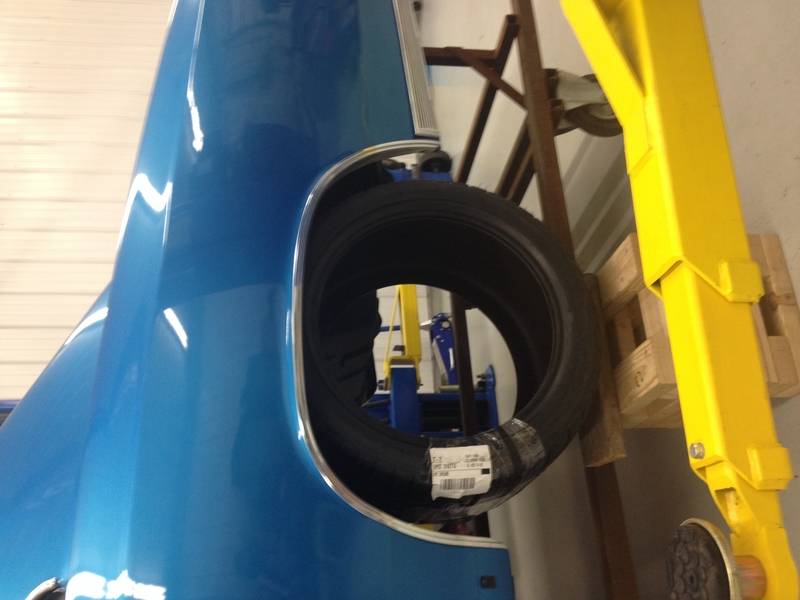

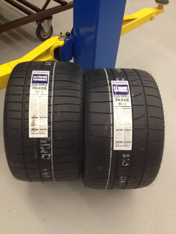

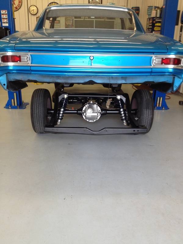

      Guys please be honest with me..Do these tires make my ass look fat?
    9. #169
      5,560
      They look sweet back there!!
    10. #170
      Aug 2009
      Chandler, Az (from west NE)
      240
      They would look sweeter under my Malibu, lol!

      They look great, but 18's eh.. guess R-comps are cheaper on 18's then 19 or 20's

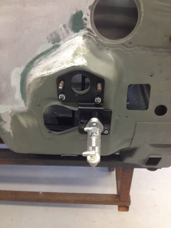

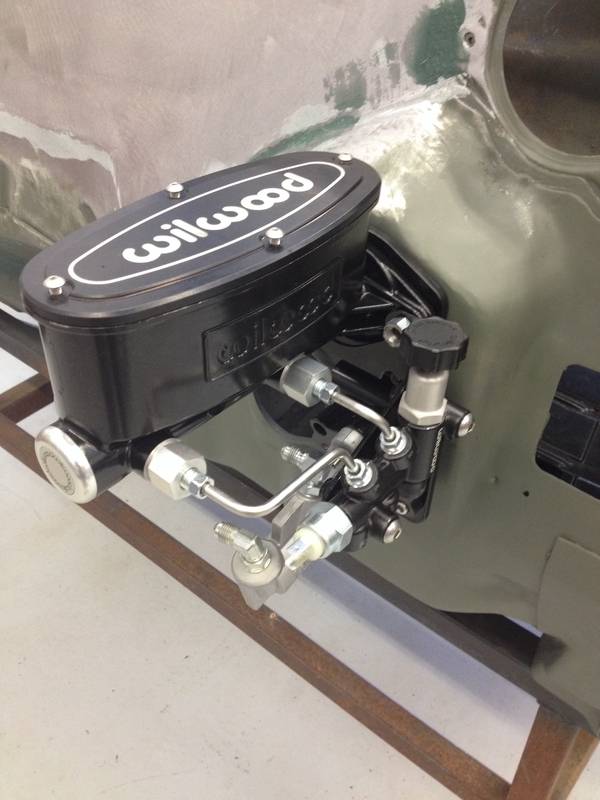

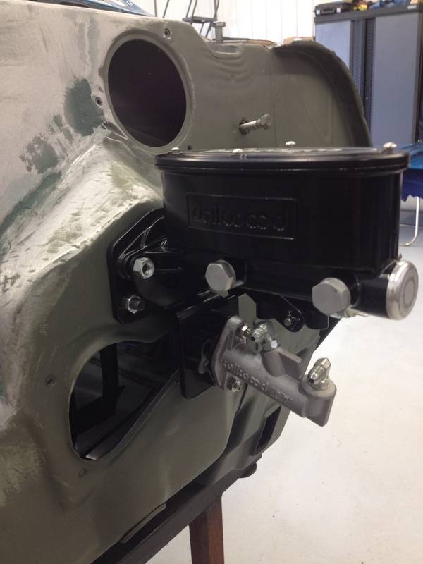

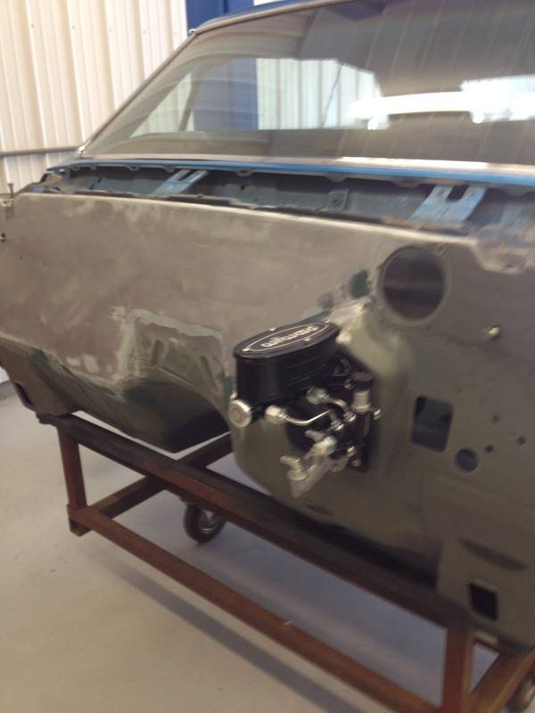

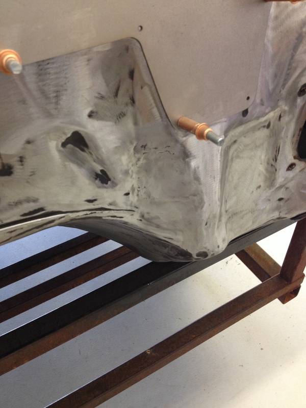

      The weather was great today and I got to spend the entire day in the shop. I feel like I have been lagging behind recently so I told myself the firewall was getting done today. It still needs body worked but its all welded up. I also mocked up my master cylinder, Proportional valve and clutch master to get an idea of how busy it's going to be. I ordered a Ring Brothers clutch resevoir but i didn't take a picture yet. It's pretty slick though!
      The firewall and the back of the smooth panel were both sprayed in etch primer. I used a rolock and cleaned the edges down to bare metal where I would be welding. I also plug welded a few spots from the inside using the old firewall pad holes so those areas were taken down to bare metal as well. I used weld through primer on the edges that were taken down to metal. Hopefully this will keep future corrosion at bay.
      I slowly stitch welded the perimeter to keep heat and distortion down. This took me all morning. After mocking up the brake and clutch masters I realize I need to come up with a nice looking plate to cover the exposed areas on steering column hole. Here are a few pictures.

      Mike,
      Nice work. If you are doing all that work on the firewall, why not fill in the steering column hole, then use a billet lower mount?
    14. #174
      Sep 2014
      Rochester, IL
      143
      Mike,
      That's not a bad idea. I'm going to do some searches and see if I can find some other options and steal their idea

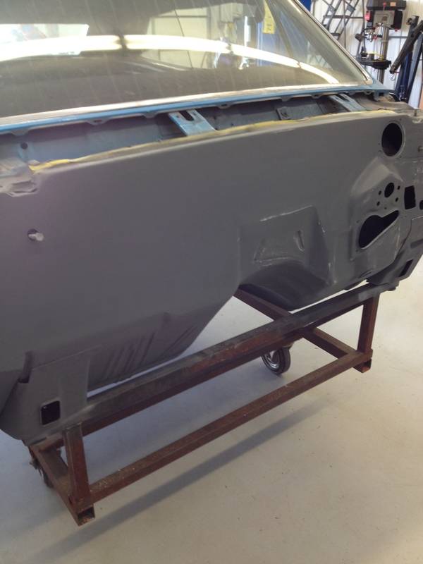

      Working with limited talent and even less smarts, I am actually very proud of how the firewall turned out. I did my final round of blocking today and it's ready for color. It went from this:
      to this:

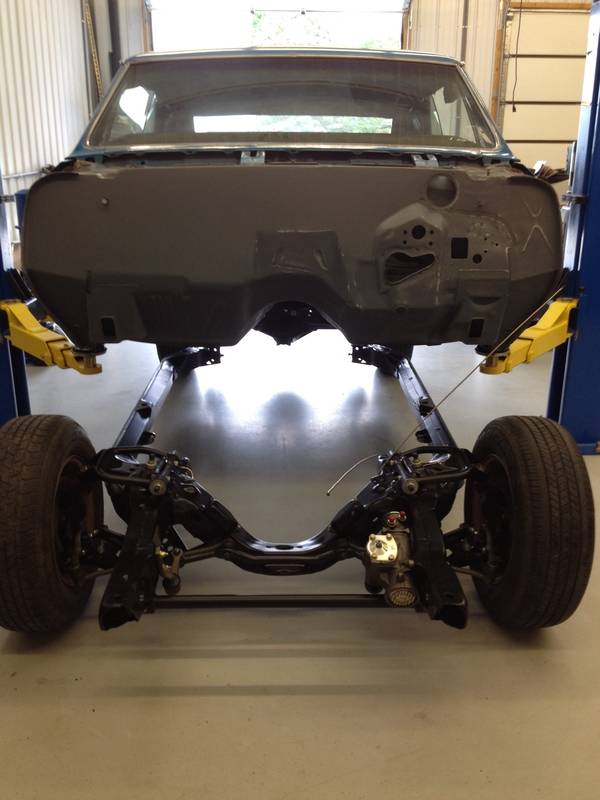

      I put the body temporarily back on so I can finish the brake lines up to the proportional valve and figure out what I want to do for a fuel line.

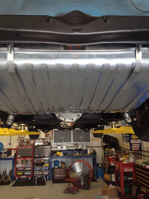

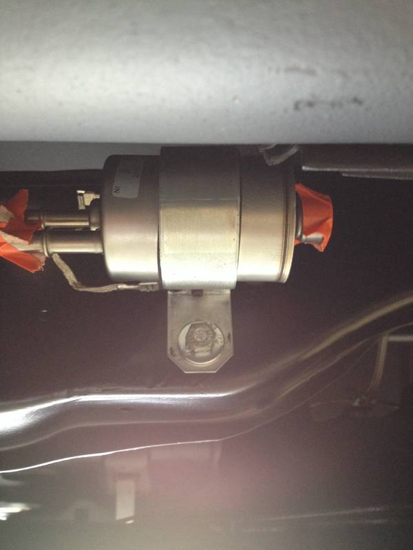

      I mocked up my new Tanks Inc tank. It came powder coated, stealth 340 Aeromotive pump, 0-90ohm fuel sender and stainless tank straps. Very nice deal for the money. I really wanted a Ricks vapor works tank but I couldn't pass this up when it went on sale.
      My goal over the next few weeks has been to put the body back on for good. The only thing holding me back is running fuel lines ,the battery cable for the trunk mounted battery, roll over vent and a vent for the rear end. I put the body on again today and mounted the tank so I can map out where I want to run everything. Once I get it laid out I will lift the body off again so I have room to drill and tap all my holes for the line clamps. I really hope to have the body on for good by next weekend.

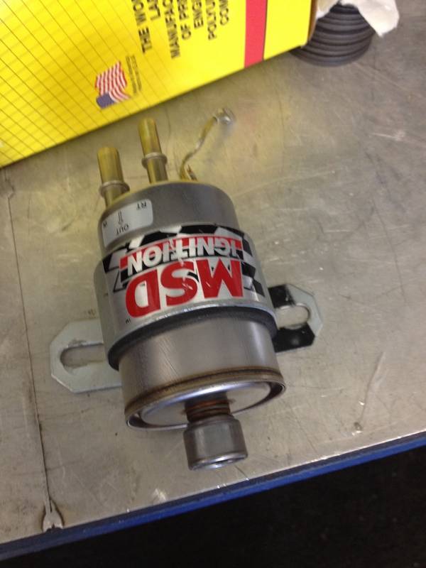

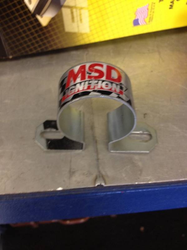

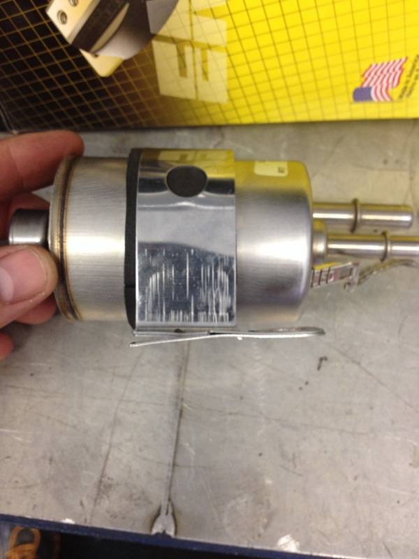

      My plan for now is to run a corvette filter/regulator so I also found a nice spot on the rear cross member and mounted it there. The filter comes with a very thin mount that I wasn't comfortable with. It had a lot of movement and I fear it will eventually work harden and crack. Here is the original bracket.
      I had an old MSD coil bracket on the shelf and I think it will be much more durable and one less thing to worry about. It fit the regulator perfect. All it needs is a few minutes in the blast cabinet and some black paint.

      Great idea on the bracket. Time spent planning this stuff out and trying to prevent future failures will really pay dividends. Thanks for the tips.
