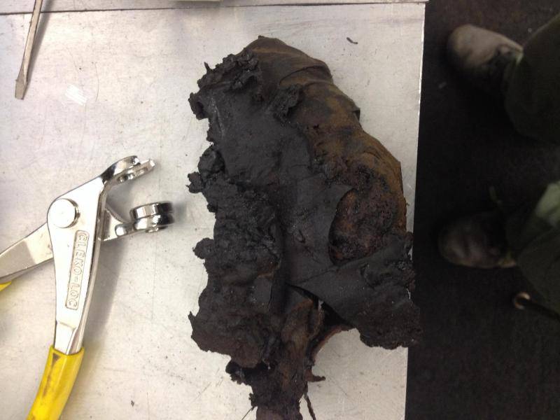

      Not a lot to update yet but I have ordered my suspension pieces. It will be a complete Ride Tech level 2 coil over system with their strong arms and sway bars. Thank you Tom Farrington!! I spent a good part of my Sunday with a heat gun and a scraper removing an 1/8" of undercoating from the floorpans. I was able to get about 25% of it done. This is a nasty job but I am extremely happy with the pristine floor pans underneath.
      Hoping to have the body off next weekend and finish cleaning the floor pans and wheel wells. Then I will start on the mini tub. By the time I get this done, I should have all of my new suspension and steering pieces to do a pre-assembly before blowing it all apart and doing the frame notch (ABC Performance) for the mini tub and boxing the frame.
      Has anyone used a needle scaler to remove the soft undercoating?? I'm going to buy one today and give it a try. The heat gun works good but it's time consuming. Did I mention this is a nasty job
