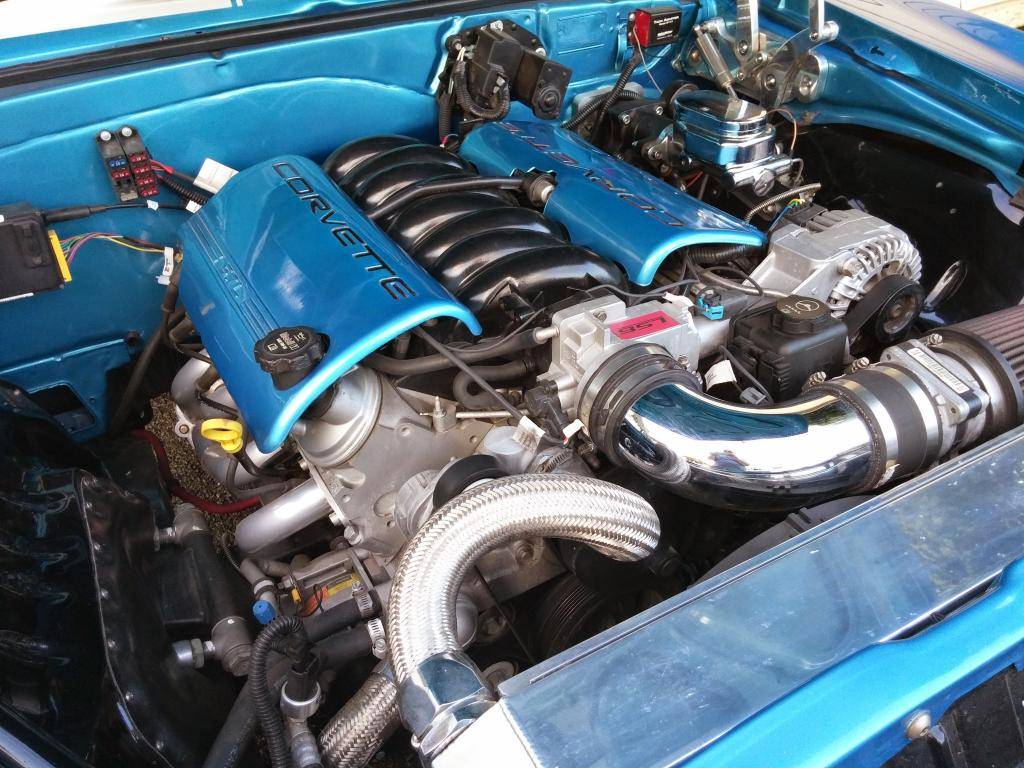

      guys i think i finally figured out how to put pics up. Do you see my car above?
      Jul 2009
      Cypress, TX
      317
      Technology is a beautiful thing. Congrats! Now let's see your stuff.
