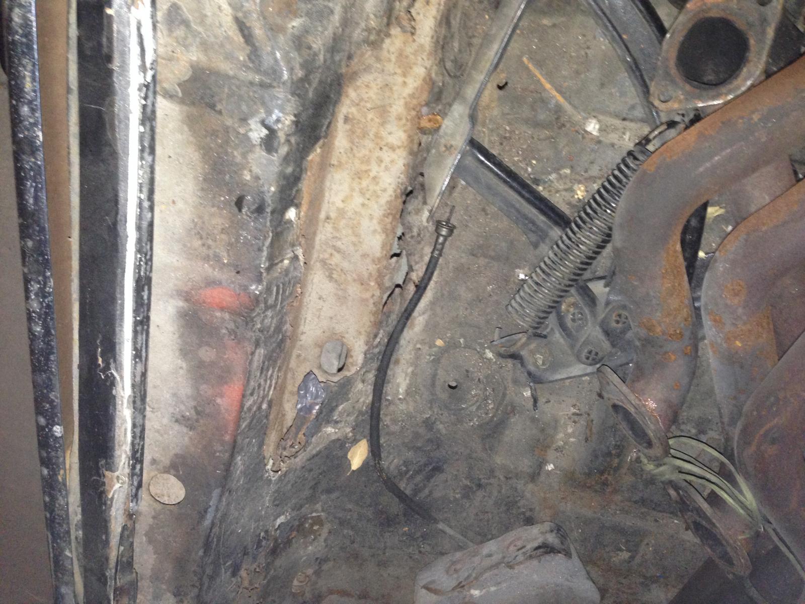

      So it is time to begin work on the Chevelle! I have plans to repair the rust in the trunk, replace body bushings, make sure the frame is square and level, and Lizard Skin everything for stage one.
      Since I have not ever replaced a trunk pan before, I went and got an estimate from a VERY good shop in town. $5000 not including the $600 trunk pan. Ouch. Of course that was sight unseen to replace the entire pan, but most of the pan I think is salvageable.
      It got me to thinking though. Attached is a pic of the bulk of the trunk pan work that is needed. Even on the left side of the pic where it looks like good metal, is actually remnants of a poor fiberglass fix decades ago. My question to everyone is this: Can I neutralize the rust with POR15 or something like that, then lay some appropriate gauge steel over the top of the holes, shape them to fit snugly, weld them in place over the top of the old pan, seal all the seams, and then cover everything with carpet? Seems like that would be a significantly cheaper alternative. 5k for rust repair is a bit steep don't you think? I believe that I could do that type of repair, but to replace the entire trunk pan is beyond my abilities. All of the bracing is in good shape and it's really only the trunk pan that has issues.
      I'm open to any and all suggestions. Thanks in advance.
      And I am heading to the other two good shops in town to see what their thoughts are as well this week. Name:  IMG_0988.jpg

      Well if you can actually migweld or are willing to learn, use a drill and rotabroach you can swap the trunk pan. Just sand along where the braces are, this should show every spot weld, auto center punch and a rotabroach and the spots can be drilled out. When you set the gaps on parts dont set them tight. I like to leave a space loose enough to slide a single edge razor blade in between Then tack it in many places so it doesnt move or warp or buckle. Then weld a little on each side till your done. Practice welding pieces together so the weld is flush or as flush as possible then you use an angle grinder and grind welds flush.

      Thanks Monza- looks like that is exactly what I am going to learn to do. Went to 3 shops today and no one can get to my car until Feb at the earliest. I have a MIG welder, and haven't welded in years, but I'm going to give it a shot.

      $5K for just the trunk! They are on crack. It sounds like they didn't want to do it so they just gave you a crazy price. Seeing how easy it is to get repair panels for yours I would order the pieces and try it yourself as other have said.

      5k is really steep... What I did was rented a U-Haul trailer, took a day off and drive the car to a few shops I knew had done classic cars starting with those closest to home. In the end the shop that did my work was the one I thought would be the least affordable. I knew him because he did the body work on my friends '68 Chevelle. Make sure wherever you end up its not just a collision shop, but someone experienced in older cars.

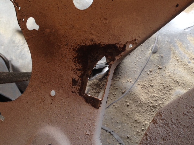

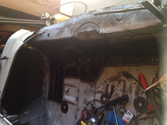

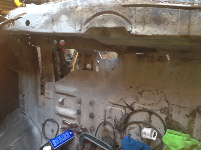

      Time for some updates. After getting the outrageous estimates for the rust repair I decided to dive in and learn how to weld. I took a welding workshop put on by the local JC and that took most of the fear out of welding. I mean, worst case scenario, I grind it all off and start over right? I'm using a small Lincoln MIG welder for all of this.

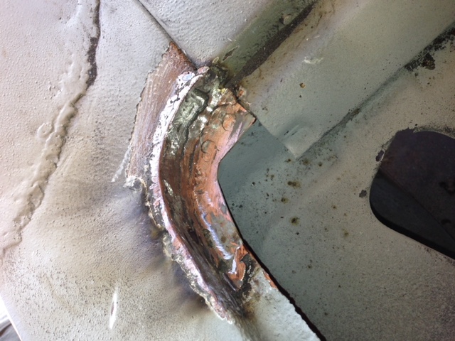

      I decided to start with a small rust patch that was non structural and wouldn't be seen by anyone. Just a spot on the rear package tray that needed some attention. Should have taken a pic before I cut the rust out, but this is what I started with.
      Then I cut an appropriately sized patch panel out of scrap that the local metal shop had lying around. If you look closely around the edges of the patch you can see the copper backing plate held on with magnets behind the patch. Keeps everything nice and level and prevents blowing holes in your metal.

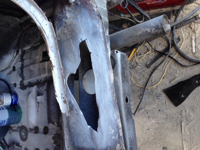

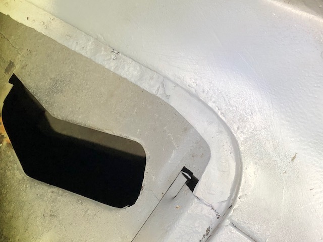

      I decided to get a bit more adventurous and take on the rusted out, lower rear window corner on the passenger side. I ended up making the patch in two pieces and welding them together once I got the shape right. I should have saved this for later on because it took forever to get this accomplished!

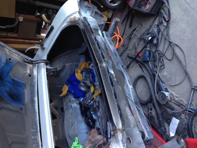

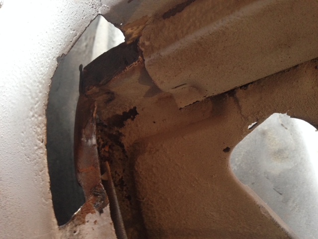

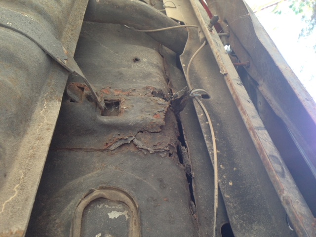

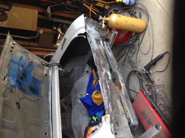

      I decided it was time to turn my attention to the rust in the trunk.
      It wasn't pretty. I opted to order a full trunk pan from AMD because nothing else had the rear most wall of the trunk included. I figured I could drill out the spot welds from the new pan and scavenge the trunk supports for re-use.
      I started cutting out the cancer.....

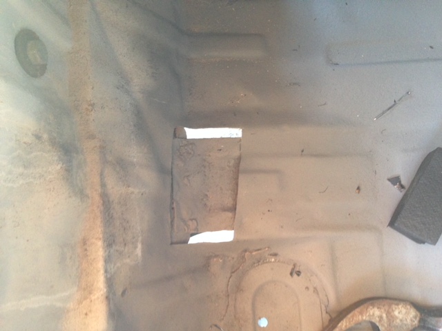

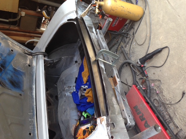

      The first round of spot welds with me being supervised by my trusty shop dog Delilah. Wish I knew how to rotate this pic...

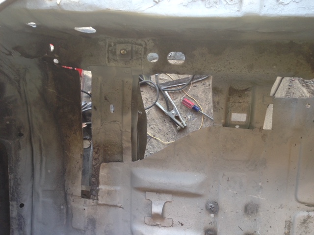

      All of the trunk supports needed attention. I replaced one of them entirely and sectioned the rest, replacing the rust with the parts from the new trunk.
      Had to weld in a new body mount as this one was completely missing!
      It may not be pretty, but it is structurally sound. I'm a big boy (North of 270lbs) and I climbed into the trunk and jumped up and down. All it did was bounce the suspension. I'll grind everything down later, but I'm not too worried about looks here as the trunk will likely be carpeted.

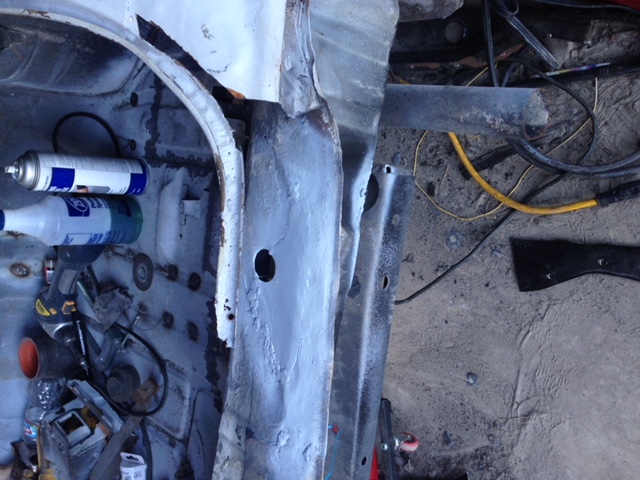

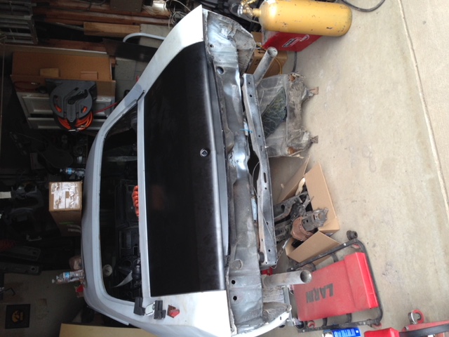

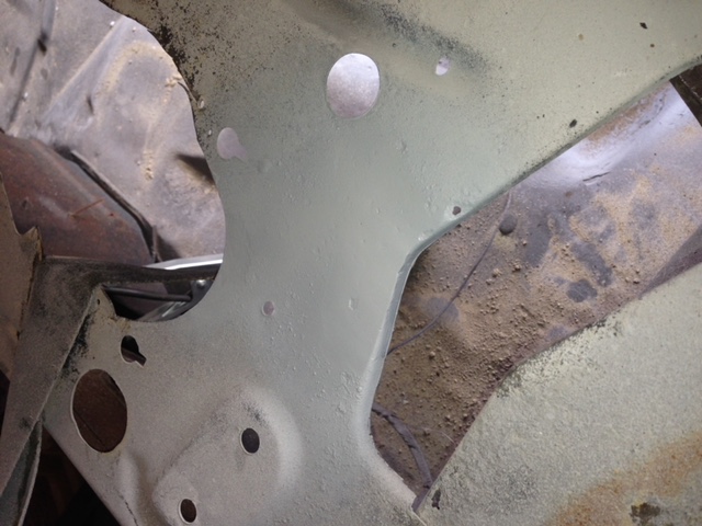

      The rear most section of the body above the bumper was 90% bondo and shattered when I hit it with a hammer. So I cut it all out and ordered the part. The patch in the second pic I had to make from scrap. I'm not too concerned about looks here as it will be covered by the new panel that I ordered.
      Drilled the new panel to make spot welding easier and it went right in. I'm starting to get the hang of this.
      Looks pretty good and fits properly. The passenger side rear quarter panel to bumper gap is HUGE. That quarter was (poorly) replaced sometime in the 80s before I ever got a hold of the car. Since I don't want to replace the quarter panel, I need to figure out a way to get that gap looking a bit tighter. Any suggestions?
