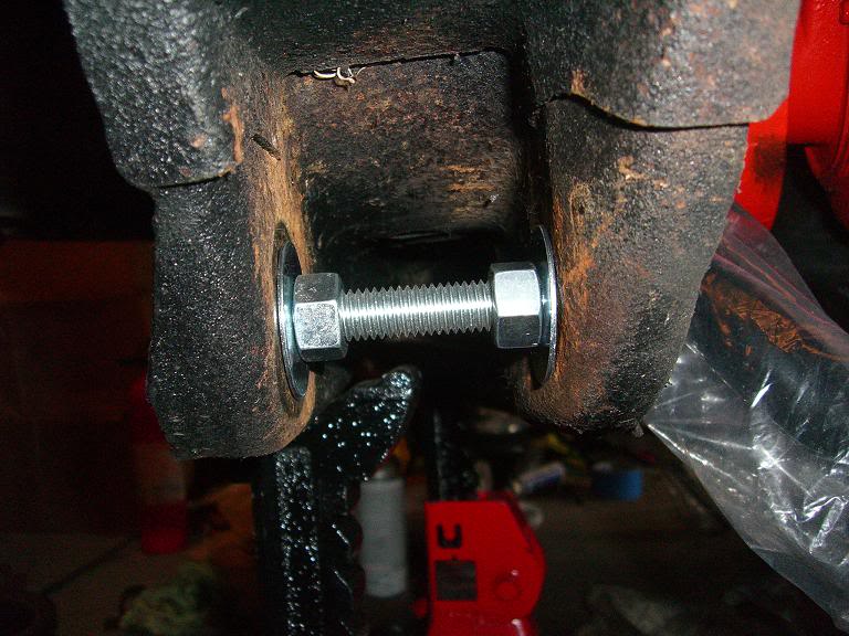

      Or, you could make one of these simple tools and spread the opening(s) until the control arm fits...
      Name:  Control Arm Installation  Tool.jpg

      Thanks will do...how u make that tool
      Jul 2007
      63
      Quote Originally Posted by 69firebird19 View Post
      I haven't made one yet... I think Camaro control arm bolts are 5/8". Get a 5/8" stud or bolt and cut it down to about 1" or so longer than the gap in the frame. Get 2 nuts and 2 washers (5/8) as well. I'd use grade 8 hardware for this tool, and make sure you lightly oil the stud/bolt.

      I would use a piece of threaded rod and two nuts to spread it. . . No im just kidding id probably smack it a couple few times with a mallet.

      I'd probably use the stud and nut spreader tool. You could use a big rock if you like... To each their own.
