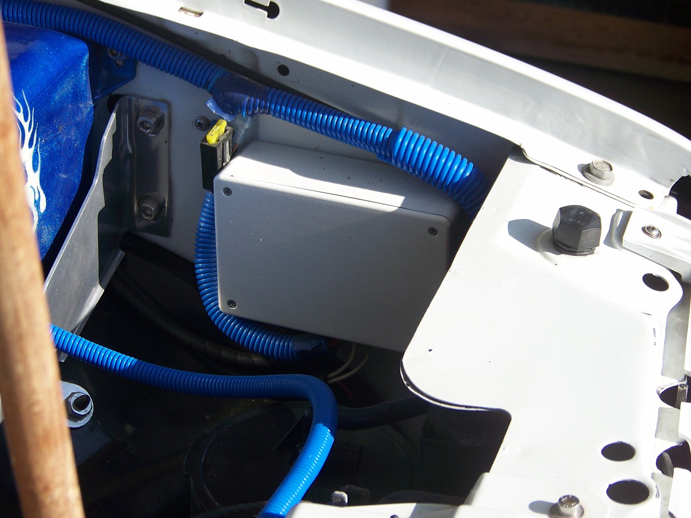

      I put all of the relays for my truck and the van in Radio Shack Project Boxes. Keeps everything neat, in one place and, when painted the same color as the engine compartment, the box disappears. Wire it through the back side to hide the wires. The van box starts at post #626.
      https://www.pro-touring.com/threads/...Faze-II/page32
      This is a pic of the relay box in my truck
      Sure does beat crawling under the dash to work on this stuff.
