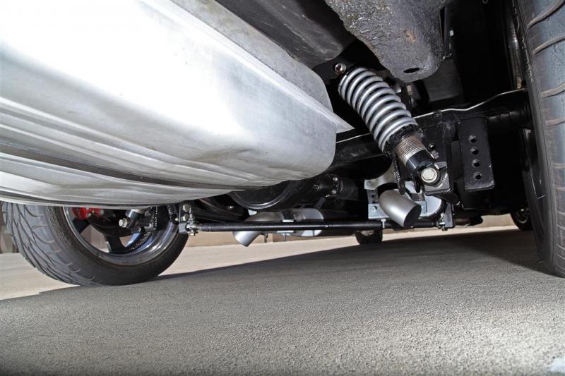

      the bar i have has heim joints (spherical rod ends) that allows up and down movement with suspension travel
      here is the only pic i have at the moment, disregard the bent shock, i found the QA1 had a bent upper mount and replaced them all with viking shocks.

      okay cool, but wouldnt the style i have virtually make no side movement as it moves with the travel
      Mopar or no Car
      Your either with us or Behind us
      Mar 2004
      Mid-Michigan
      2,764
      Quote Originally Posted by benno505 View Post
      No, your track bar cannot stabilize the cross car movement of your suspension. Look at it like this. The track bar is at an angle to your suspension and also at an angle to the force being applied to your suspension. Being that it is on an angle it is trying to inscribe an arc, the center of which is at the front mount. The radius of the arc is the bar length, center of link to center of link. The track bar is simply letting your suspension swing around the solid mounting point. This puts a LOT of stress on all of the other suspension components and is what bent your shock mounts.

      okay i will make a bracket, that hangs low enough to give me a panhard bar that is parallel to axles, weld it to passenger side chassis. then mount the other end to the lower shock mount, this should work right?
      just shorten the bar i have now to suit.
      I also might take my top 4 link rods, set my squareness, set my pinion, put one of the rods back in to make sure everything is right, then adjust the other upper rod out to suit and bolt it up.
      last time i set my squareness and pinion angle with all 4 rods still on, this might be causing some binding of the 4 brackets and might be twistin gthe diff a little.
      what do you think?

      Your shocks need to be more vertical. They are not very effective as mounted.
