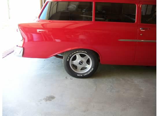

      I figured out the suspension issue today. It boils down to a WHEEL issue more then suspension though.

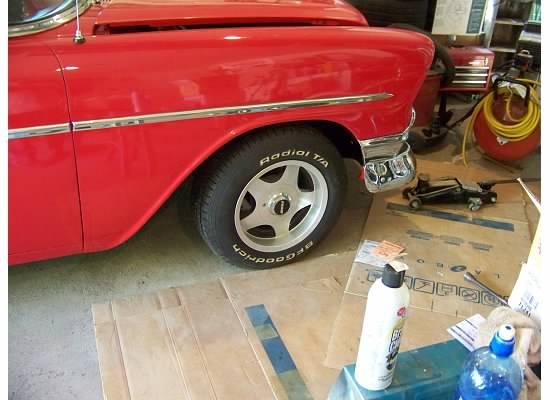

      The wheels just don't work. They have slotted lug holes and are NOT hub centric. That means there was NOTHING centering the rims to the hub. They were slopping up and done on the lugs as they were rolling...
      This is what I found when I pulled the left front wheel off:
      1) Three lug nuts with mostly stripped threads.
      2) Two broken studs..
      3) ALL of the studs were loose in the rotor! The wheel had been knocking around enough that the lug studs had worn their respect lug holes to an egg shape! ALL of them!
      4) The spindle nut was loose by almost a full turn.
      I pulled the caliper, removed the rotor and knocked the lug studs out with some very light taps from a ball peen. Not a BIG ball peen either.

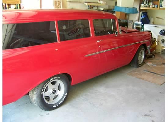

      Took the car on her maiden voyage tonight! She did very well! It has some lighting issues but those just may be bad bulbs. The engine ran great, the air blew cold and the wheels stayed on!
      I had a set of old 5 star mags I ran on my '89 Pickup. They bolted right up and are lug centric so no more wobbly rims!!!

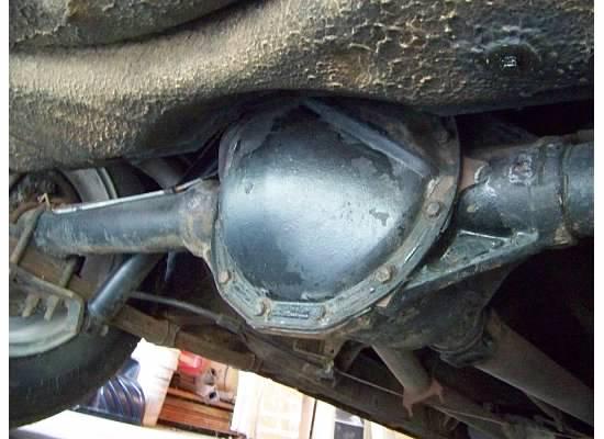

      While I was swapping out the rear rims I saw this!
      A 12 bolt! and it is a posi!
      Whoever built this car threw some coin at it. I found a link to a FOR SALE ad in California for THIS car. There was a pic attached that was dated from 2004. The car also has no front bumper. The gravel pan had been trimmed and rolled and this is what's on the front of this car under the bumper. The digital cluster rolled 60K tonight on our way to Durand...
      The car with my old truck wheels on it. The wheels are dual bolt pattern 4.75/5.00.
      Not real pretty but they will do the job till I get some new shiny ones!

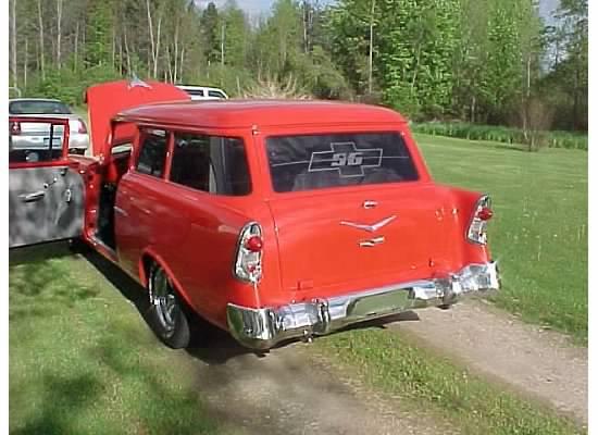

      The last 4 months have been pretty much dedicated to working on the wagon. After doing a complete rewire of the starting and charging systems, N/S and B/U switches, tail, head and parking lights I thought I had everything taken care of. Wiring wise I did. Other things...not so much.
      I haven't been posting much because I haven't been on the boards. Counting today the wagon has been out to a friends repair shop for three weeks. What started out as simple steering box swap turned into a major renovation! While doing the box swap we did the oil, trans, rear end fluid change stuff and decided to adjust the rockers to get rid of a lifter tick on the passenger side... Nope, not gonna do it.. Cam had a flat lobe... VERY flat! Needless to say that opened up a can of worms that we are just beginning to get closed.
      The same day we found out about the bad cam I had ordered a fuel injection set up from Performance Fuel Injection. So, along with the the new cam, lifters, timing chain, intake, water pump, harmonic balancer, belts, hoses, radiator and A/C condenser brackets, I installed new supply and return lines, O2 Sensor, fuel pump and pre-filter, wiring, ECM, distributor, coil and TBI unit.... Whew...
      We got the car fired up this past Saturday evening. Still have a few tweaks to make in the ECM to correct a rich exhaust and low idle but it is running again and I hope to head over to Kalamazoo Friday afternoon for the NSRA Nats. AFTER a front end alignment sometime this week.
