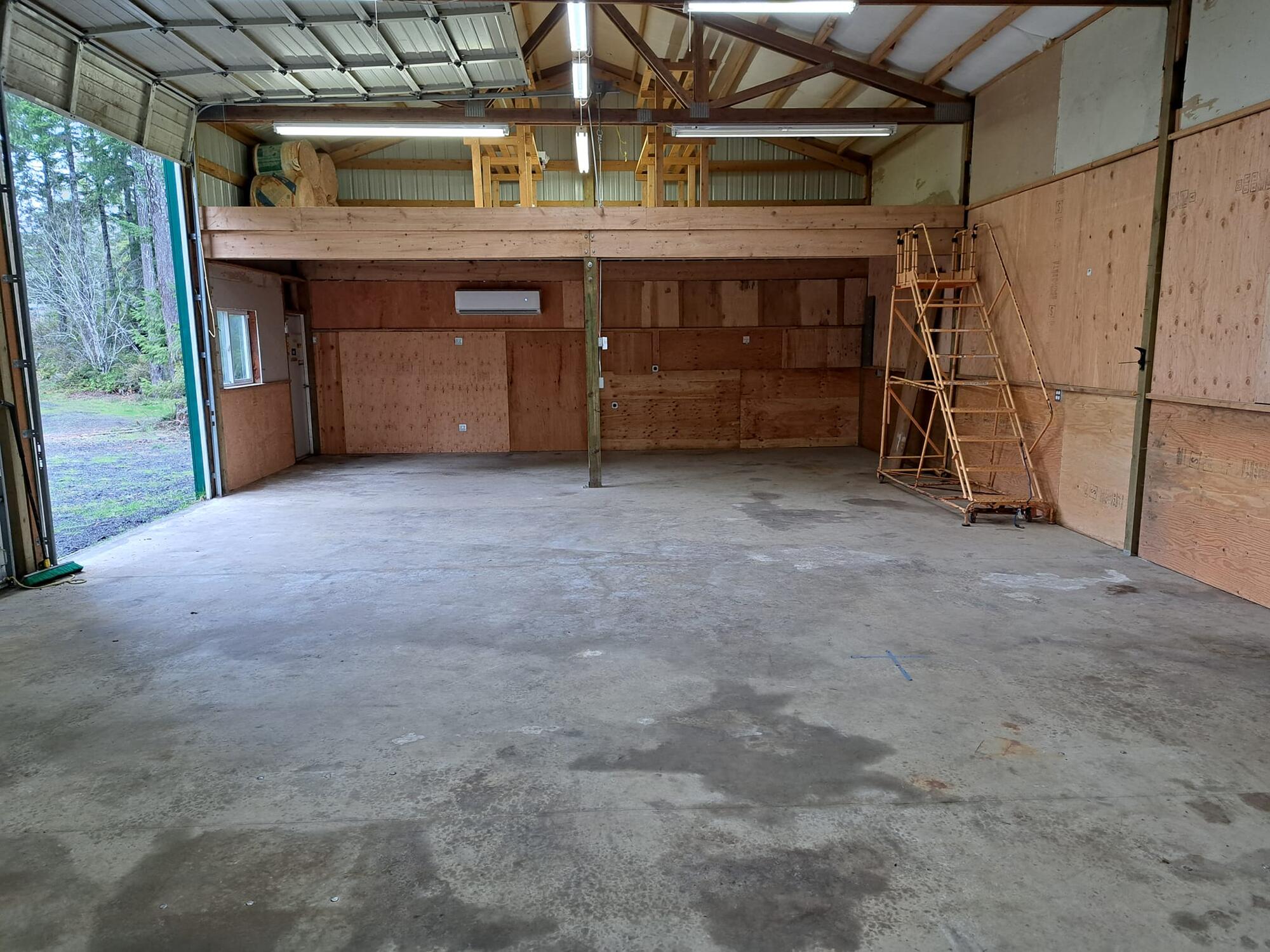

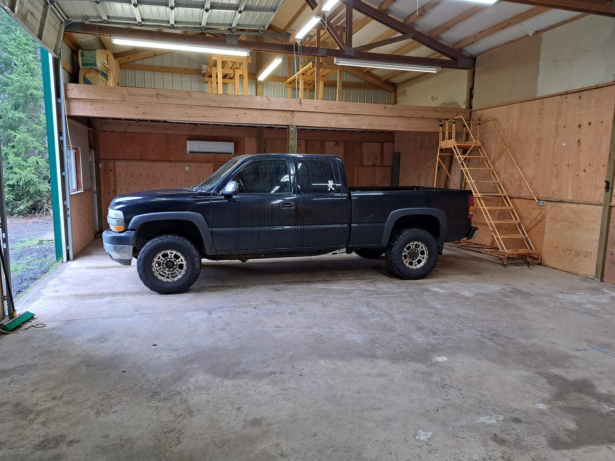

      Well the wife and I found our house and it came with this. 30+ years of working in a gravel driveway, backyard or borrowed garage/shop space is over. We move in next weekend. Work on both my projects will resume as soon as I get organized.

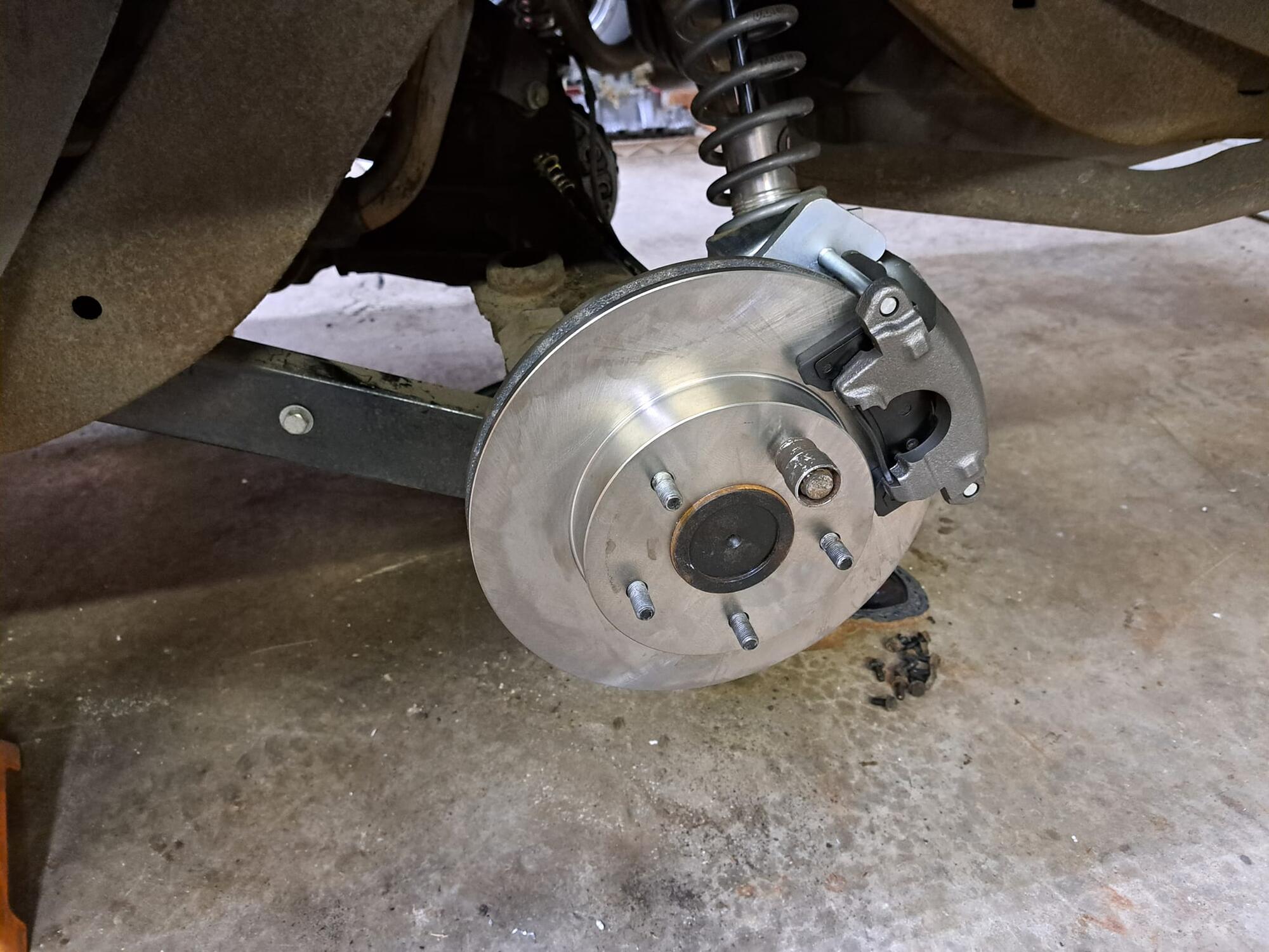

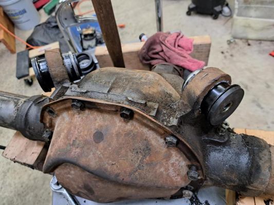

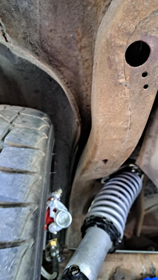

      First up install the rear disc brakes and finally replace the upper control arm bushings. I did the brakes while the rear end was still under the car but decided to pull it out to do the bushings and new hardlines.
      Next up, get the axle back in and swap the master cylinder to a Corvette unit and a 4 wheel disc proportioning valve.

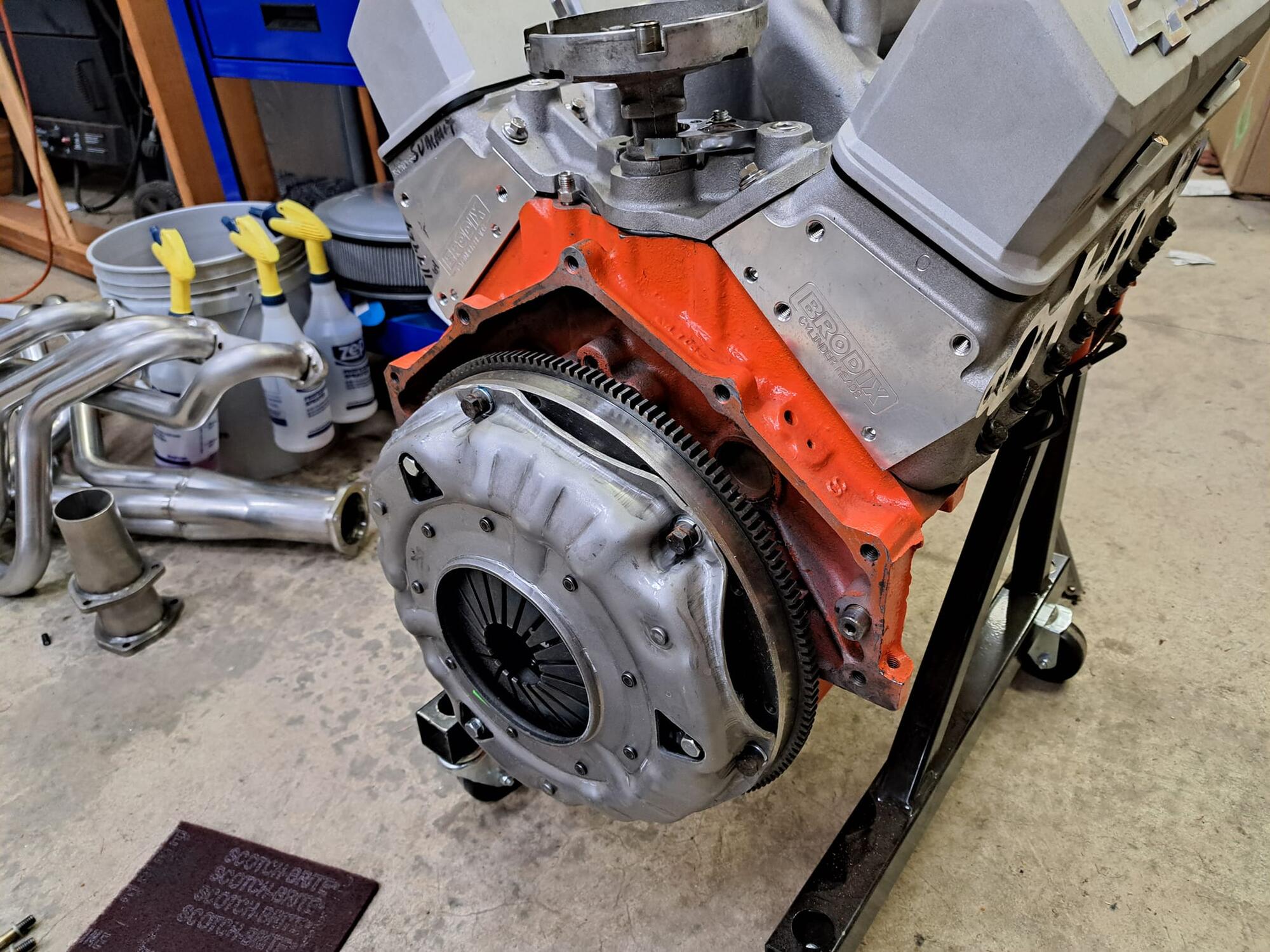

      Some progress made but parts trickling in.

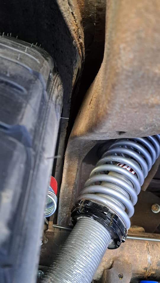

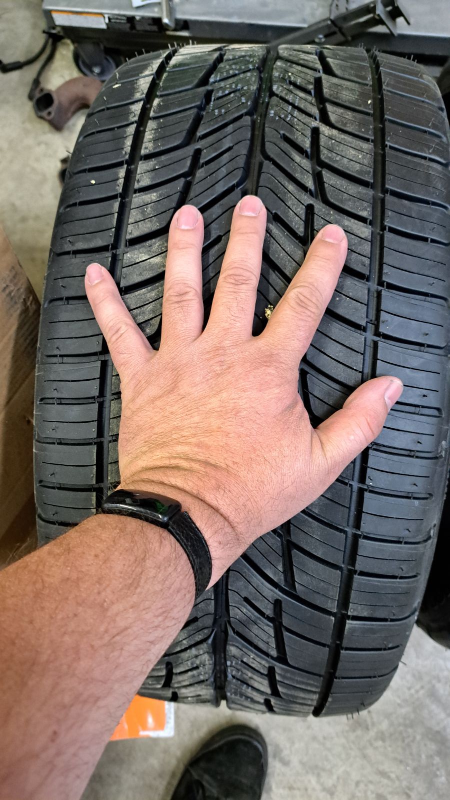

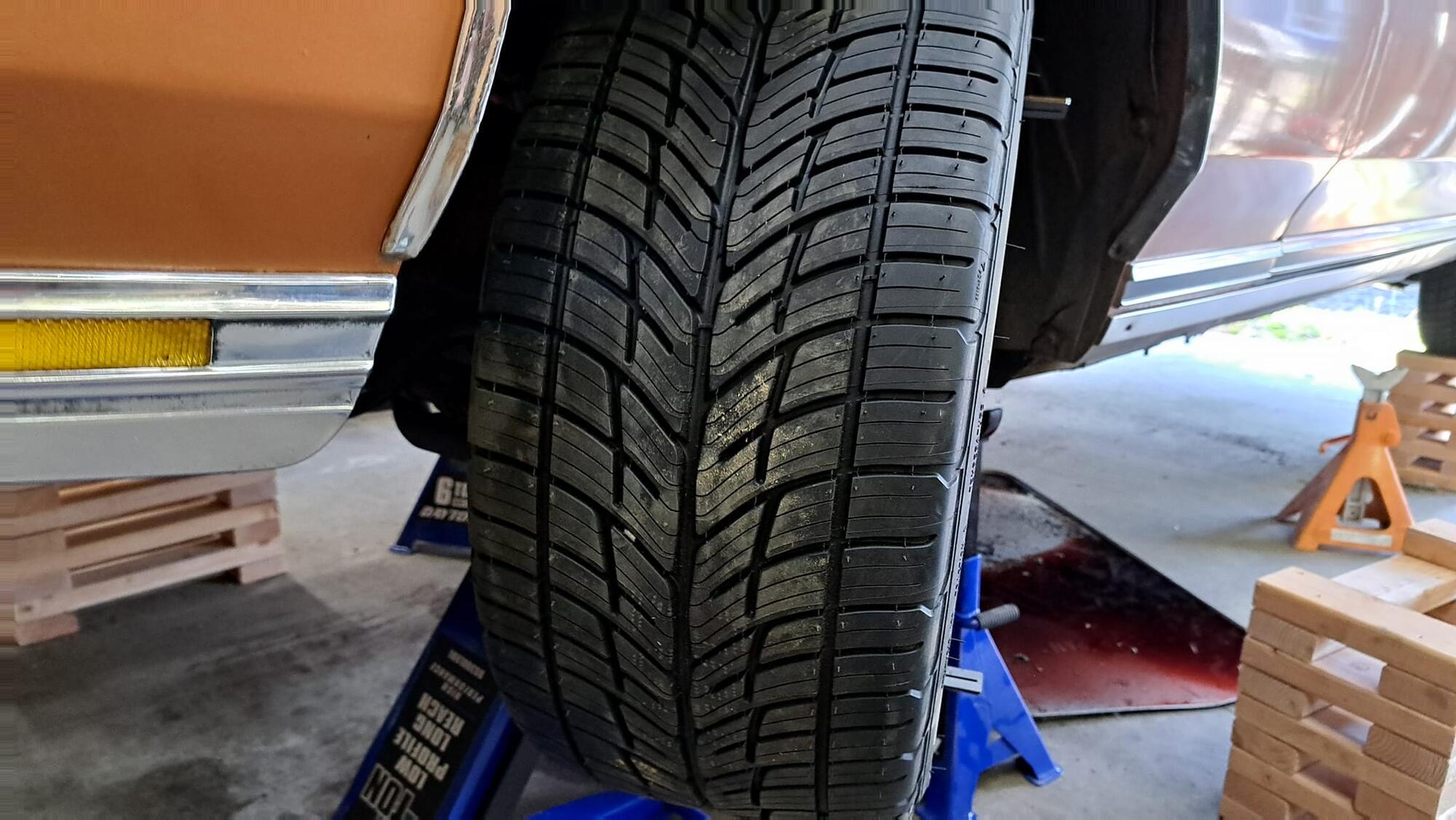

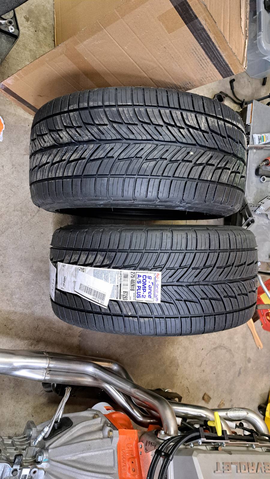

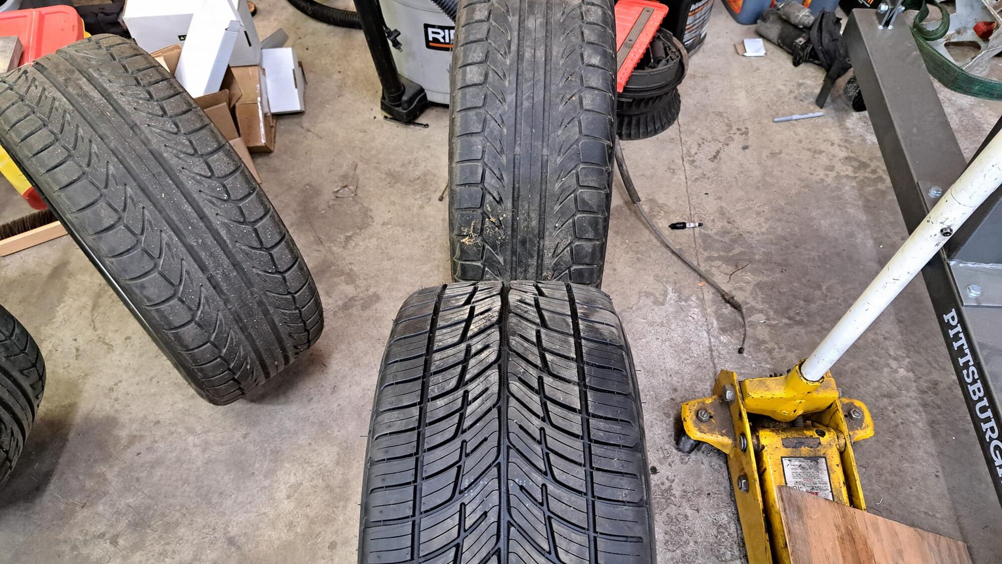

      Time to fit up tires so I can get some wheels. I know they'll fit the rear just need to get the right specs on the wheels. While I'm at it I'm going to see if I can get them to fit the front with the same wheel spec as the rear. If that doesn't work I have a plan B for the front. Not exactly 335s but for unmodified wheel wells they're plenty wide

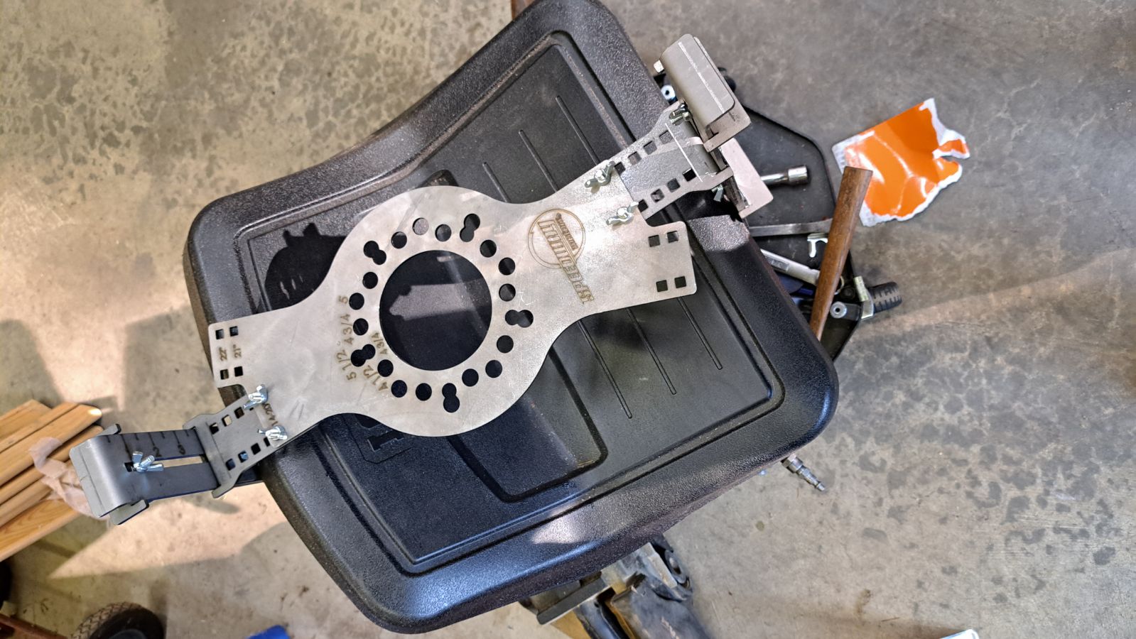

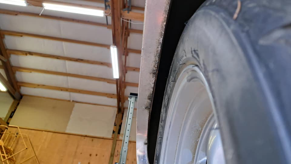

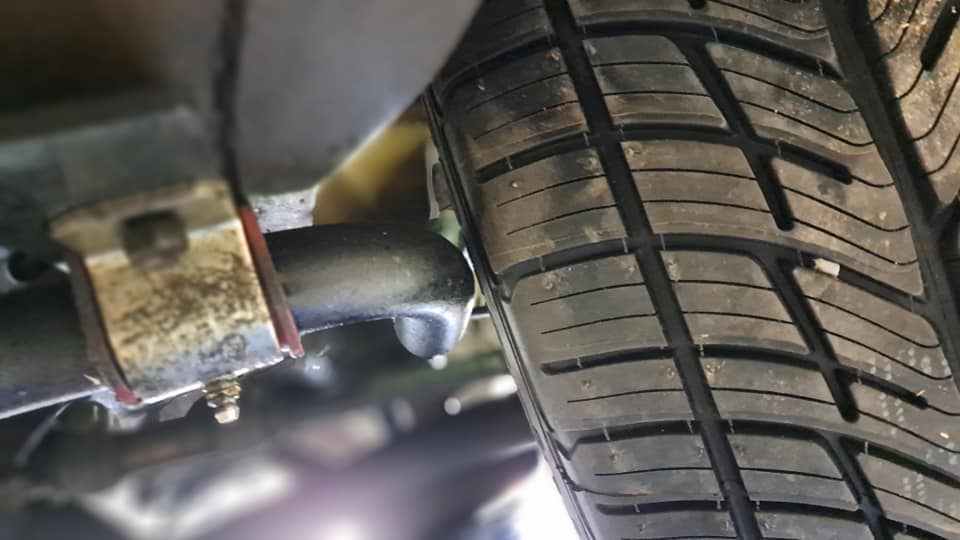

      Got the tire jig put together and adjusted and got my wheel specs figured out. I have room for 275/40/18 on 18x9.5 with 6.0 BS on all four corners with just enough room on the front and room to go up to a 295 on the rear in the future. I might be able to go to 295 on the front with a different sway bar.Name:  455773032_10160702608284006_717262027016645296_n.jpg

      Took me some trial and error, should have found a Youtube video, but got it all figured out. Now I just need to order the wheels. You seem to be the go to guy for EFI, what would you recommend for a decent system, preferably port style?

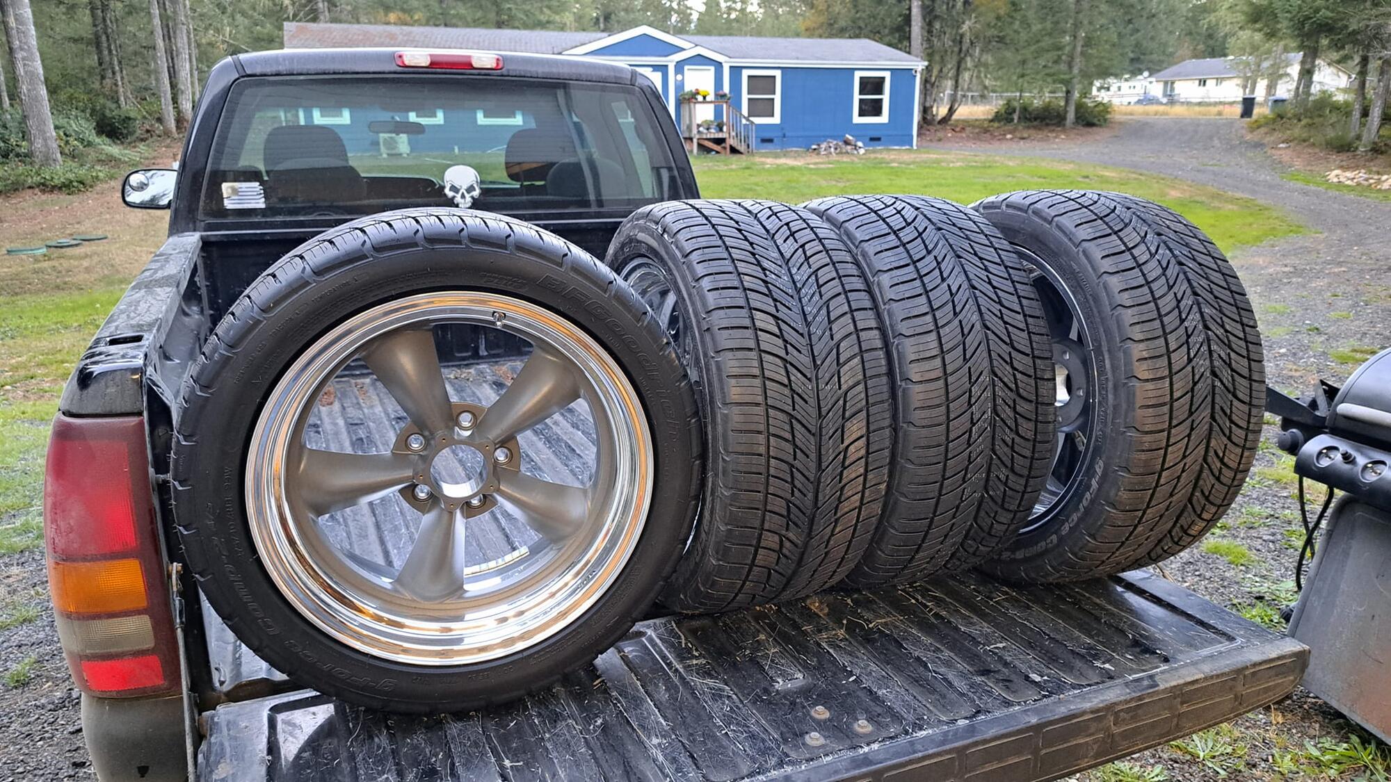

      Got the new wheels in and got the tires mounted and balanced.

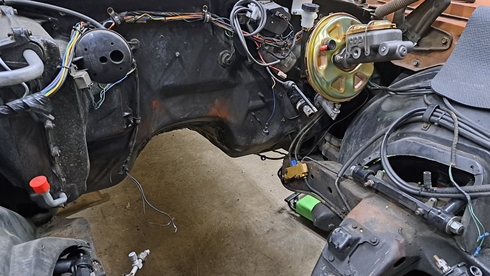

      Got my master cylinder and booster installed, made a bracket and installed the hydro clutch reservoir, cleaned some parts for paint and ordered some parts. Hopefully I can get the brakes and steering operational soon so I can move it out of the garage so I can pressure wash the engine compartment so the engine can go in.
