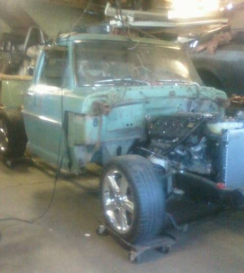

      Finally got the cab back on. 1969 f-100 with a ford racing crate 5.0

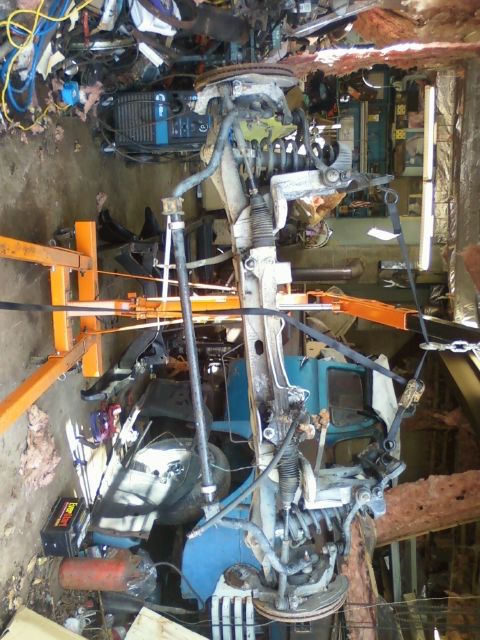

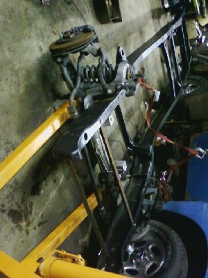

      Think he's asking if you used any spacers or was it just cut out and and drill four holes? I've seen a couple builds like this other places but no one really shows how they did it.
      Are you going to use the trailing arms with it? Would love to see some closer pictures on how you did the fitment.
      Have a 67 that my Grandpa bought new and really interested in this myself.
      Mar 2011
      NY
      77
      I can take more picture if you like. I made up new plates for the rear trailing arms so they would bolt level to the frame. I welded those to the frame and then rotated the bushing so they bolt to my bracket. The front I drilled holes in the frame, then welded in tube to prevent the frame from crushing where the bolts go through. I boxed the frame from front to rear, most people just box the section by the bolts. You need a 5/8" spacer between the frame and the crown vic cross member where it bolts in. I put mine on the top to be lower. I wish somebody would make airide for the front I've asked Ride Tech but I may have to go with eaton lowering springs. In the rear I have ridetech's airover, still playing with ride height.

      I can post a link to fordification if that is allowed lots of great detailed pics and step by step for crown vic there, hardest part is cutting out all the old rivets to take original crossmember out, plus on the frame I bought the po welded in parts for some reason.

      quick test fit of parts

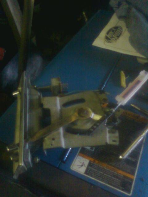

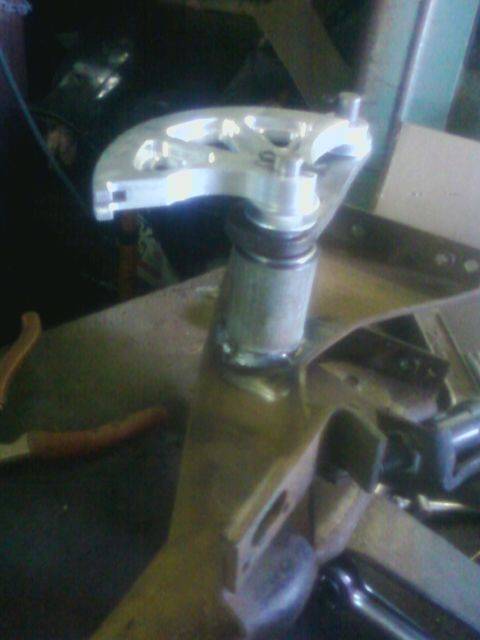

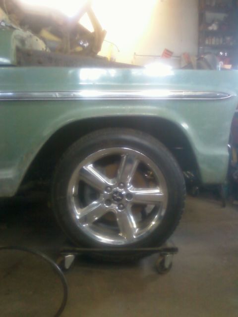

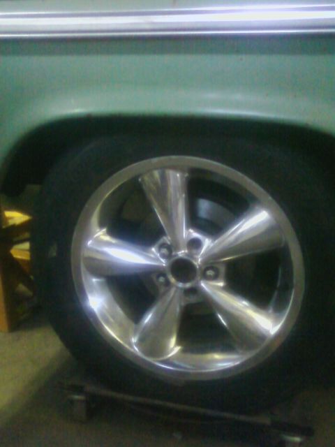

      adapted 98 cobra cable clutch to 69 pedals, also replace stock pot metal bushings with ball bearing ones.
      Picked up engine cover and coil covers at Carlisle doesn't make it run any better but looks cool
      modified stock ford heater controls to work with vintage air electric controls, Using a gen IV kit made for a 69 camaro

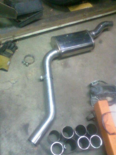

      3" magnaflow exhaust will come out bedside in front of rear wheels
      mustang cooling system

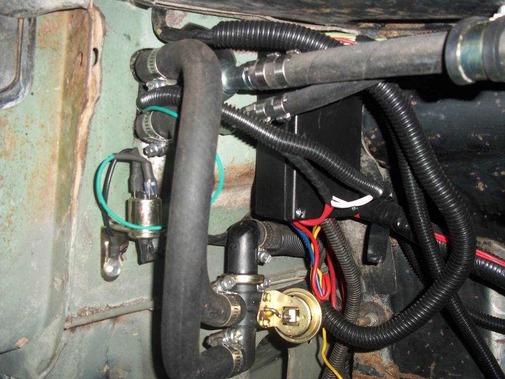

      I have to say the customer support at Vintage Air is awesome! While talking with the rep at the Right Coast Nationals I said I was having problems and I thought it might be the trinary switch. He hooked me up,when I got home I put it in and problem solved I have ac done now.

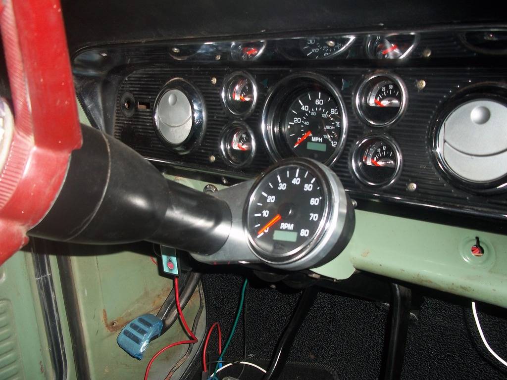

      f600 dash insert with autometer american muscle gauges. Ac vents are from 2005-2009 mustang
      Heater valve is from a ford ranger using vintage air vacuum electric switch to control it as coyote motor is supposed to have coolant flow through heater hoses at all times. All the lines are run under the inner fender to hide them. I'm using 78 ford plastic fender liners to protect everything and hide it more.
