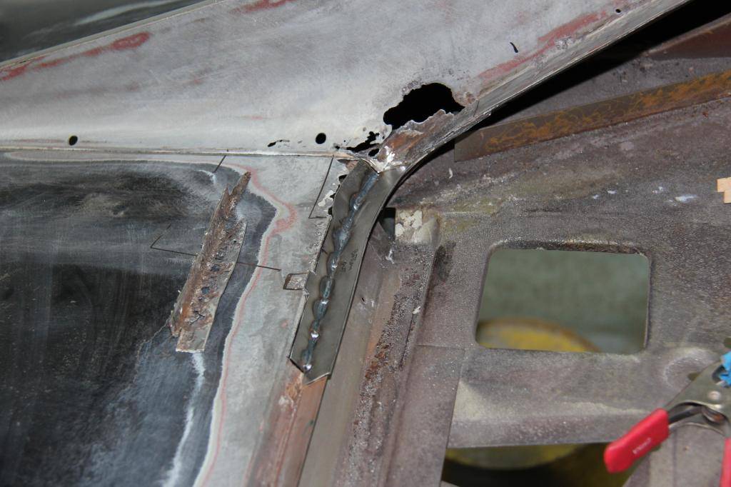

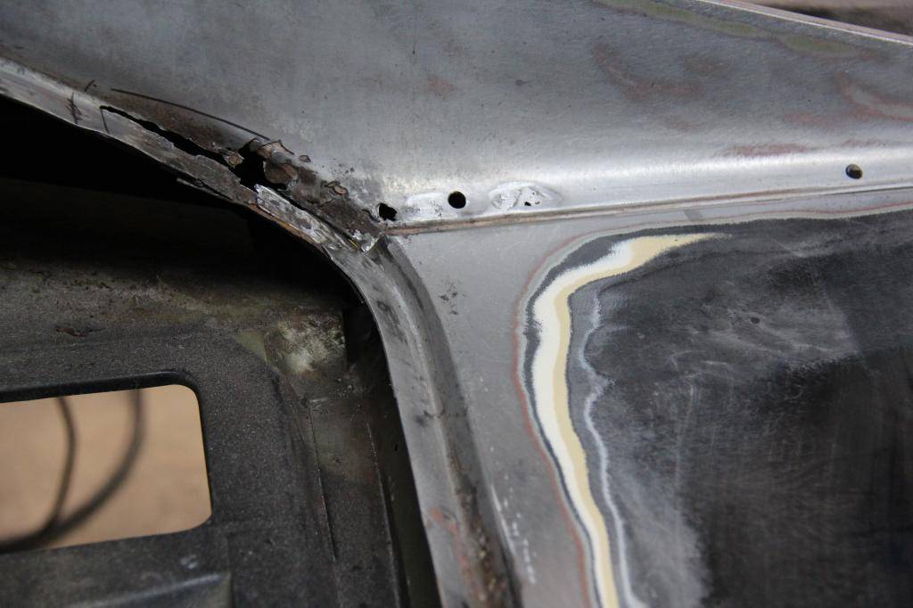

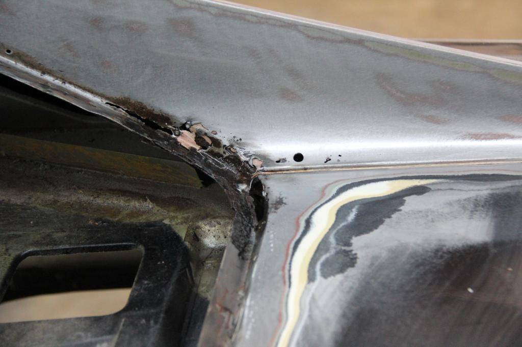

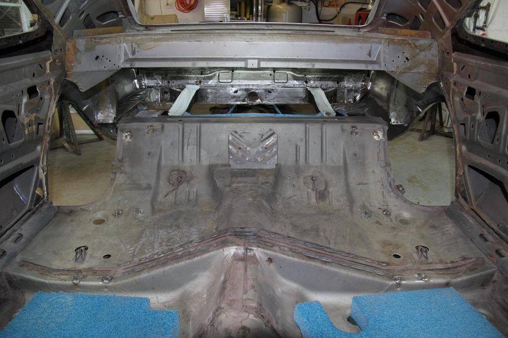

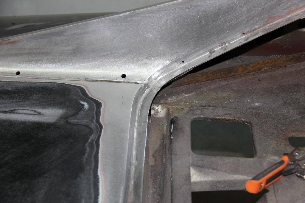

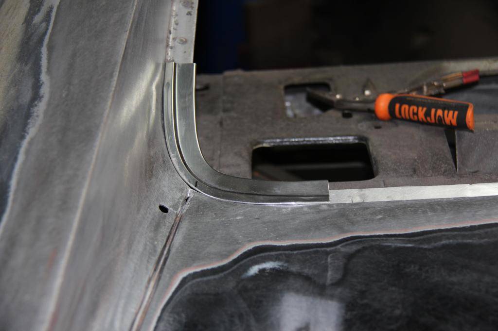

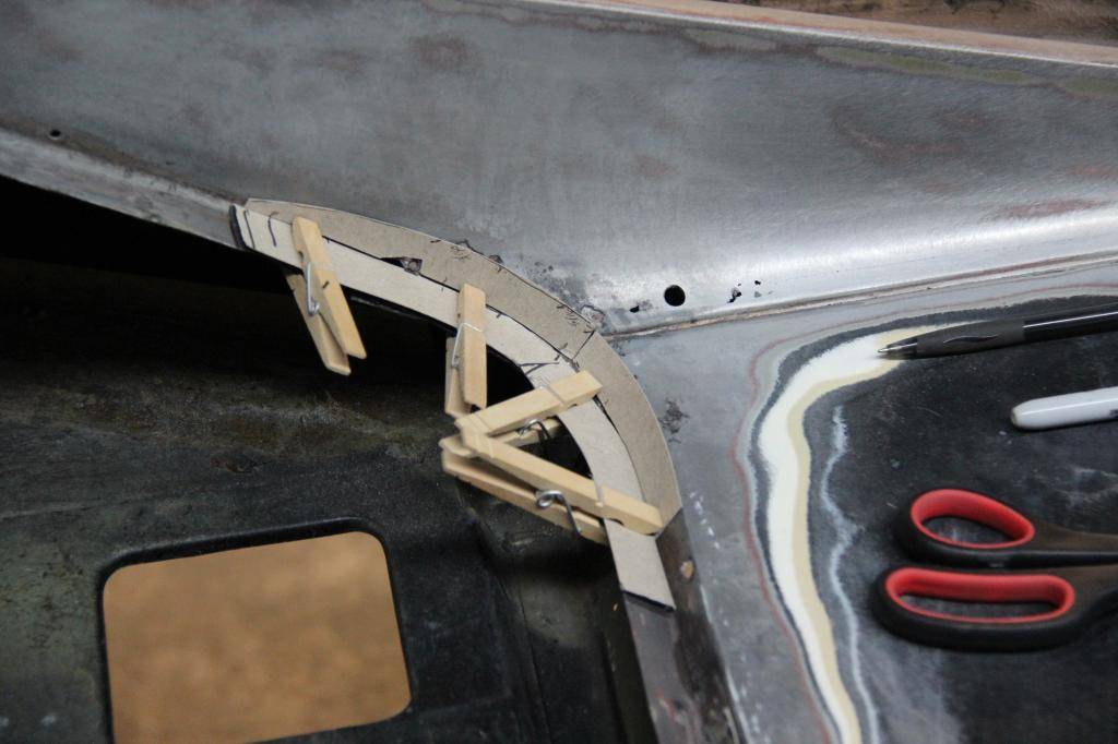

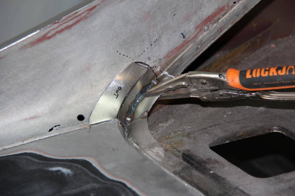

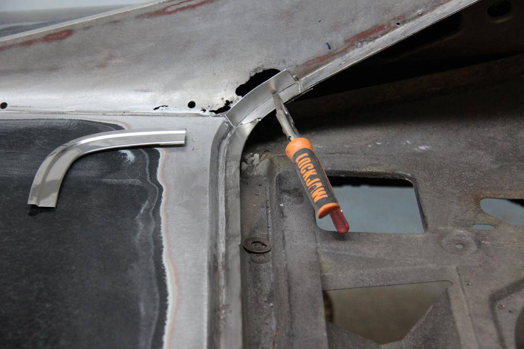

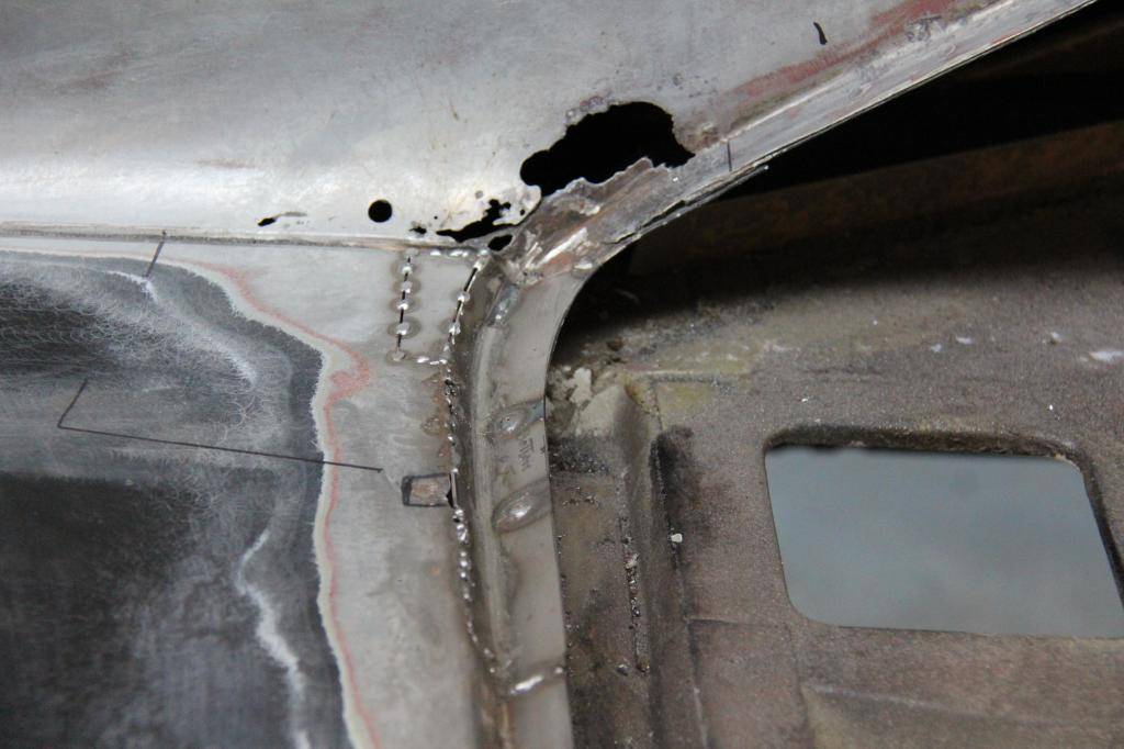

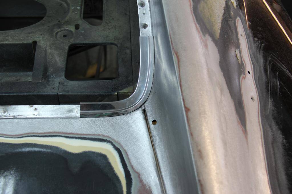

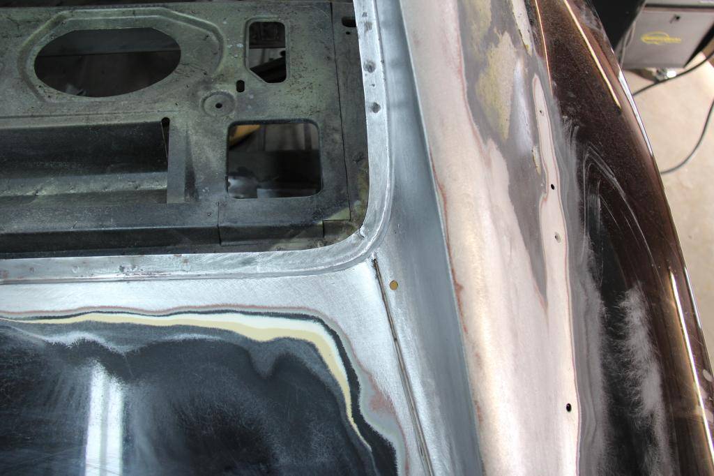

      Before installing the trunk floor I started on the back window as it would be easier to clean up the welds under the window frame without the trunk floor.
      Made a few template of the corner before cutting the rust out as to match the shape.
      Welded in the lower half of the corner before cutting out the top half to help hold the shape.
      Use the trim to confirm the shape as I tacked welded the new metal in.
      One corner done and one to go.
      Thanks
      Pat

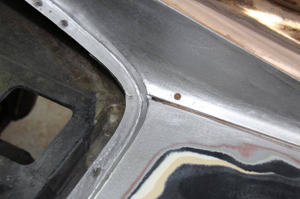

      803

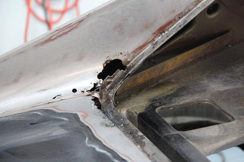

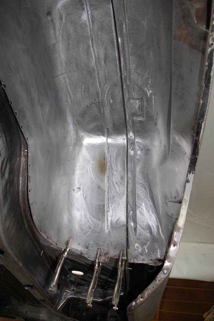

      The right side was a little more work but turned out nice.
      Next project is the trunk floor and mini tubs.
      Thanks!
      Pat

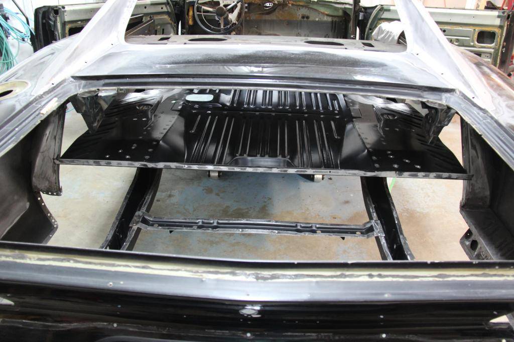

      803

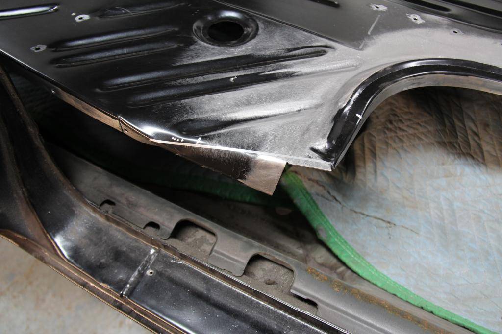

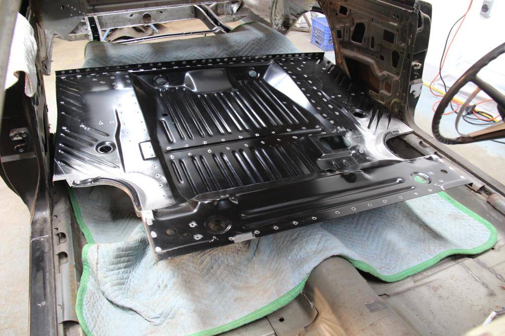

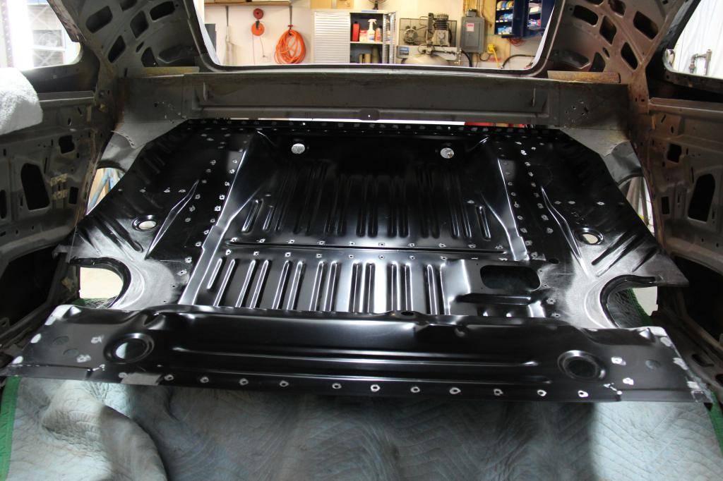

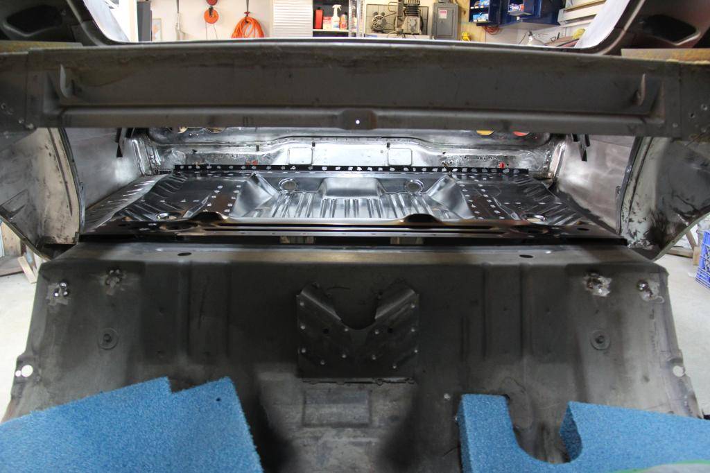

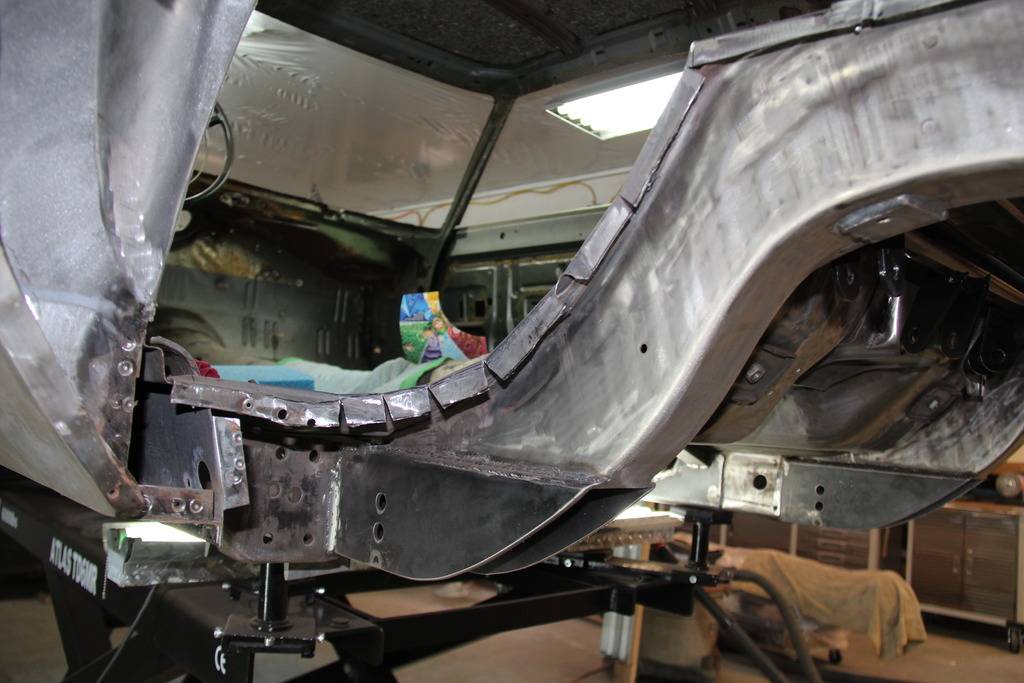

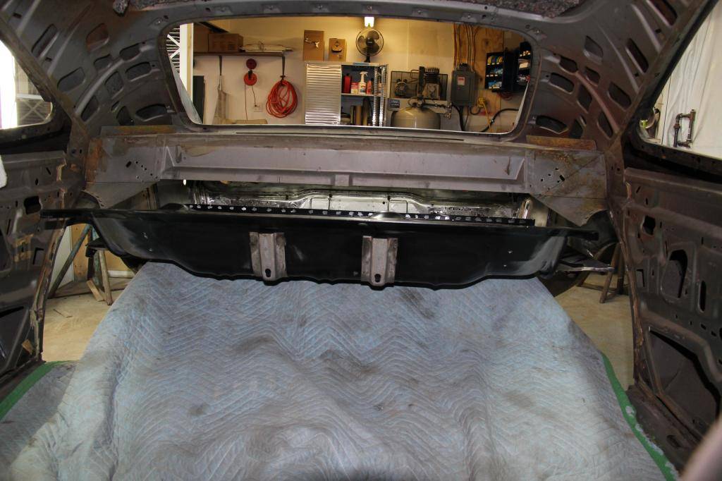

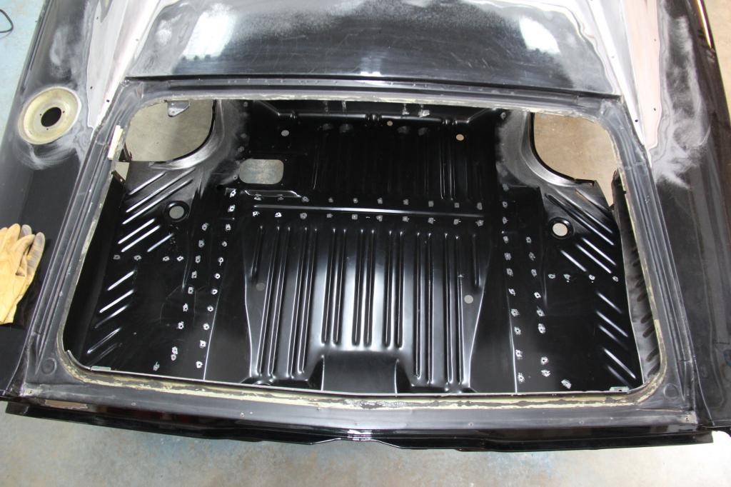

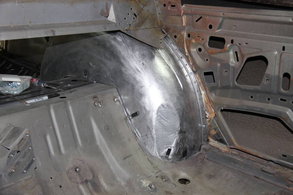

      Test fit the trunk floor today so I can measure for the inner wheel wells. With the back seat cross braces removed and upper corners slightly bent up. The only other modification need was to bend the right side aft wheel well corner which I was planning on as I didn’t weld that corner on yet in anticipation to a tight fit at the widest point of the trunk floor.
      Thanks
      Pat

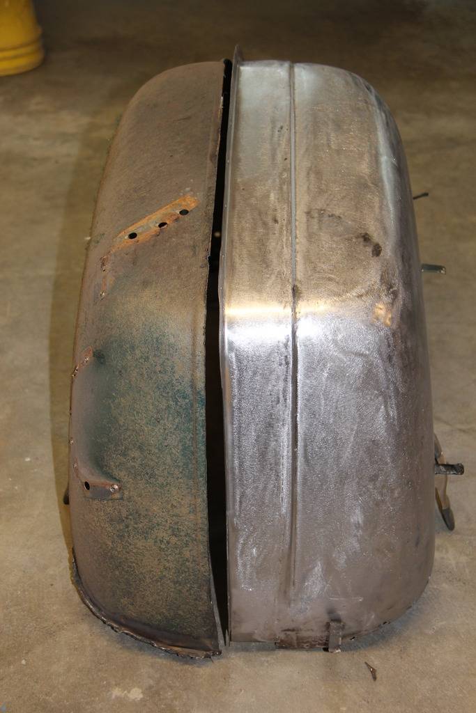

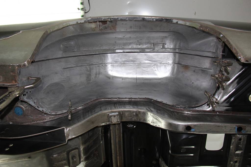

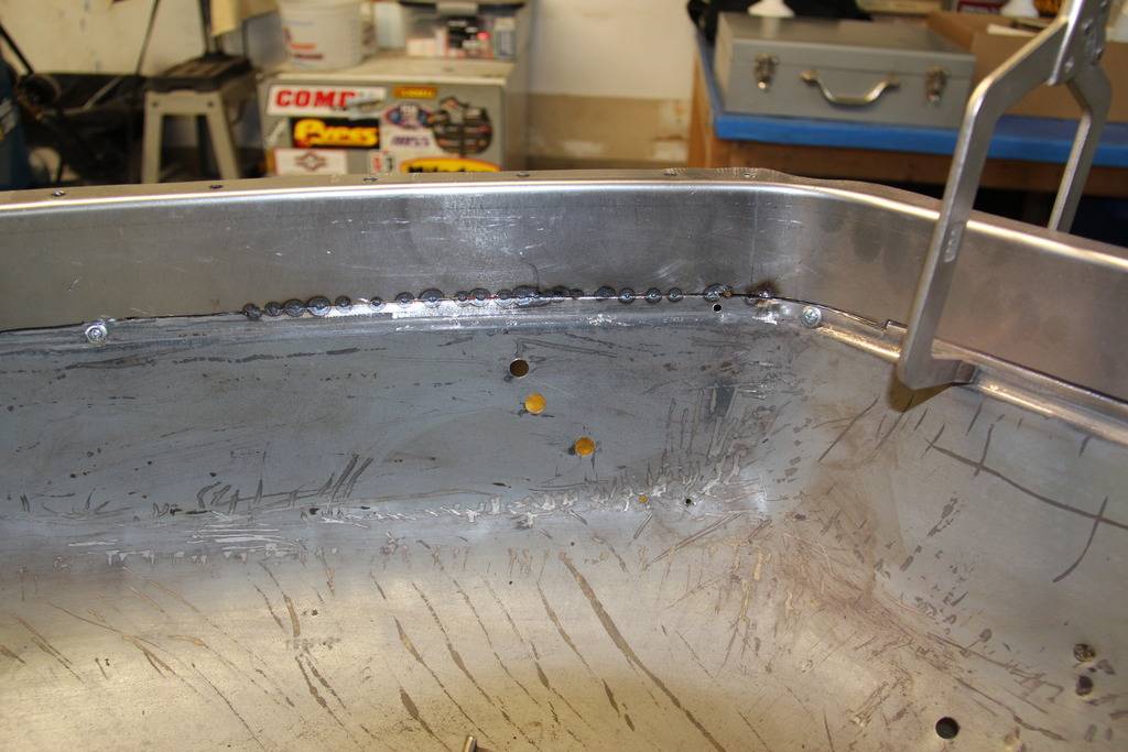

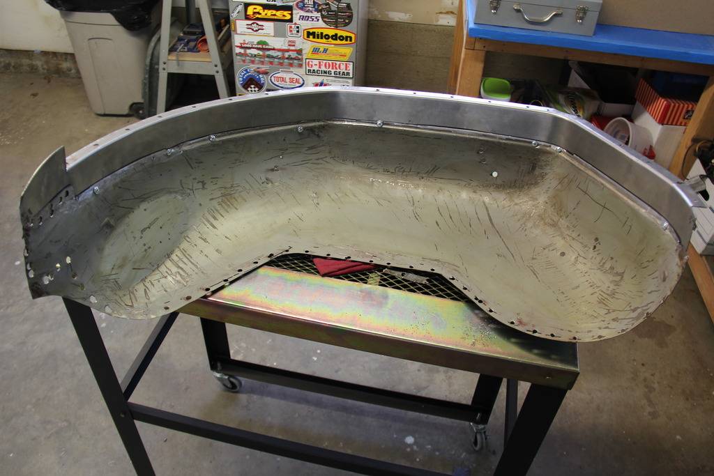

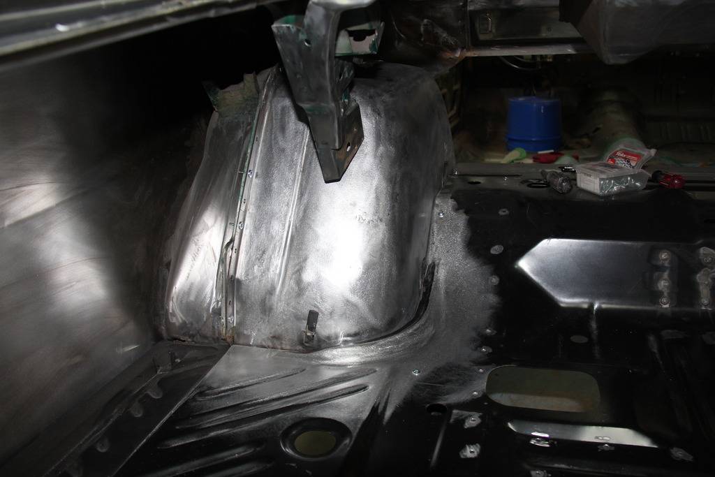

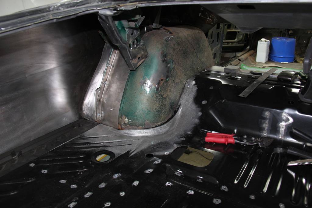

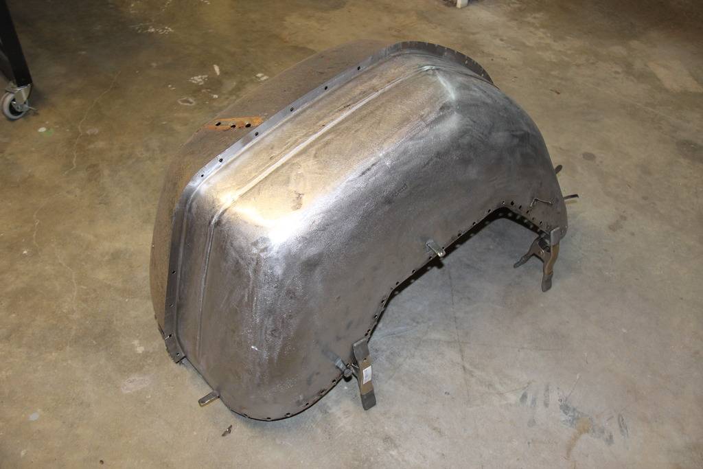

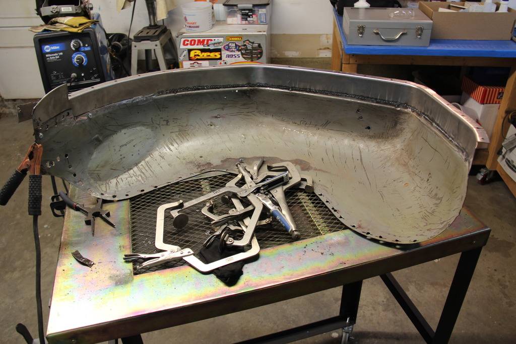

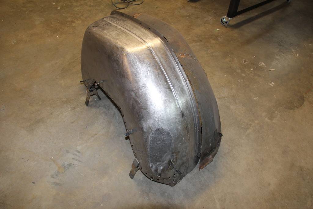

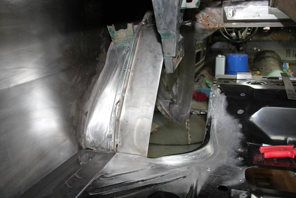

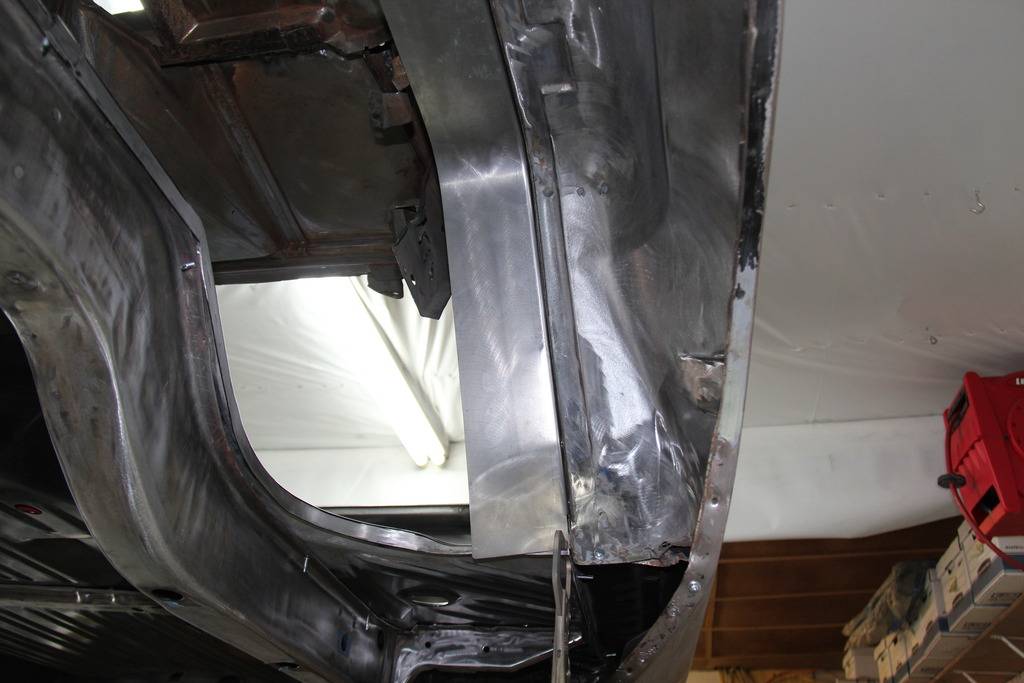

      Fit and butt welded the US Car Tool mini tub kit to one of the wheel wells. The left side fit great and I’ll let you how the right side works soon. Would be nice if someone made wide stock looking wheel well like they have for GM & Ford cars!
      I screwed on the extension to the outer wheel well. The shape of the kit is spot on!
      With the extension in place I screwed the inter wheel well on so I could remove it as one part to weld it together.
      Added about 2 ½” to the wheel well, a lot of work for a 335 tire but it will look cool!
      Thank you!
      Pat

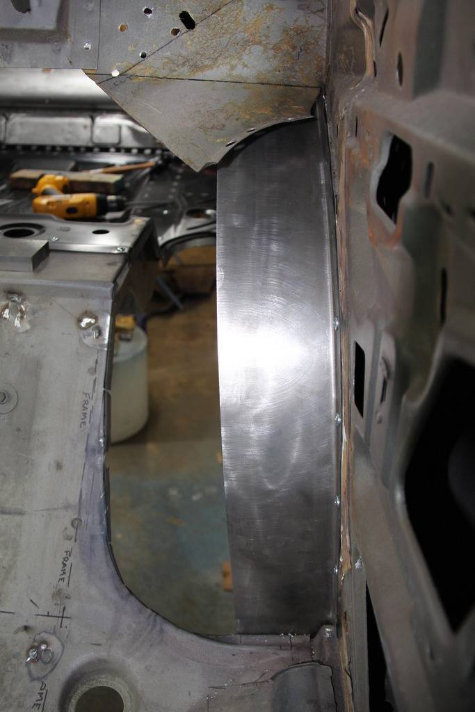

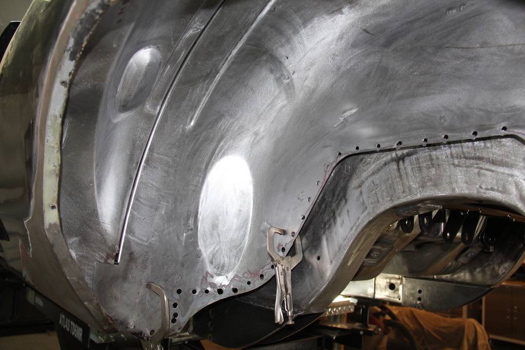

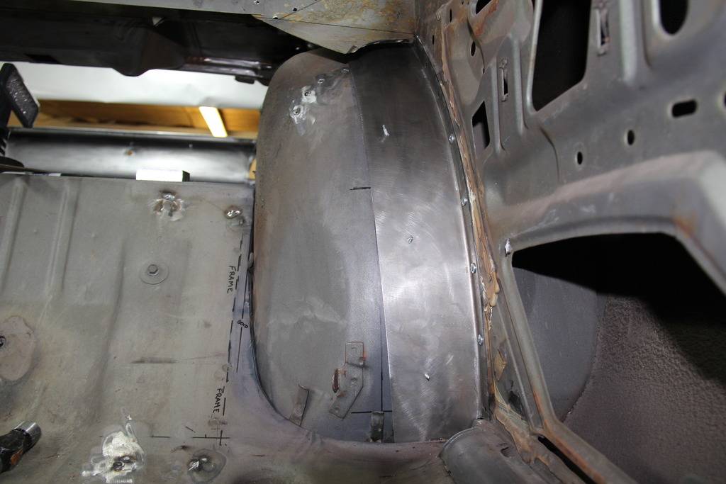

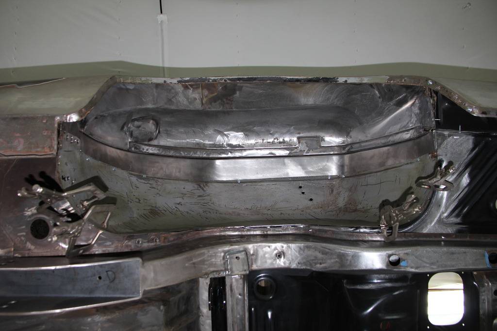

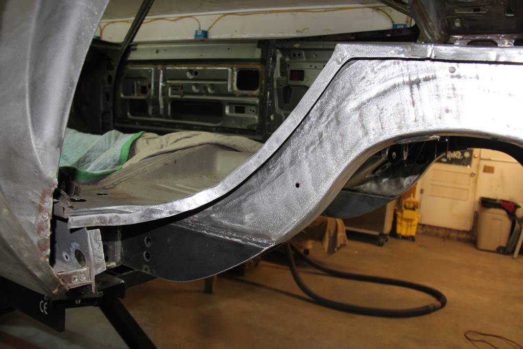

      Finished the front wheel well floor flange and test fit the left wheel tub. Now on to the right side.
      Thanks
      Pat
