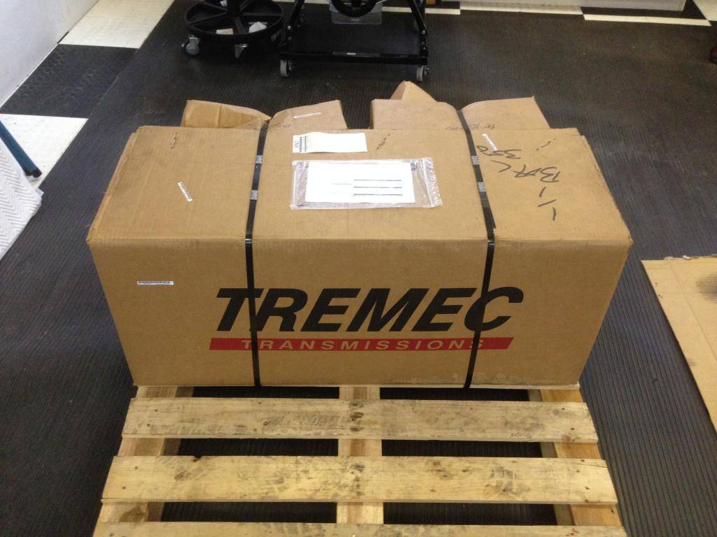

      Received the T-56 6 speed transmission I ordered from Silver Sport Transmission today, along with the clutch, flywheel, peddles, and Quick time bell housing. So now I have most of the drivetrain component.
      Thanks
      Pat
