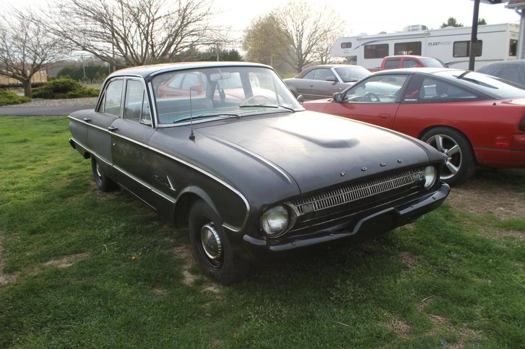

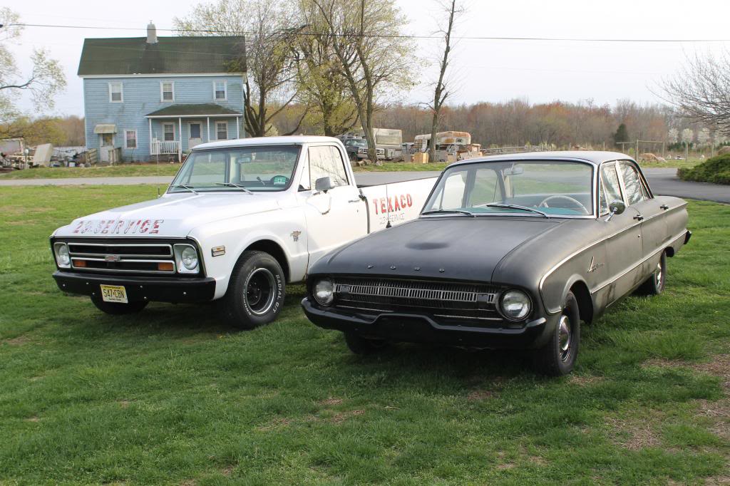

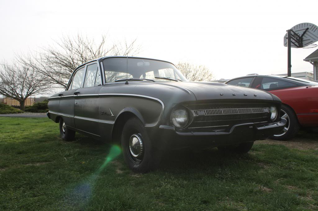

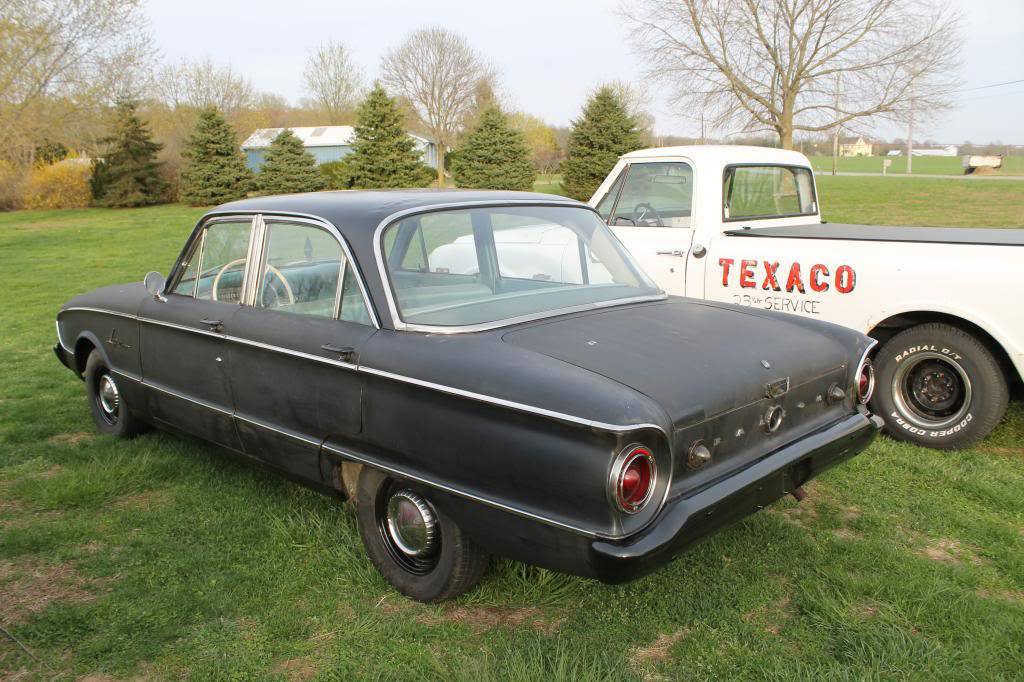

      Here's some pics of the old bird. Project Falcon Punch.
