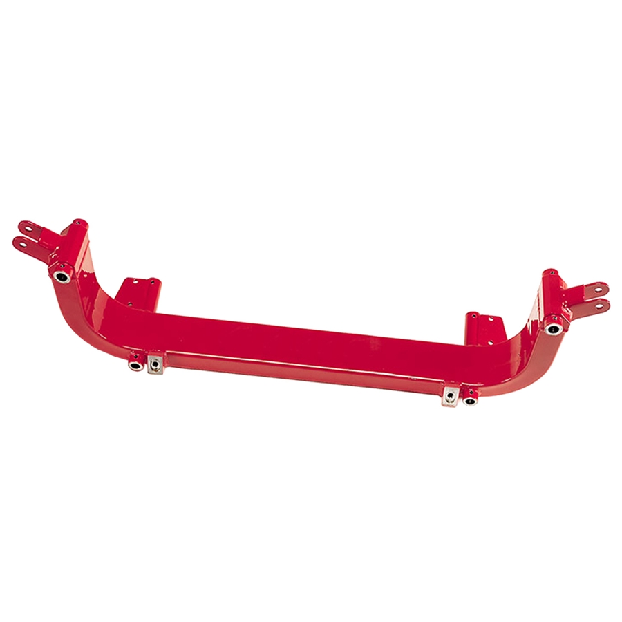

      I have a complete Chassis supplied by Chris Alston Chassisworks. Great people, and have had a pleasure working with them. I strongly recommend to check them out for your custom build applications, and even some stuff that can easily be adaptable to your car. Visit them @ www.CAChassisworks.com
      Complete IFS will be supplied by Chassisworks as well.

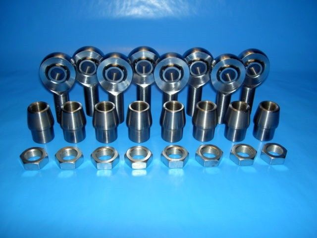

      I have a complete 4 Link bracket kit supplied by Bears Performance. Fast, easy, and great to work! I recommend working with them if you ever need anything! Check out their website to wrap your mind around how much sstuff they carry! Kevin is great, and tell him Levi w/ the Maverick sent you -- He'll take care of you Visit them @ www.BearsPerformance.com
      Heim joints, and N.A.S bolts supplied from separate supplier. However, for inquiring minds this is what I got, and specs.
      I also am going with 1 1/4" O.D. 4130 Chromoly .120 Wall tube for the links.
      4-LINK KIT CONTENTS:
      • 4 RH 5/8-18 THREAD, 1/2 BORE HOLE
      • 4 LH 5/8-18 THREAD, 1/2 BORE HOLE
      • 4 RH JAM NUTS
      • 4 LH JAM NUTS
      • 4 RH TUBE ADAPTERS
      • 4 LH TUBE ADAPTERS
      ROD END SPECS:
      • THREAD SIZE: 5/8-18
      • BORE: 1/2 (.500 )
      • BALL WIDTH: 5/8 (.625 )
      • RADIAL LOAD: 31,300 lbs
      • CHROMOLY: 4130
      • TEFLON KEVLAR LINER
        • ( Increases wear & longevity )
      TUBE ADAPTER SPECS:
      • LENGTH: 1-3/4 (1.75)
      • WIDTH: 1-1/4 (1.25)
      • 5/8-18 THREAD WITH 1-1/4 OD x .120 WALL
        • ( Fits in 1-1/4 (1.25) outer diameter tube with (.120) wall thickness )

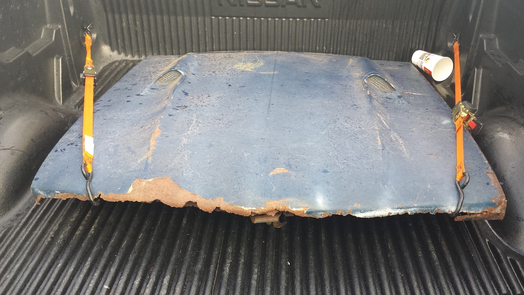

      Picked up a grabber hood. Front lip is rusted out, but not worried as I will be extending the hood by about 3"
