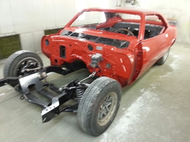

      Home from my friends paint shop today! The real fun starts now as I can get it back in my shop

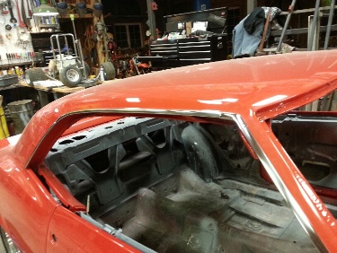

      Finally am getting some time to work on the car, Put the drip rail mouldings on tonight and they look great. My originals were in very poor shape. I decided to roll the dice and try some after market before trying to find some originals to work on. I'm pretty good at fixing minor dings and buffing stainless(I have a 2hp Baldor buffer) but it takes me a long time. Long story short I tried some from D&R Classic as they were advertised as new tooling and heavier then others out there. They fit very well, other then the corners, no good, or junk in my opinion. I spent the time to fix my original corners used them and the car looks great.

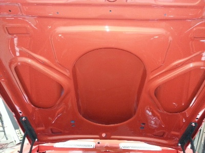

      You are right and the thought did cross my mind, In the end I decided to kinda go more the resto mod on the outside and inside of the car, and not so much on the engine and engine compartment. Besides I needed a reason for the tall hood and the high ram fits the bill for that, and as you said it looks bad ass. I have not seen to many (none in my neck of the woods) around so it is a little bit different then the norm. (still trying to decide what to do with hood hinges, using the original and old bolts for now untill I decide) Pic of the mod we did to the hood to clear the high ram. (the color looks funny in the pic, must be the flash, the color of the inner fender is what the hood looks like in real life)

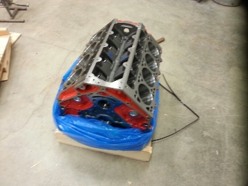

      Installed my first headliner. Went well and easy to do. Turned out perfect with no wrinkles, sags, etc. Tried a set of the Morris Concepts mirrors they fit very well and the quality seems first class. Door panels look very nice, but lots of work to get to that point. After market uppers junk! Went on ebay and bought some original uppers and then took apart the new interior and replaced with the originals, fit well then. I would not recommend new interior with aftermarket uppers. Buy unassembled interior and use original uppers. Vintage air install going well so far and am happy with the fit so far. Only complaint is the underdash vents could be of a little higher quality. Visited the machine shop check on the progress on my LSX block. Looking good. I'm looking forward to getting the block home so I can assemble and then install in car. Ordered my ecu today for the engine so I guess it's time to start wiring up the car.
