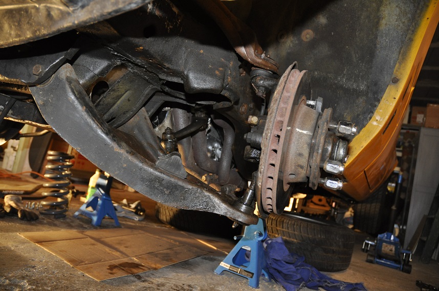

      more update,

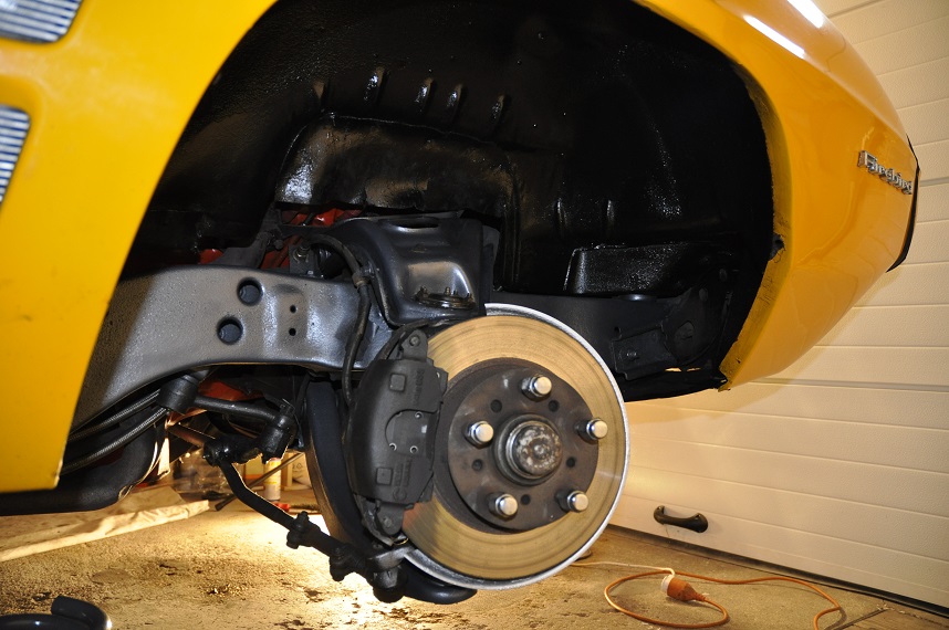

      Front passenger side is done, just waiting the ball joints boots to put it back together.

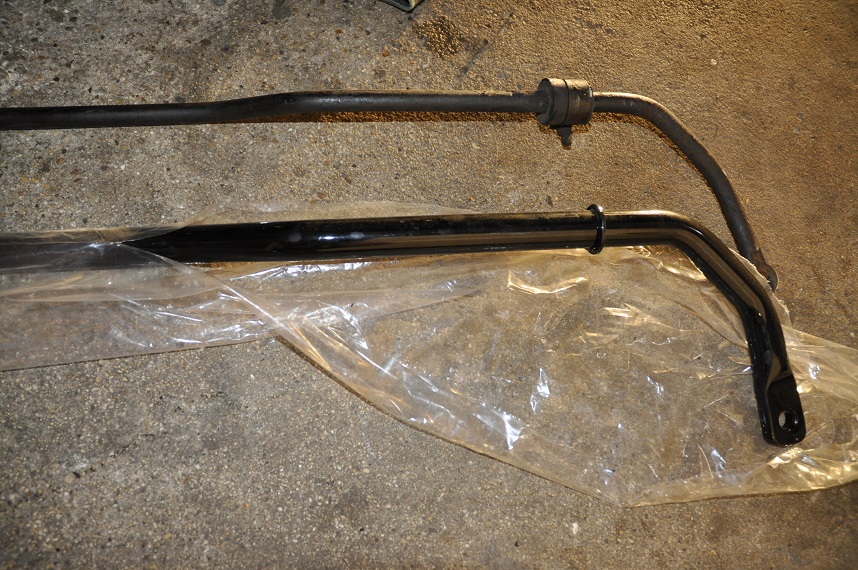

      Sway bars, old & new :
      Also started driver side. Ball joint is out, & spring and shock too...
      Need to clean and spray stop-rust & paint like the other side
      Have a nice week-end
      Gil

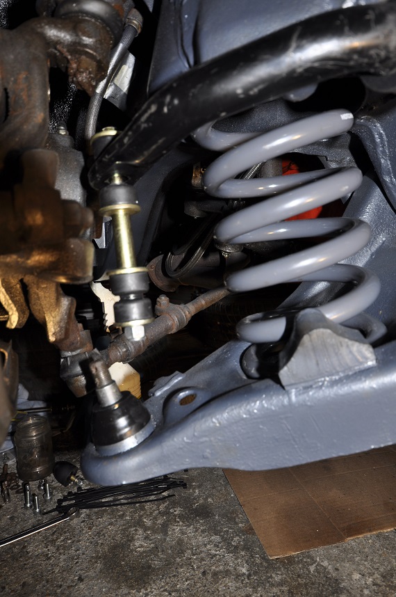

      Update for today :
      Both sides are done & sway bar is in place...
      Sway bar was a little pain to place... even with the lower arms down...
      I can't imagine doing it with the A-arms bolted... No pain, no gain... I did it, yeees !

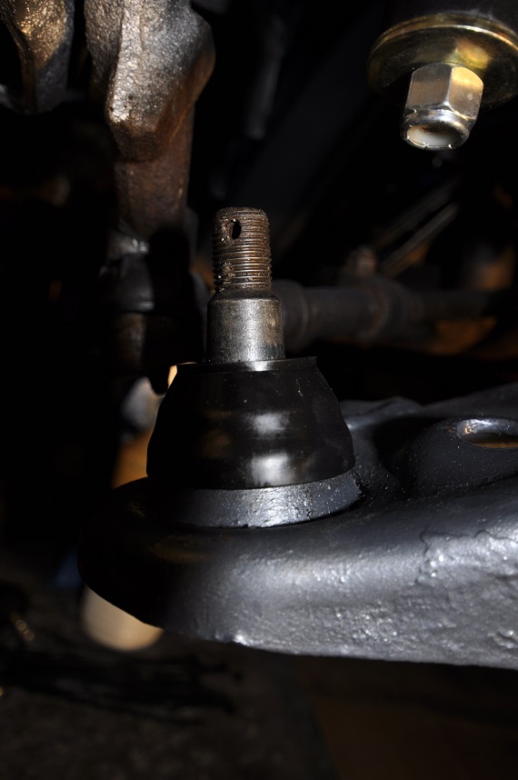

      Back from vacation, ball joint boots finally showed up...
      Pretty nice fit on factory lower BJ.
      Should be a roller again this week end.

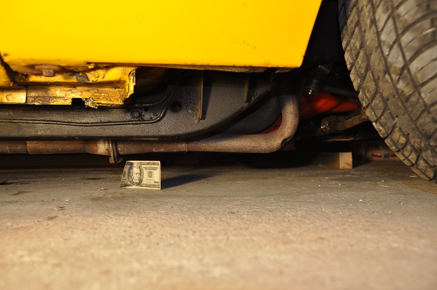

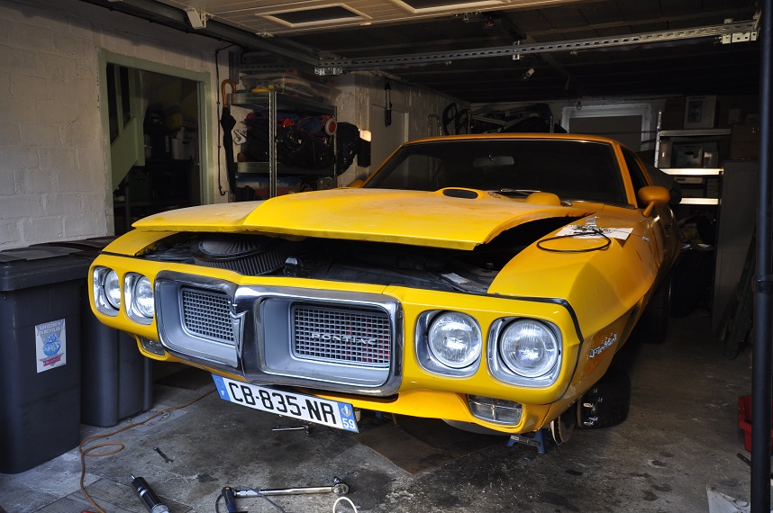

      Hi guys,
      She's back on 4 wheels !
      Here is the before & after ride height, think I won more than an inch.
      I'll took her for drive test next week & let you know.
      Have a nice WE
      Gil

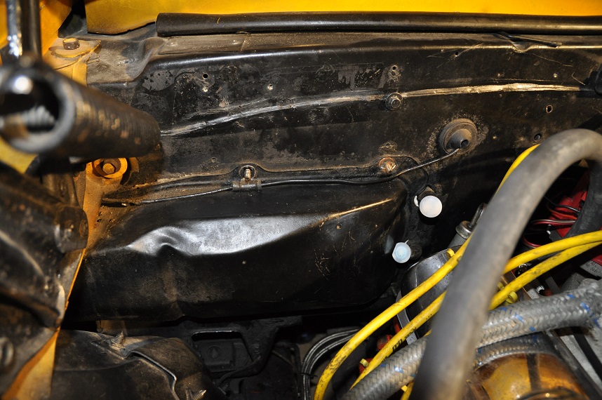

    19. #99
      FRANCE
      683
      Country Flag: France
      Replace heater core
      Quote Originally Posted by lucky13firebird View Post
      Nope, piece of cake... nothing has to come apart fender wise... if the blower motor is still good anyway. Ive done it once, theres six or so sheetmetal nuts on the firewall and the the whole heater box can be pulled off on the inside... if the cables are in the way undo them, and make sure to mark them. Theres three of them and an electrical connection, the box comes off under the dash and you replace the heater core, make sure not to bust the new one like i did (my motor sits back more than stock btw, thats what broke it) and connect the hoses and push the cover back on... connect the three control cables and the electrical plug and tighten up the six sheet metal nuts in the engine bay.... and enjoy your heat...
      OK, removed the 5 sheetmetal nuts I found on the firewall, 4 were easy, fifth was lower left, a bit tricky behind inner fender. ask your wife to remove it if you have too big hands.
      I'll shake the heater core box from inside the car tomorrow to see if it can be removed.
      Have a nice day
      Gil
    20. #100
      FRANCE
      683
      Ok, shook the heater box a little (not all night long),
      seems Ok to move but I'll have to be careful as I don't wanna break the plastic pins & heater core nozzles seems not Ok to come...
      I'll have to twist them a bit... will see that tomorrow.
      See yall
      Gil
