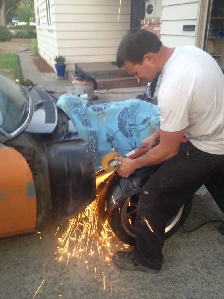

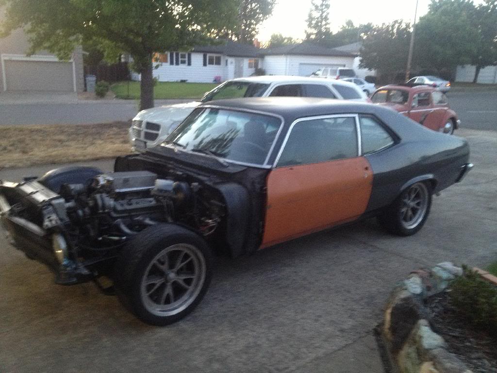

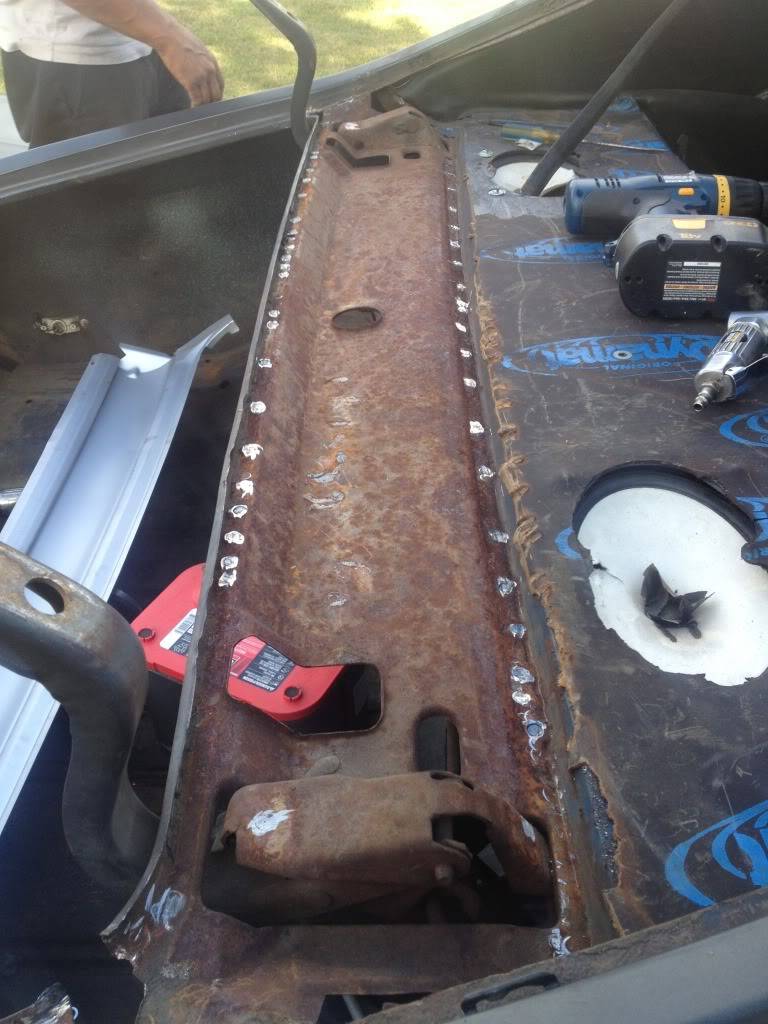

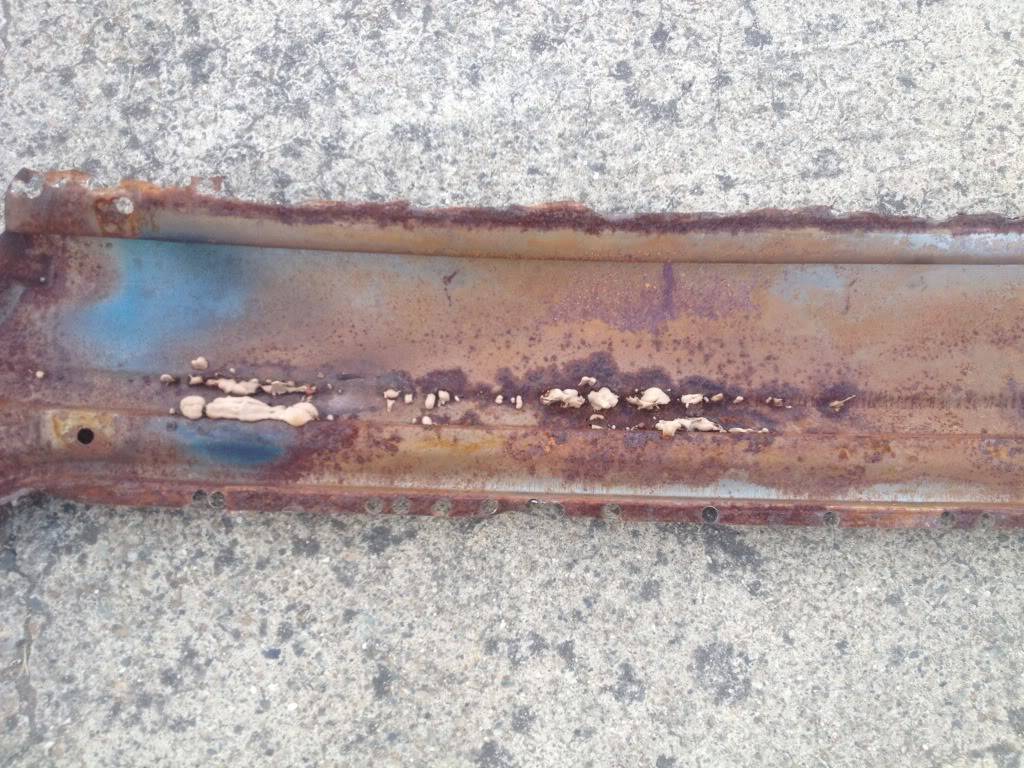

      Update time! I knew I had a little one on the way and so I tried to get a head start on the doors and some of the rust. The worst case of rust I knew had been in the rear lower window channel. I knew something was up because I kept on getting water in my trunk after a rain. After my second accident I decided to dig out the rear window channel and found a ton of rust, complete with gaping holes. Being 20, not knowing how to weld, but knowing how to use Bondo, I slicked a quart or more into the channel. It looked good, but never really kept the rain out. I took a trip up to my Ryan’s (novatrifecta on SNS) house in NorCal to wrench on the car do some panel replacement.
      Some of my handiwork…
      And the fix…

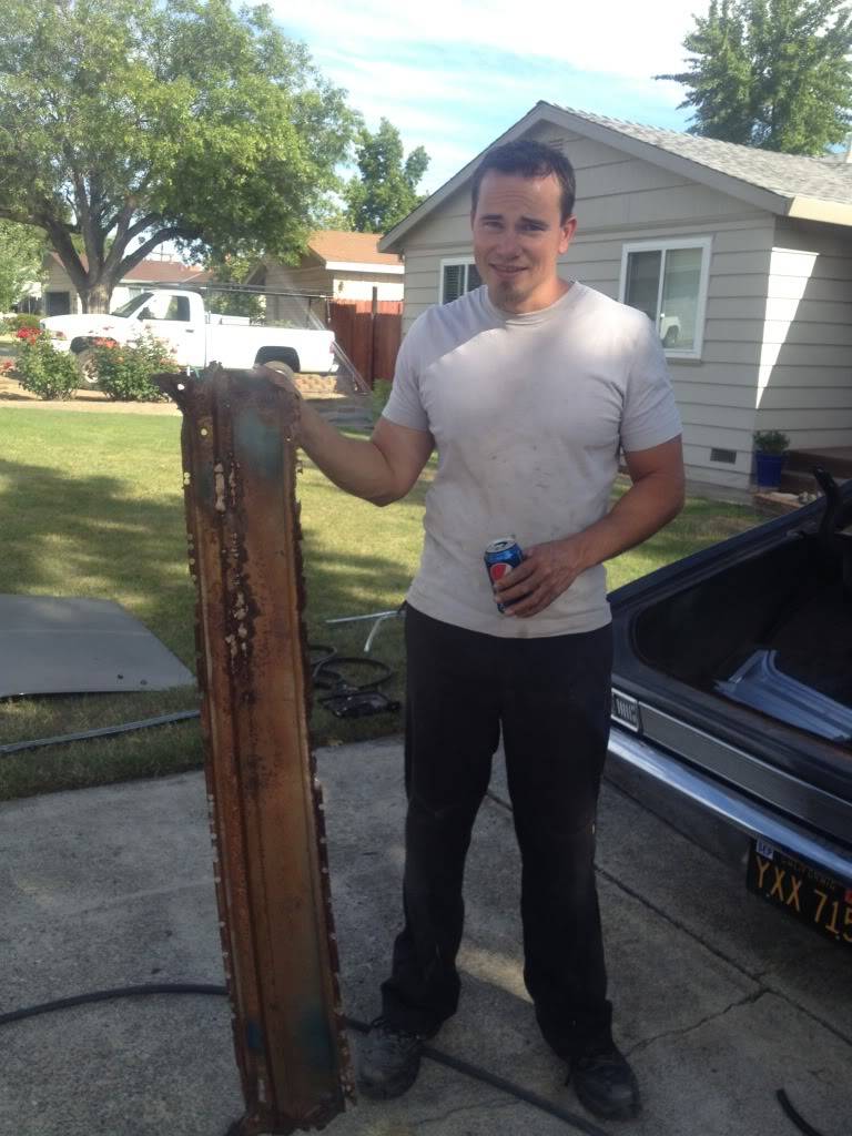

      No beer yet, we still had some cutting to do…

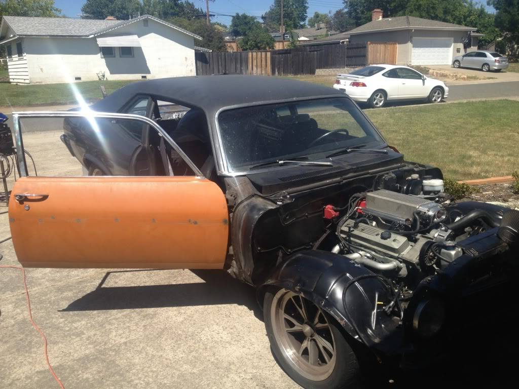

      We also took the time to yank my 69-72 doors and swap them for a set of doors I scored for free off a 1974 Olds Apollo. As you can tell, the Apollo was very orange. I will have the tan 73-74 door panels for sale soon, if anyone is interested.
      Drivers Side
      Passenger side

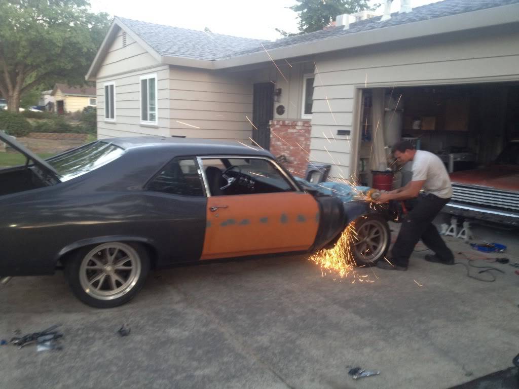

      We also did some front fender well trimming to make room for the 275/35R18s I want to put in there in this iteration of my Nova.

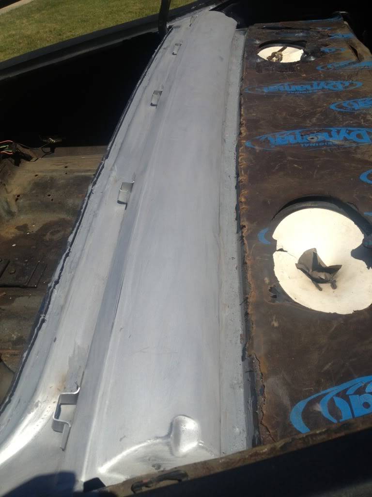

      I have spent the past month or so stripping the car and I should have some pics of that coming up very shortly. The car is way more solid than I had thought, but the quarters have been banged about a bit. More to come!

      Quote Originally Posted by Gil View Post
      Hi Don,
      Very nice Nova
      I'm 39 yo & didn't do the half you already did !
      But if you want just an advice, put some gloves & glasses when you use cut-off wheels. Security is longer time spent with the familly...
      Just my 2 cents
      Gil
      Thanks, Gil! That is actually not me; it's my friend Ryan. I have gotten too much crap in my eyes in the past, so I usually work with a 3M face shield. Funny you should mention this, Ryan's wife walked out while we were doing this and chewed him out.
