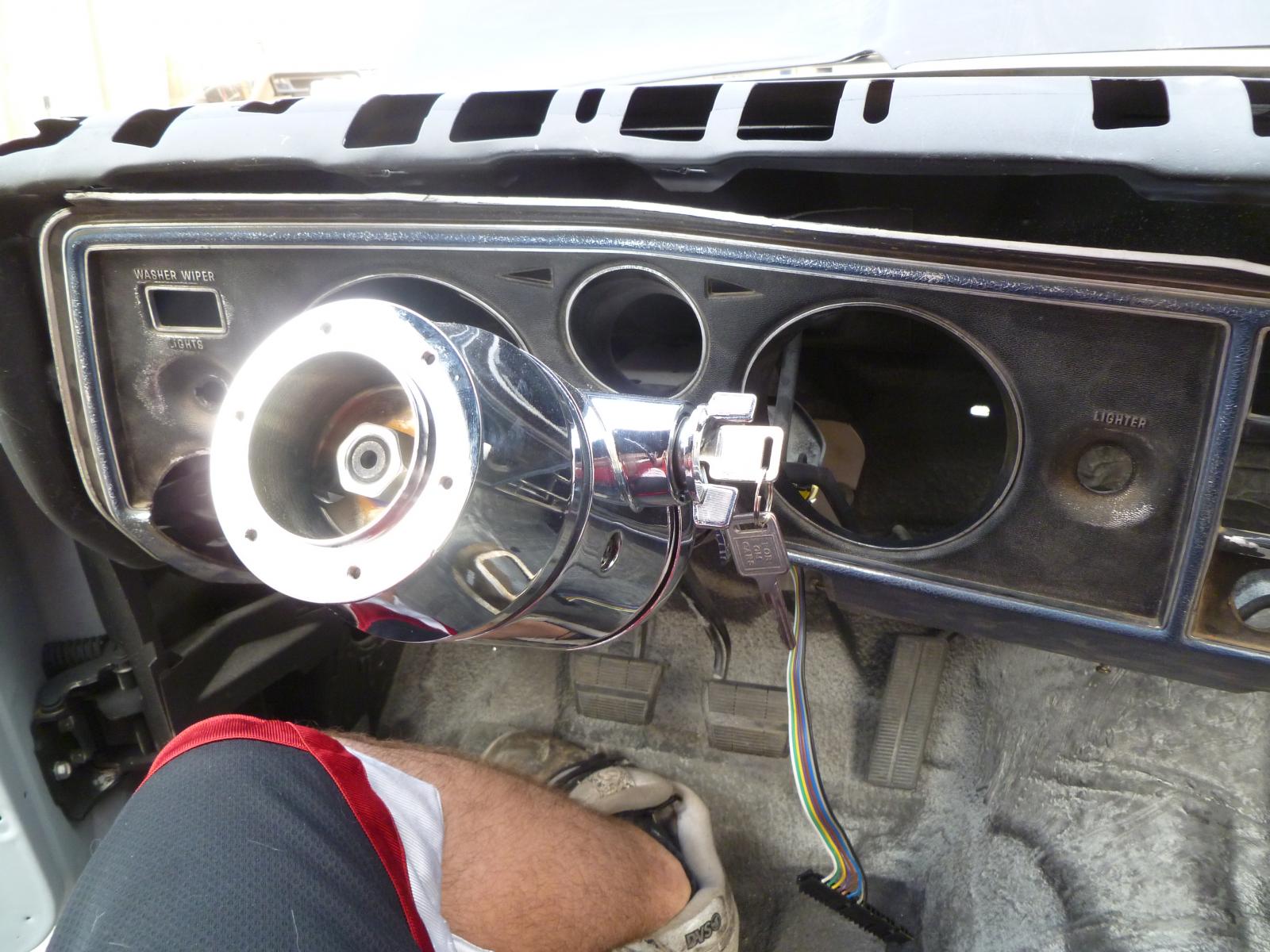

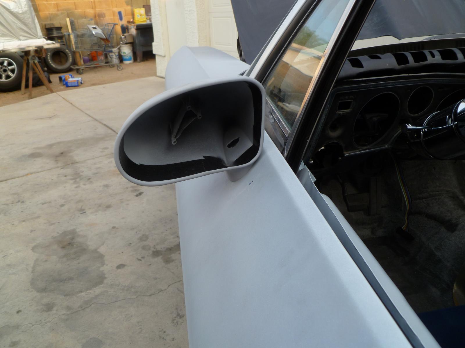

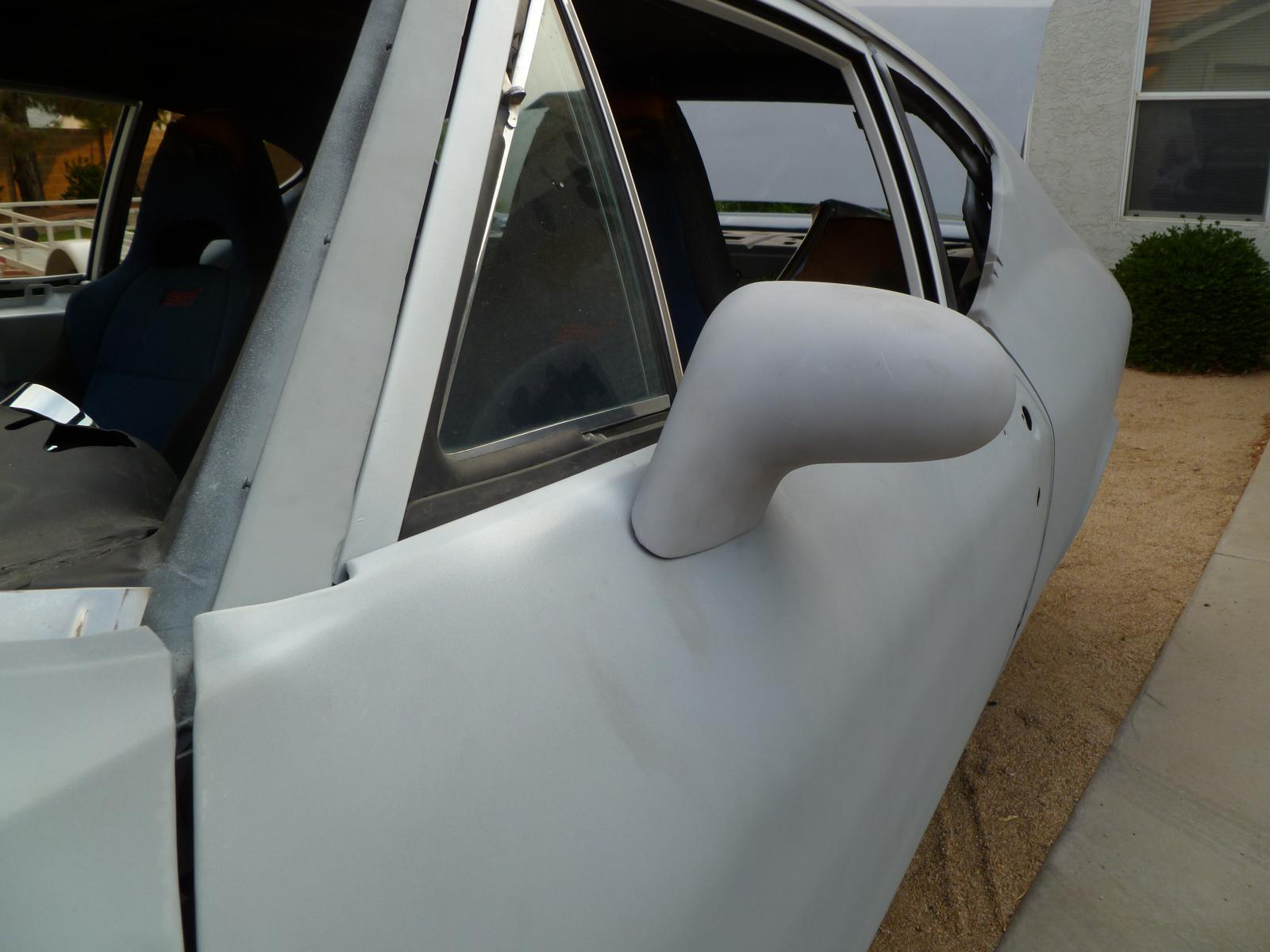

      Mirrors from a 90's Buick, they follow the curve of the body well, and the passenger side has convex glass so it is actually useful to see whats behind me. My brother broke the driver side, but the new one is sitting in a box in the shop.

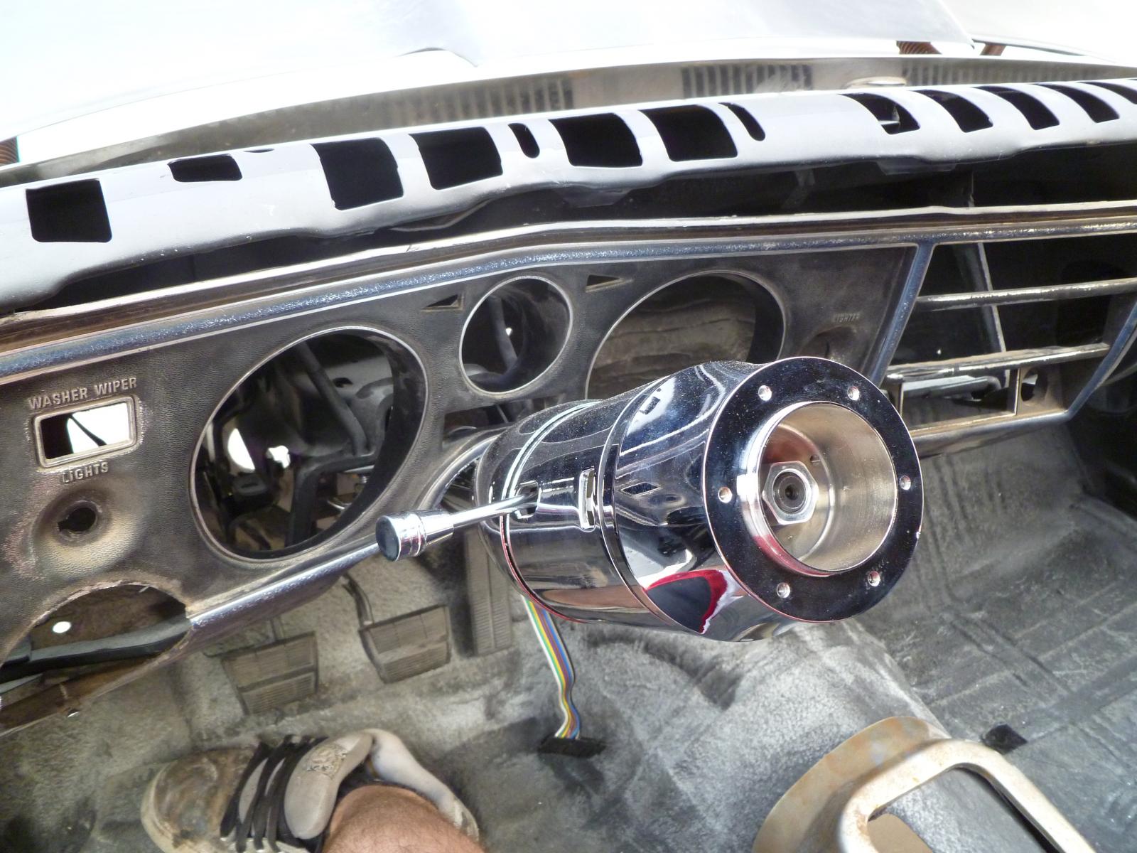

      The steering column is mounted so that when the body is on the frame the shaft can be built. I've got the Borgeson U-joints and shaft already, so I'm just waiting til the body and frame are together again. And depending on the look of the interior, I may paint over the chrome if it will stand out too much.

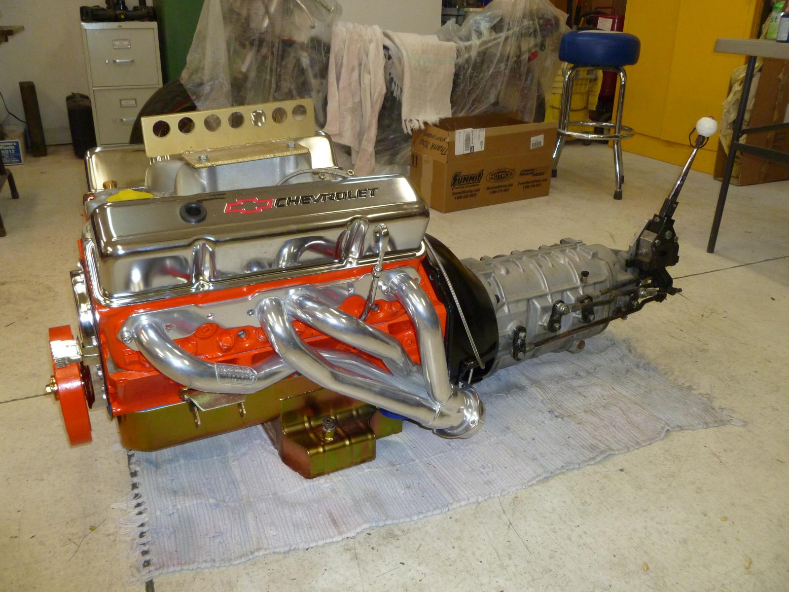

      Engine Time!

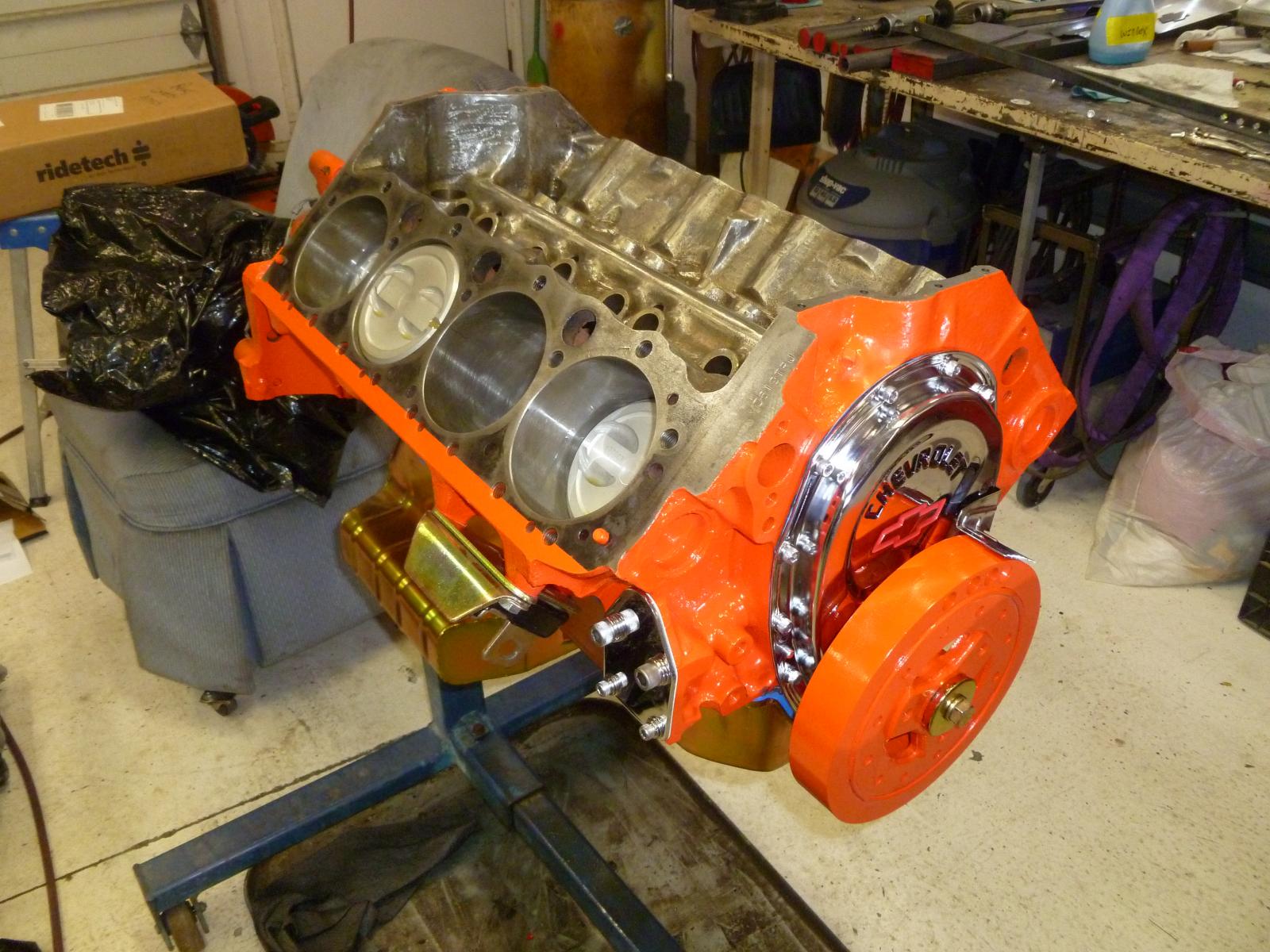

      Been a while since I had some updates, but work is progressing. I've started a new job recently, so I've been dealing with a new work schedule for the first time in 3 years.
      The roll cage for the car is going to be built this week, so the body is on the frame again. We got the steering hooked up and are going to drag it down the street tomorrow. so work will commence on that.
      But the past couple of days have been good! Got a Richmond 6 speed on the way for the car, the clutch showed up, and the engine is assembled finally!

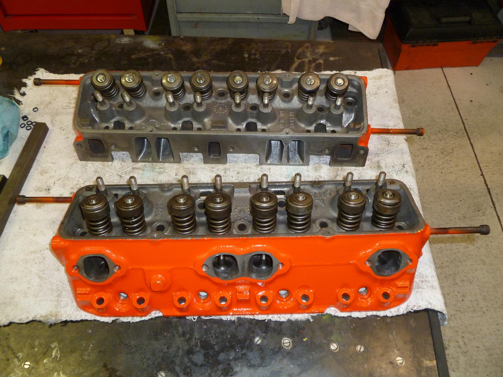

      I took time to polish the lifter valley in the block as well as the ports in the heads.
      Looks pretty good in Chevy orange and Chrome ;)

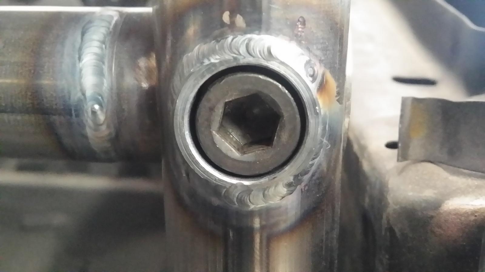

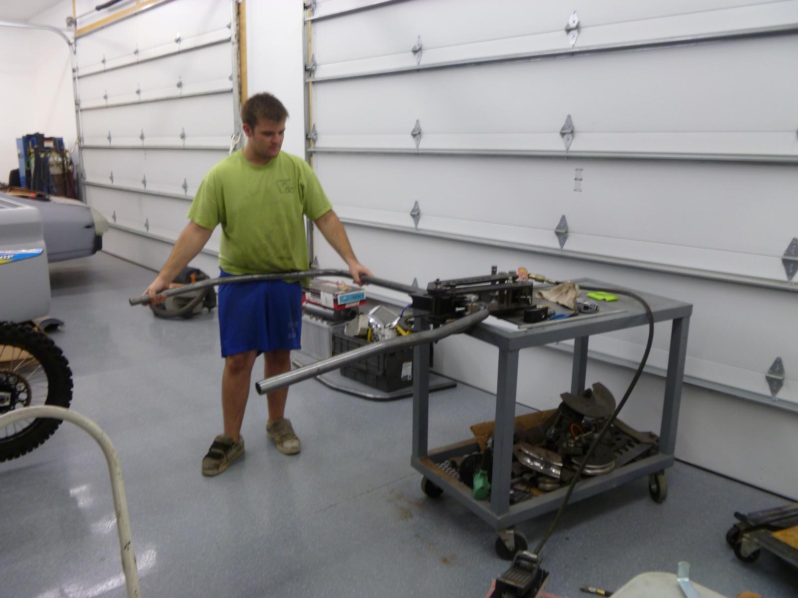

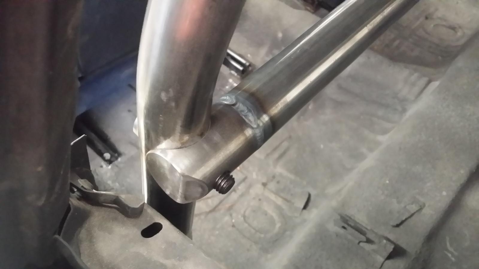

      Roll Cage!!
      Spent the past few evenings getting the roll cage built! Looks pretty good!
      I wasn't gonna push the car, luckily he had a rhino
      Bending the hoop
      All done
      Here's what we came up with to make the harness bar removable

      Nelson that cage came out really nicely. Thats a good idea to do the plug on the removeable door bars rather than have a stub sticking out to catch your shoulder on.

      Quote Originally Posted by pist0lpete View Post
      Thanks! That was my friend's idea, he's really good at building things like that. The only thing that my dad wanted from the cage was to make sure that getting into the back seat was still easy, and it works good!
      Nelson

    16. #56
      Oct 2006
      Stillwater Oklahoma
      183
      I meant to say harness bar not door bar but either way its slick.

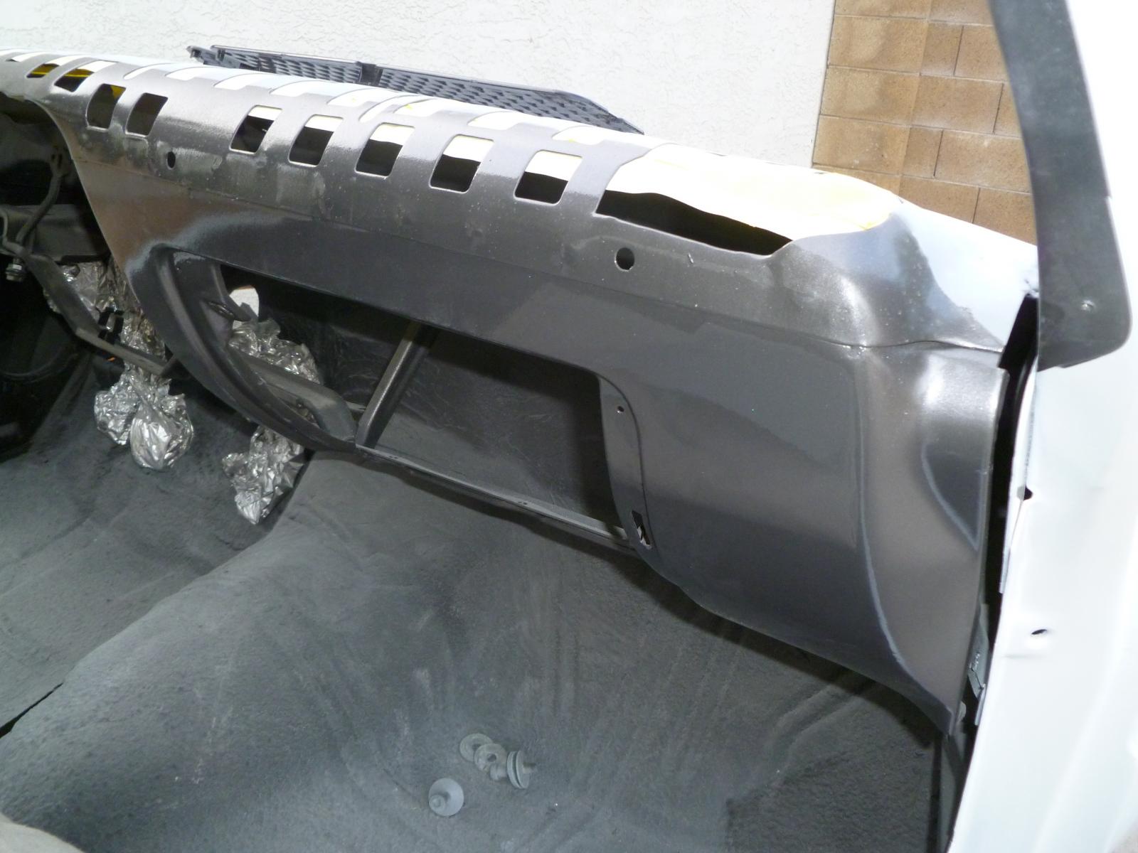

      Progress Update
      I spent some time painting things on the car including the dash, roll bar, cowl, and door jambs. The dash and roll bar are a grey called "Dark Argent".
