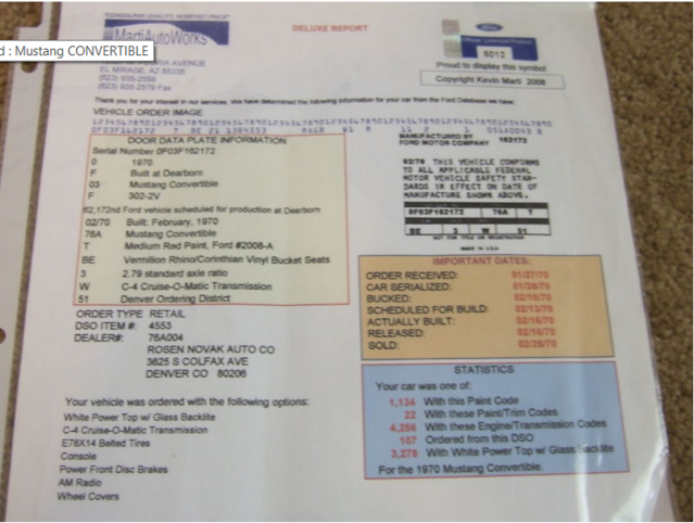

      So here she is in all her glory. Originally sold in Denver, it made its way to Washington state at some point and I bought it off of eBay and had it shipped 2000 miles to my house. From the pictures, I didn't think it look too bad for a $900 car. However, the car was completely stripped of everything when it got here.

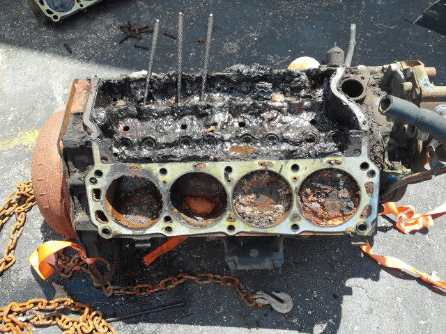

      The engine that came with the car turned out to be junk so it made its way to the scrap yard. Had three cracked cylinders so there was no point in repairing it.

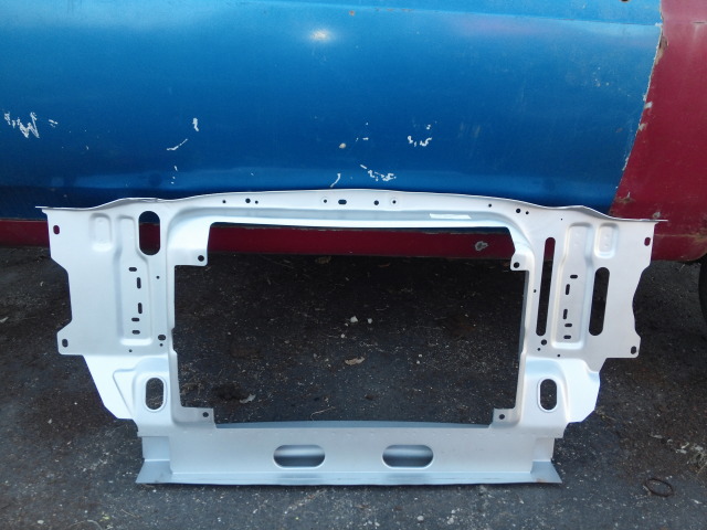

      I started collecting some parts here and there over the past few months. I've gotten a hold of a pair of hard to find convertible quarter extensions over the summer. I've bought new fender aprons, door mounting plates, a picked up a new radiator support from Kentucky Mustangs at the swap meet last week.

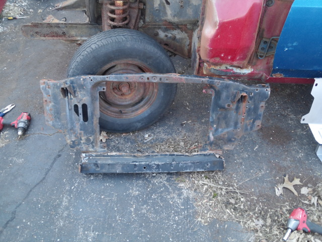

      I looked for some pictures of cutting out the aprons but I can't seem to find them on this computer. Long story short, someone replaced the original aprons and core support to a '68 style. Maybe that's all they could get at the time but it caused everything to not line up properly with the fenders and everything else.

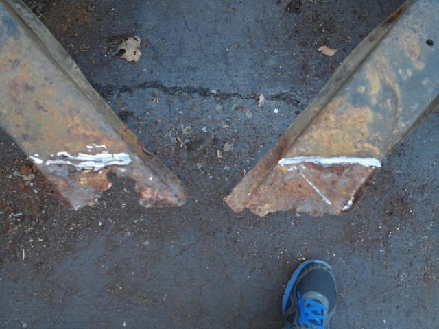

      I did get some time to work on the car today taking out the radiator support. It wasn't easy as they butt welded everything together instead of using rosette welds. I don't think they cut out the original support using a spot weld cutter because the strut rod brackets look like they've been cut with an acetylene torch. So we've got to get a new pair of those as well.

      Wow, only 22 with that trim/paint code.

      I hate red cars but love red interiors. I think I'll keep it with the original colors just because it was so freaking ugly but kind of cool at the same time. lol
