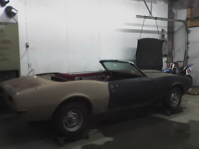

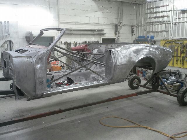

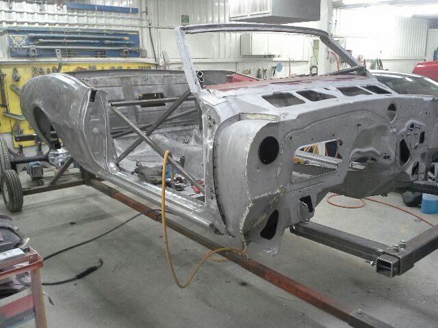

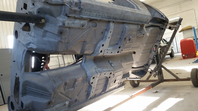

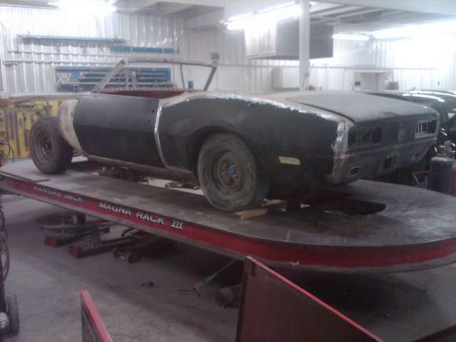

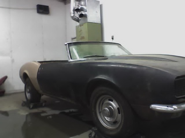

      Well after 9 years, my project is finally on its way. After a few setbacks ,thoughts of selling, and changing my mind on what way i should build, i stumbled onto the ProTour site and well i was hooked. The wondering on how i should build was over, and the research (lots and lots) began. Thanks to this site and its many members threads, many decisions have been made a little simpler. I realize my project is not ground breaking in any way but to me it is a life time dream coming true,so, here are a few pics of my start, and more to follow as i have time to post. These are when i got her home a long time ago. She is now at my friends body shop and is progressing nicely.I will list my plans for the build and a lot more pics later .
      Name:  16-11-05_1901 - Copy (2).jpg
Size:  39.9 KBName:  16-11-05_1905 - Copy (2).jpg
Size:  38.7 KBName:  16-11-05_1900 - Copy (2).jpg

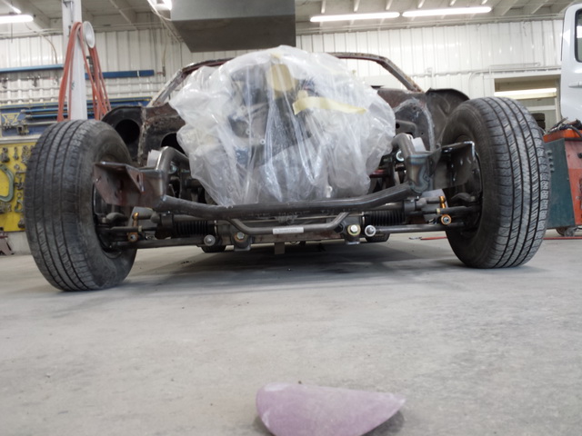

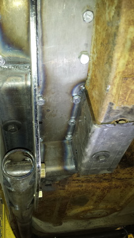

      -some pics of TCI test fit:,(BOLTS ARE NOT FOR FINAL INSTALL JUST FOR ASSEMBLY)

      Nice start. How is the fitment of the TCI torqe arm?
      A day late and a dollar short!
      Feb 2013
      Saskatchewan, Canada
      157
      Thanks,the torque arm fits great but in the pic the pinion angle was not set yet, my main goal is to have all holes drilled and make sure stuff fits before media blasting the body.

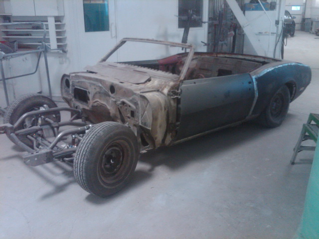

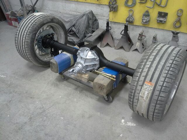

      Well ,small update, suspension on, and off lift, PRO RAT anyone? Paint and body work really are important, lol.
Size:  89.1 KBName:  IMG00981-20140220-1812_resize.jpg

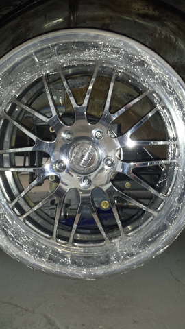

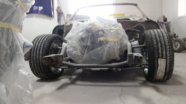

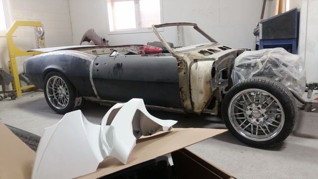

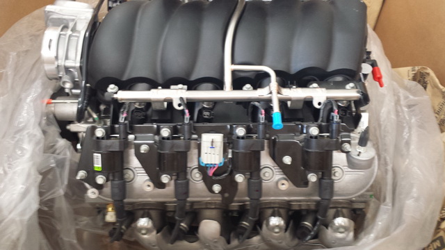

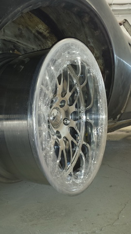

      Some small progress,received engine ,trans , components ,so time for some test fitting.......yup wrong oil pan was sent so i had to reorder pan and install it later, while test fitting motor trans had to open up the trans tunnel to make it all fit in its proper place,but i am happy with the final fit. Rims also came and they will be fine.i was very happy with the way the rims looked so i guess its time to get on with the rest of the body work. i cant wait until i can put on parts and leave them on. oh well i am enjoying the process.
      Feb 2013
      157

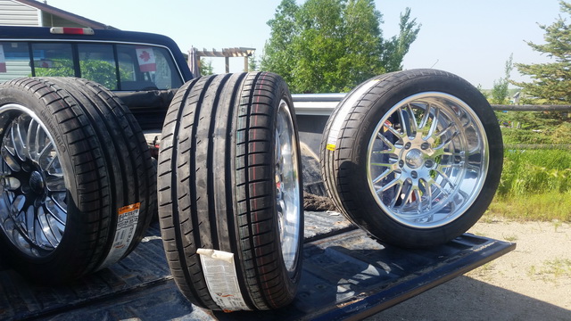

      Received new rubber ,Continental dw , tried them on for looks and i am really happy with the results .

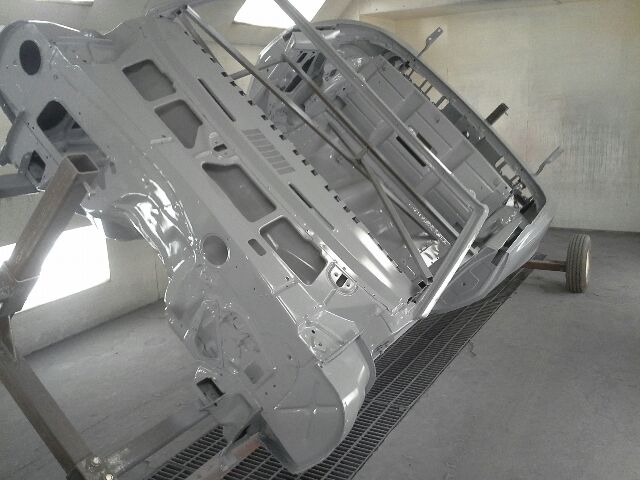

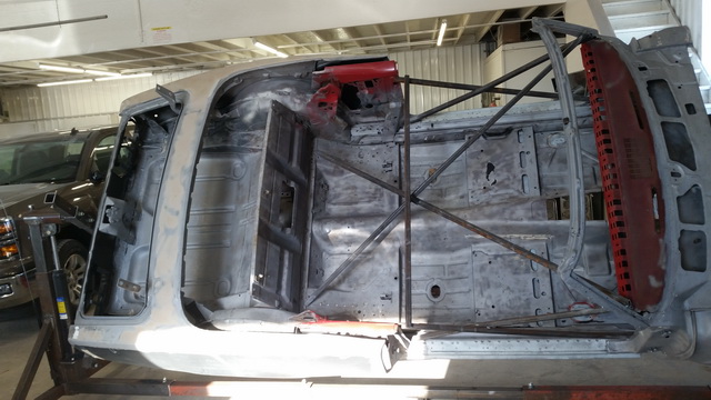

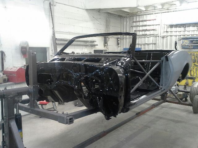

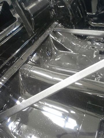

      Some more progress,a little light at the end of the tunnel.
      Thankfully while blasting I never came across any holes or lurking demons so I was very pleased. Only thing that didn't work out was the bags of soda blast didn't arrive on time, so I left the dash and side interior arm panels to be scuffed by hand.

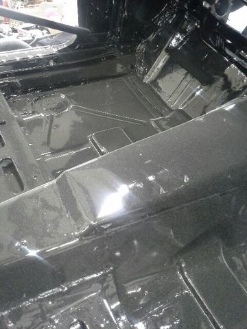

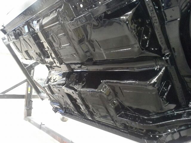

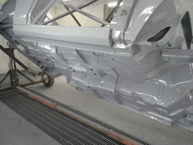

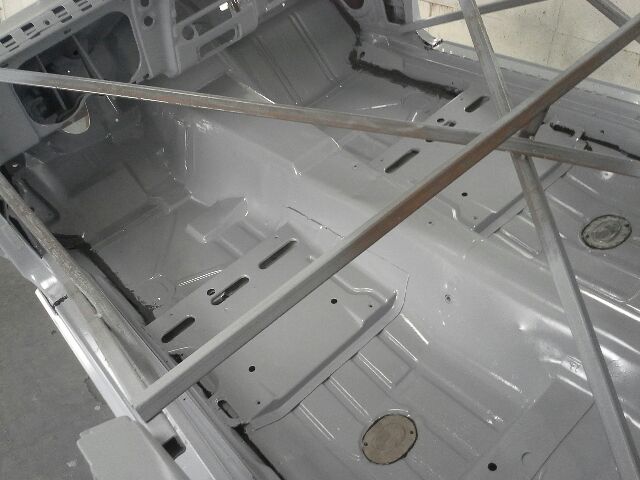

      And yes........PAINT,well at least on the underside and interior.

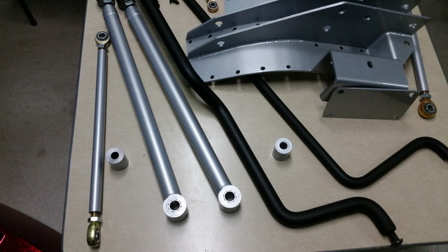

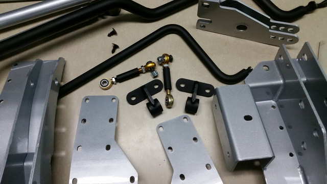

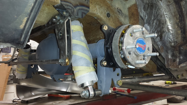

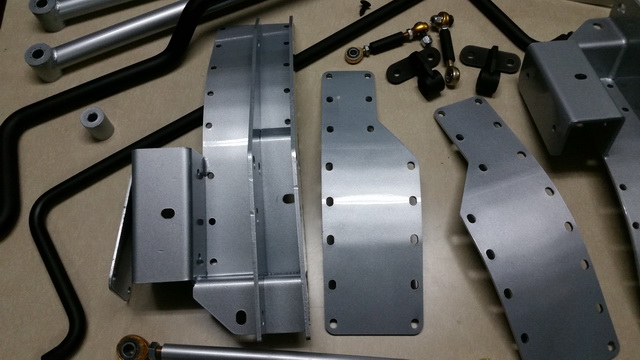

      Not all suspension parts are finished being painted yet, but here are some of the rear torque arm bits..
