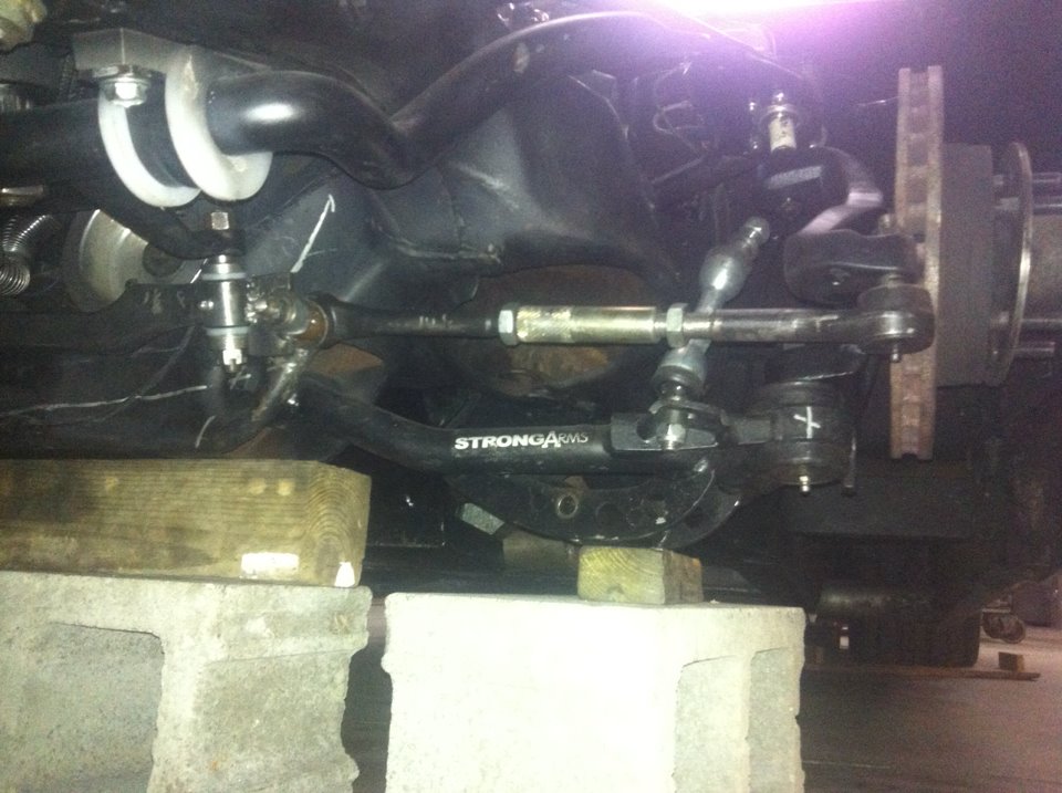

      Front Suspension:
      The front suspension is S10 based with a combination of aftermarket and stock style parts. It’s a basic stock style 2” drop spindle, with a larger stock style 33mm sway bar from a newer model and ridetech PosiLinks.
      The tubular upper control arms are from a swap meet and apparently were designed for a metric dirt car, but have been modified. The upper arms use Allstar Adjustable ball joints adjusted approximately 1” from the tallest setting.
      The lower control arms are ridetech StrongArms with the standard Moog ball joint.
      The upper spring pocket has been removed to fit a 4.1” stroke RideTech Triple Adjustable Coilover with 4.1” stroke (10.125” compressed & 14.225” extended) running a 10” tall 2.5” ID 450 lbs/in spring.
      I believe that my front suspension might possibly be considered a “Tweener” set up or at least it might be possible to set it up as a Tweener. Taking actual shock travel measurements at an event or by simulating event conditions is a priority once the weather is better. But for now I can only estimate based on videos and jouncing the front end that my front shocks can compress about 2.5-2.75” under heavy braking and are nearly bottomed out when the front cross member scrapes.
      I typically shoot for about -1 degree of static camber, 0 toe in/out, and according to the FasTrax Adjustable Caster Camber Gauge I can currently register about 8.5-8.6 degrees of caster.
      I am also battling a relatively high scrub radius due to my 17x11” wheels with just 4.25” backspacing. Using the method in Lance’s thread, I measured the scrub radius at 4 13/32”

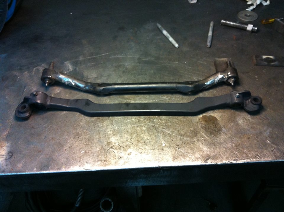

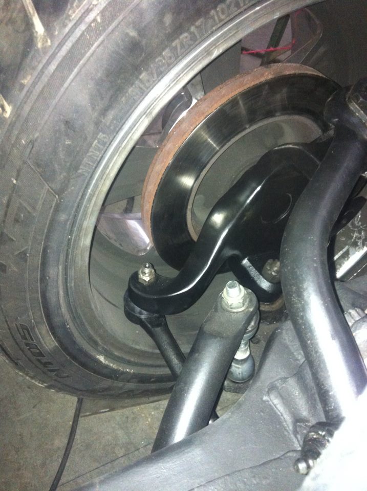

      The S10 spindle steering arm geometry has always annoyed me because it’s front steer and the arm is actually angled forward toward the centerline of the front of the frame because the tie rod must clear a tire (for small diameter stock style wheels) or in my case the wheel itself. Moving the tie rod end outward any further will require shortening the steering arm at least an inch or two so that it can clear the rim lip and barrel, but I have not quite been able to determine whether this is feasible or not. I have a 12.7:1 Grand Cherokee steering box. The stock spindle steering arm has a flat base at the end where the tie rod end mounts, but there was room for moving the mount back slightly, which effectively shortened the arm with good results.

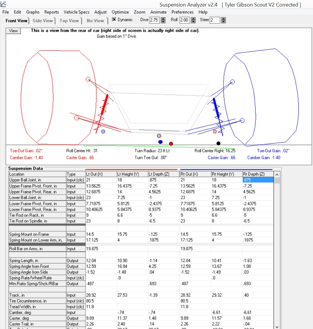

      After reading the mapping instructions, and then rereading them again, my dad and I spent the better part of two days developing creative ways to map out the front suspension. There were small, but mostly consistent variations side-to-side, but we double checked each measurement and/or checked against a different measuring method in some cases. I have those measurements in a spreadsheet. Thus, if possible, I would like to set and tune the front roll center height.
