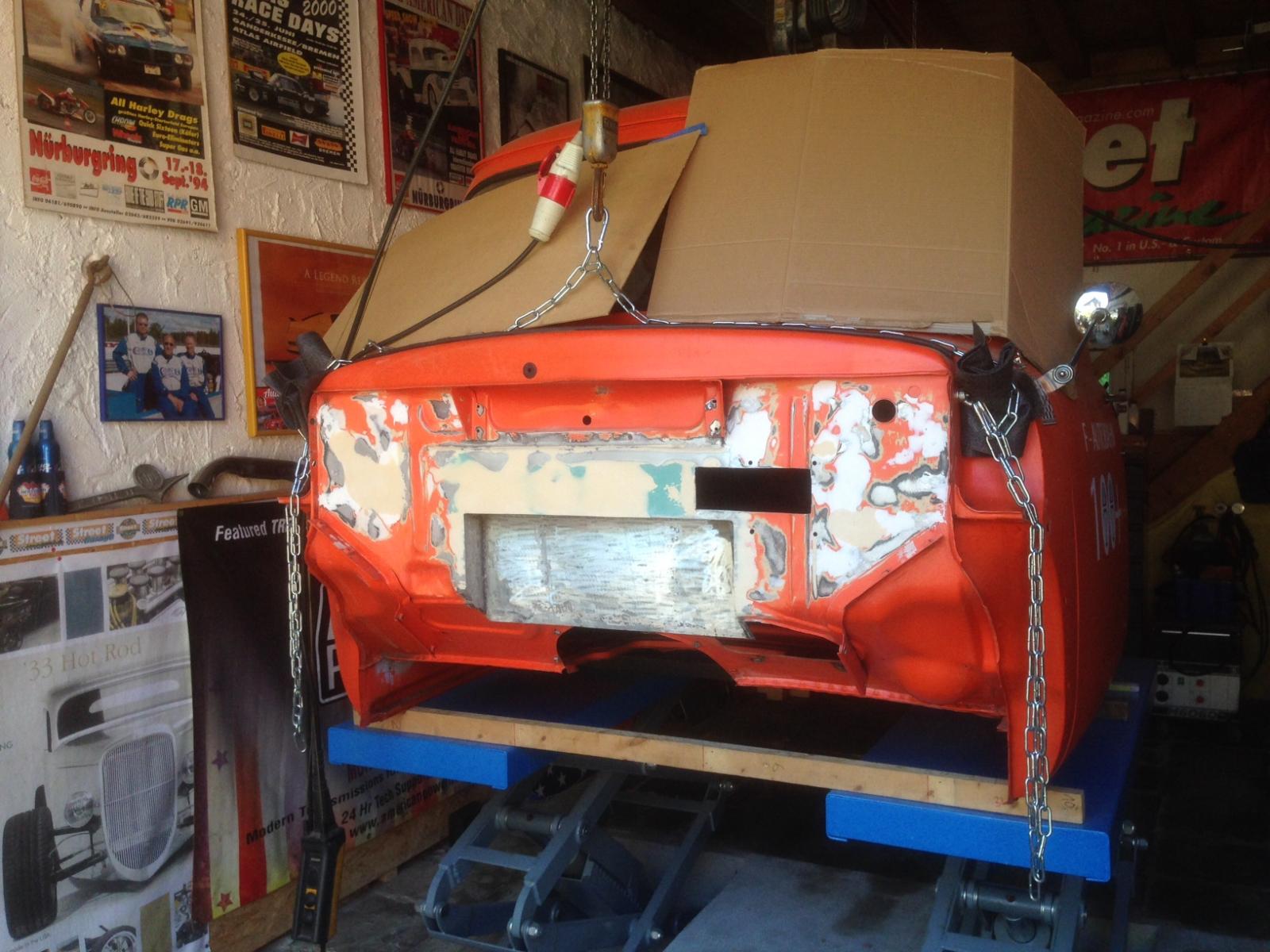

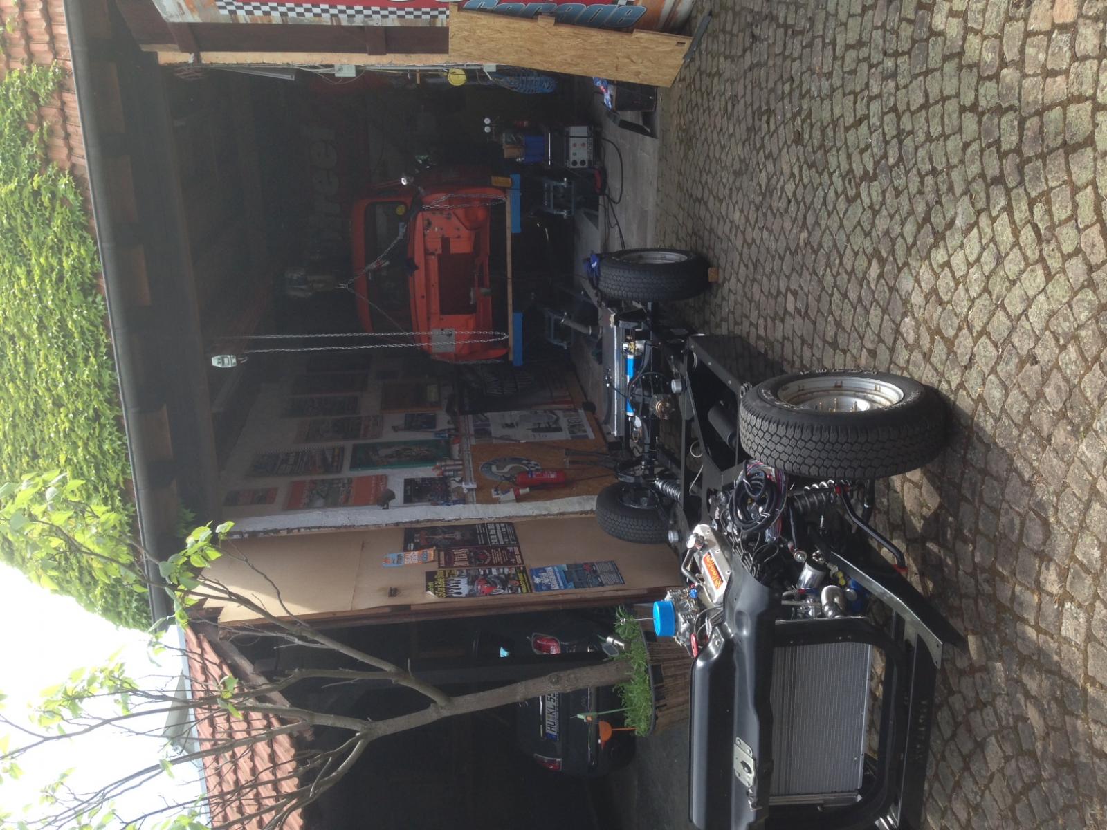

      Sorry for staying radio silent for the past 9 month or so. Business kept me away from my project, but I am back now. The body went off and on a few times. Finished the fire wall mod. Seats are in the cab. Steering is done. Had to get another set of headers as the Sanderson headers would not clear the steering. Exhaust is welded, but needs to be taken apart for coating. Drive shaft installed after changing the yoke. Axles are in the full floater rear end. All fluids are in. Just last night I did the bleeding of the brakes and the hydraulic throw out bearing. Now working the wiring, gauges and all the electrical stuff.

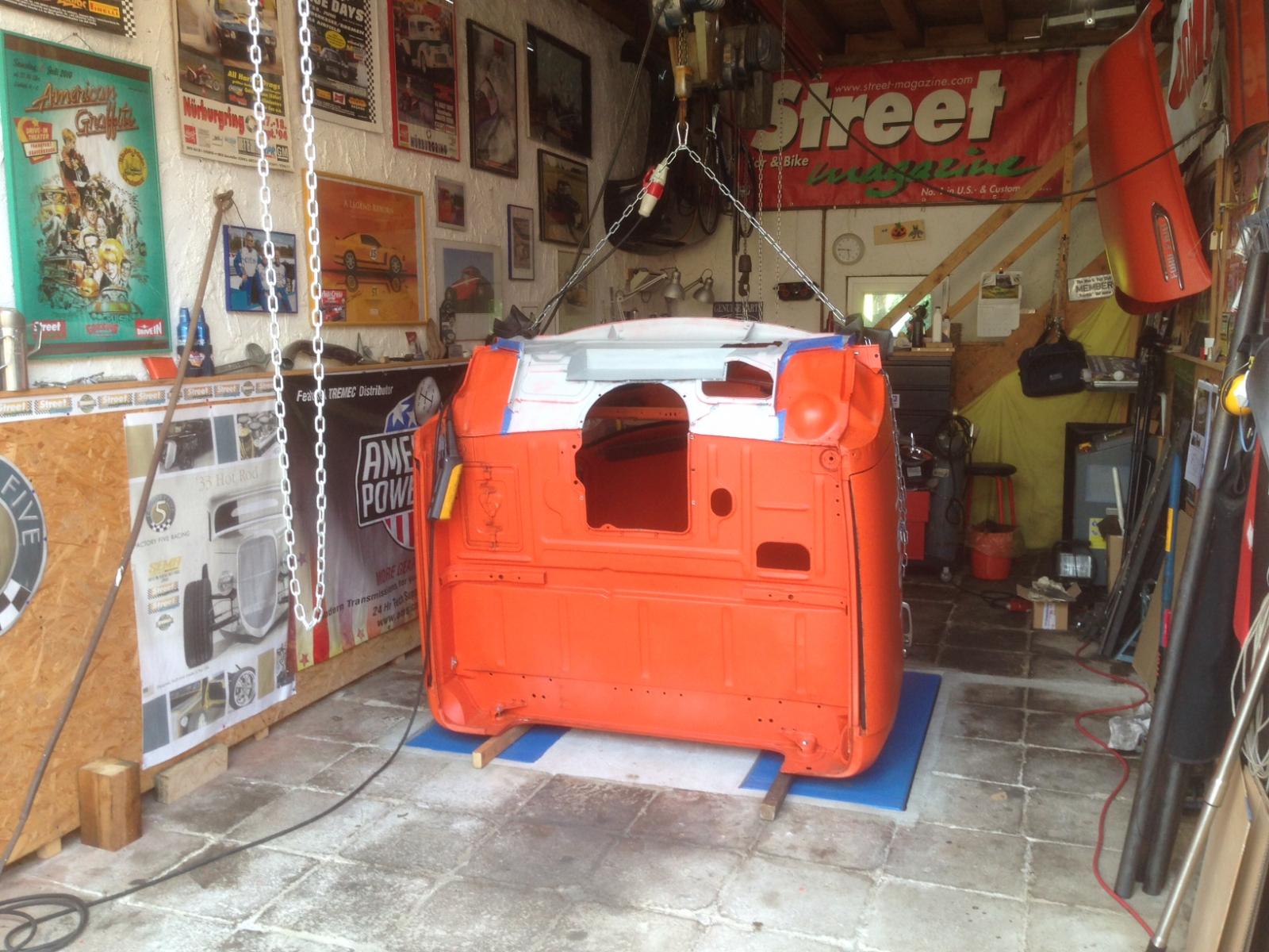

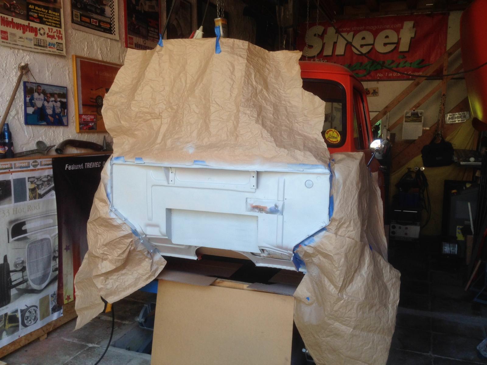

      Since I have moved the engine back as much as possible, I had to cut the firewall. Bought an aftermarket firewall, but decided to cut only as much as needed and build my own. These photos show how much. Just enough clearance to get the valve covers off.
