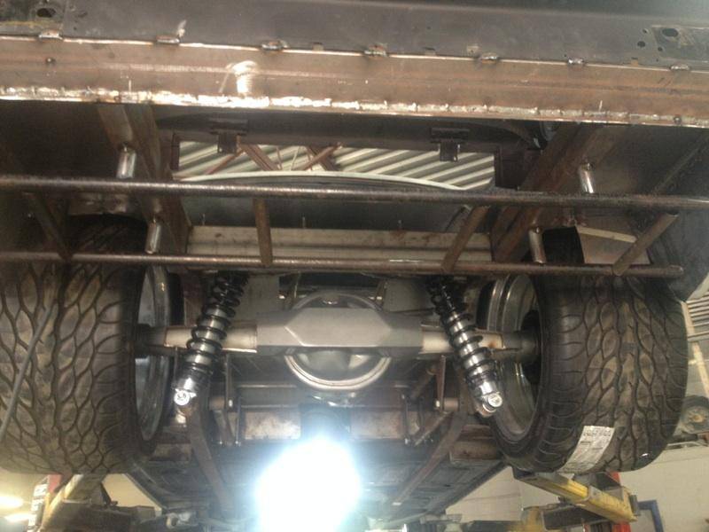

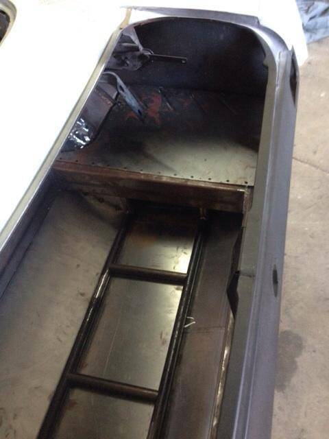

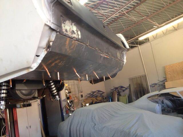

      Made a little more progress. The AME rear clip is going in. The car had a R&C coil spring setup in it when I bought it so we swapped it over to coilovers.

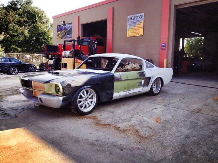

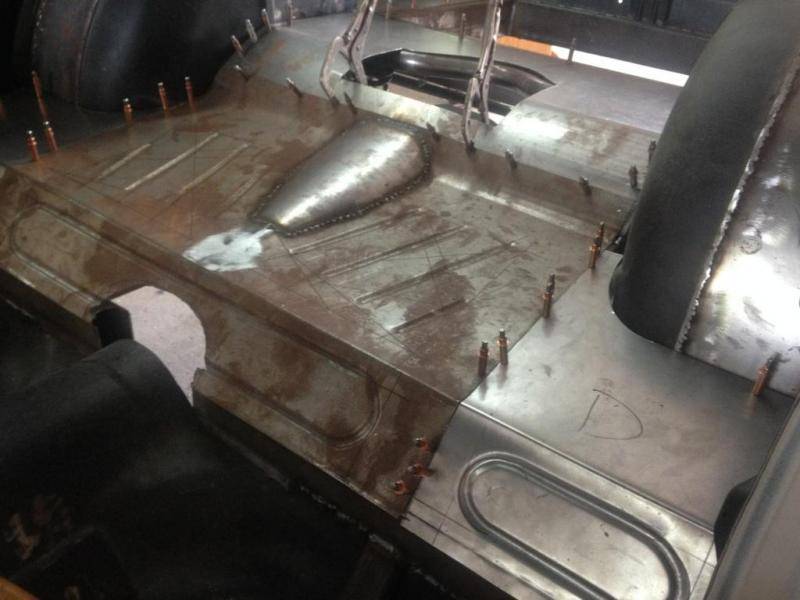

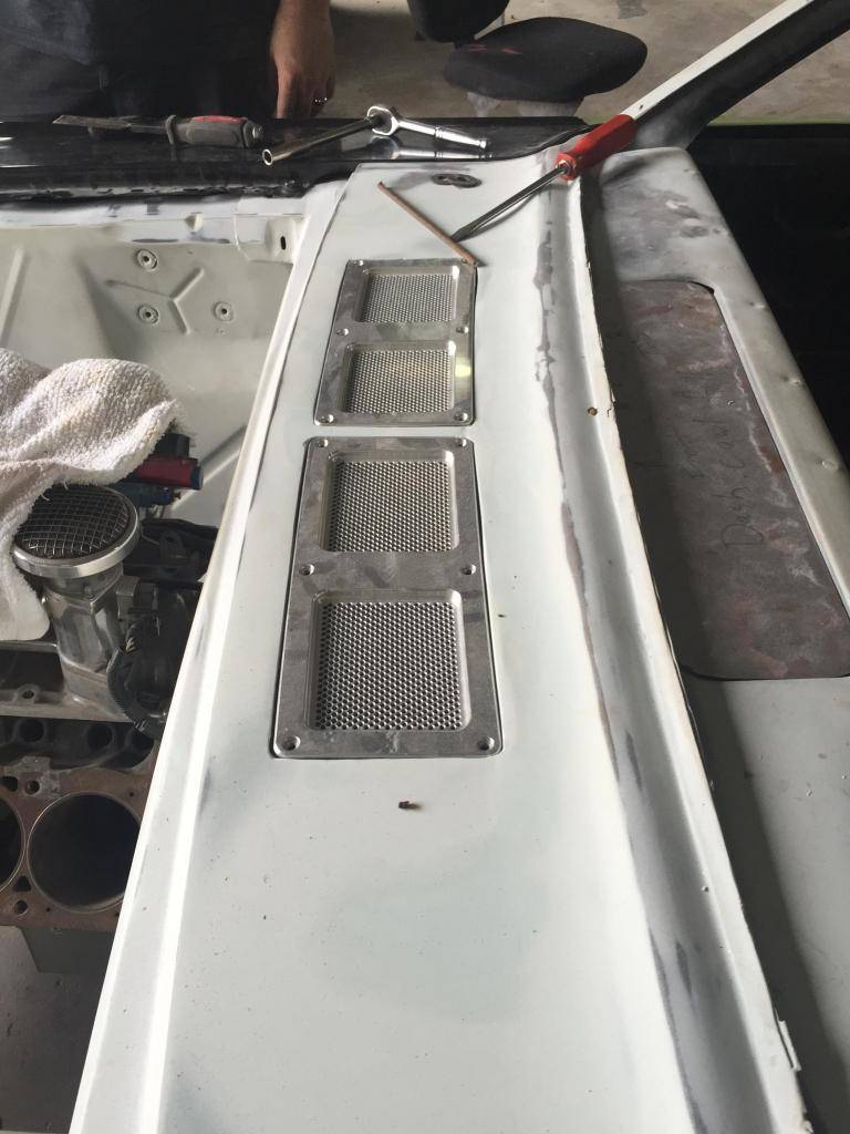

      It's been awhile so thought I'd throw some progress photos up...

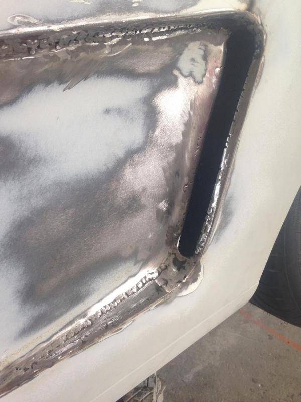

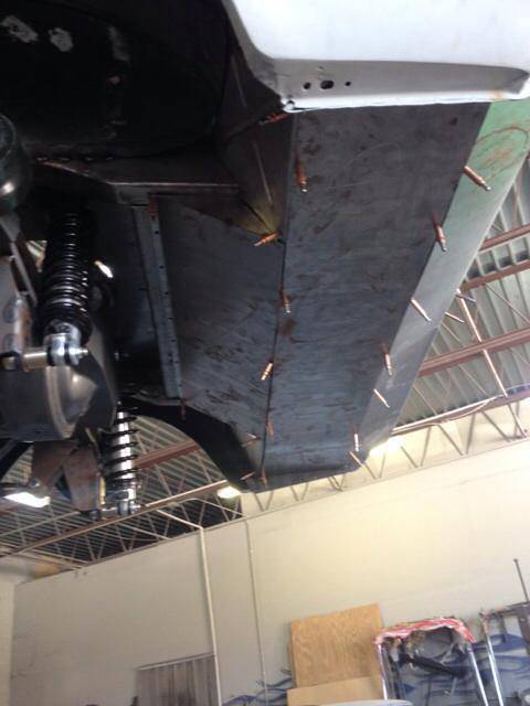

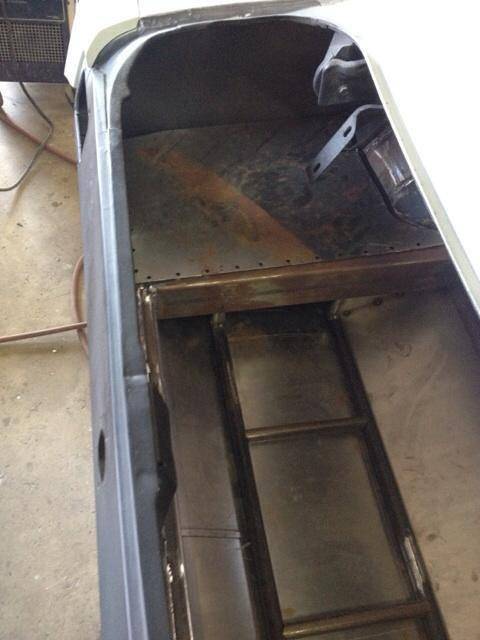

      The AME rear clip is finished up and started on some of the sheetmetal around it.

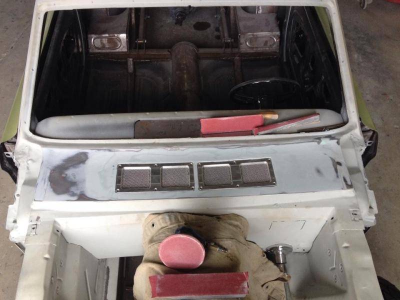

      Roughed in some rear air ducts...
      Got the cowl finished...

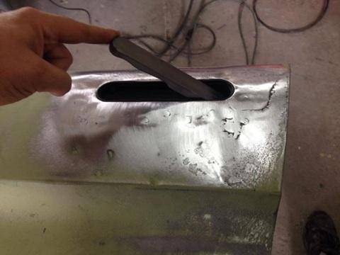

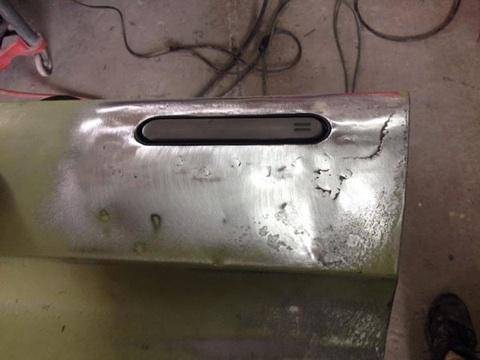

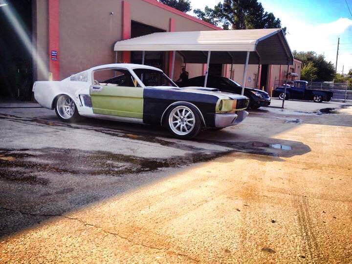

      Next, the door handles are roughed in....

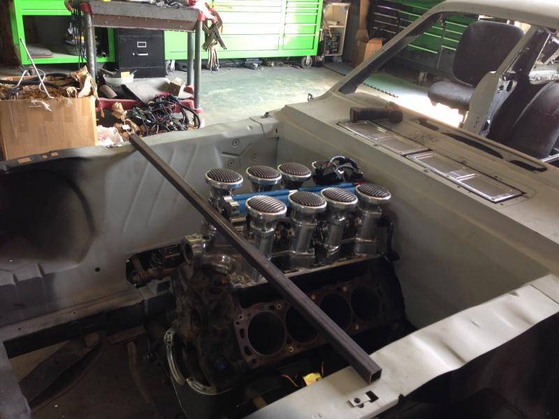

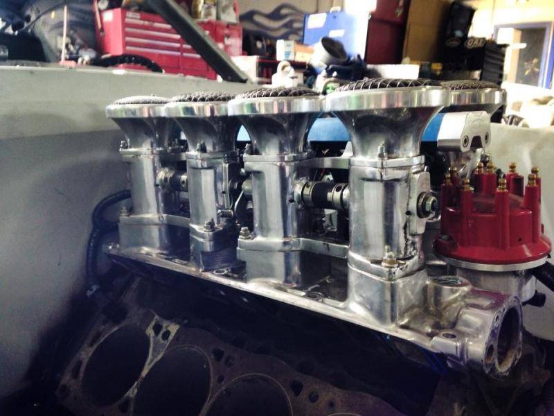

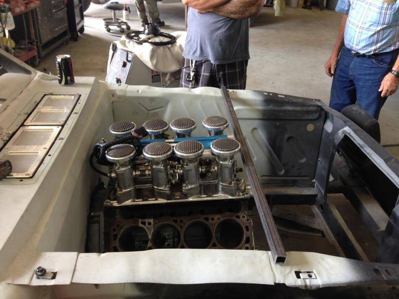

      Mocked up the engine and set it back a few inches...

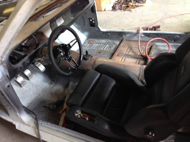

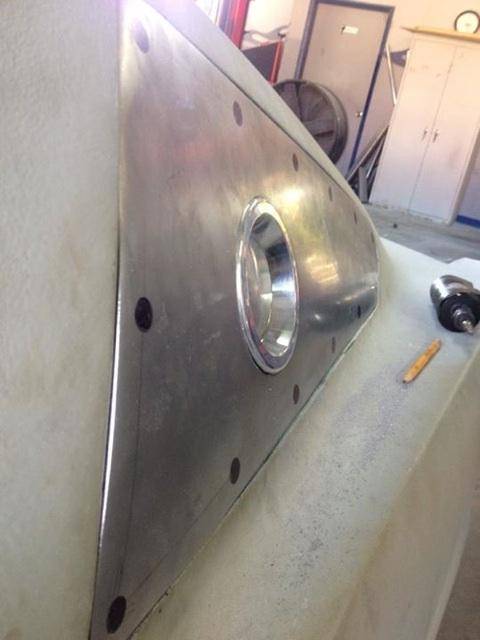

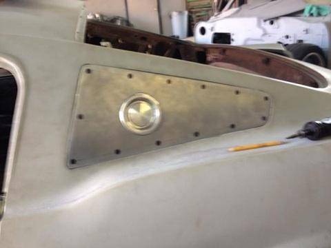

      Got the pedals installed. I still have the drivers seat at the house working on the control panel so we set the passenger set in just to get a feel for the set up....

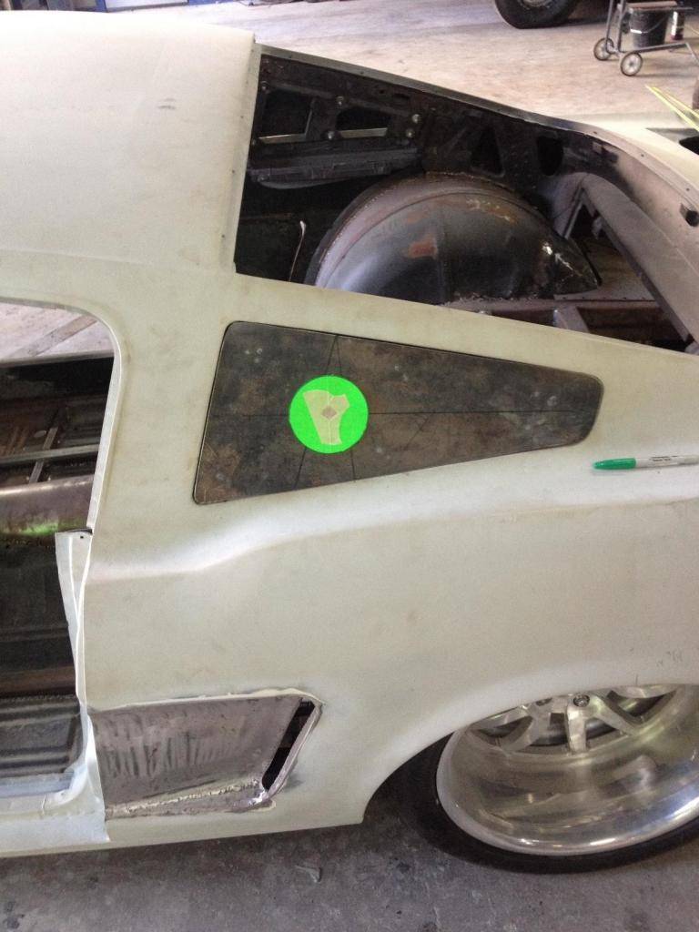

      Roughed in the Fuel fillers... put one on both sides.

      The mounts are Energy Suspension 4-1122G from Summit but with the engine moved back, the drivers side will need modified to clear the steering.

      Quote Originally Posted by manOwar View Post
      These oughta do!
      These are awesome!!! Great choice in gauges. What brand are those?
      Also, might be a stupid question but what are all those brass colored plug things in some of the photos above? They are sticking in the sheet metal.
      1974 F250- 428 c6
      1959 F100 Project -For Sale
      1964 Falcon Sprint 347 4 speed Pro Touring build!
      Follow us on instagram @blueghostindustries
      http://www.enjoygram.com/blueghostindustries
    19. #39
      Mar 2010
      Jacksonville FL.
      92
      Quote Originally Posted by BlueGhost93 View Post
      The gauges are Classic Instruments Autocross Series.... and the brass things are Clecos which are used to hold the sheetmetal in place prior to welding.
