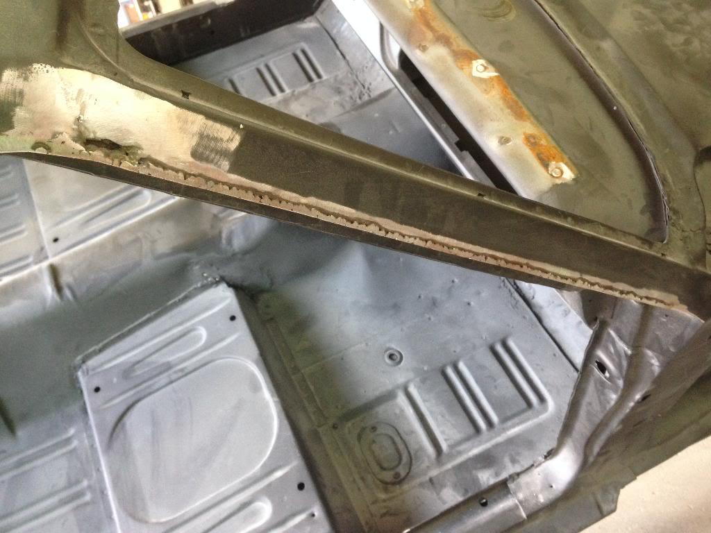

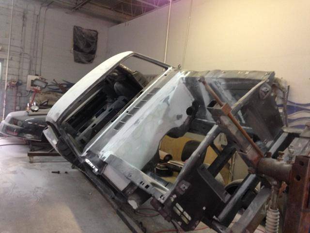

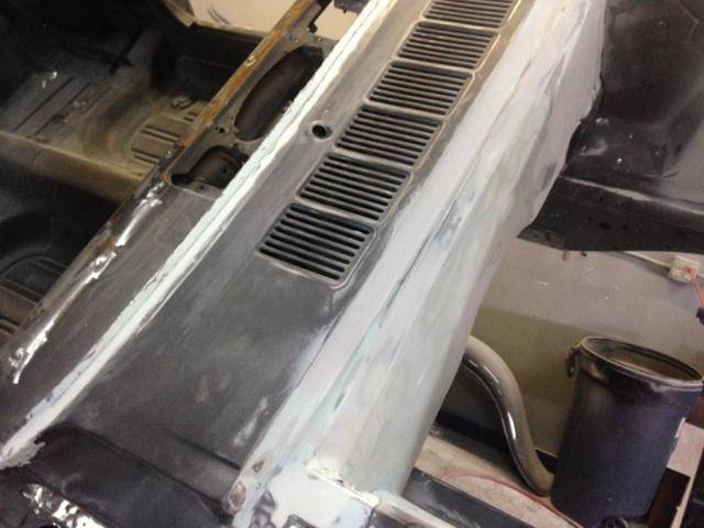

      After tearing it the rest of the way down and getting it on the rotisserie, we still couldn't find any rust!!! So off it went to sandblast... it came back today!!
      Looks like he missed a spot under the lip of the dash.

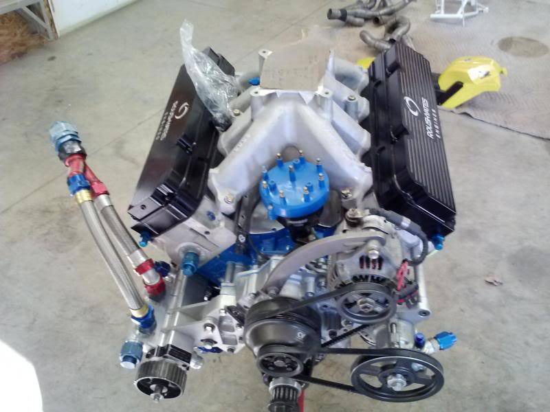

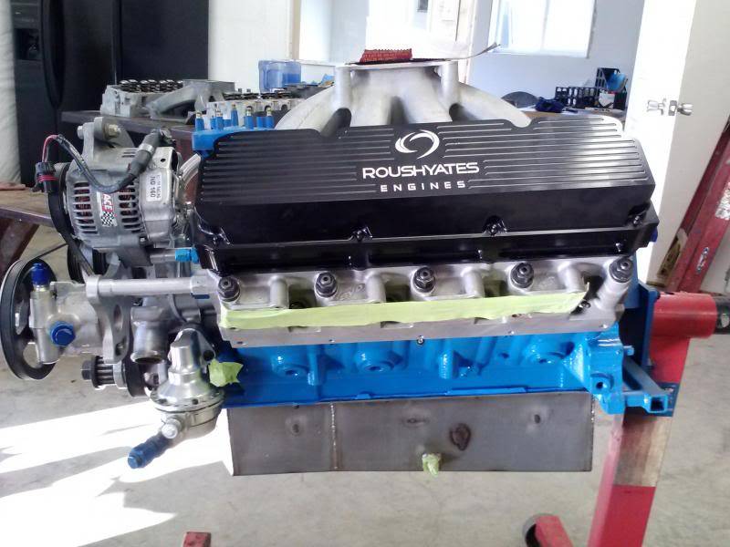

      For the engine, I wanted an original 427 Side Oiler but couldn't find one in the 600hp range like I wanted. So during my search, I came across a deal I could not pass up. I picked this up right after Christmas. It's for sale right now as I found the Side Oiler I was looking for a couple days ago.... an original 1966 427 SO that was just finished to ~650hp.... Hope I can work it out, if not I'll have to "settle" with this one @ ~800hp and the 8800 rpm's it'll turn!! Bummer eh!!

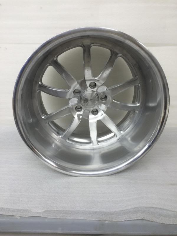

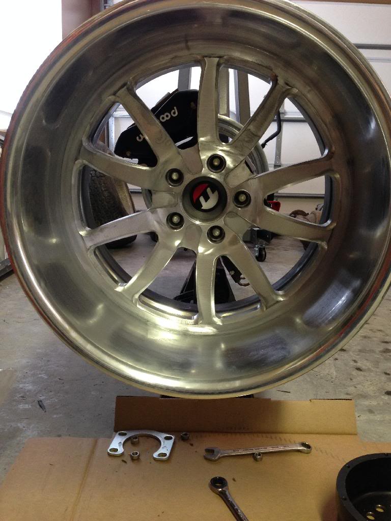

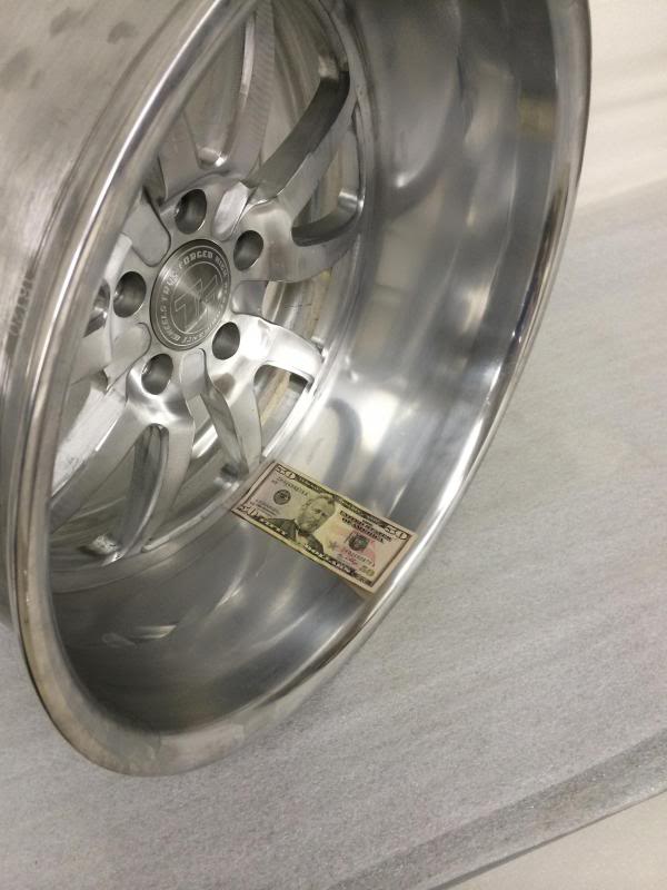

      My Wheels also Shipped today. True Forged Super Sports, 18 x 12 and 18 x 8. I had them leave em' ready to for power coat as I haven't decided on a color for the car yet.

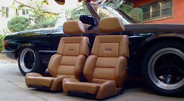

      Seats, what a search that turned in to. I started out wanting Recaro Orthoped or Experts, then I came across a set of classic Recaro Model C's. These seats are from the late 70's thru 80's and were a $6000+ option in Audi's, Porsche and Mercedes. These seats have power adjustable seat back, electric air pump for three lumbar air bags, manual adjustable seat base bolsters, side bolsters, knee support, shoulder and head rest. I will be mounting them on a set of Jag XJ6 - 6 way power base's under both seats.
      This is a shot of a set just redone...

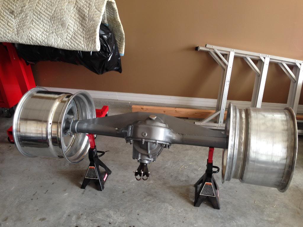

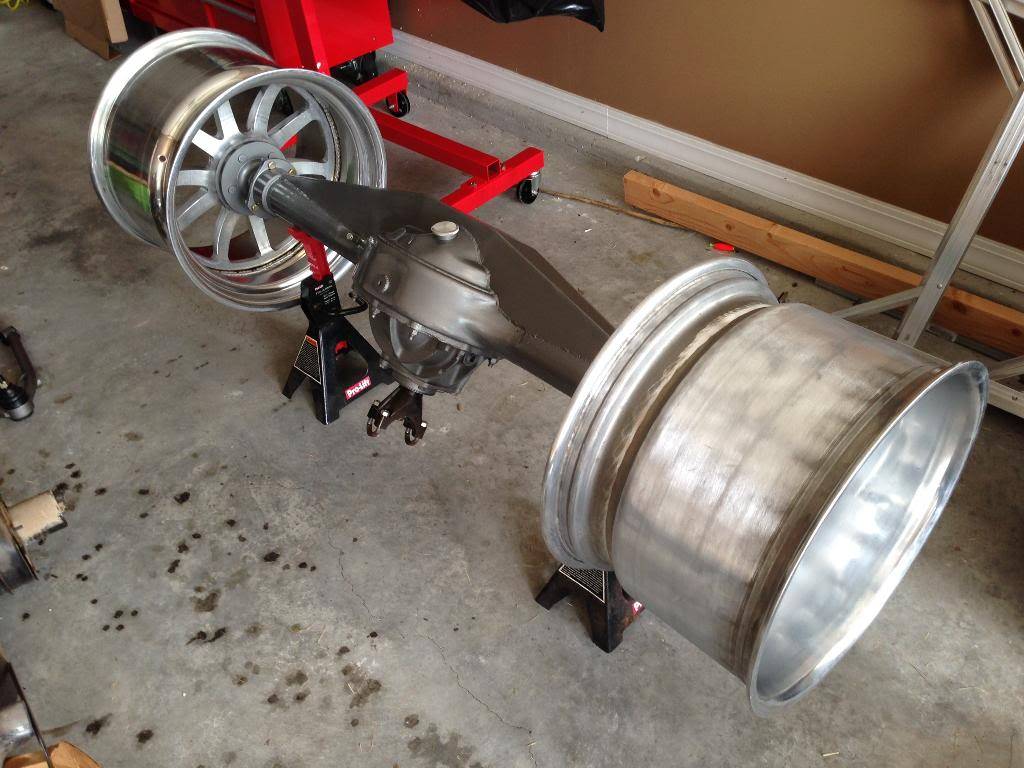

      I mocked up the rear end. It'll have 1.5 in of clearance between the tire and fender lip.....

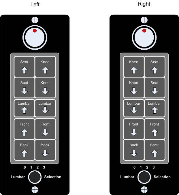

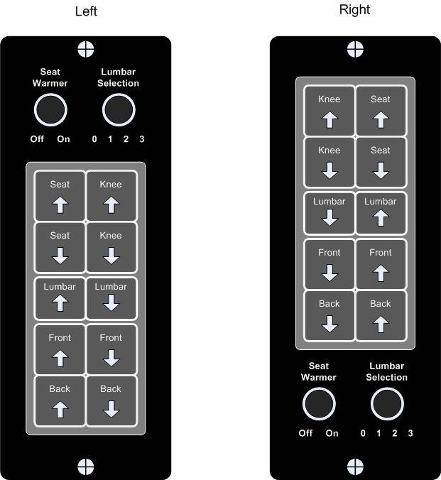

      Also spent some time drawing up some ideas for the seat control.... I'm using a set of switches from a BMW. I'll send them in and have them etched along with a new switch panel made.
      For the lumbar, the idea is to have the button run the pump, the other button will let air out or the section selected by the rotary switch...
      The seat warmer needs to be either a toggle or rotary switch which I like best.
      Take a look, I'd like to hear some ideas and opinions.
      Option 1 -
      Option 2 (left) and 3 (right) -

      Sorry for the late response. It's getting a narrowed rear sub frame from AME.

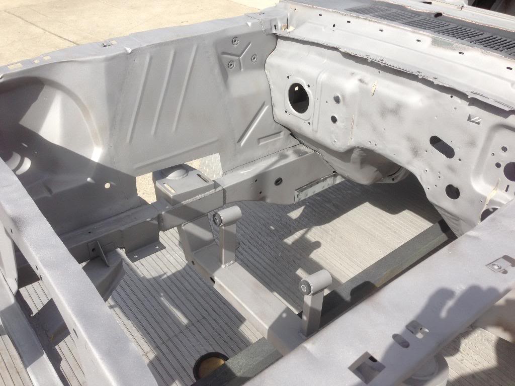

      A little progress, the drip rails are gone and stated on the fire wall. I finally decided on the pedal set up so the rest of the fire wall can be smoothed as there won't be a booster, master cylinder or clutch linkage hanging off it!!!

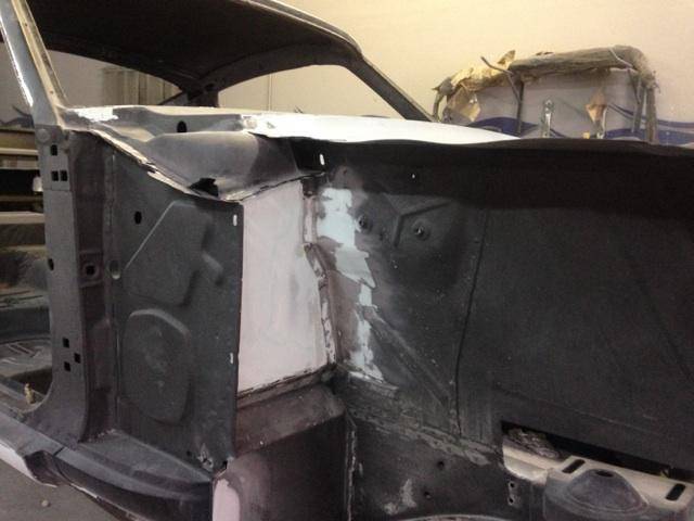

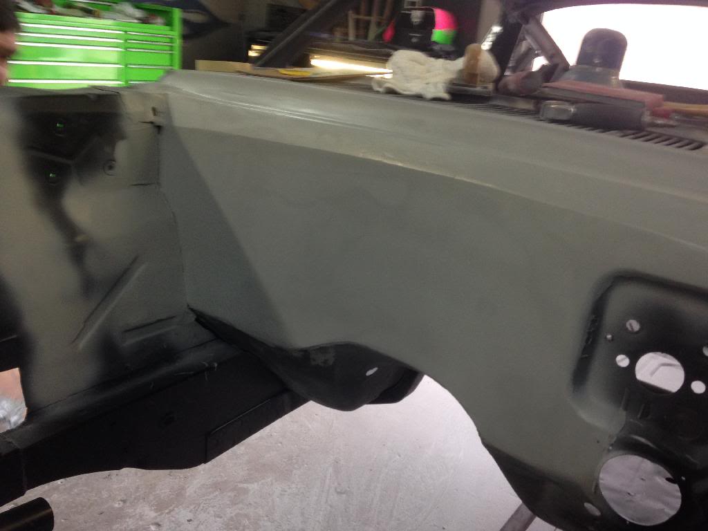

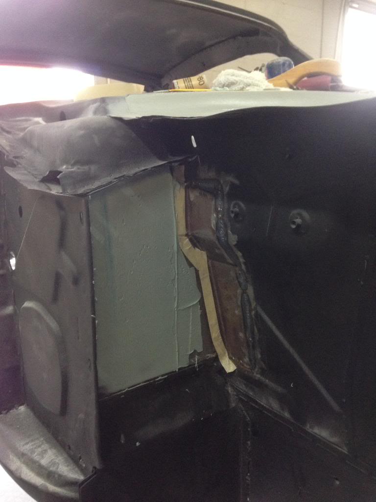

      Making some progress, hope to have it all primer next week.

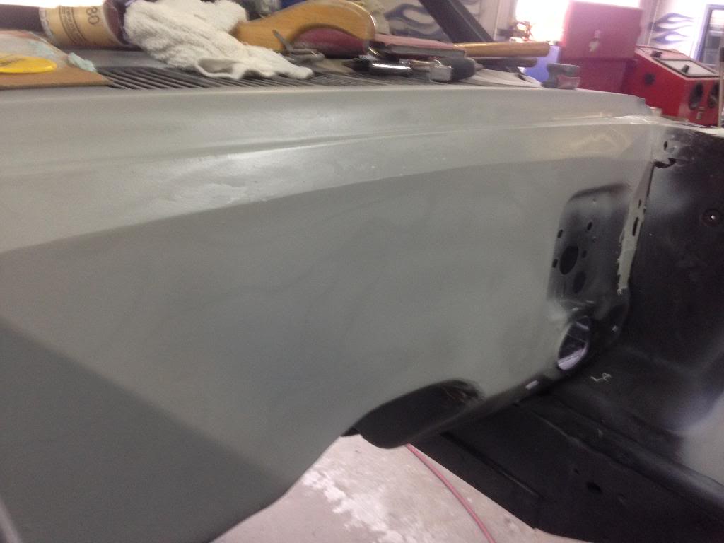

      Got the firewall just about finished up....

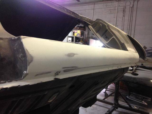

      Welded up all the holes in the and started working the rocker panels....

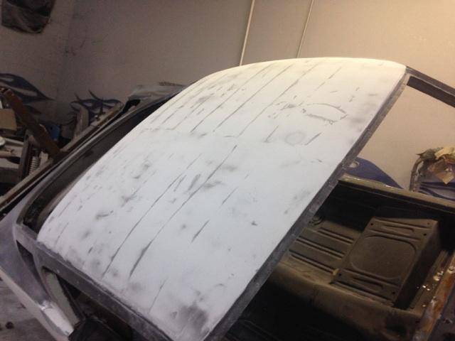

      Smoothing the roof....

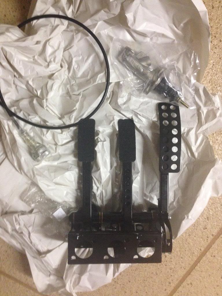

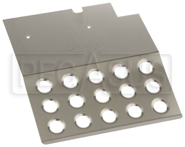

      Reverse floor mounted pedals. We'll have to notch the floor board to move the pedals back a couple inches. The floor pan will be reworked to match up with the cover...

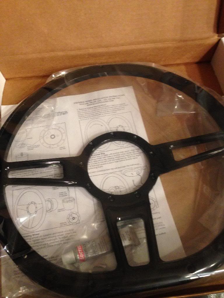

      Billet Specialties Formula steering wheel with black pad and horn button....

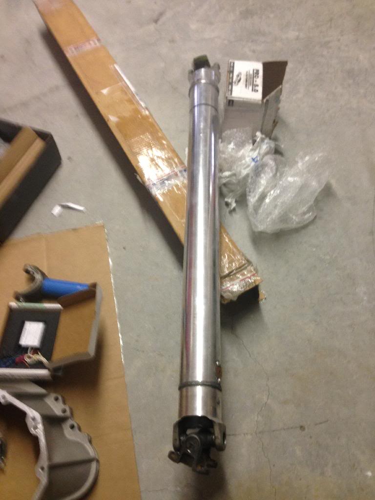

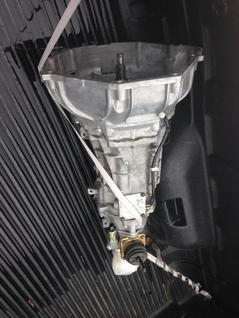

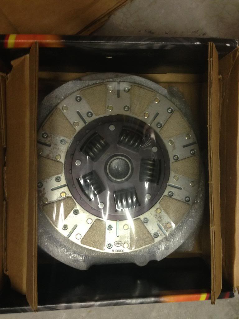

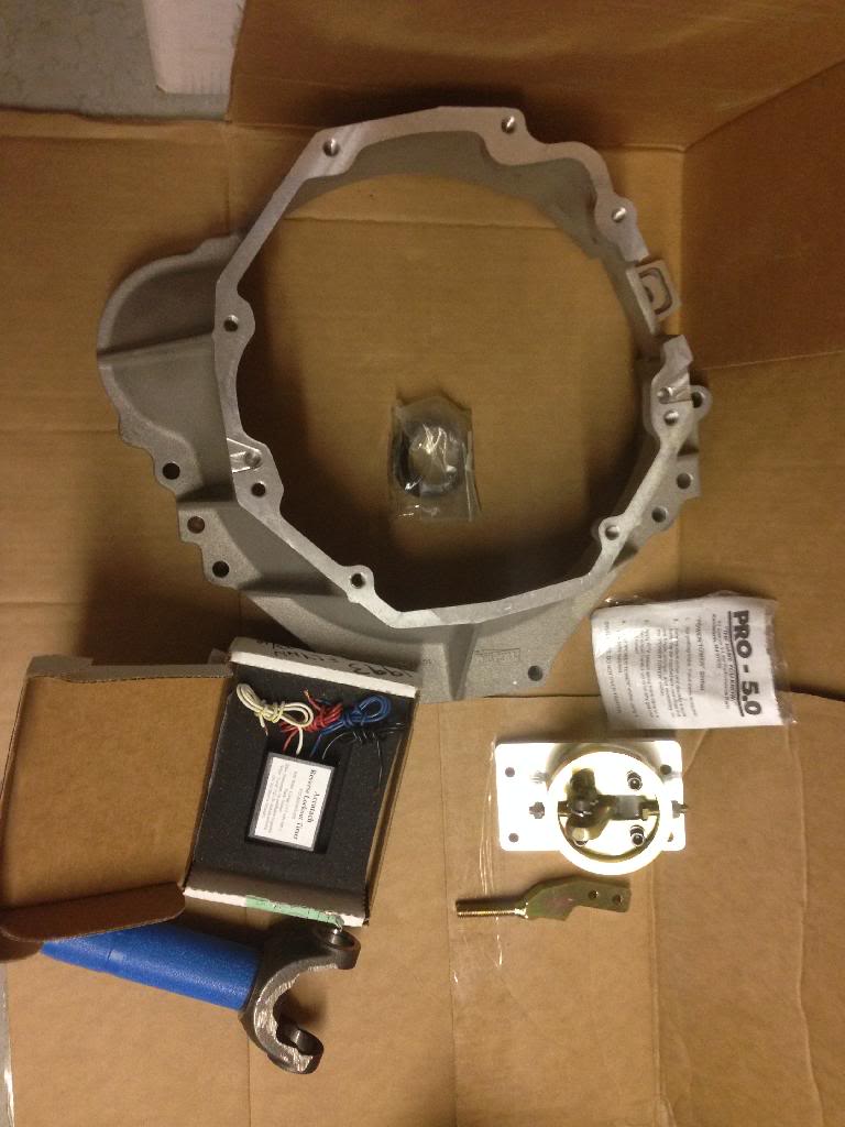

      I was able to unload the T56-R I had and found this Viper Spec T56 with a 2.97 1st and .50 6th. It was for a project that never got started so I ended up with the Trans, 2 SBF bellhousings, Pro 5.0 shifter, Clutch and an Aluminum Driveshaft.

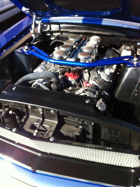

      Now the best part... The Borla (TWM) Stack Injection complete with ECM, Dual Sync Dist, MSD Ignition, 70lb injectors, rails and Dual Wide Band O2 module.... this shot was just before it was pulled off. It was run less than 2200 miles.
