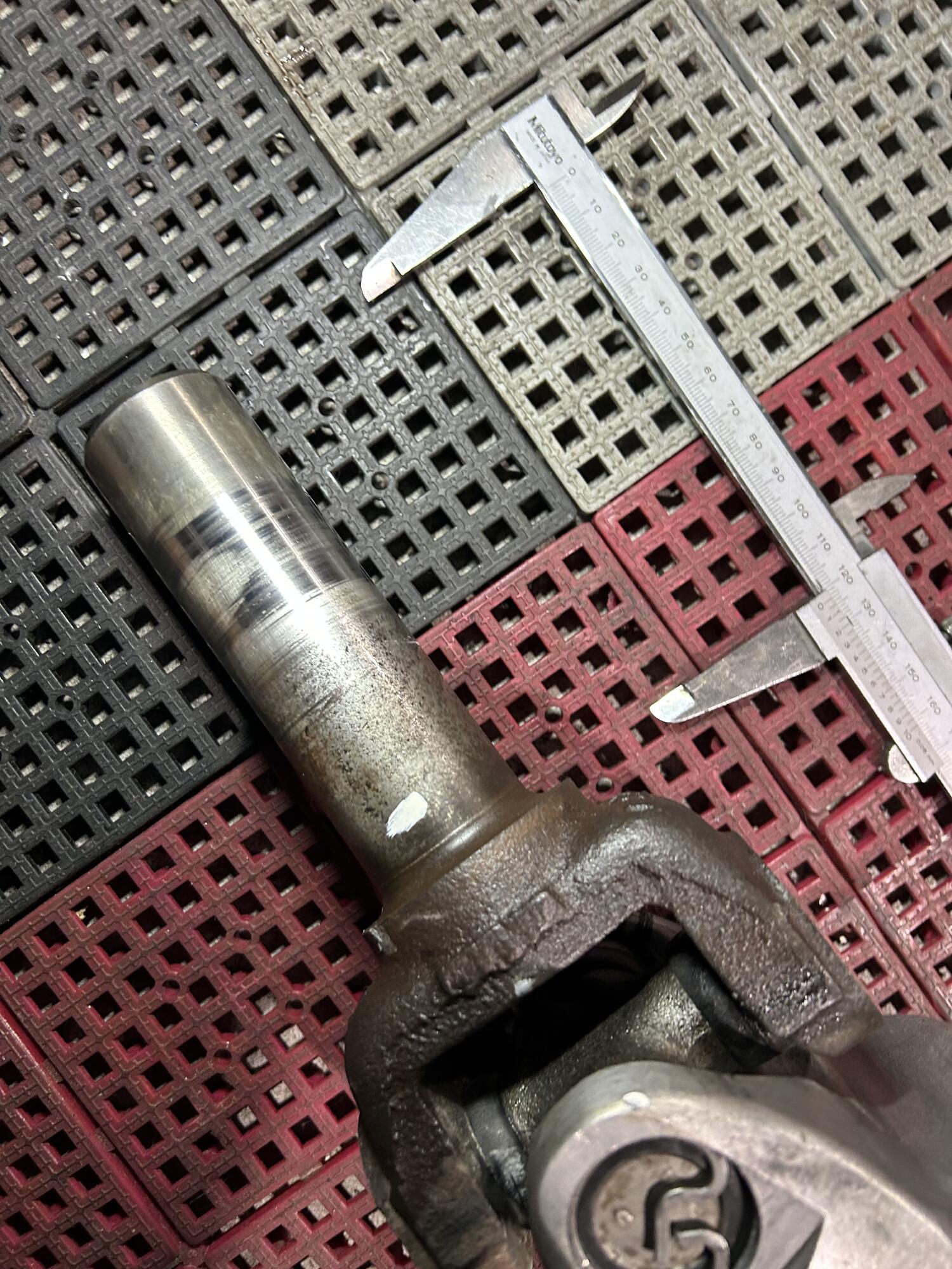

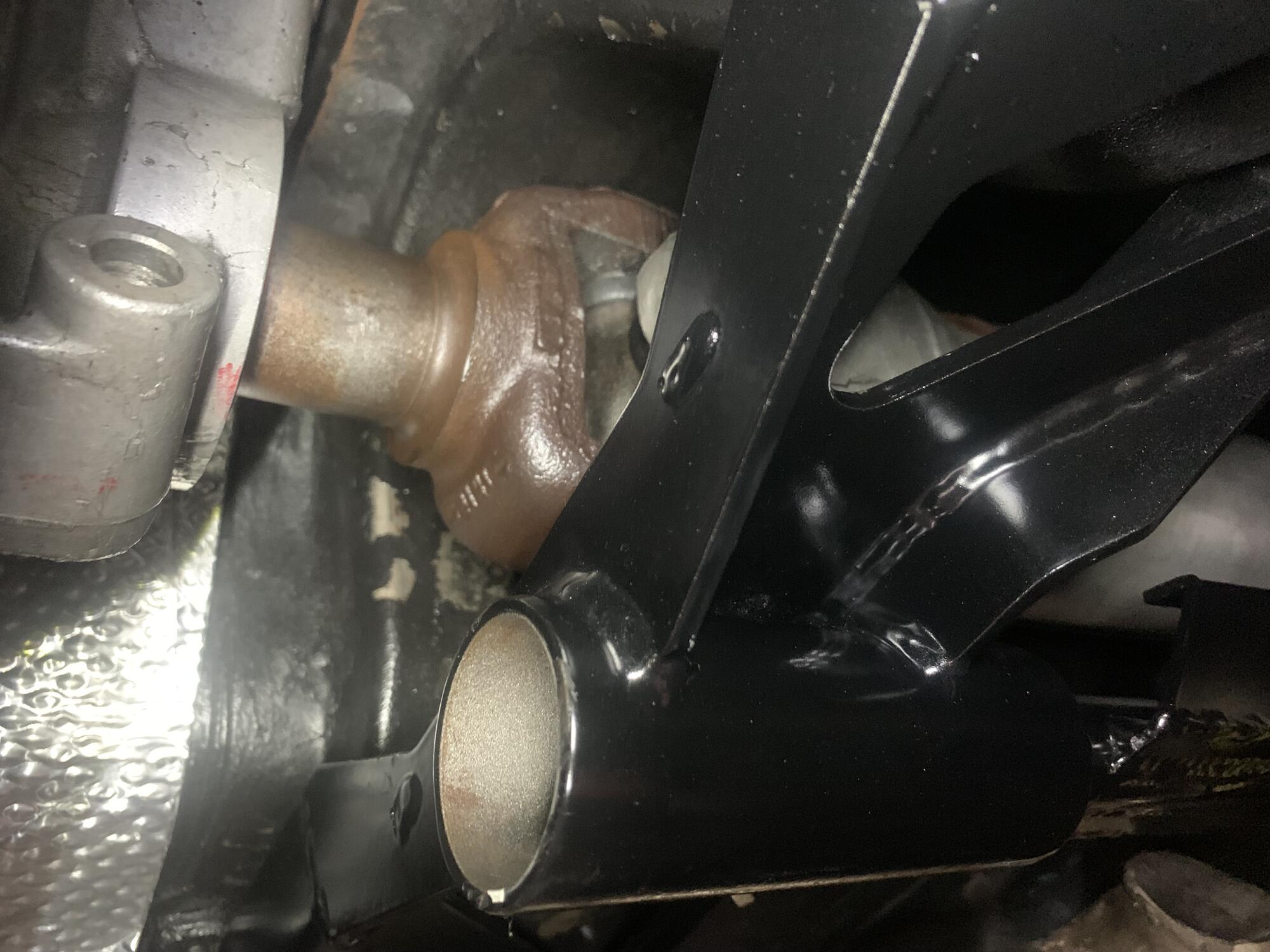

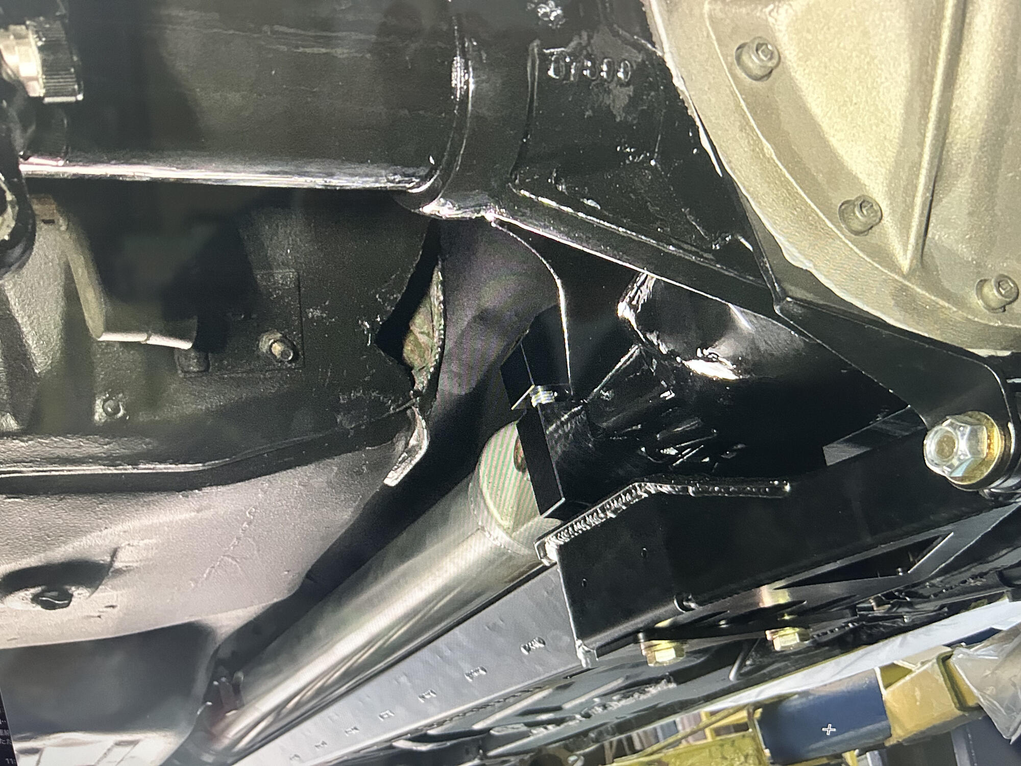

      I want my 1970 Camaro to stop vibrating. I'm thinking about the pinion angle, but I'm also thinking about the shaft problem. There is a limit to the thickness of the shaft due to the rear suspension equipped with a speed tech torque arm. I need your advice.
