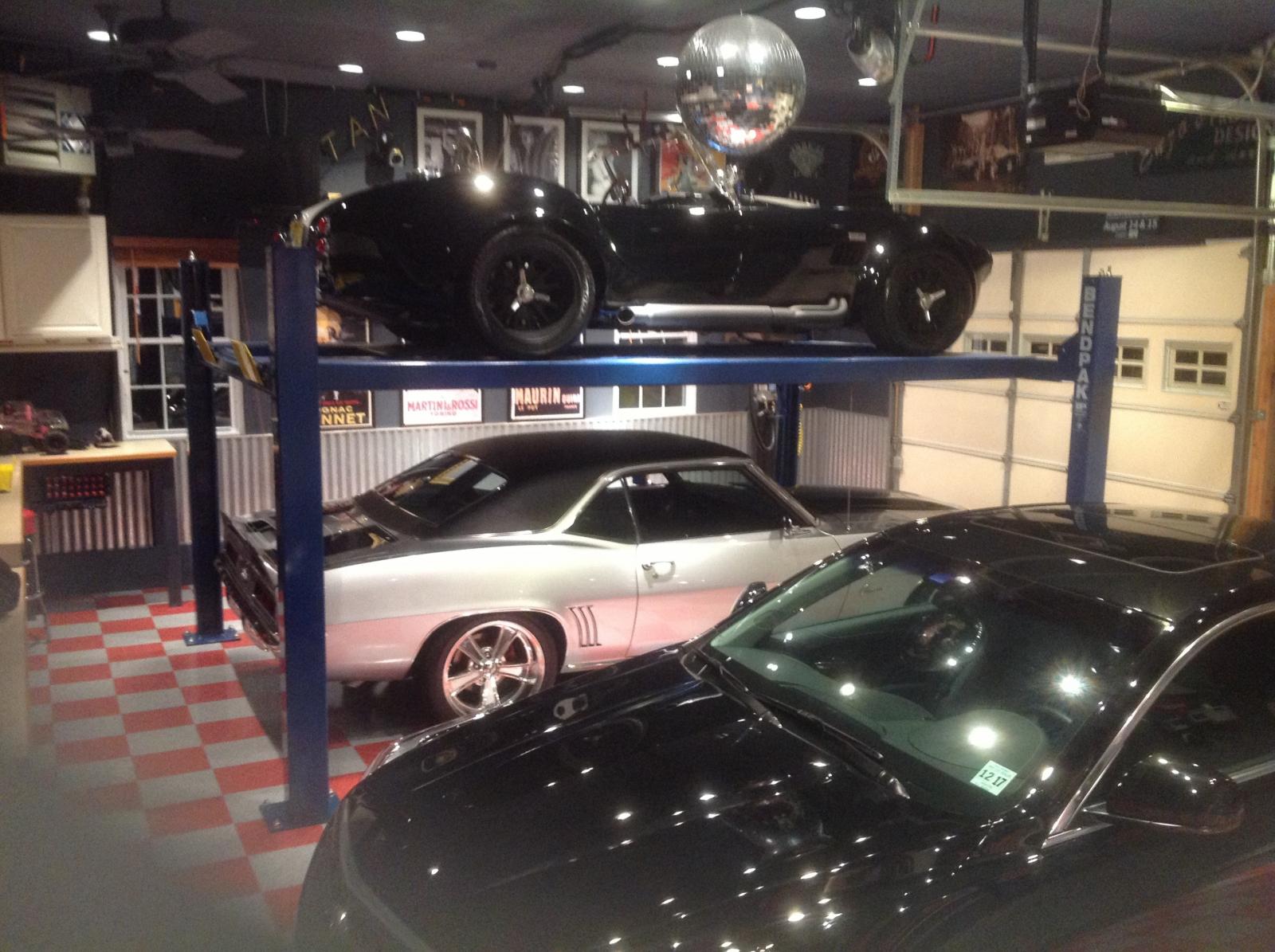

      Quote Originally Posted by Enzo Damico View Post
      Gotta love the disco ball .. LOL
      67 Firebird Convert 455 +.060 Johnny Winters TH400 74cc KRE d-port flowed @ 310 cfm heads piston dished 16cc H-beam rods Comp Cam 305-AH-8 cam 108* LSA 253/260 @.050 duration .577/.594 lift w/1.65 rockers Ford 9" 3.55 Detroit Locker M/T Sportsman Radials 31x18x15 on Convo Pro 15x15s
      Honest dad that 455 on the side of the block is a serial number
