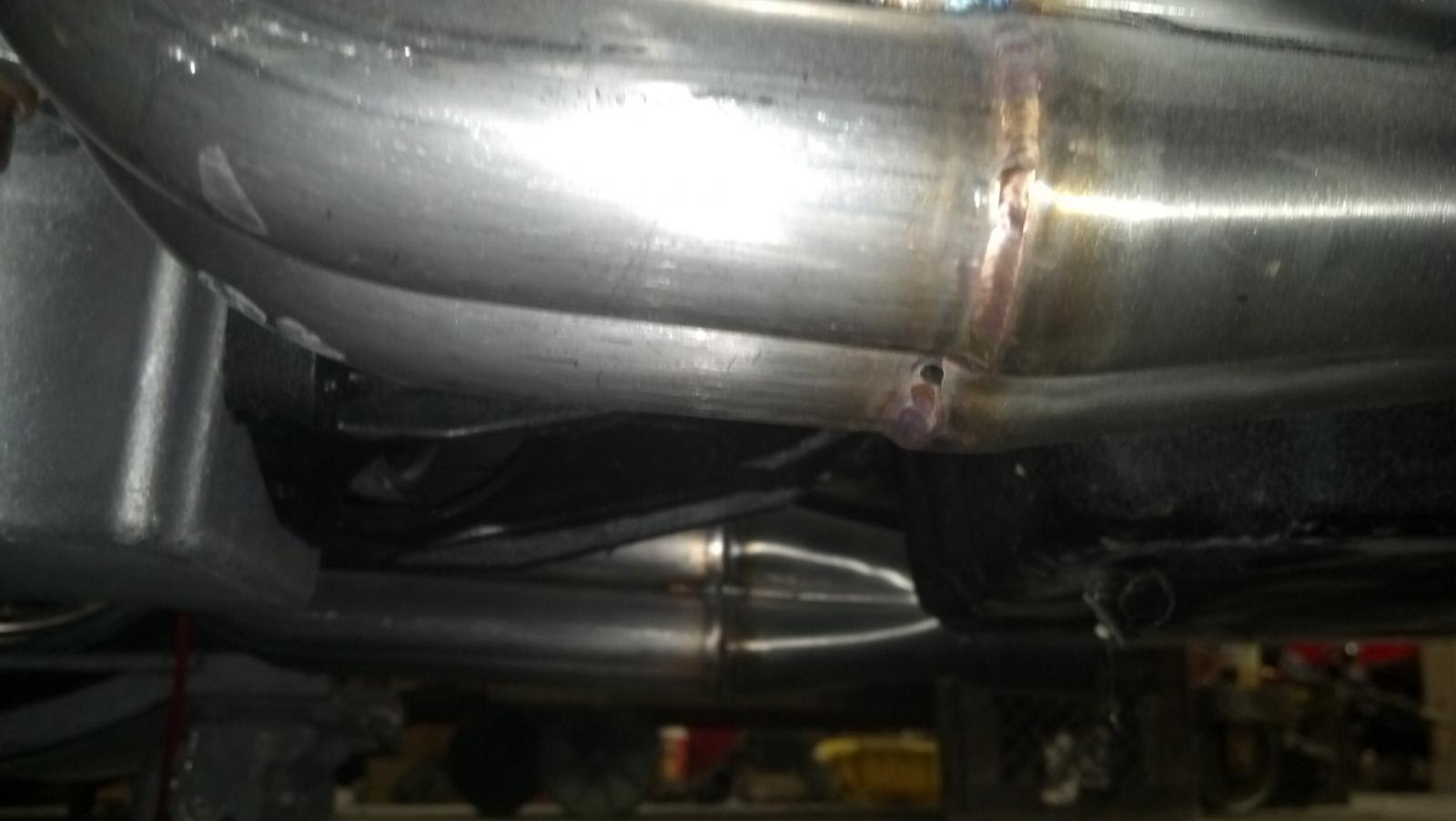

      Pics are not that great but they tuck up nice under the car

      What motor mount are you using? I currently have Dynatech headers with the recommended DSE mounts and the headers hang very low. Now I'm in a market for a replacement set.

      Transdapt mounts on Z28 frame stands
