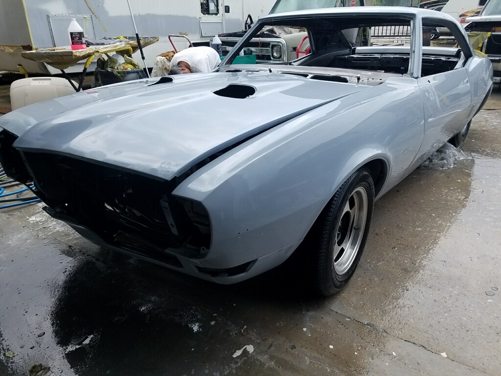

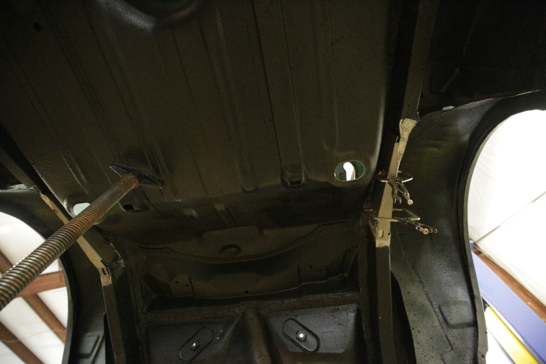

      Getting rid of the rust... waiting on new full trunk pan, quarter panels & outter wheel wells.
      Dec 2013
      10

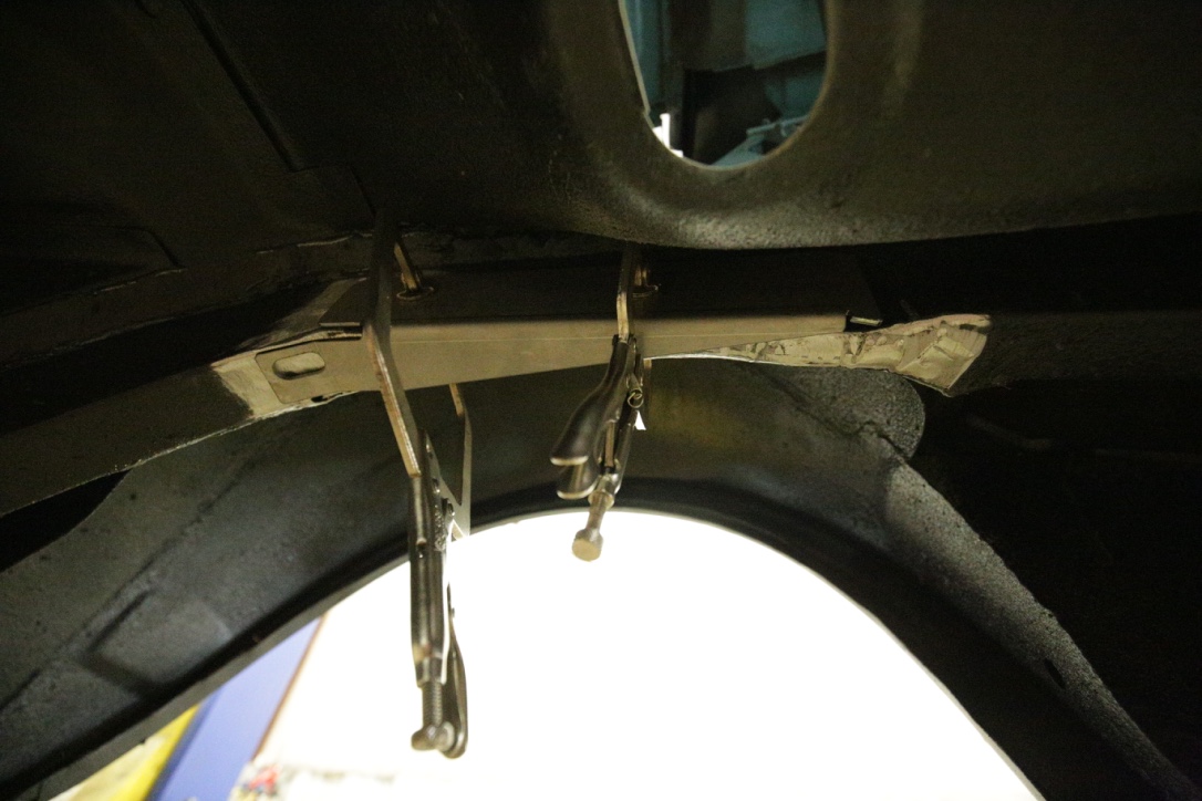

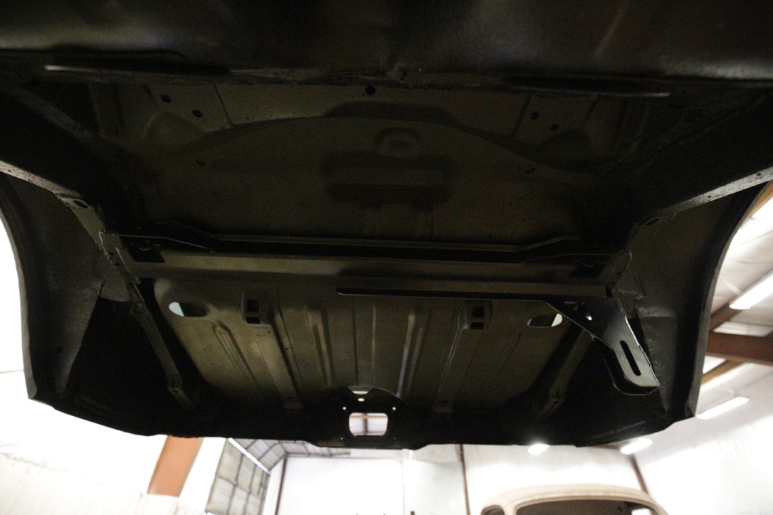

      New floor installed & started the sand blasting. Seam filling of floor up next..

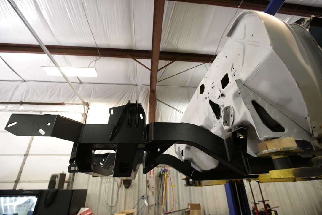

      OK, I haven't posted anything in almost 3 years but I still have my 68 Bird & we are still moving forward with it. I now know what it takes to get one of these things up and going and boy was I in for total surprise along the way.
      Dec 2013
      10

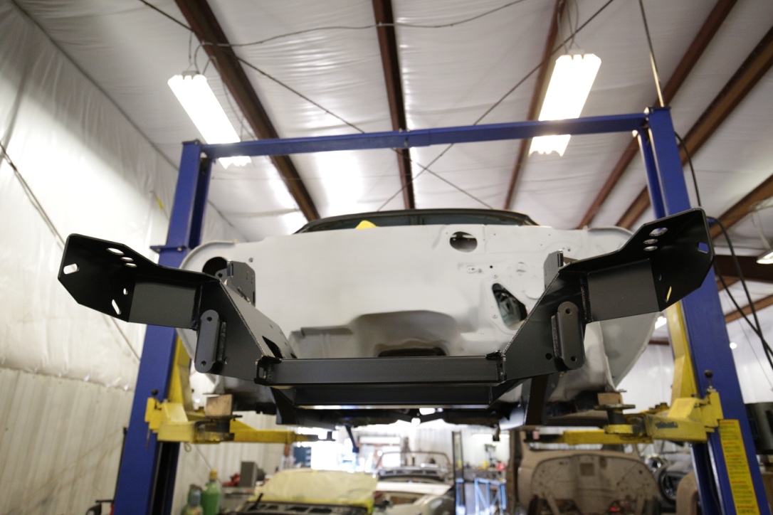

      "Project Tenacity Reloaded"

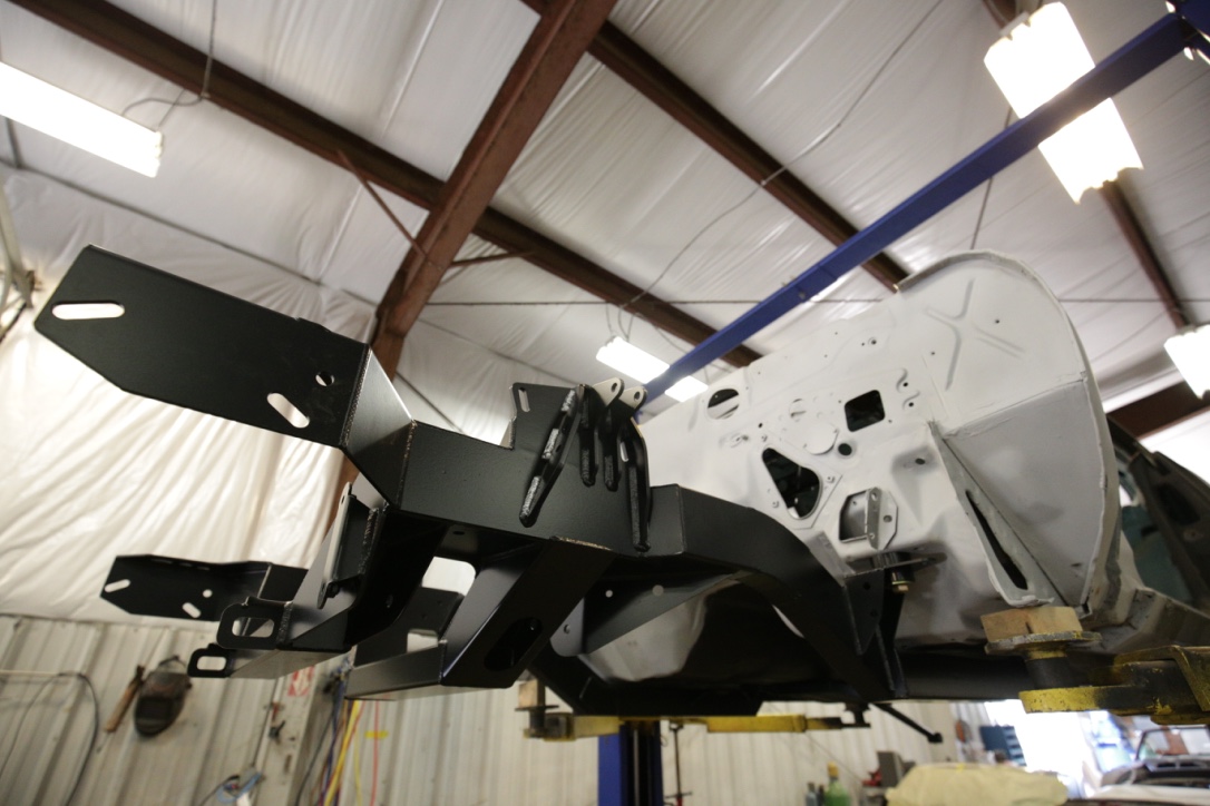

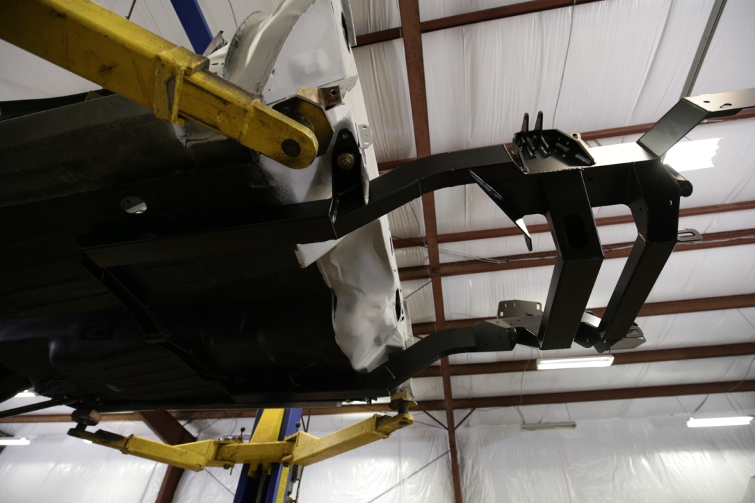

      Speedtech Pro-touring Subframe & QuadLink Rear

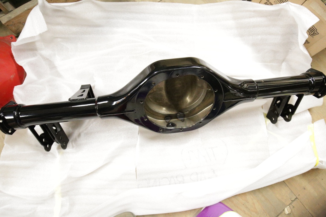

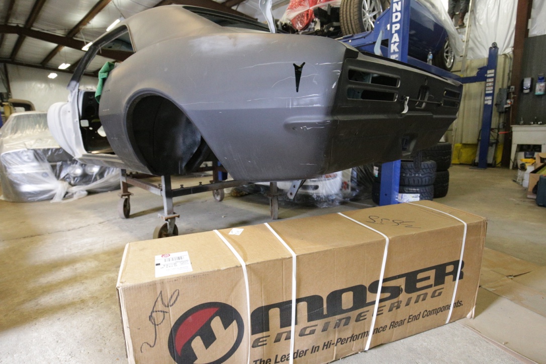

      Moser Ford 9" Rear End
      Nodular Case Ctr Section with 31 spline w/3:89 Tru Trac gears.
      Have LS 408 Stroker with Wiseco Pistons, K1 forged Crank
      Cam Motion Custom Grind Cam
      Tremec 6 Speed wide Ratio Trans
      Baer 14" 6P Brakes
Size:  266.2 KBName:  thumb_IMG_4683_1024.jpg
Size:  189.1 KBName:  thumb_IMG_4682_1024.jpg
Size:  207.8 KBName:  thumb_IMG_4681_1024.jpg
Size:  200.3 KBName:  thumb_IMG_4680_1024.jpg
Size:  205.4 KBName:  thumb_IMG_4743_1024.jpg
Size:  187.6 KBName:  thumb_IMG_4742_1024.jpg
Size:  233.8 KBName:  thumb_IMG_4739_1024.jpg
Size:  258.2 KBName:  thumb_IMG_4737_1024.jpg
Size:  225.9 KBName:  thumb_IMG_4665_1024.jpg
Size:  203.9 KBName:  thumb_IMG_4660_1024.jpg
Size:  202.2 KBName:  thumb_IMG_4659_1024.jpg
Size:  234.6 KBName:  thumb_IMG_4658_1024.jpg
Size:  230.6 KBName:  thumb_IMG_4657_1024.jpg
Size:  134.3 KBName:  thumb_IMG_4431_1024.jpg
Size:  207.2 KBName:  thumb_IMG_4201_1024.jpg
Size:  207.0 KBName:  thumb_IMG_4684_1024.jpg

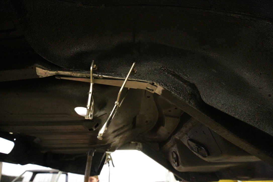

      That was a lot of body work! Did you just start out by taking a 4" cutoff wheel and cutting all the rusty metal off? Looks like a lot work was done since 2014; I guess we don't want to know how much/time money went into that... I spy what looked to be Verdoro Green on the old photos, same color as mine was originally (also an original 400 car). Keep up the tenacity!

      Yes, That's exactly what we did. The metal wasn't too bad. I prolly have about 8K in the metal work with parts & labor. The $$ was the motor, subframe, suspension, brakes, rear end, Trans etc...

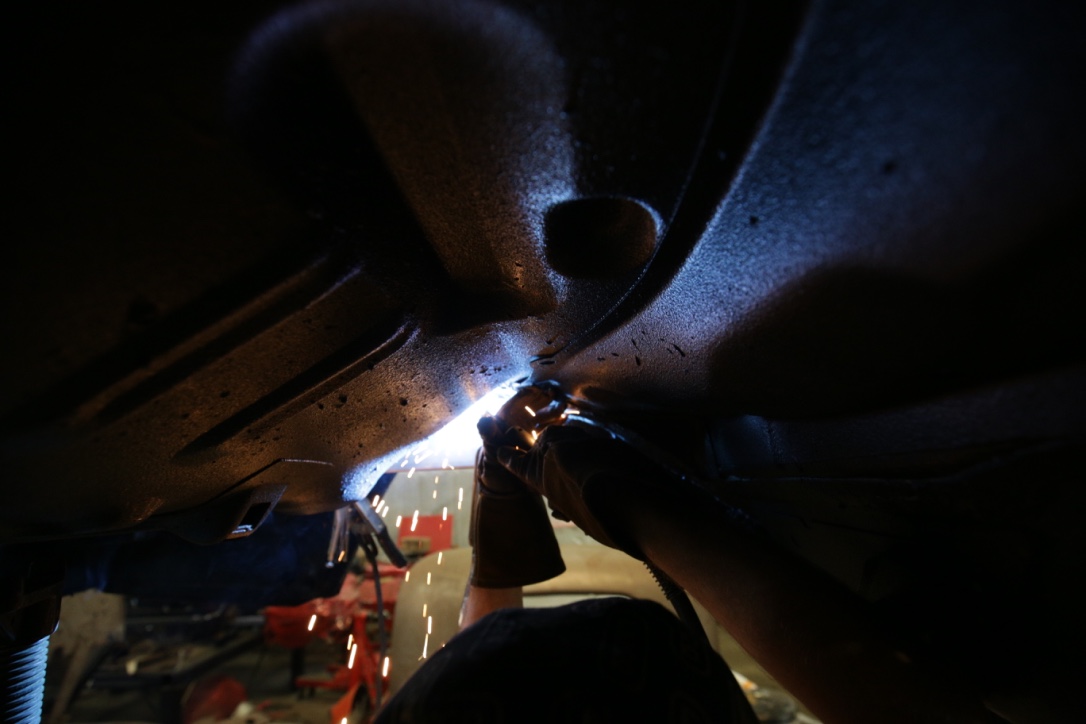

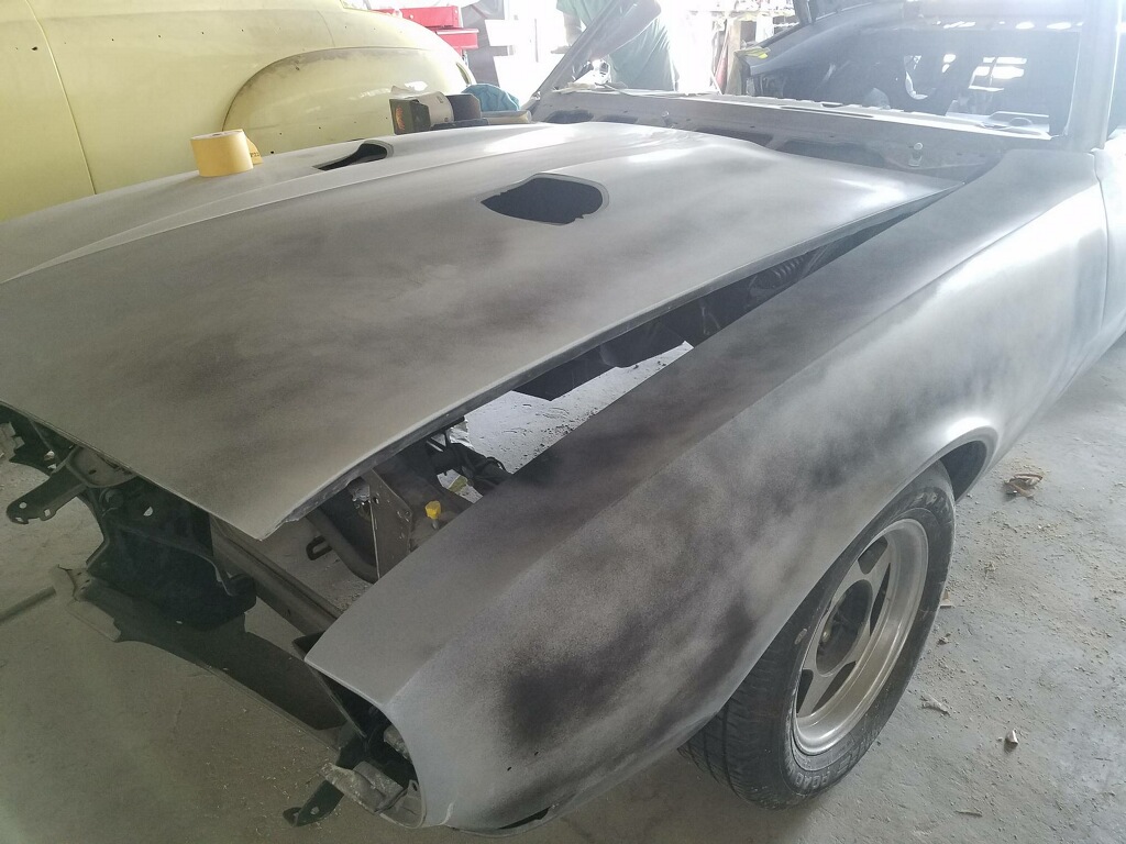

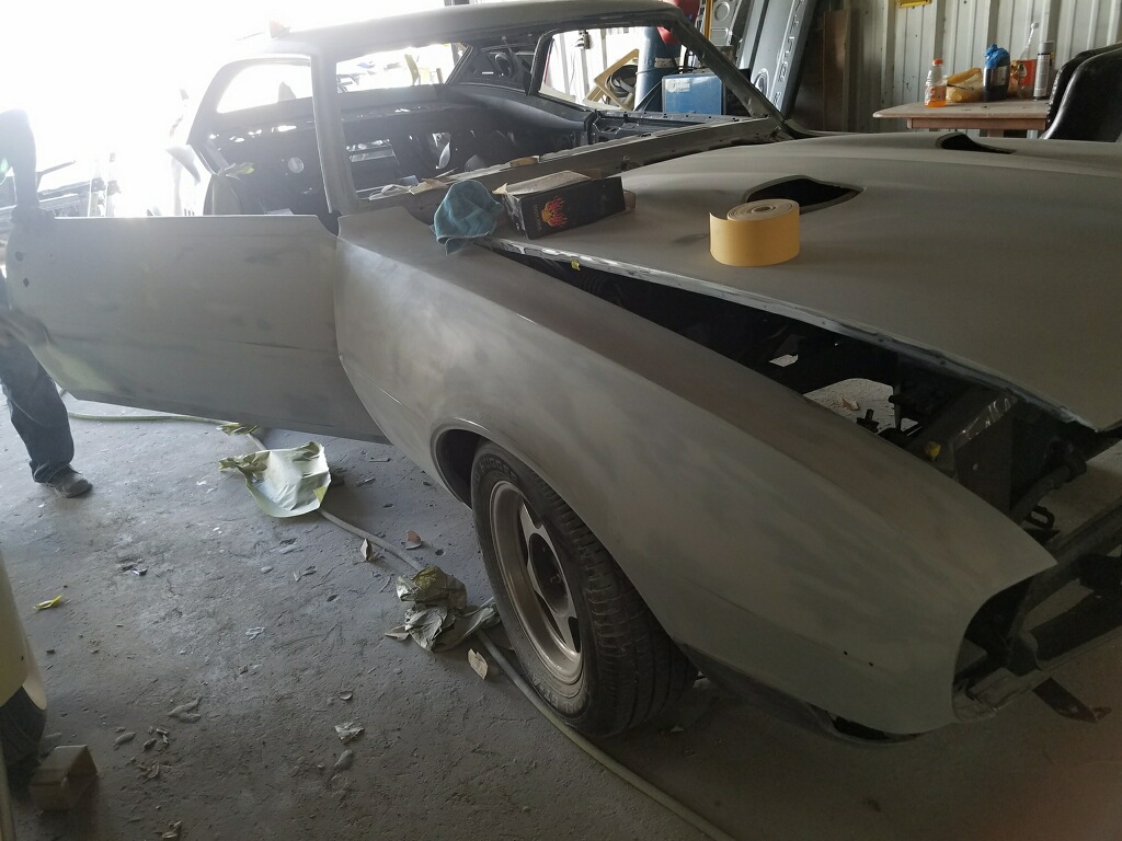

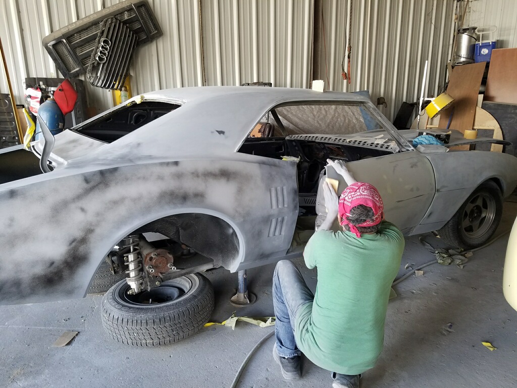

      Still Grinding
Size:  272.5 KBName:  9E1ED315-9F5B-44AA-BBD1-4762EE7F0902.jpeg
Size:  152.1 KBName:  7DE2EF4E-8754-45BF-936A-F3B941ABBB1F.jpg
Size:  155.3 KBName:  81F9B0B1-18FD-4E83-8ED0-B4A78F16465D.jpeg
Size:  244.4 KBName:  EC6A63A8-4376-4FE5-918A-93BF09C938C5.jpeg
Size:  166.8 KBName:  65B0B806-ED03-4E57-A359-6B06BA925032.jpeg
Size:  182.7 KBName:  507CA879-86E6-4862-8897-6AF2C5CBC1C0.jpeg
Size:  178.3 KBName:  49A9478E-2D1E-4E69-811F-93676D01283C.jpeg
Size:  172.1 KBName:  BFDD84AB-695E-4677-8348-C92F7CC36196.jpeg
Size:  176.4 KBName:  91E7D3CA-D6C3-4A19-A701-284A7744EDAA.jpeg
Size:  238.7 KBName:  B5AD4B38-66F4-4F64-A57F-467DAAE83563.jpeg
Size:  168.9 KBName:  5EAA801E-BC64-45CE-84CA-A2A362C90773.jpeg
Size:  169.7 KBName:  E31B652B-BAB6-4ADA-9927-704893521B7E.jpeg
Size:  163.3 KBName:  07632CB8-52DD-4E43-AA98-5A769747D8E2.jpeg
Size:  248.7 KBName:  F0D893B1-C972-4632-9469-C0D3490F55EE.jpeg
Size:  201.2 KBName:  C35819D8-22F2-4347-A2F9-9EB406891699.jpeg
Size:  195.0 KBName:  DDB7FFB3-F62A-4E24-8E1A-67360F0A0A0D.jpeg
Size:  187.8 KBName:  19C36BD3-F1AE-4D5F-81AB-DB366528328D.jpeg
Size:  192.8 KBName:  21A7D366-7B71-4E72-BCB6-88E54542D478.jpeg
Size:  155.4 KBName:  DD8C3993-0D44-45F8-8219-F9B2C8AF0FF2.jpeg
Size:  142.3 KBName:  A65ABBC7-2DA4-4945-A10D-6DB2A5E6C39D.jpeg
Size:  251.7 KBName:  C45E43D2-8EEB-424F-97A9-81358D2DB20E.jpeg
Size:  253.0 KBName:  1B3CD5FD-1C0F-4B43-975D-93E56BEFE60E.jpeg

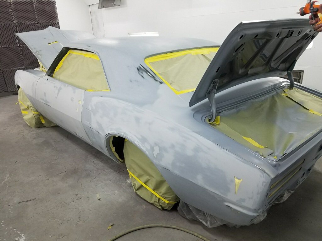

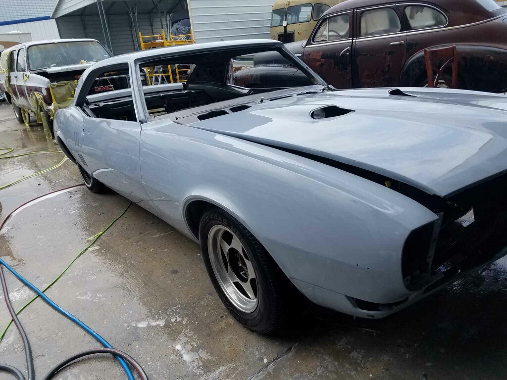

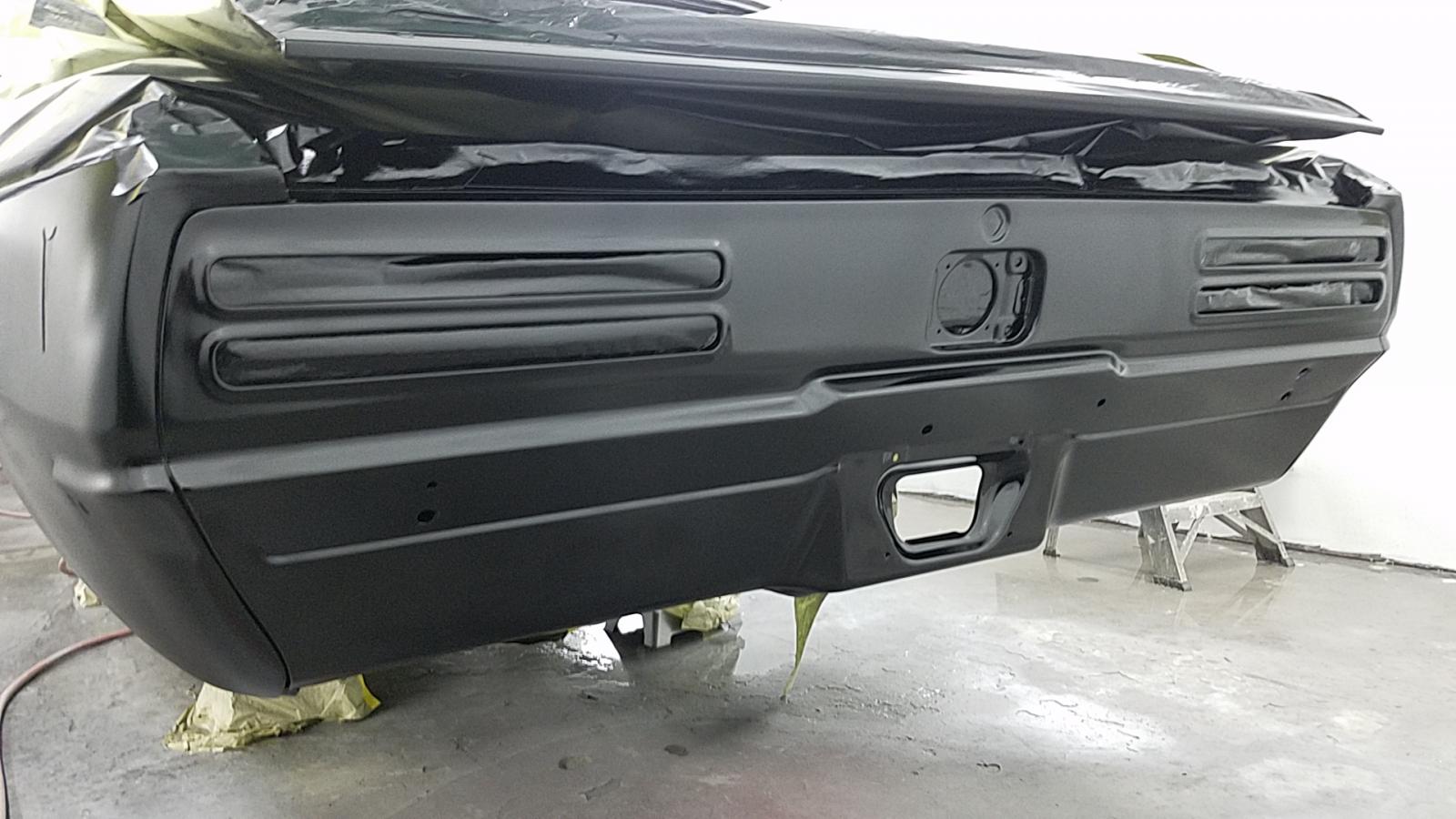

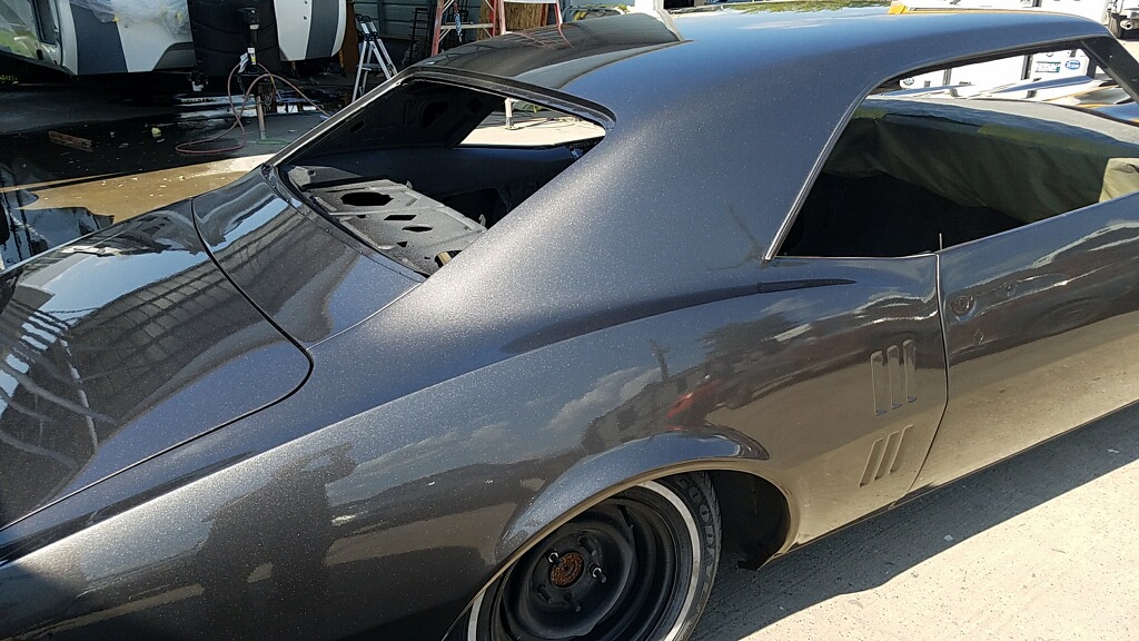

      Still Grinding

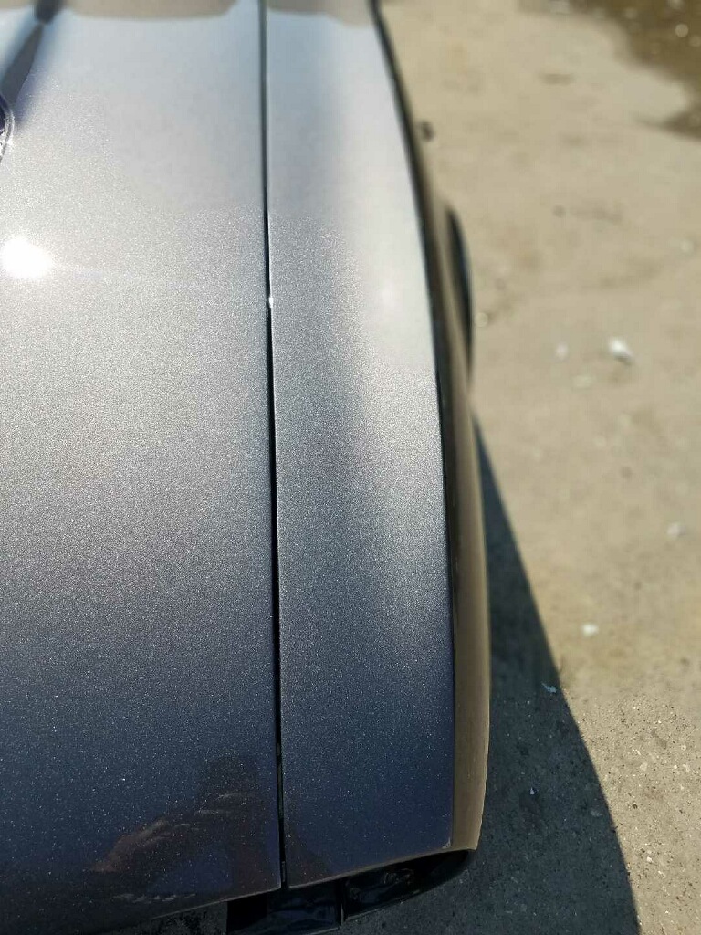

      Sand & polish on deck!
      Mar 2017
      Mississippi
      167
      When I saw the first few pictures, I thought "well, on the bright side, it's never been wrecked." :-)
      Love the paint color.

      I’m in awe. Great work bringing her out of the ashes. I feel real lucky with what I got to start with now. That paint color is a phenomenal choice.

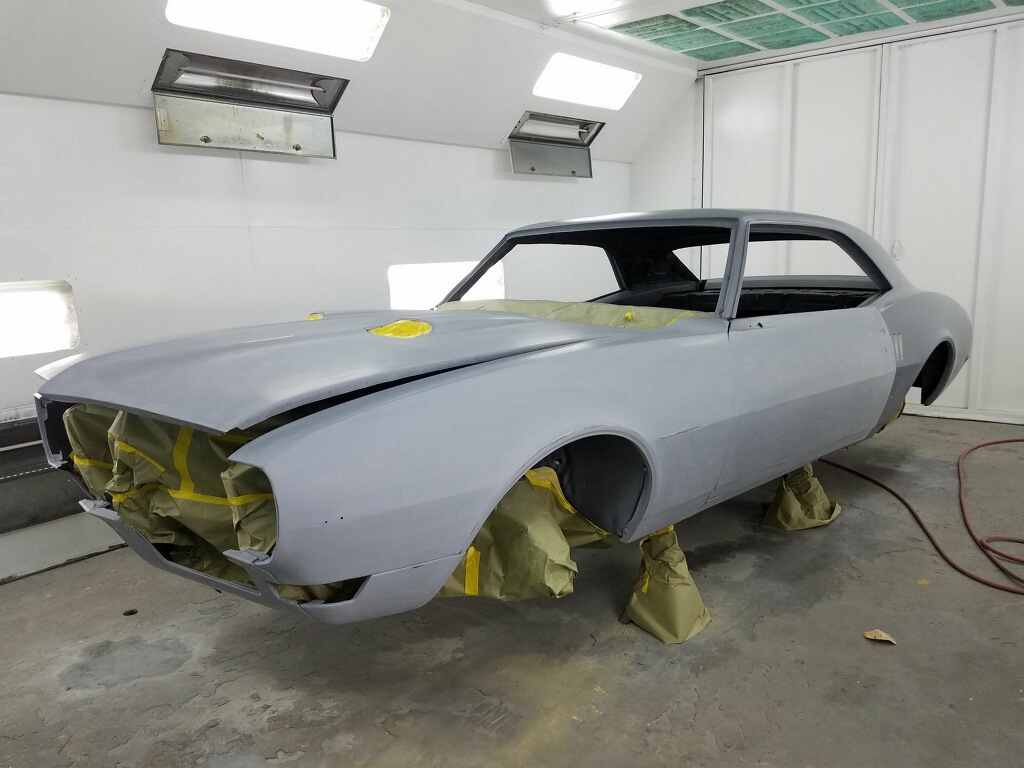

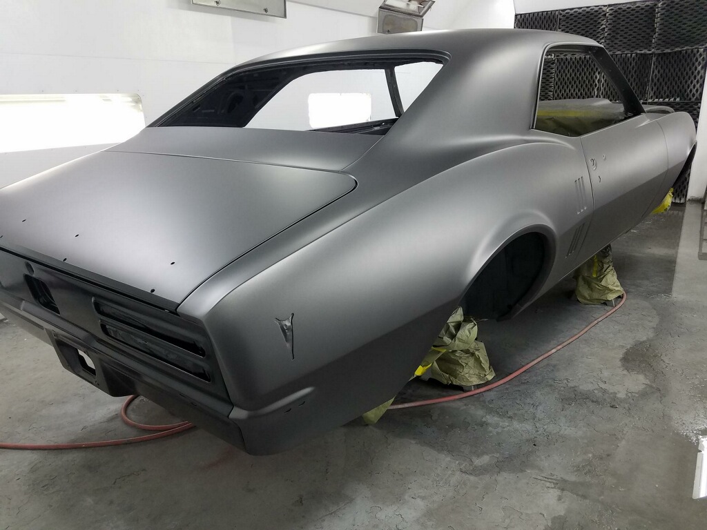

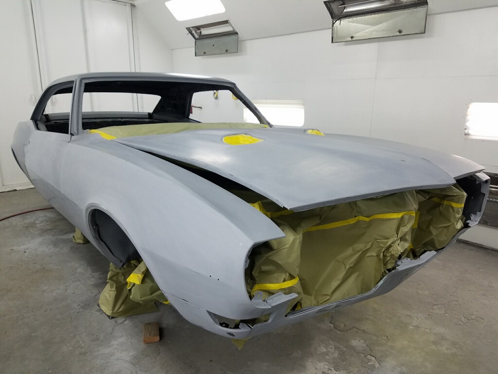

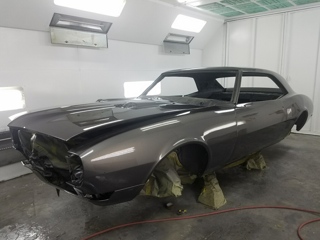

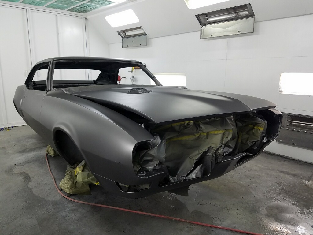

      Project Tenacity 2020 Updates
      Back at the build again. Here are few updates on where things are. Paint is done for the most part. Wheel & tires have been fitted. I am running 245/40ZR-18's Michelin Pilot Sports 4S up front with Baer 6P Bakes all the way around & 325/30ZR-19's in the rear. Manual Brakes has a Baer Master Cylinder w/proportion valve. The bird has Dakota Digital VHX gauges, Vintage Air, DSE Wiper Motor, Holley Dominator X EFI, Holley Fuel Tank, Griffin Radiator w/fans, McLeod RST Twin Disc Clutch w/Hydraulic Throwout Bearing, & American Wire Wiring.
