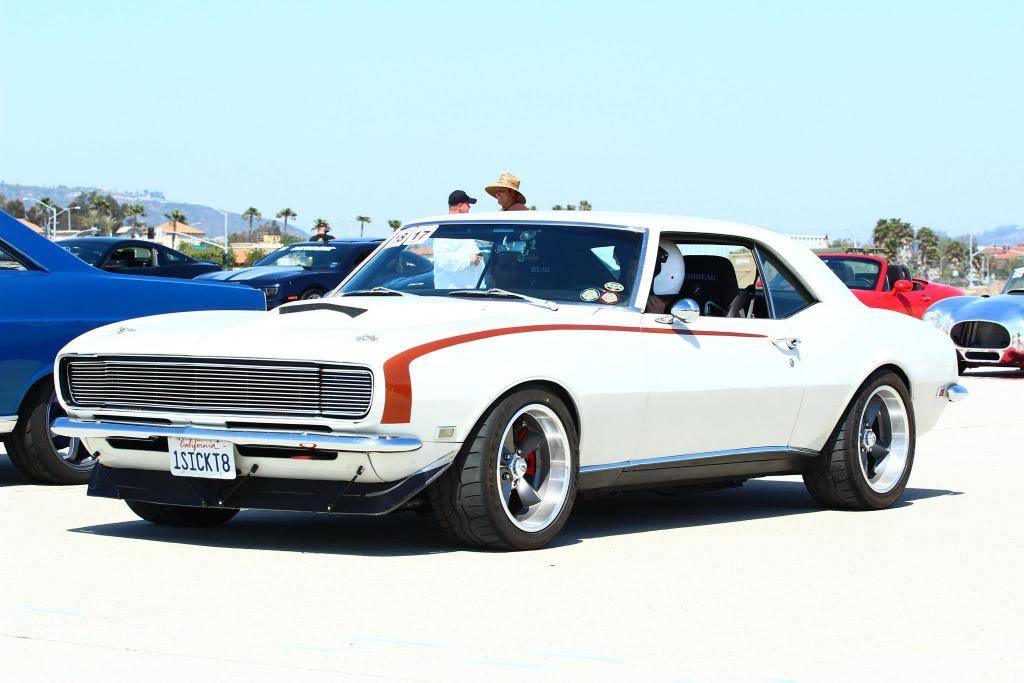

      This is our test car Nova, which has our off the shelf Track Time suspension in it. For an honest street car, it rocks it on the race courses. Jay even taught it to fly, which it did several times at this pro touring event. Like the the old commercials say, it takes a licking and keeps on ticking...

      Man do I love that picture of Ben's. Anyway, all the above are good comments so it will come down to how much do you want to spend. I went with the TCI front and rear kit because I didn't want to spend a pile of cash rehashing old technology with my factory frame and end up buying a better one later anyway. The only thing worse than overspending on the parts for your project is having to buy them twice. There are a lot of really great vendors on this site so do your research and get what works best for you. I can tell you the boys over at TCI have treated me very well and the customer service is second to none.
