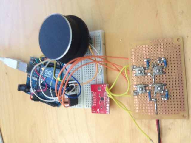

      To be 100% honest, i sold the car right after I did my second version of the install (with the 3dconnexion) so i didn't get it fully integrated into the system. but... it's basically a common HID (human input device). Through the software that comes with it you can modify how you want it to work. i believe there are a total of 8 axises with that device. iirc you can modify these in the driver package that comes with the device. for instance, if you find that the 'twist' functionaily isn't needed and sometimes gives false readings, then you just disable that portion of it. From there it's just a matter of mapping the functions to correlate with what you want it to do with your front end software.
      it is also possible to use that device w/o having a pc and using an arduino micro controller to interpret the actions.
      as for the installation. I took the 3" to 2" abs pipe reducer and graphed that into my console in order to get a uniform recessed angle. then i graphed the spacenav (removed from it's base) to the 2" opening
      another option that i'm exploring right now is a standard rotary encoder (the type that 'clicks' as you turn it... like the volume knob on a stereo receiver) and a set of four buttons that can detect when your finger is just touching it as well as when it's being pressed. this allows you to have a display (be it lcd or even led lights) that will allow you to have a visual confirmation on which button your finger is on. The added benefit of this is not to have to look down at your console for verification of which button you're touching.:
