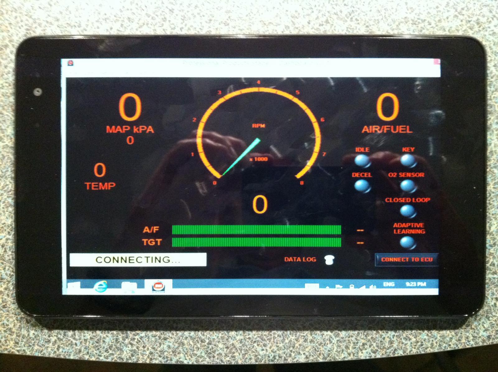

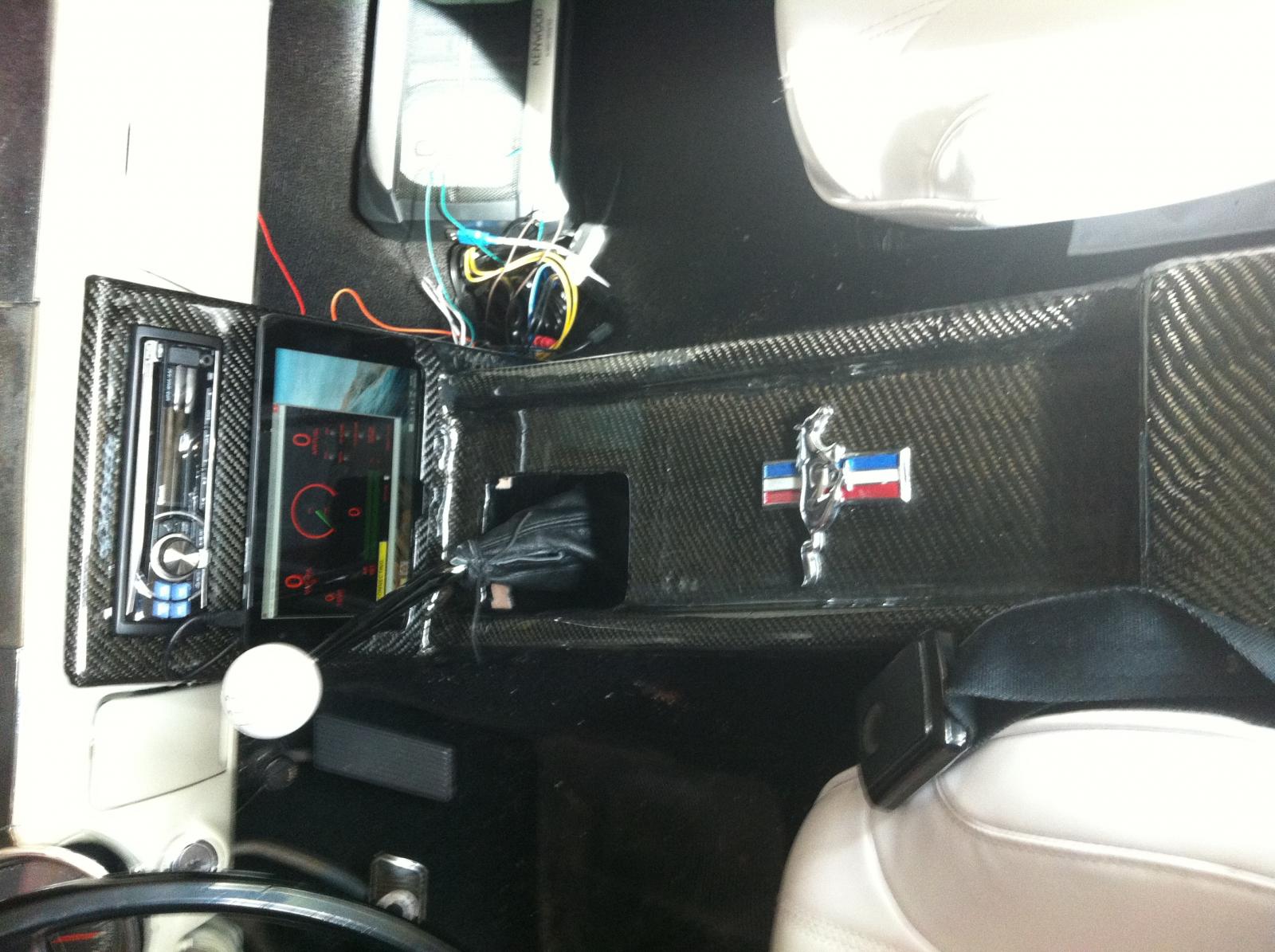

      I picked up the little 8" Dell tonight. Was able to drop the resolution to 800x600, at which point the EFI software nicely fills the screen (this software, for the Powerjection III, has a fixed window size)
      Need to finish the console and see how it works.
