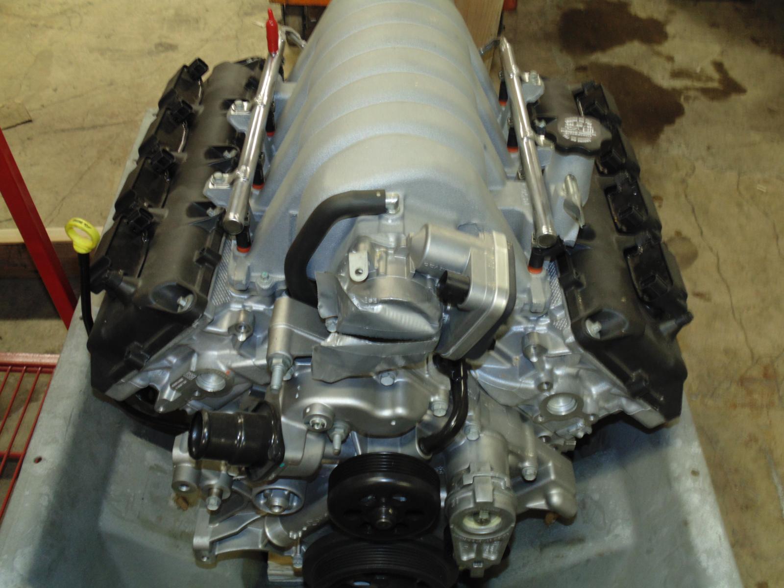

      Engine/Trans:
      Dodge Gen 3 7.0L Hemi 426 stroker
      Stock Harness and Computer
      4l80e with paddle shifters
      Still on the fence about a supercharger or staying all motor, so any opinions would be appreciated

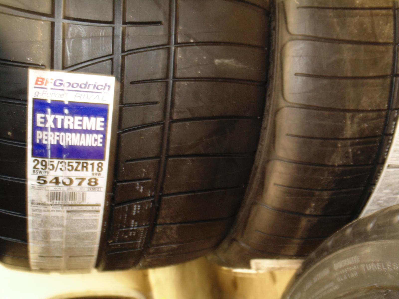

      Wheels/Tires/Brakes:
      Forgeline Premier ZX3P titanium finish
      BF Goodrich G-Force Rivals
      18x11.5---315's (rears)
      18x10.5---295's (fronts)

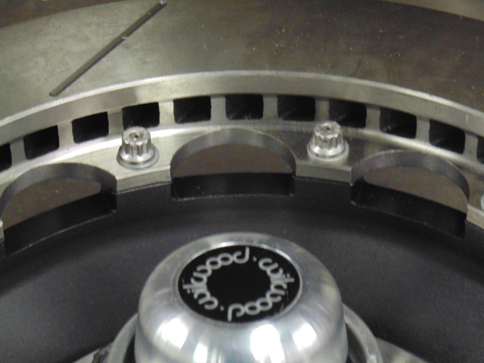

      Wilwood 6 Piston front calipers with 2 piece rotors
      Wilwood 4 Piston inboard mounted rear calipers with 1 piece rotors

      Nice project! Is that an aluminum 426 crate? I would leave it NA if it is. Boosting a 426 doesnt really have any advantage over a 3.79 stroke 400" engine other than it sounds faster saying 4-2-6 lol! The shorter stroke engines seem to live ALOT longer in the 1000+hp range under boost without the extra cylinder thrust.

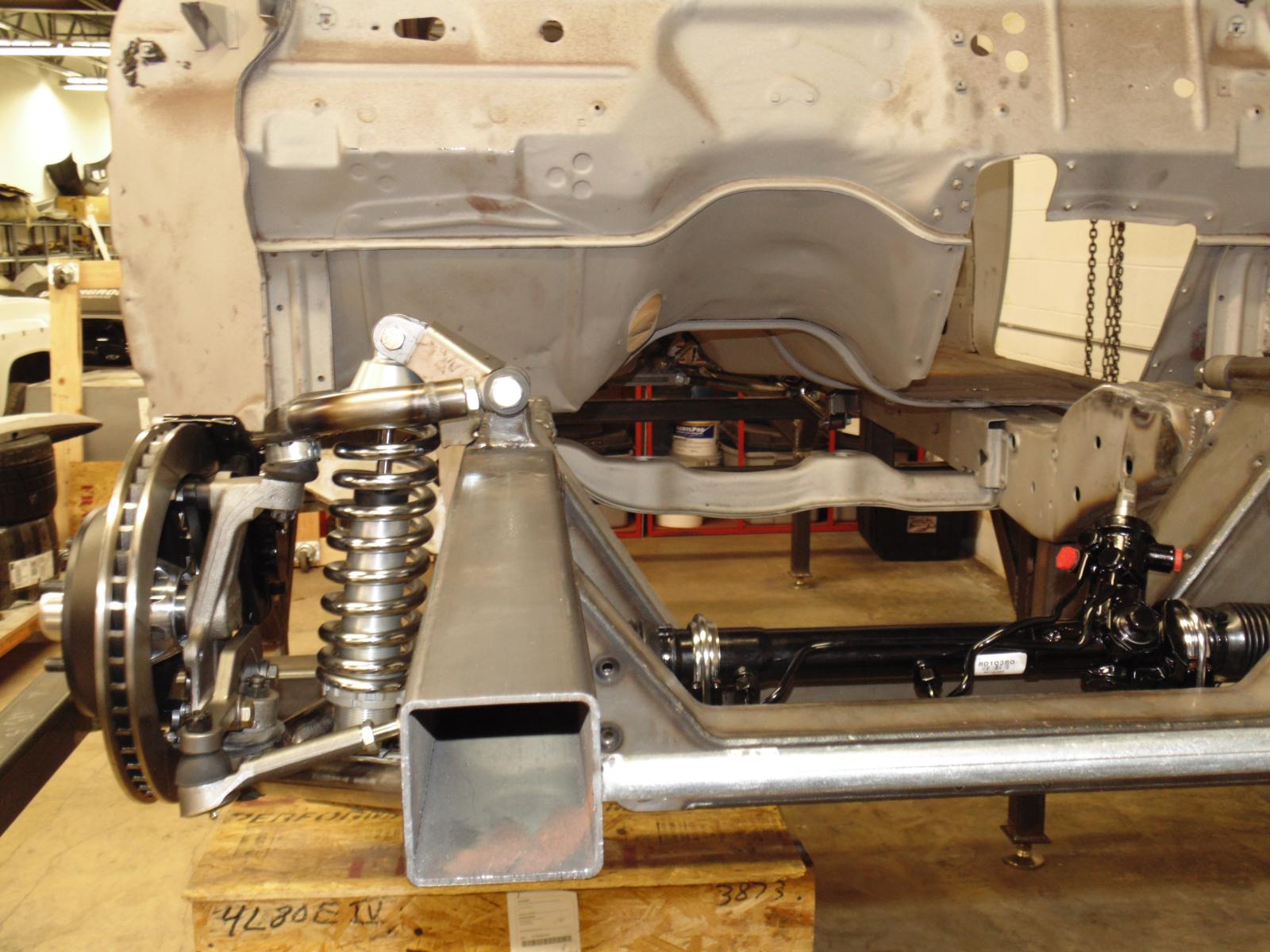

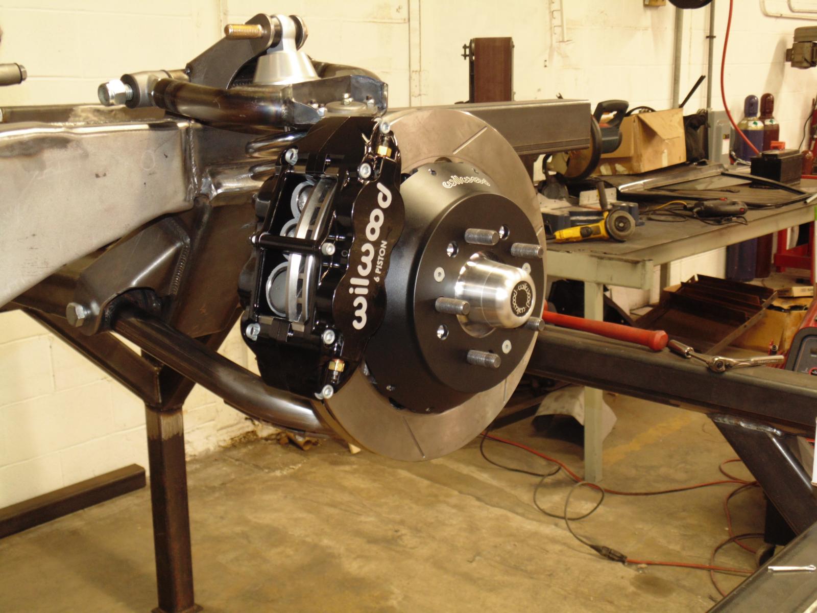

      Update

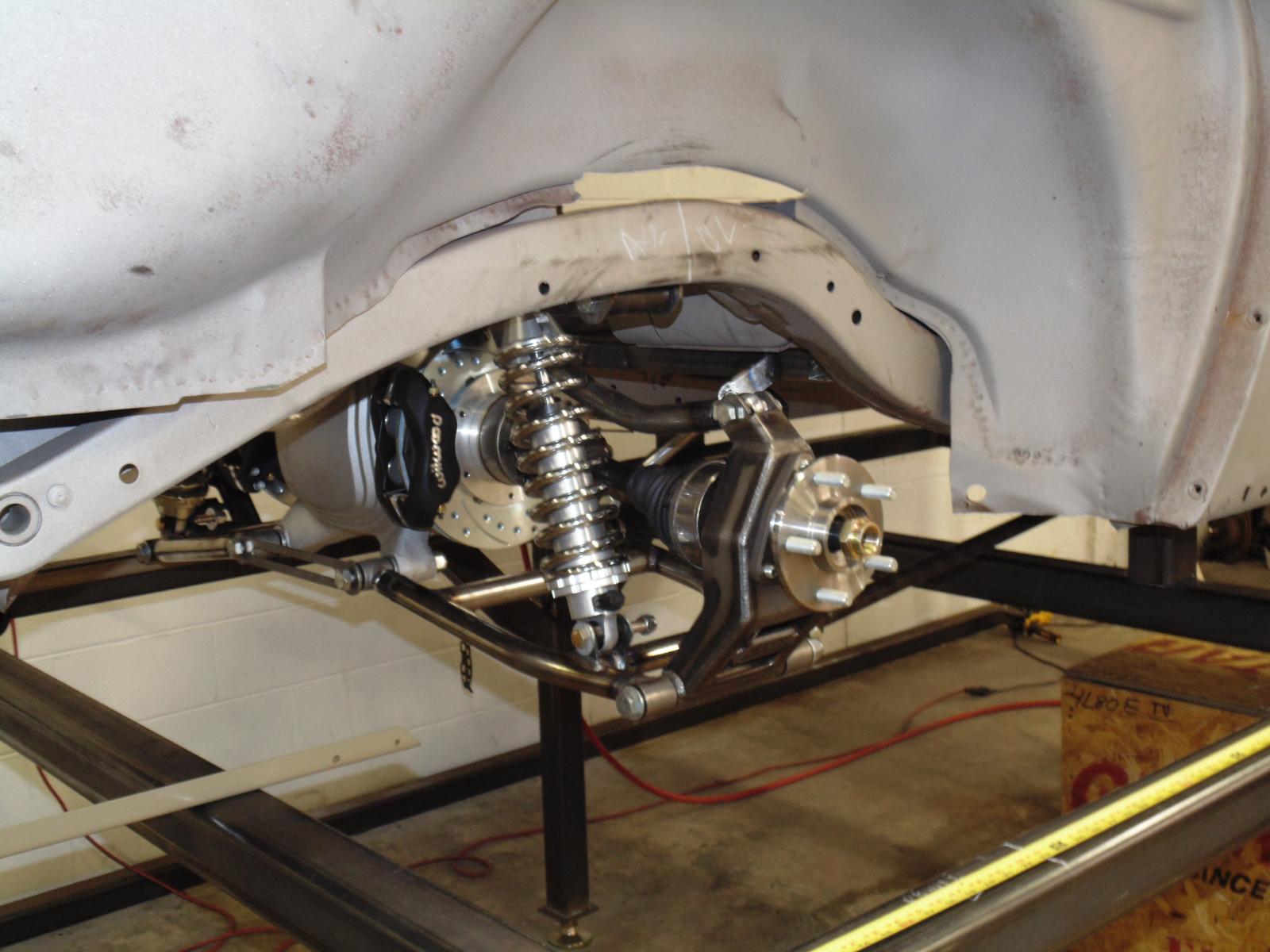

      Small update for you guys, started assembling the front end, rotors, bearings, caliper, rack, and sway bar. Wheel will be here next week and we will have some better pictures with wheels and clearances. Enjoy!

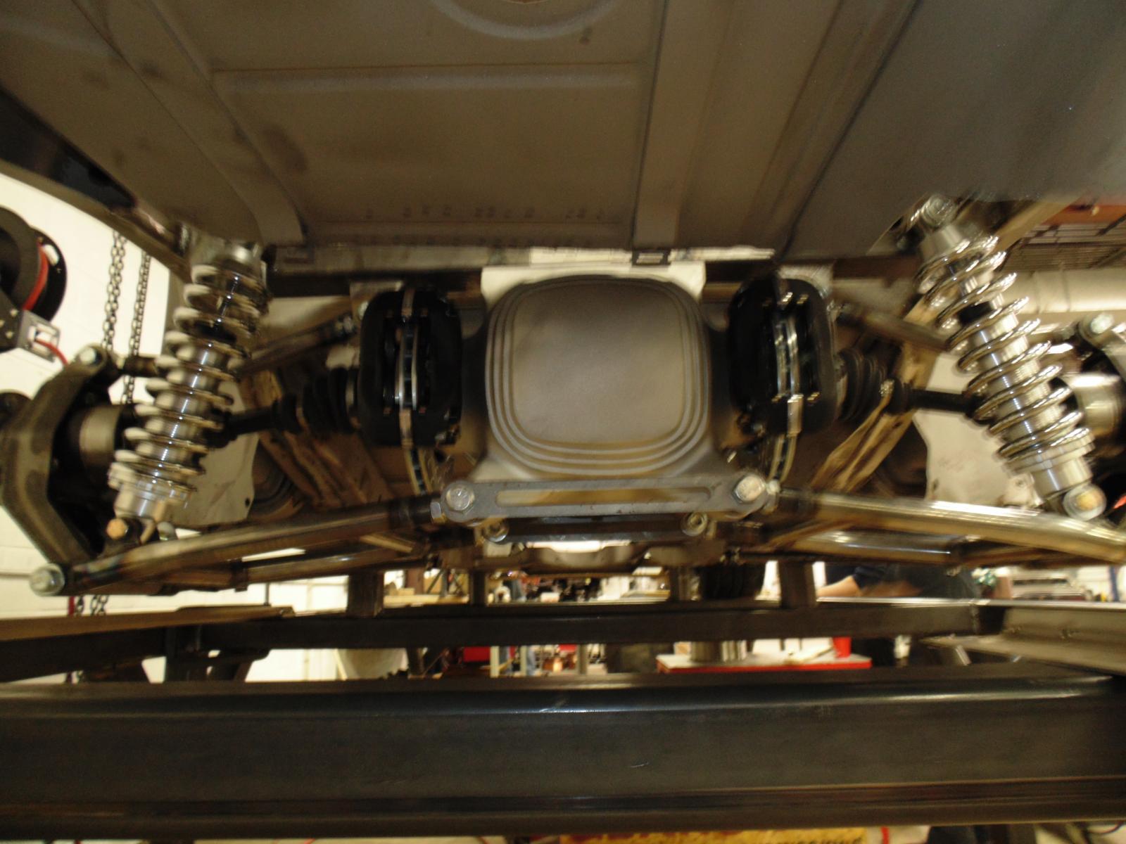

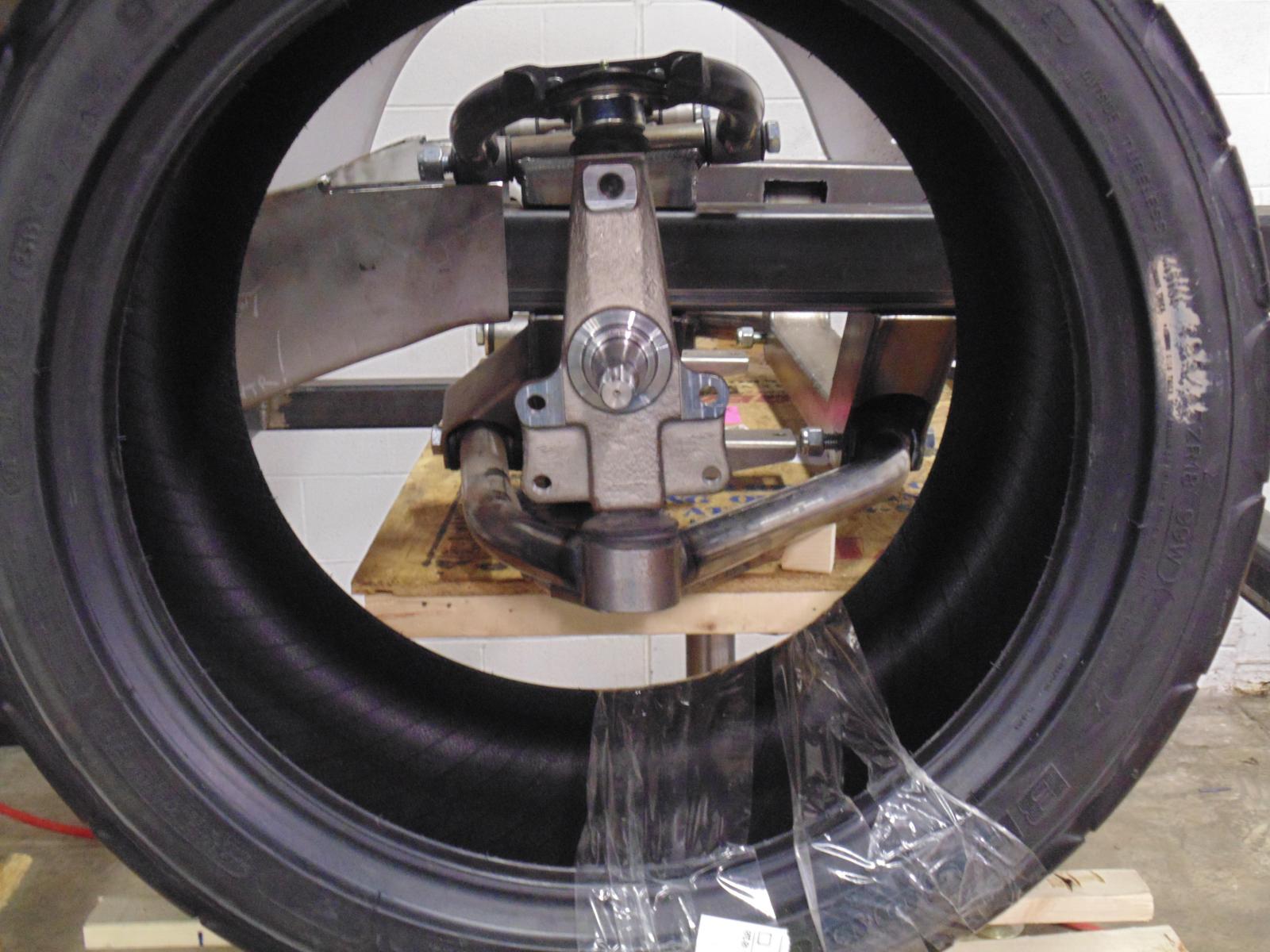

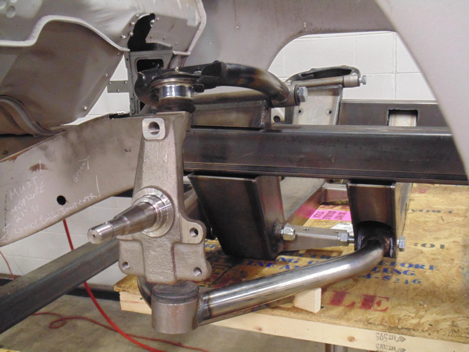

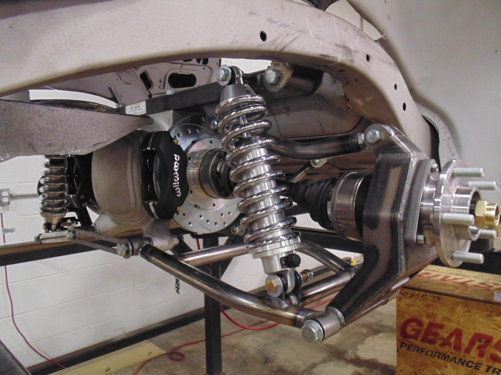

      I would love to see a top/plan view pic of the front upper A arms, they look from the partial pic as rather nice and robust.
      Nice build.
      Aug 2012
      21
      will get requested pictures for you tomorrow!

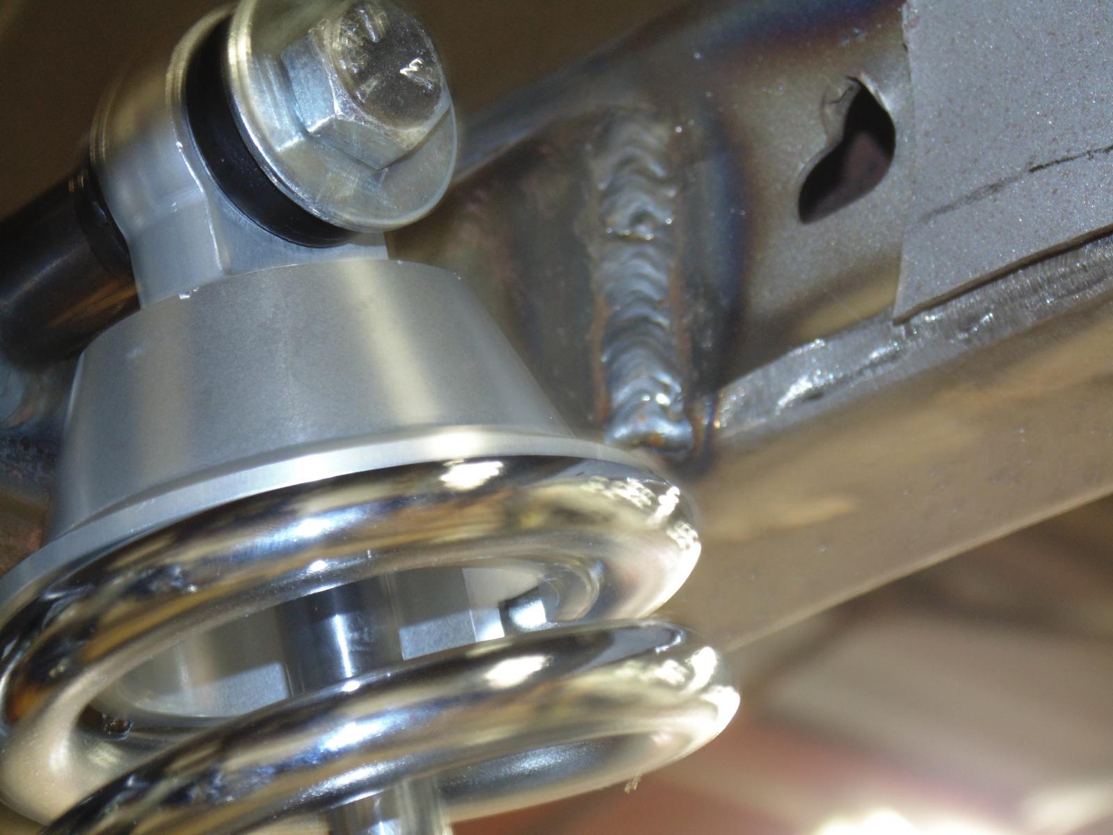

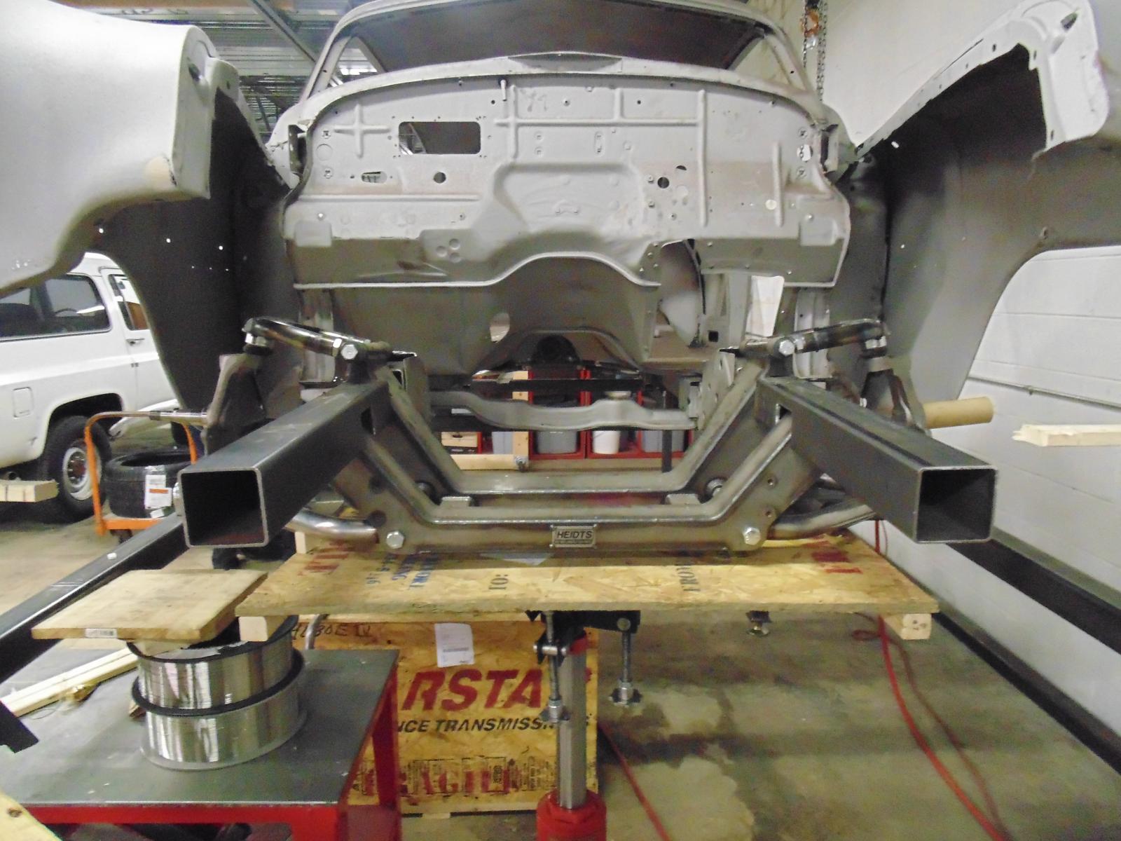

      little more progress, short day today as we found out we need a new oil pan with the sump mounted in the rear to clearance the crossmember and rack.
      Also, colors for frame and suspension will be decided tomorrow!Name:  DSC01574.jpg

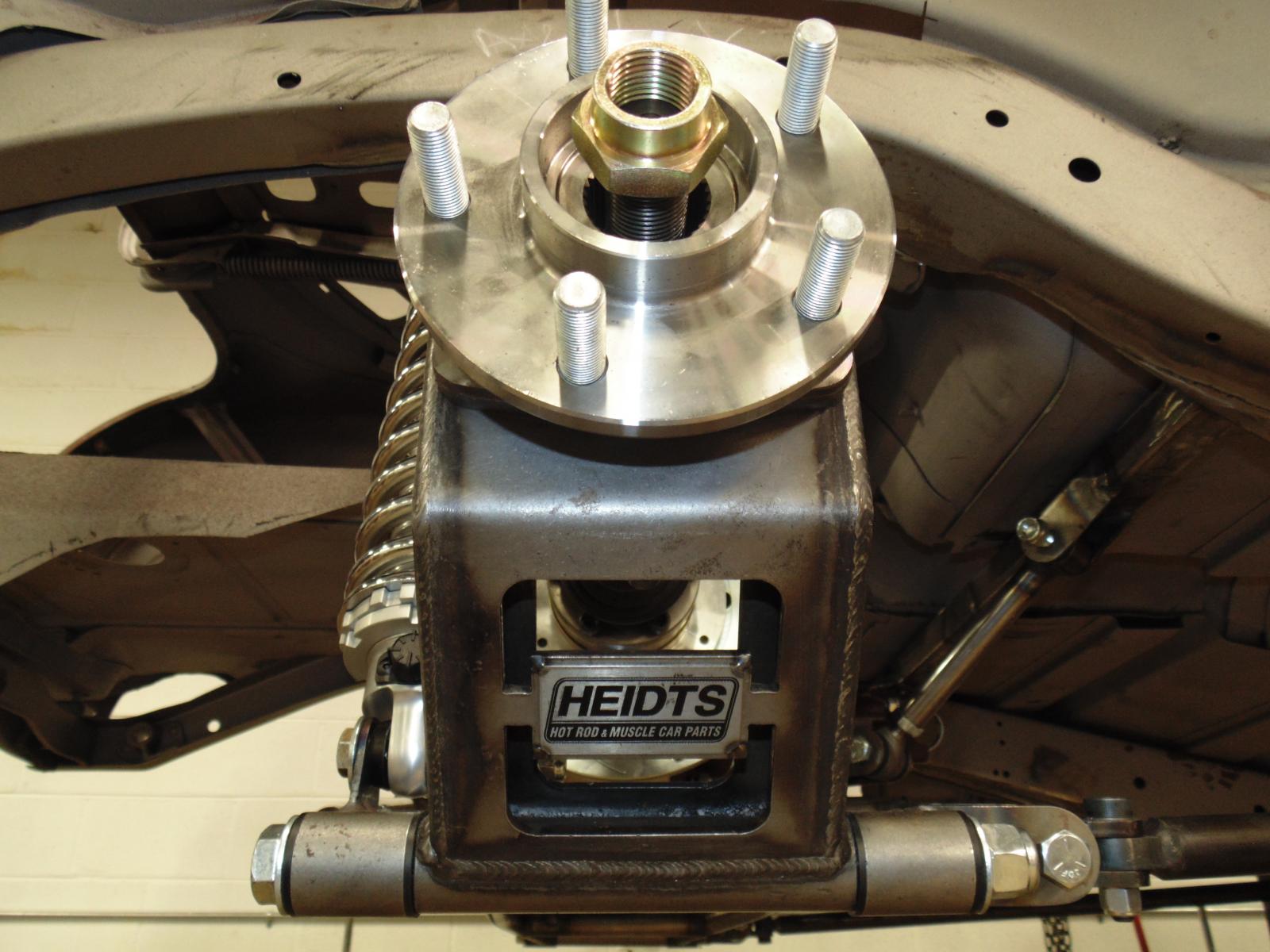

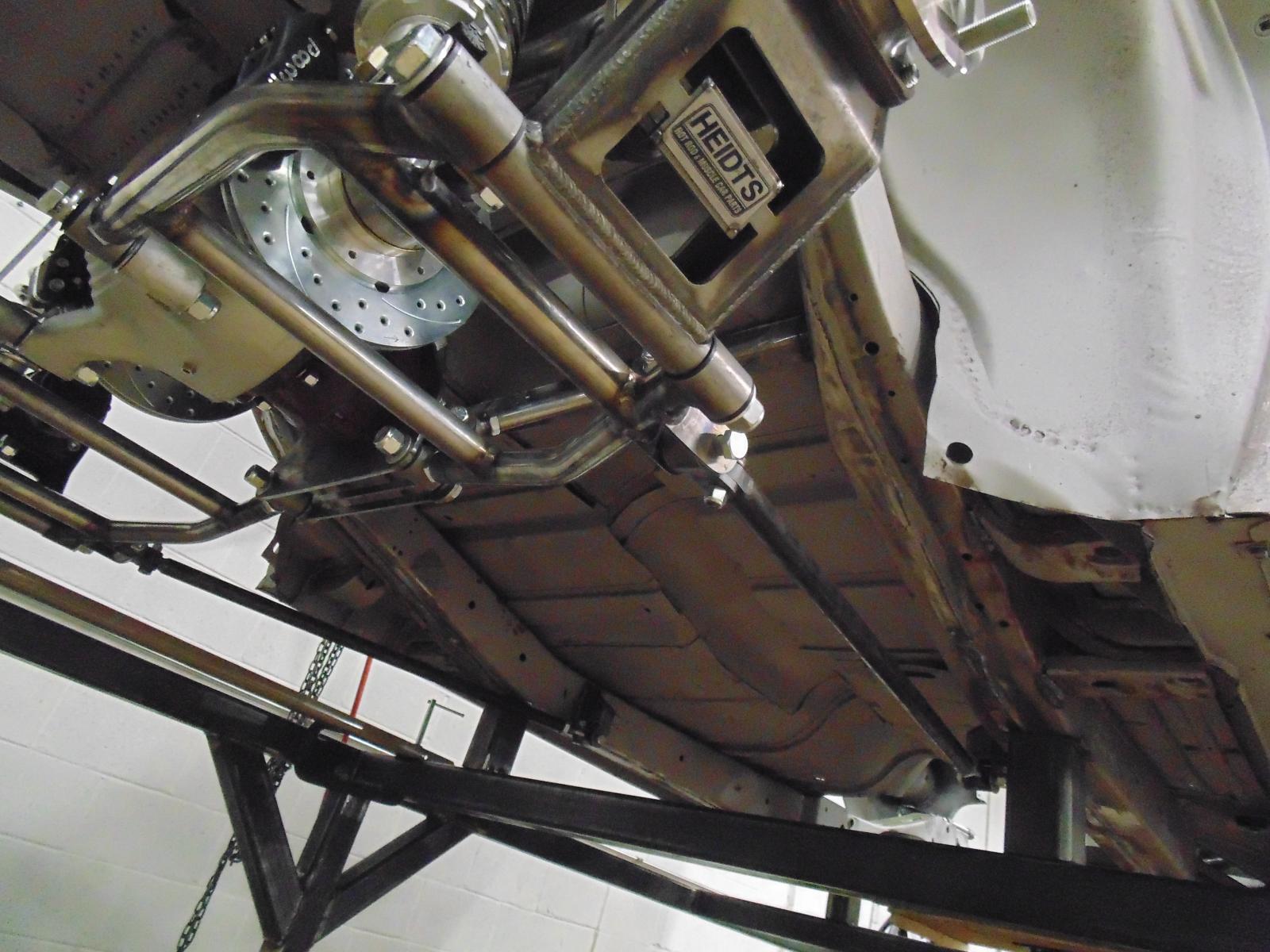

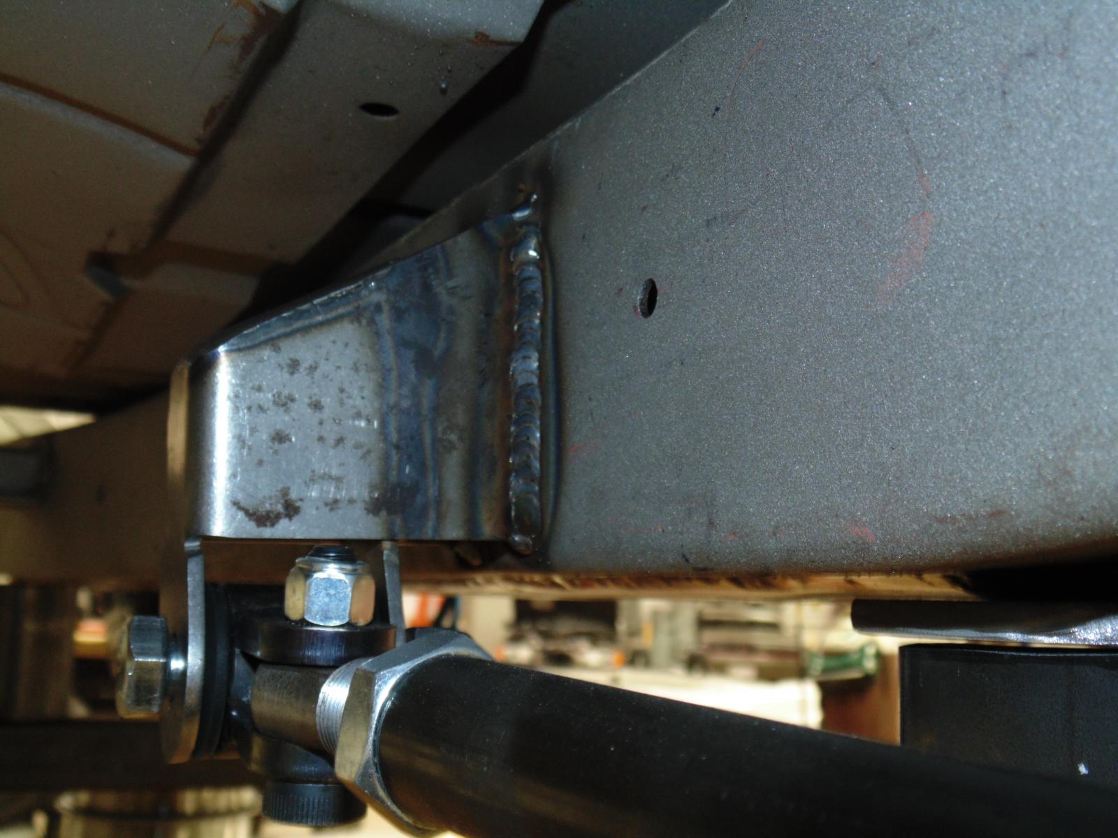

      So looking closer at the IRS, I see a lower radius rod attached to the LCA, which begs the question, how is the radius arm arc absorbed by the LCA, and second question, what similarily restrains the upper control arm? It looks nice in place, just trying to figure it out.
      Aug 2012
      21
      Not quite understanding your second question. To answer the first question, if you look closely at the pictures you'll see the pivot points for the radius arms have bushings and heim joints to allow for movement. Hope this answers your question!
      Quote Originally Posted by j-c-c View Post
      Dec 2012
      131
      Ok, so the lower radius rod offers compliance by a flexible bushing on one end, which was hard for me to see, but makes perfect sense. The other question was mainly, if the lower control arm needs a radius rod, why doesn't the upper control arm need one also? Doesn't seem like the lower one offers any restraint to the upper arm, Don't sweat the answer, I'm just trying to figure out the design thru your pics, and this is to say again is a cool project.
      Aug 2012
      21
      bump...wheels will be here this week!!
      Dec 2012
      131
      I saw a Heidt IRS display at PRI, and i asked the non engineer rep about the reasoning behind the radius rods, I give him credit, he said without any BS he didn't know their purpose exactly.

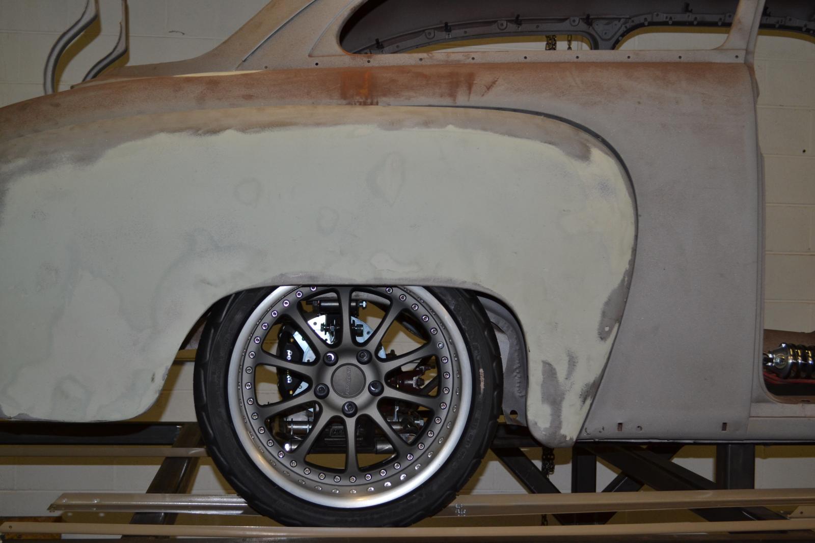

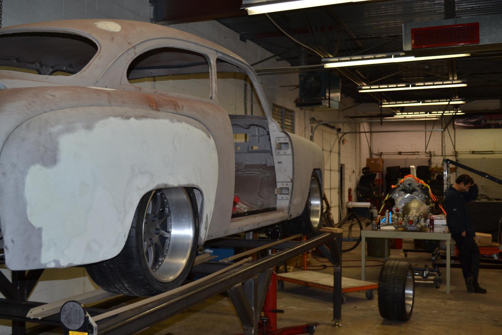

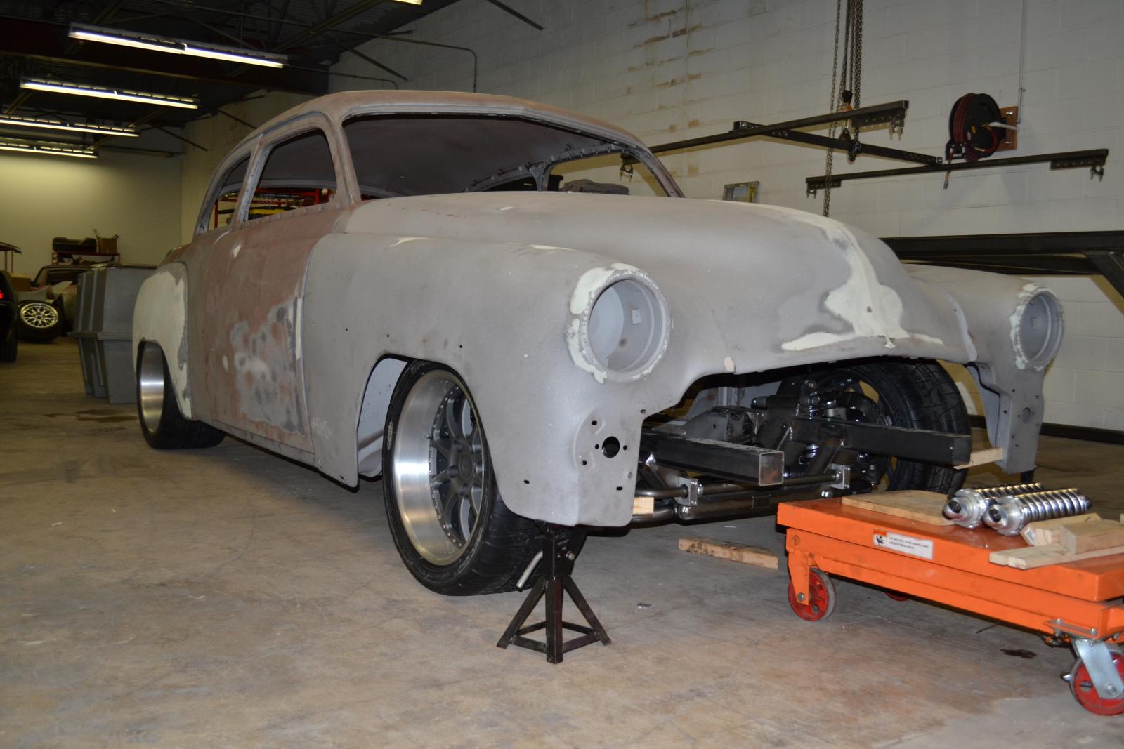

      The wheels have arrived!! here they are mocked up.. ride height in the front will be lower once the weight is over the front wheels. Next step is to pull it off the table and and mock up the engine and trans to make mounts for both of them!

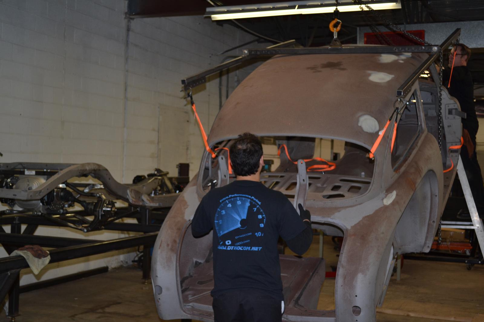

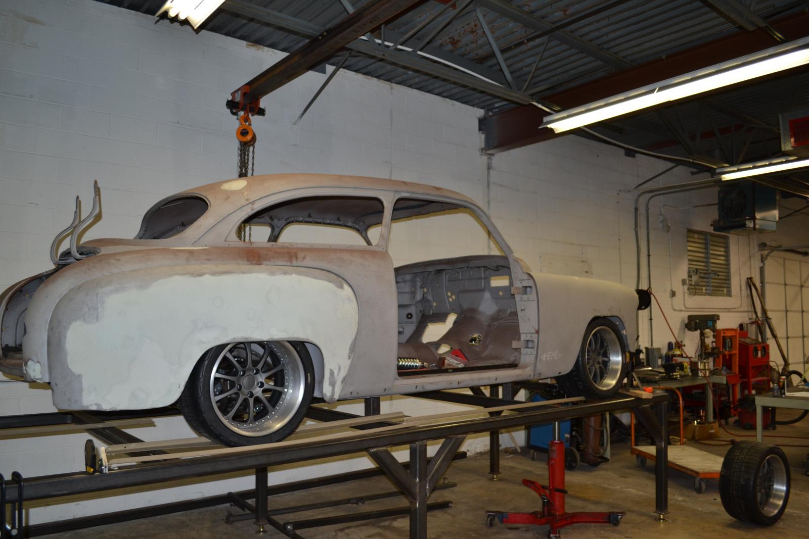

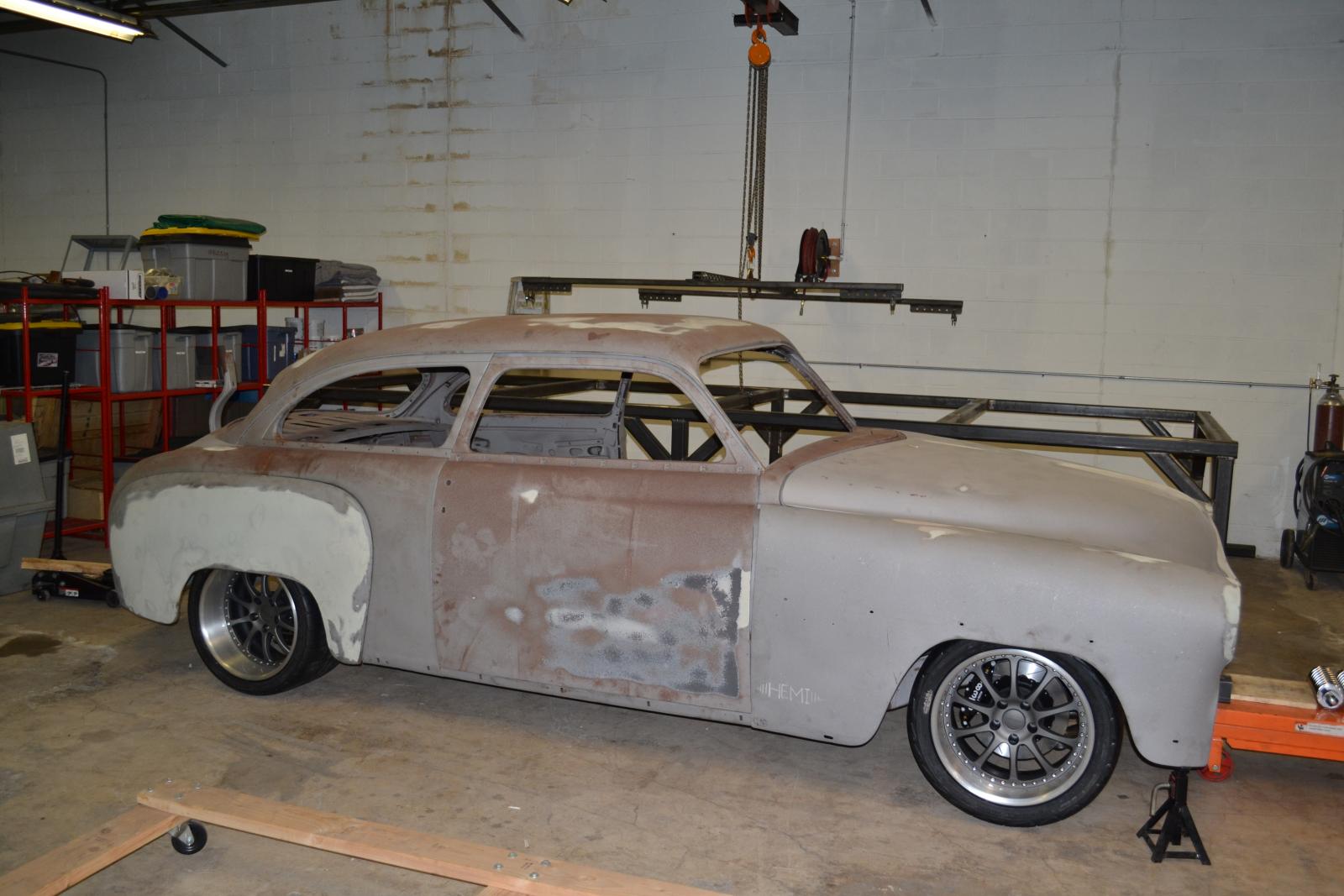

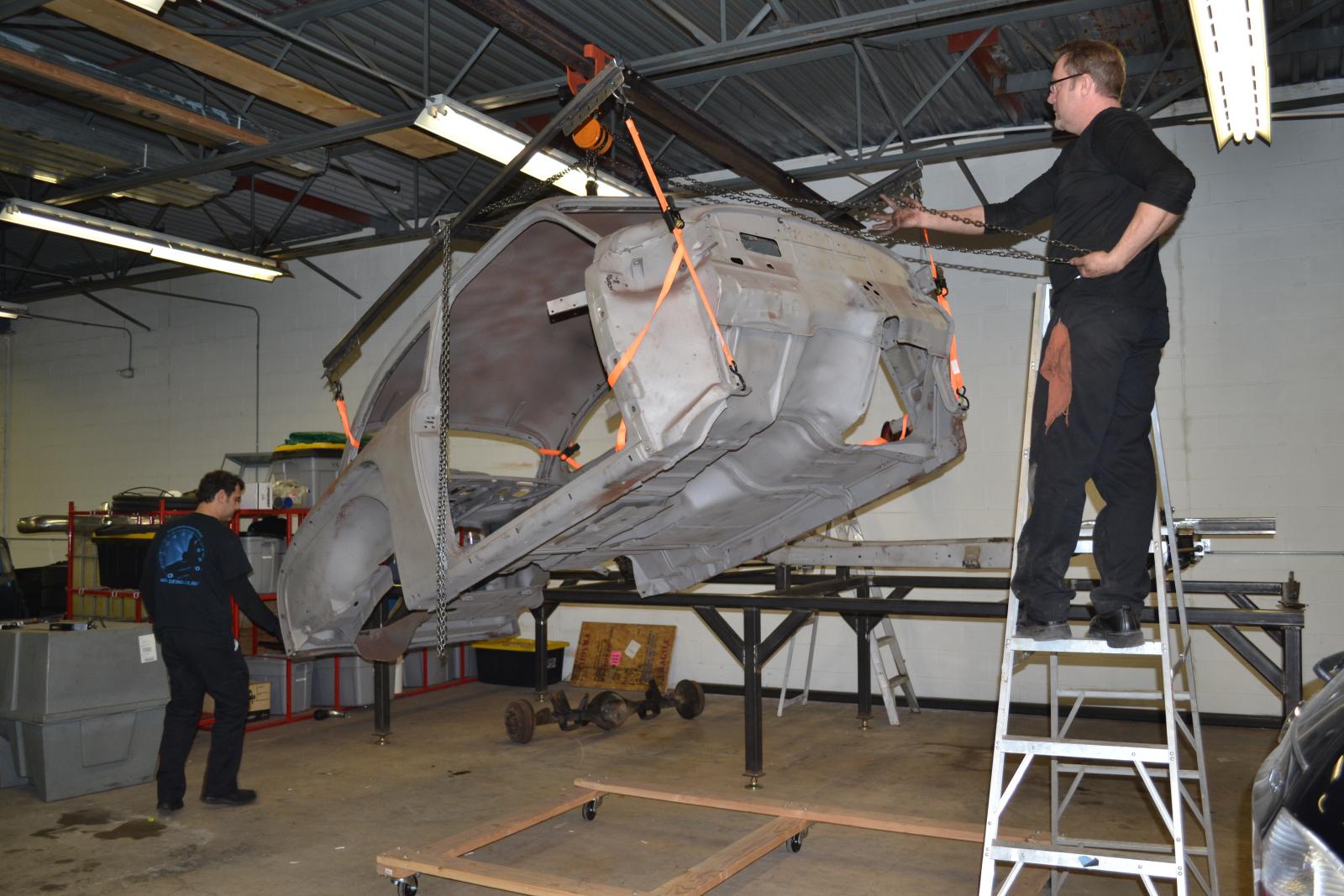

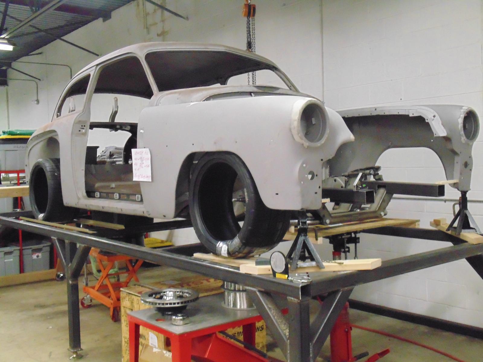

      Body is on the frame on the ground. Ride height is about set, we pull the fenders and rear quarters a bit to give us the clearance we need. The reverse oil pan is on the way for the motor so we can get the engine and trans set it.

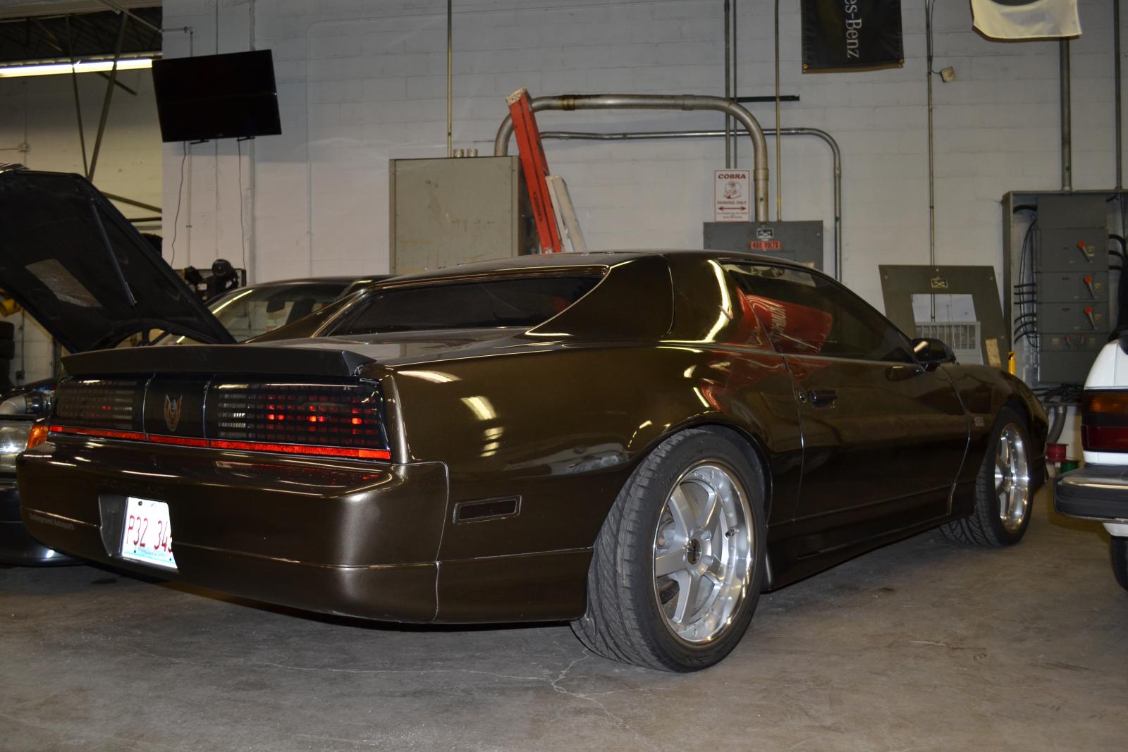

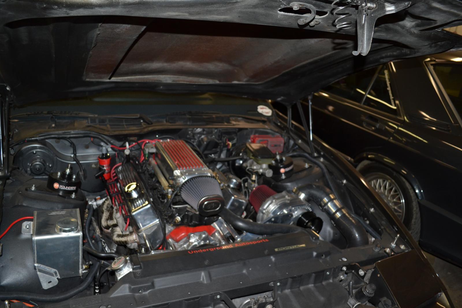

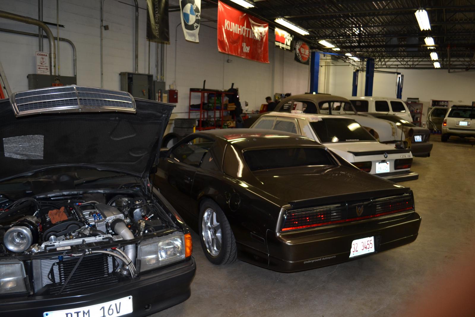

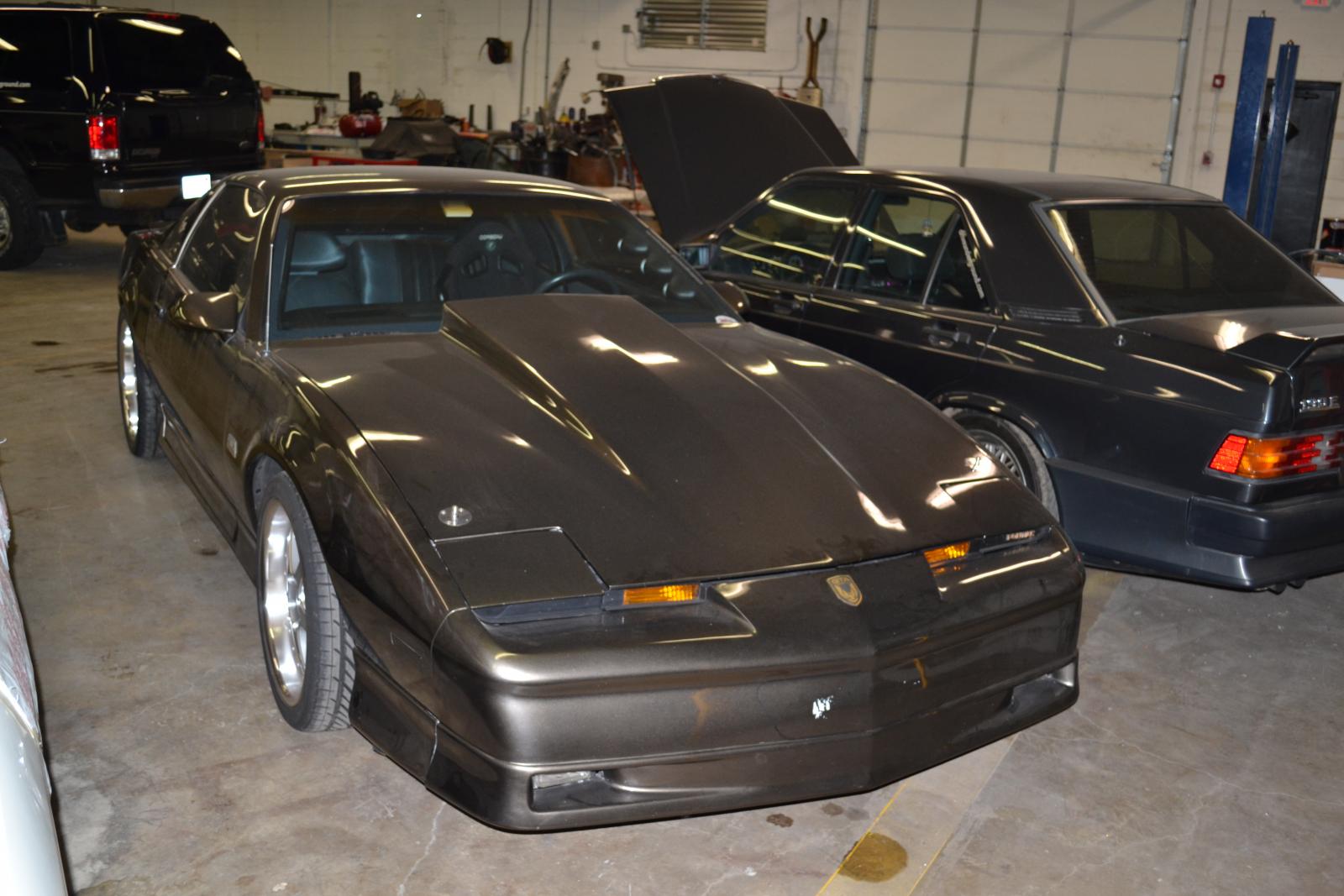

      A little teaser of one of our personal cars.. 87 GTA, 385 stroker, d1sc, qa1 coilovers, tubular subframes......and much much more.. This was the owners first car at 16, sold and bought back 3 times and now is here to stay for good.. Was featured with an interview at last years optima Challenge at Road America.Name:  DSC_0867.jpg

      The car has an awesome, tough with slight attitude stance, Very Nice.
      And please don't use the HD straps for rigging again.
