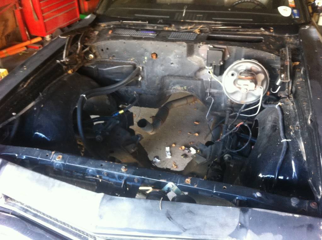

      Ok so here's a quick history of the car as it sits now. 68 Chevelle with Hotchkis suspension front and rear. Boyd 18x10 295-45-18 rear 17x9 245-45-17 front. 2000 LS1 4L60E trans.

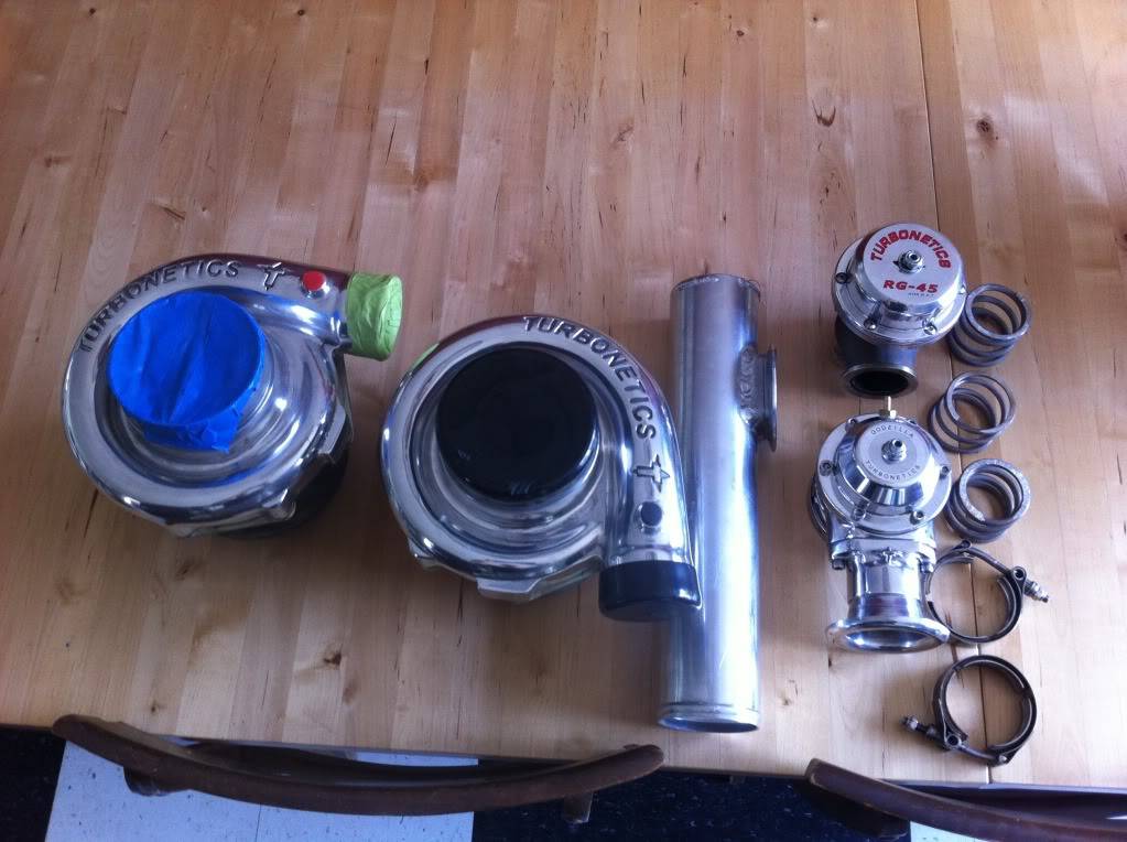

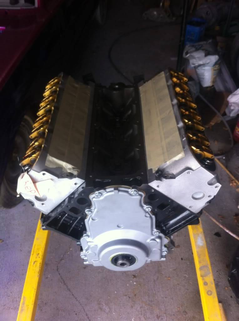

      And here's where we're heading. AES 390 Twin Turbo 4L80 trans. Shooting for 1000 whp. Comp Engineering back half ladder bar with Moser Fab9. Dropping the body 3 inchs and welding the frame to the body. 24x15 385-35-24 rear. 18x10 265-35-18 front.

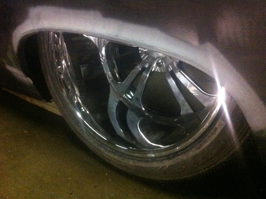

      Heres a quick update. Floors are rough cut out as is the frame. Ordered 48 feet of 2x3 .125 to start the frame. Raceline Jaded 5s 24x15 are ordered.

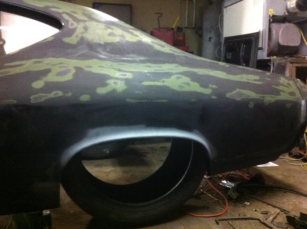

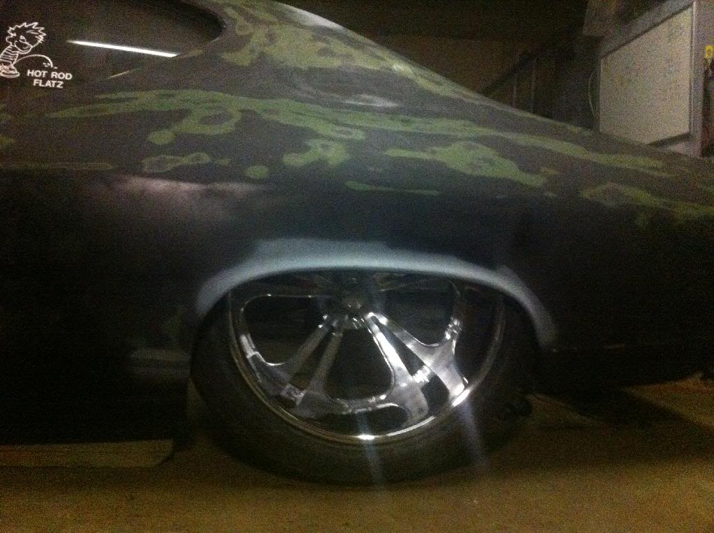

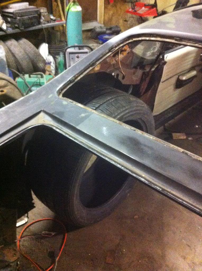

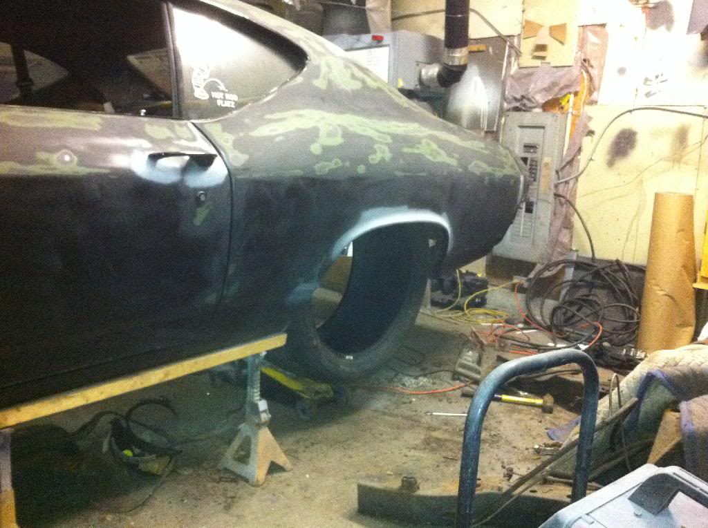

      The body drop ended up at 4 inches. Got the frame rails made and installed. Rocker height will be 4.5 front and 6.5 rear.

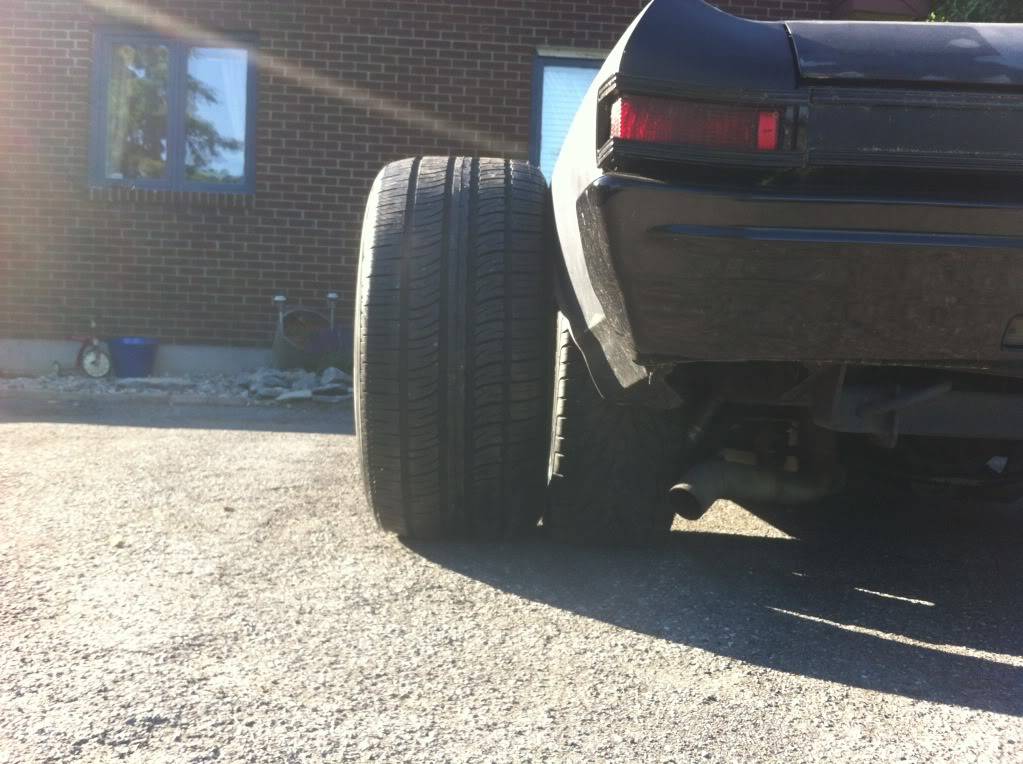

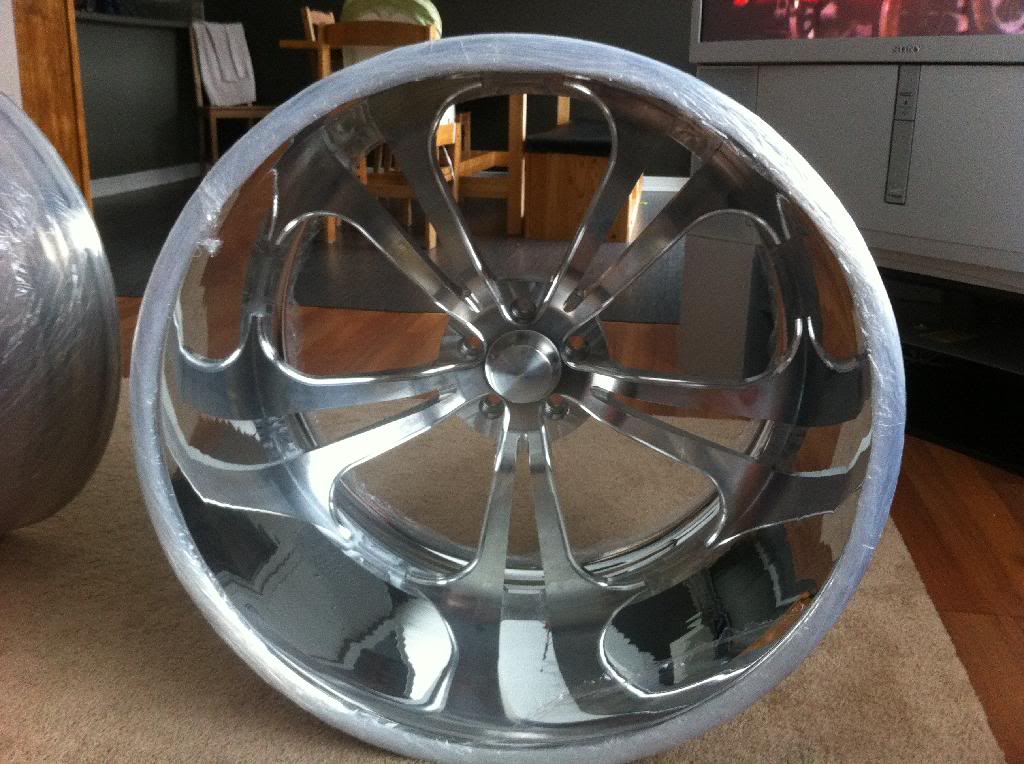

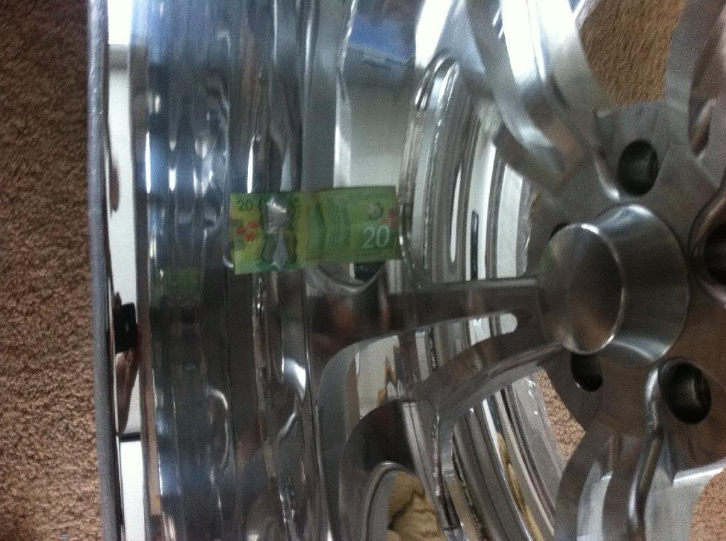

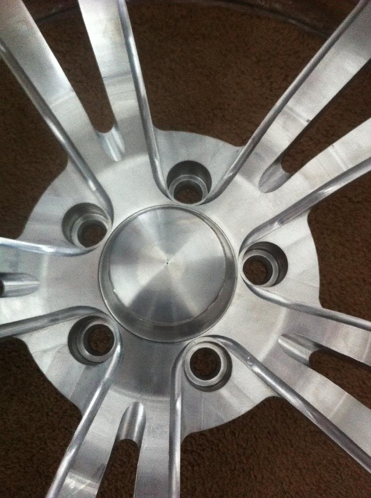

      Got my rims today. Wanted something different so we did a raw unfinished centre with polished tub. Huge thanks to Val at Raceline.

      not very pro touring but i love it. Do what you want. It is your car. i love the wheels and the tuck.

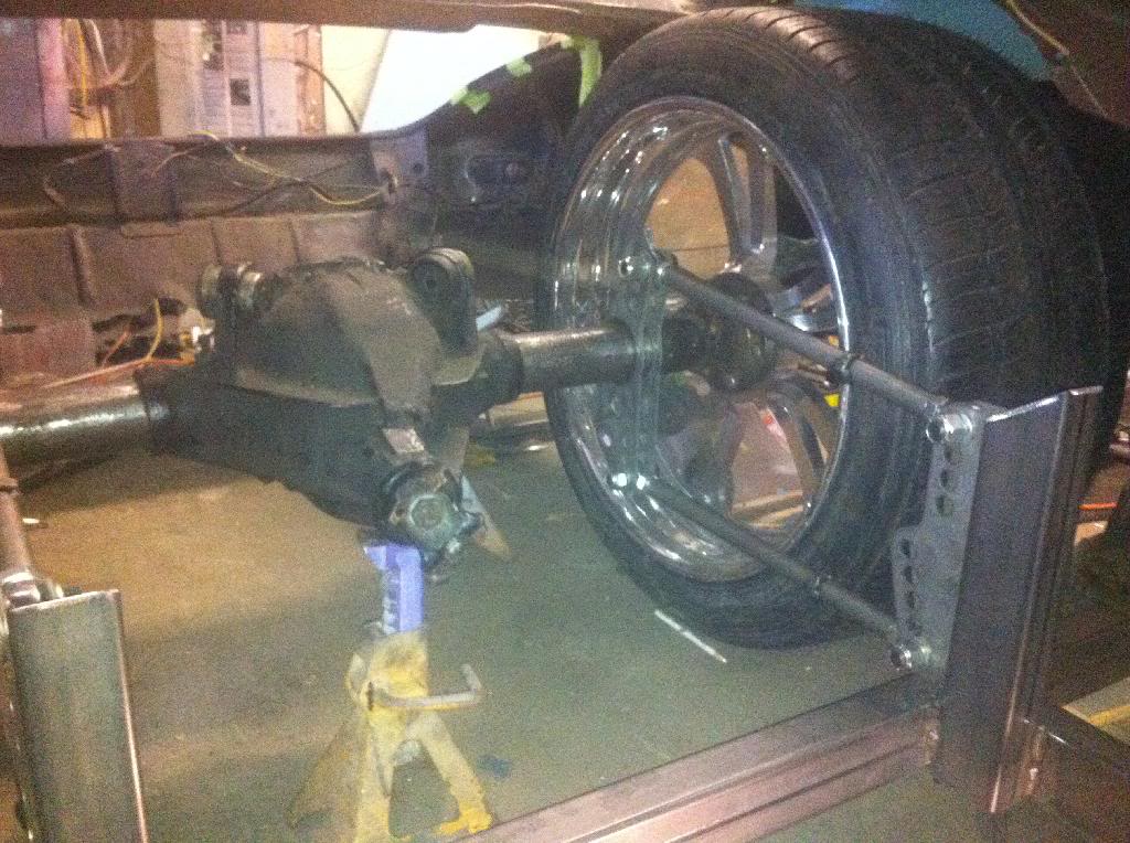

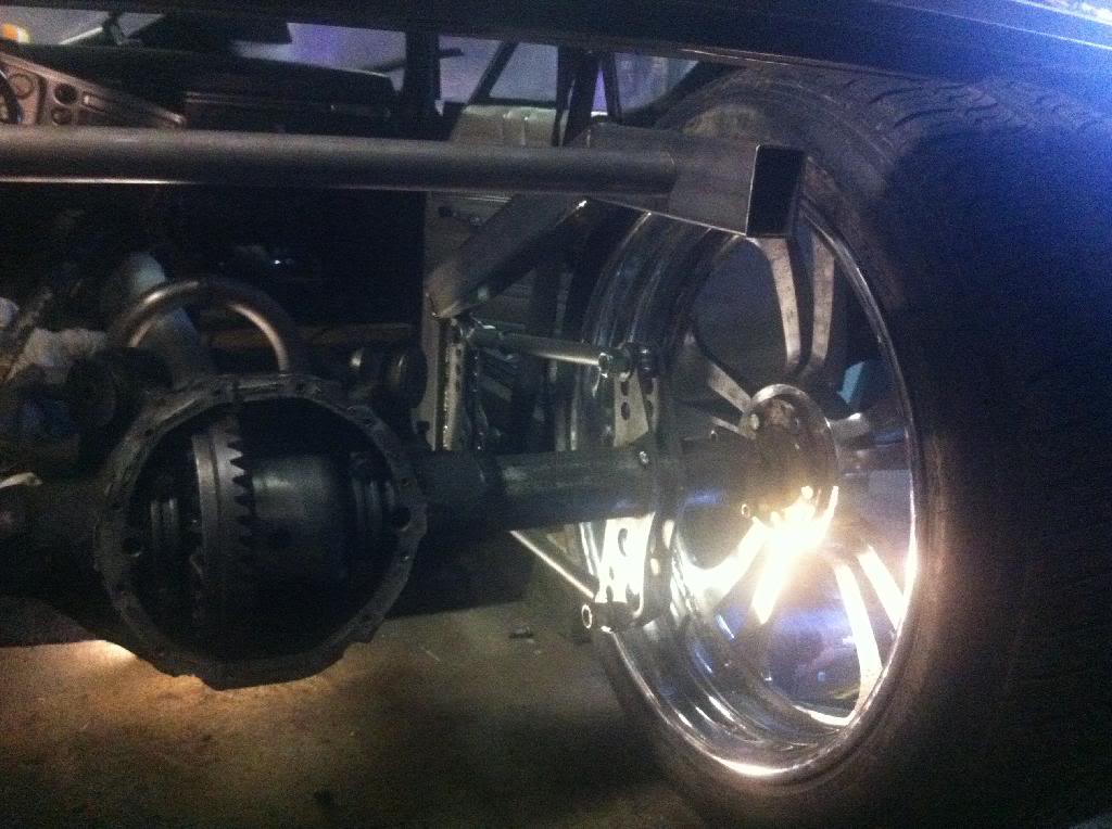

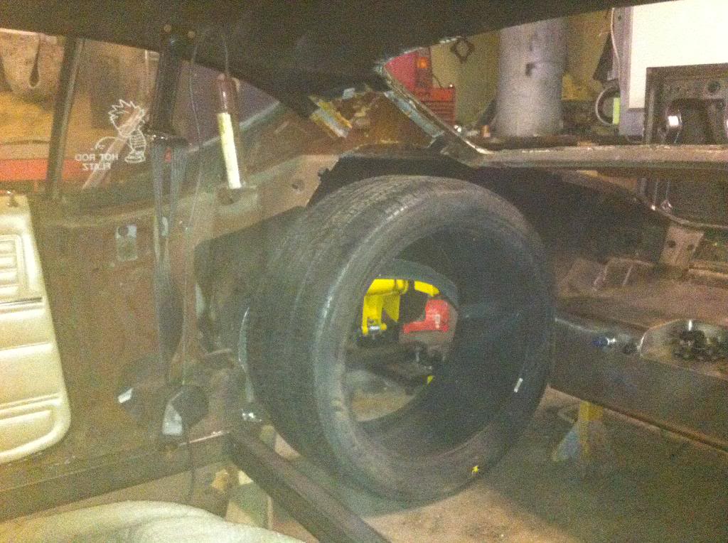

      Got the tires mounted today, took a while but got them balanced. Now I can start the back half and narrow the diff.

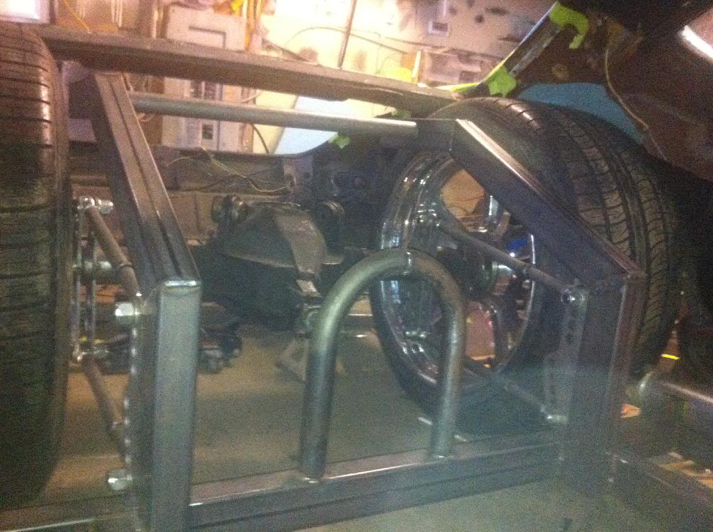

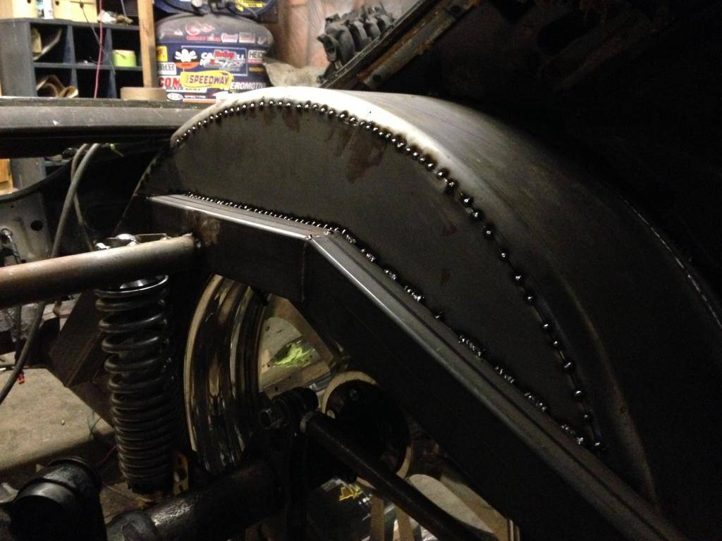

      heres a few new pics of the rear frame section and 4 link.

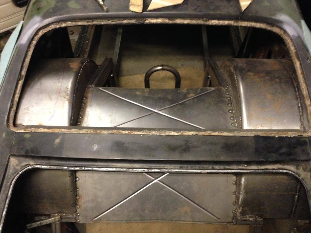

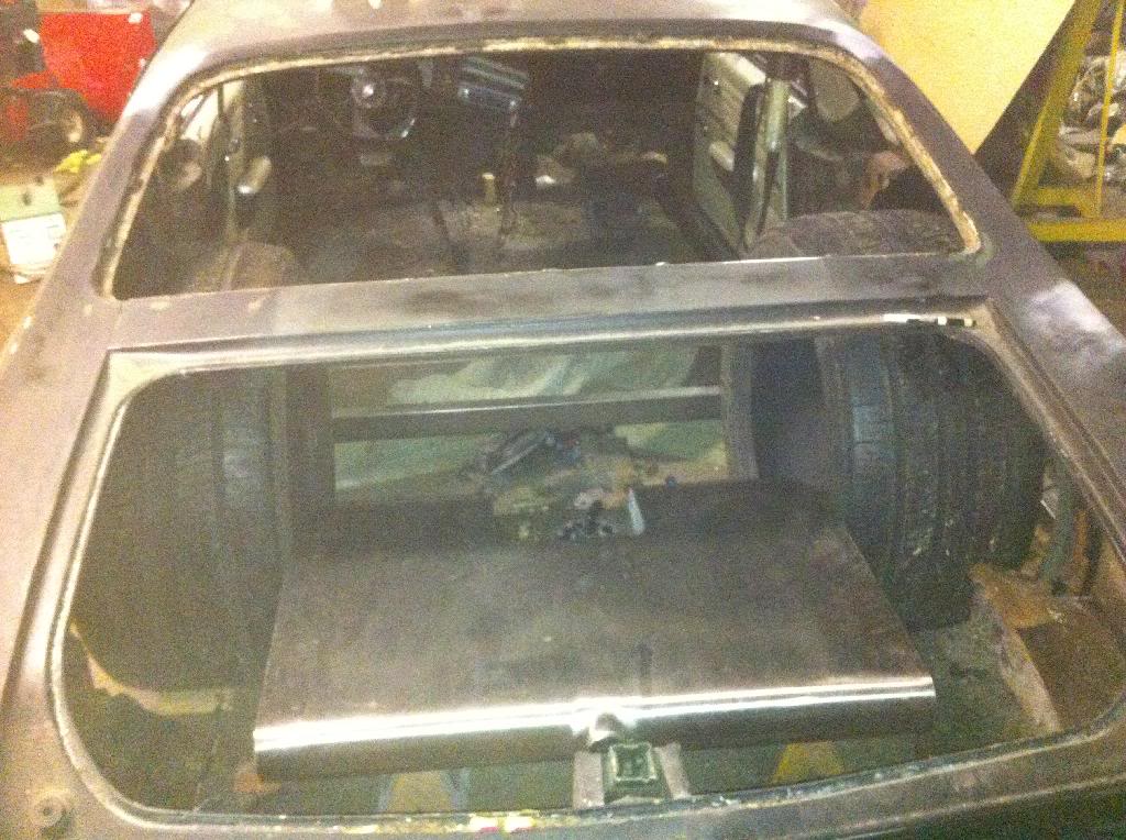

      Got the tubs in and the floors started. The rear suspension is pretty much done just a bit more welding.
