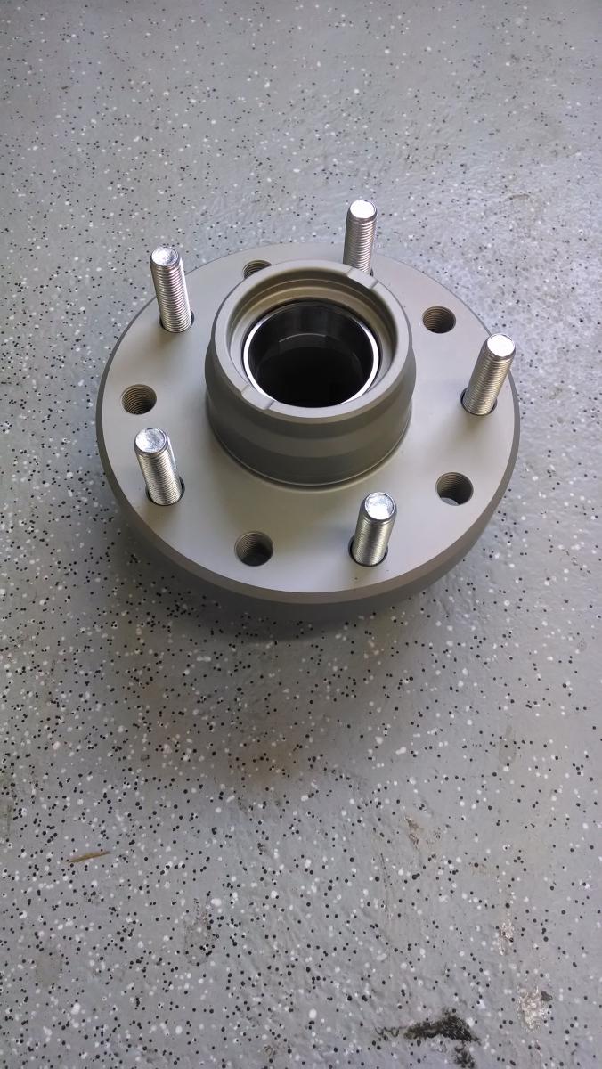

      Yup. Hubs are from Tobin.
      The wheels fit great...so far. They are 8" w/4.75 BS and 9" w/5.5" BS if I recall correctly.
      I will be finishing up the brake mock up this week. After talking to Tobin and reading other accounts, I think the caliper/wheel clearance should be close. I'll document any issues that arrise.

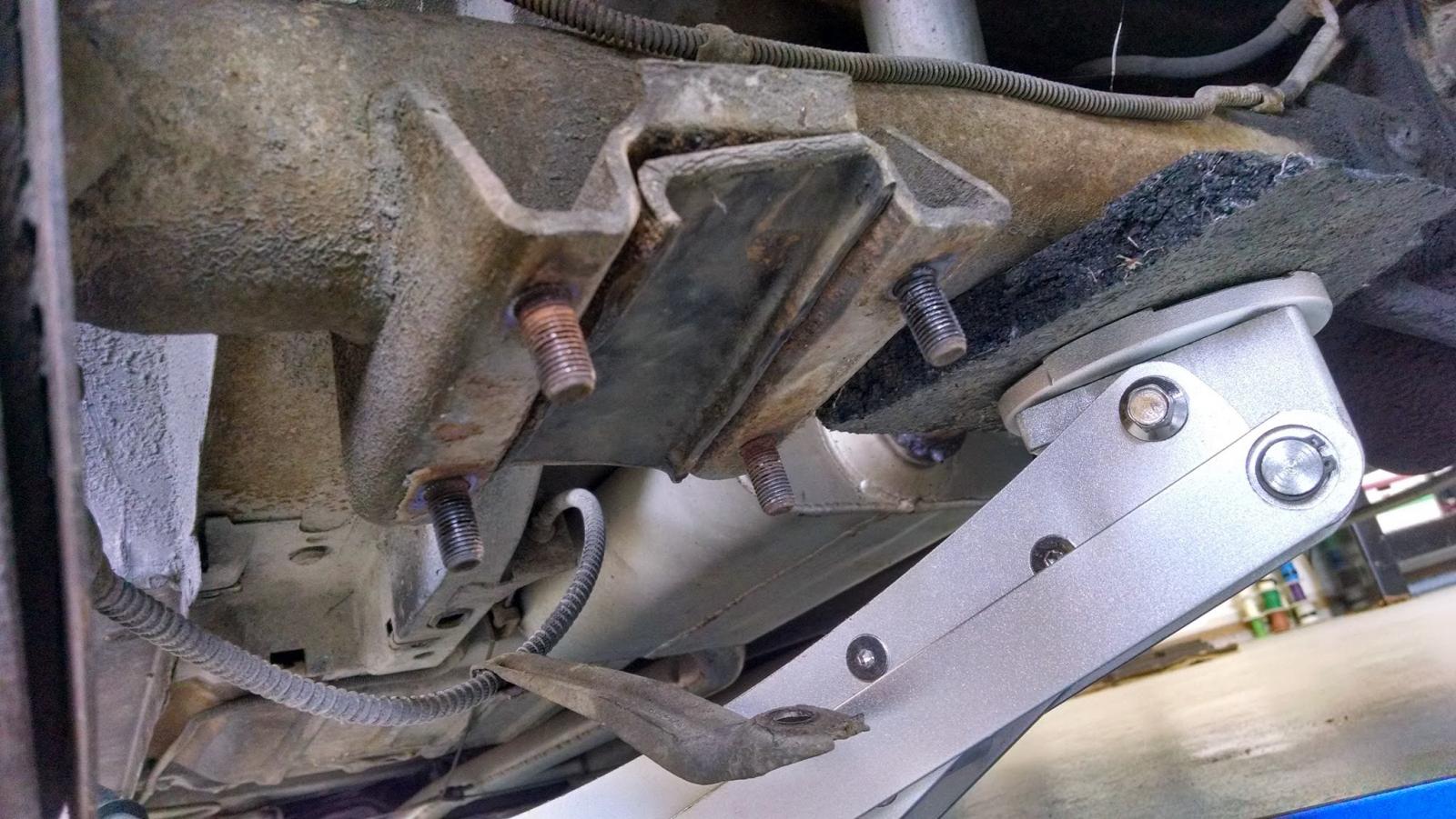

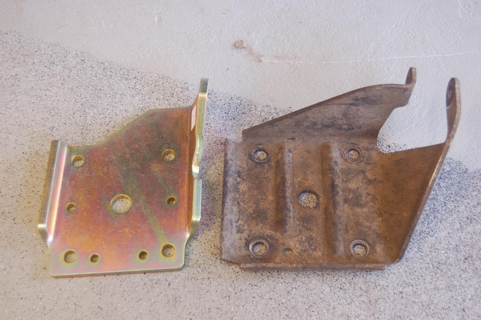

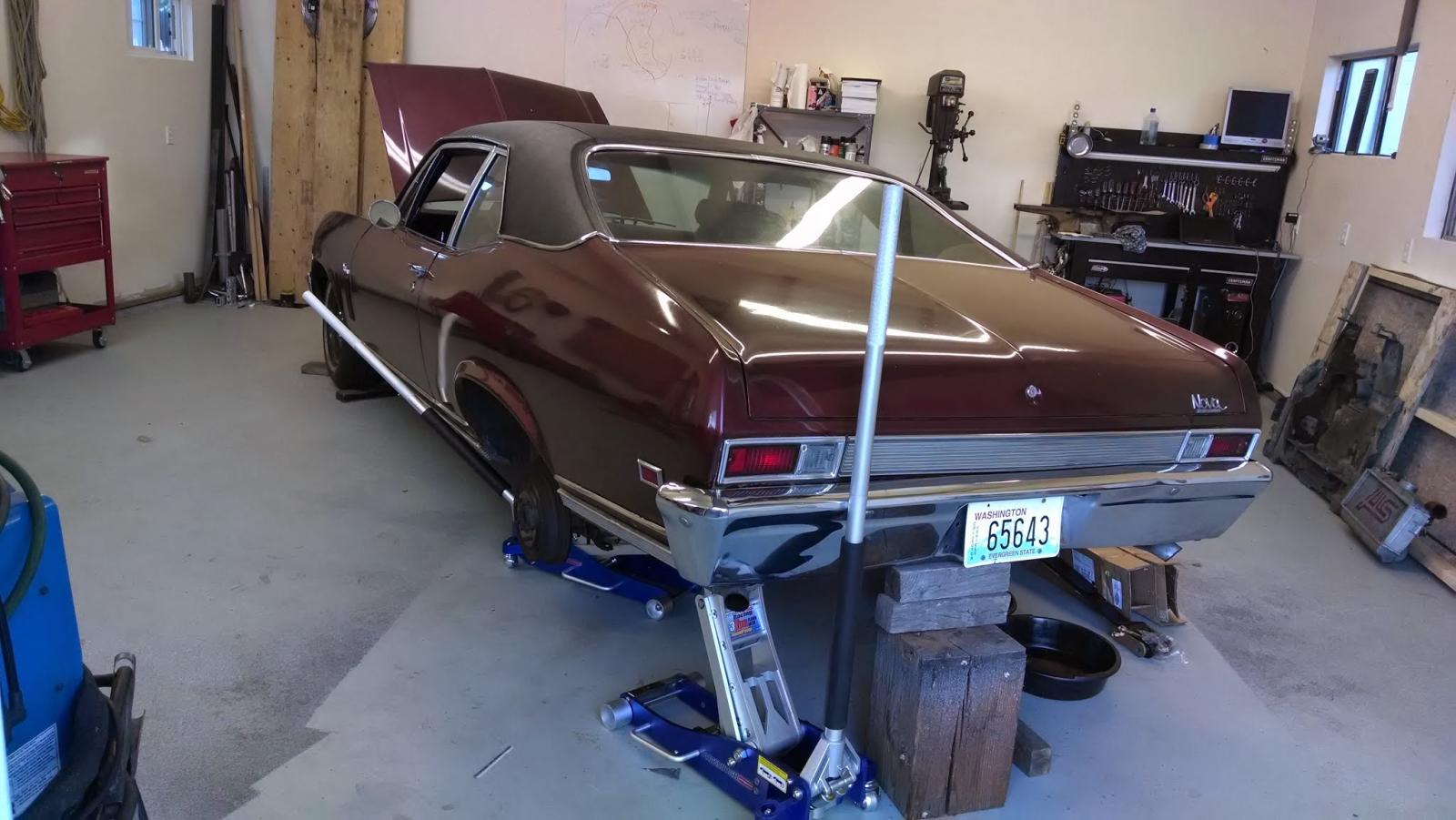

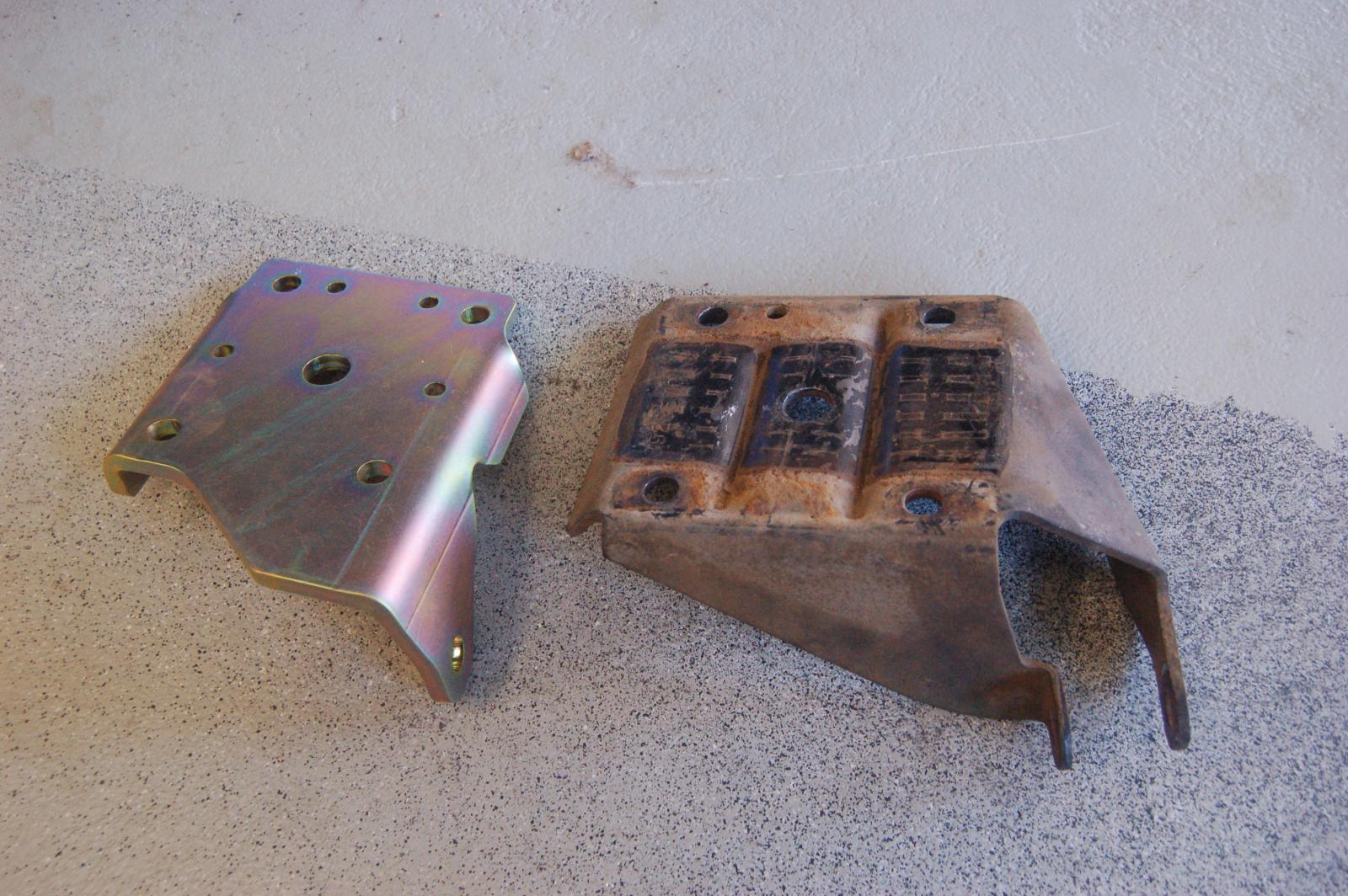

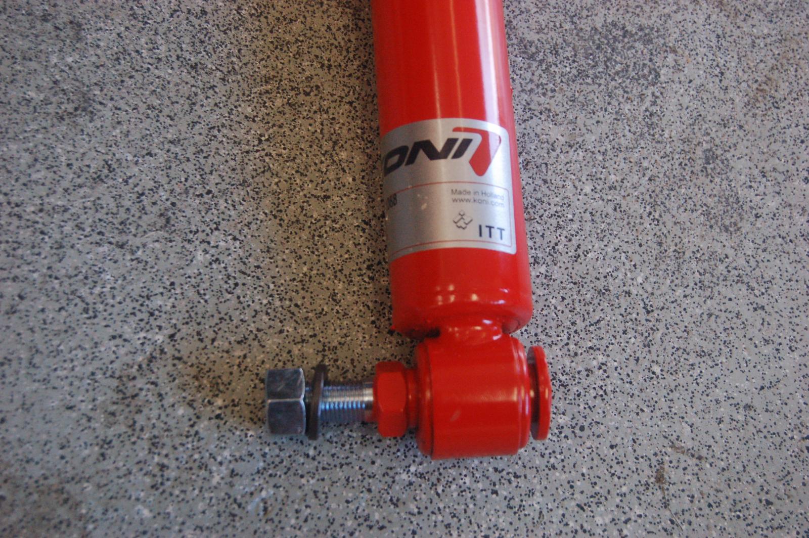

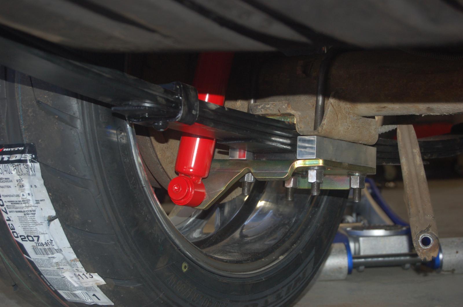

      New lower shock plates came in today so I was able to finish up the multi-leaf conversion. Something to note is that when you order a DSE drop leaf kit it doesn't include the multi-leaf u-bolt bolts, spacer blocks, or upper locating plate. It also ships with single bolt shock ends. If you use a shock with an eye on the bottom leaf plate, you need to find or order the correct shock plates ( I think they are just the normal multi-leaf plates). I'm sure all this is probably obvious but after talking with them about my conversion I was told I did not need a new plate ... which I then had to order later to finish the conversion.
Size:  268.3 KBName:  DSC_0264.jpg
Size:  219.8 KBName:  DSC_0266 1.jpg
Size:  305.6 KBName:  DSC_0270.jpg

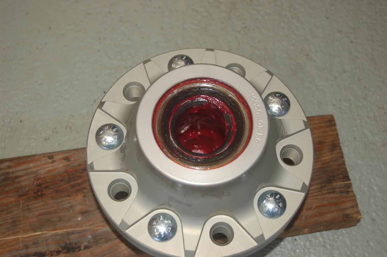

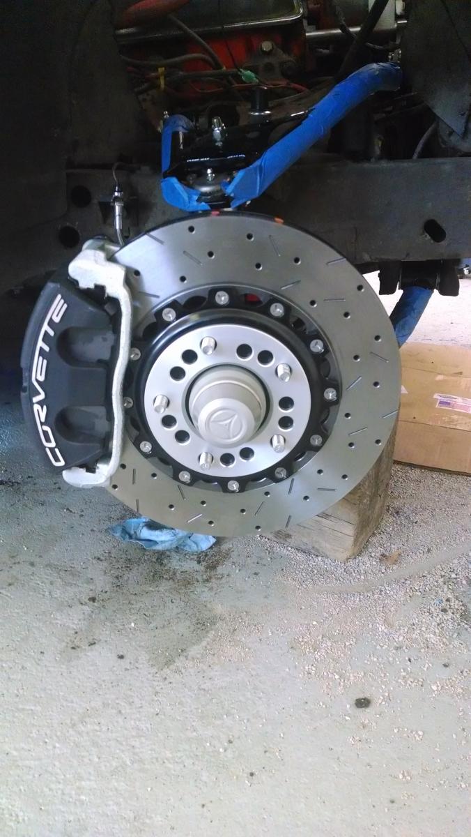

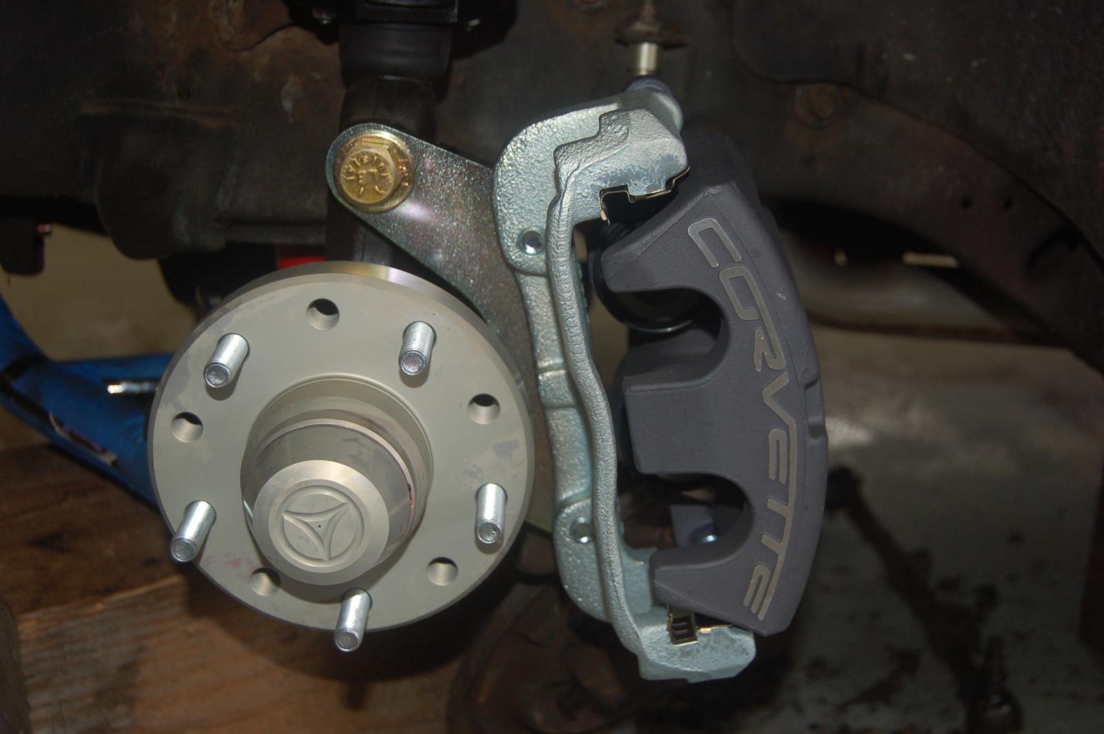

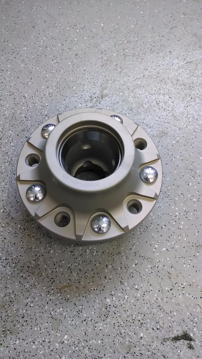

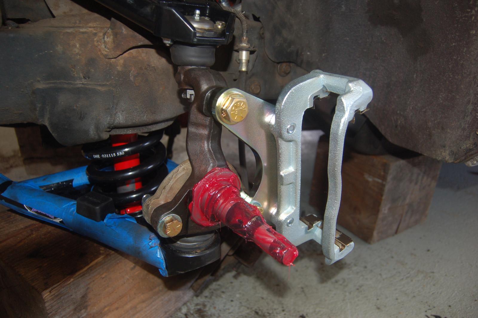

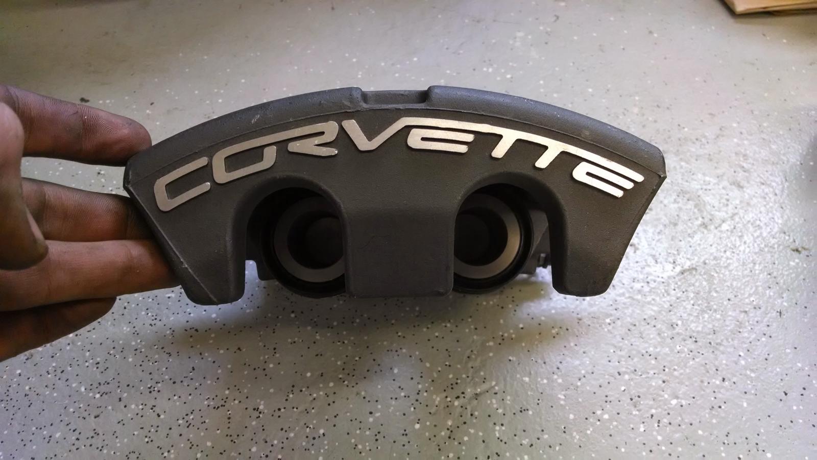

      I also worked on the front brake conversion today. Packed the bearings and installed the hubs. I also did a quick mock up of the wheels to get an idea of caliper clearance. Unfortunately I'm still waiting for the rotors so I can't get an accurate measurement yet but yikes! It's going to be close. I wouldn't doubt if I end up needing a 1/8" spacer or so.
Size:  130.9 KB Name:  DSC_0274.jpg
Size:  161.8 KBName:  DSC_0281 1.jpg

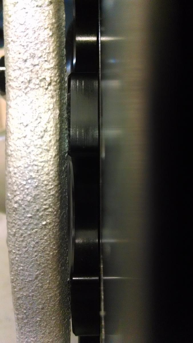

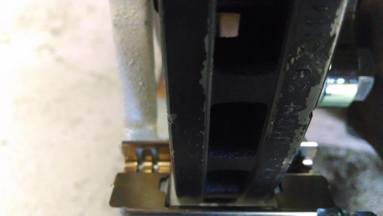

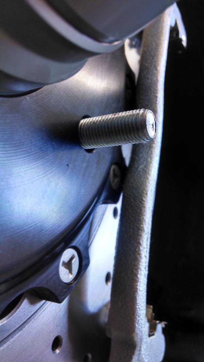

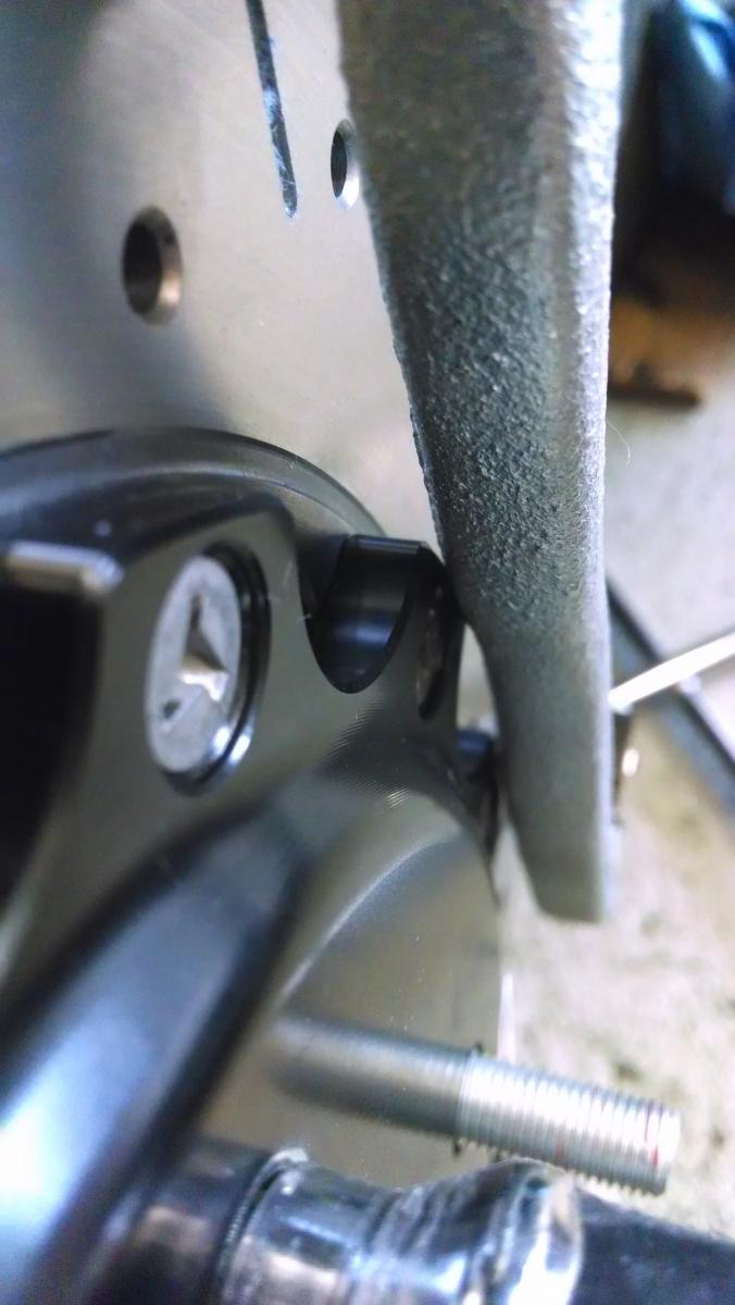

      My rotors showed up from Kore3. I went to mount them and noticed that I have interference between the rotor hat and the pad abutment bracket. After talking with Tobin, he said he would contact DBA and see if anything has changed. If not, I may need to consider clearancing the abutment to clear the hat. That, or something is amiss.
Size:  76.2 KBName:  IMG_20131031_151932841.jpg
Size:  130.6 KBName:  IMG_20131031_151953367.jpg
Size:  70.0 KBName:  IMG_20131031_152008574_HDR.jpg
Size:  71.5 KBName:  IMG_20131031_152021292.jpg
Size:  76.6 KBName:  IMG_20131031_152029489.jpg

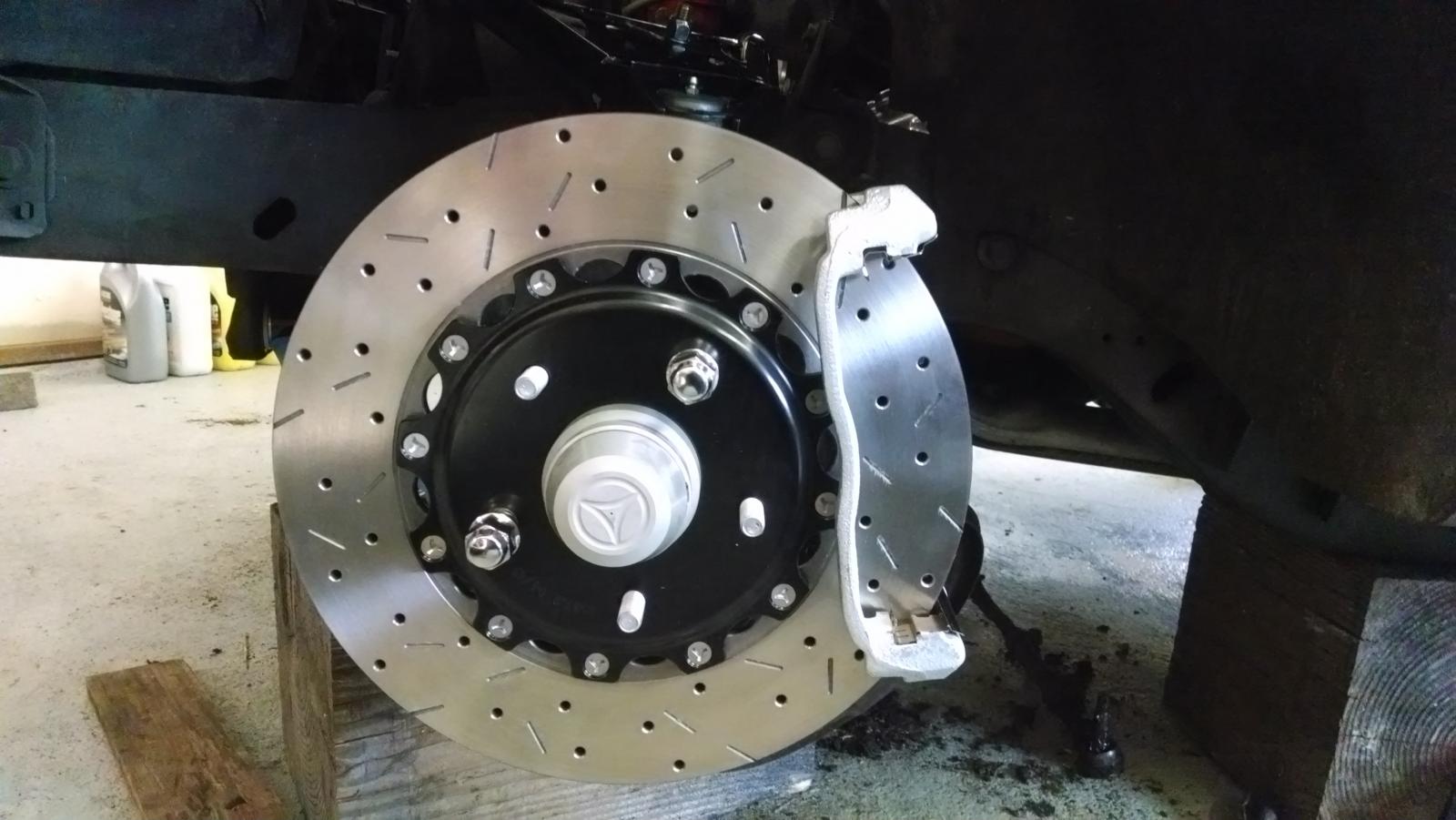

      Well, I re-torqued the spindle along with everything else and couldn't find anything that would force the rotor hat-to-bracket clearance issue. I ended up just clearancing the inside of the abutment bracket. I didn't have to take off much and everything clears now with room to spare.

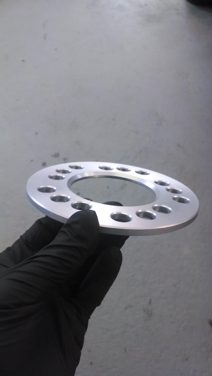

      In order to get the wheels to clear the calipers I ended up using a 1/4" spacer.

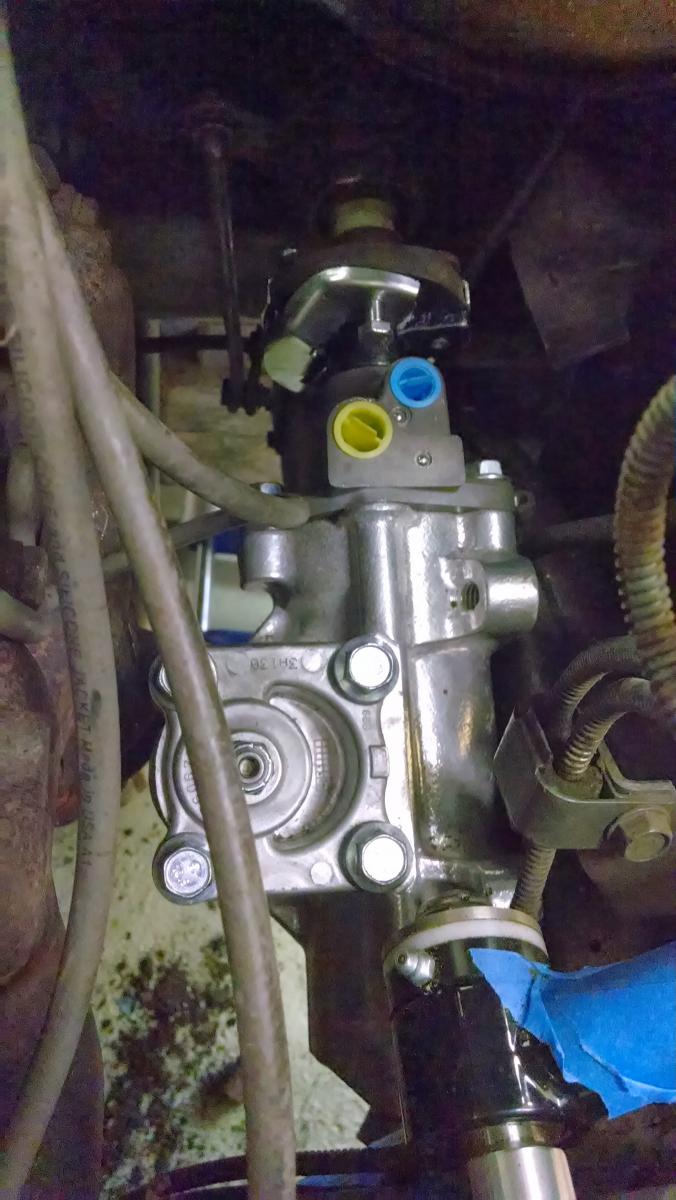

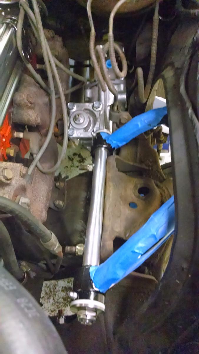

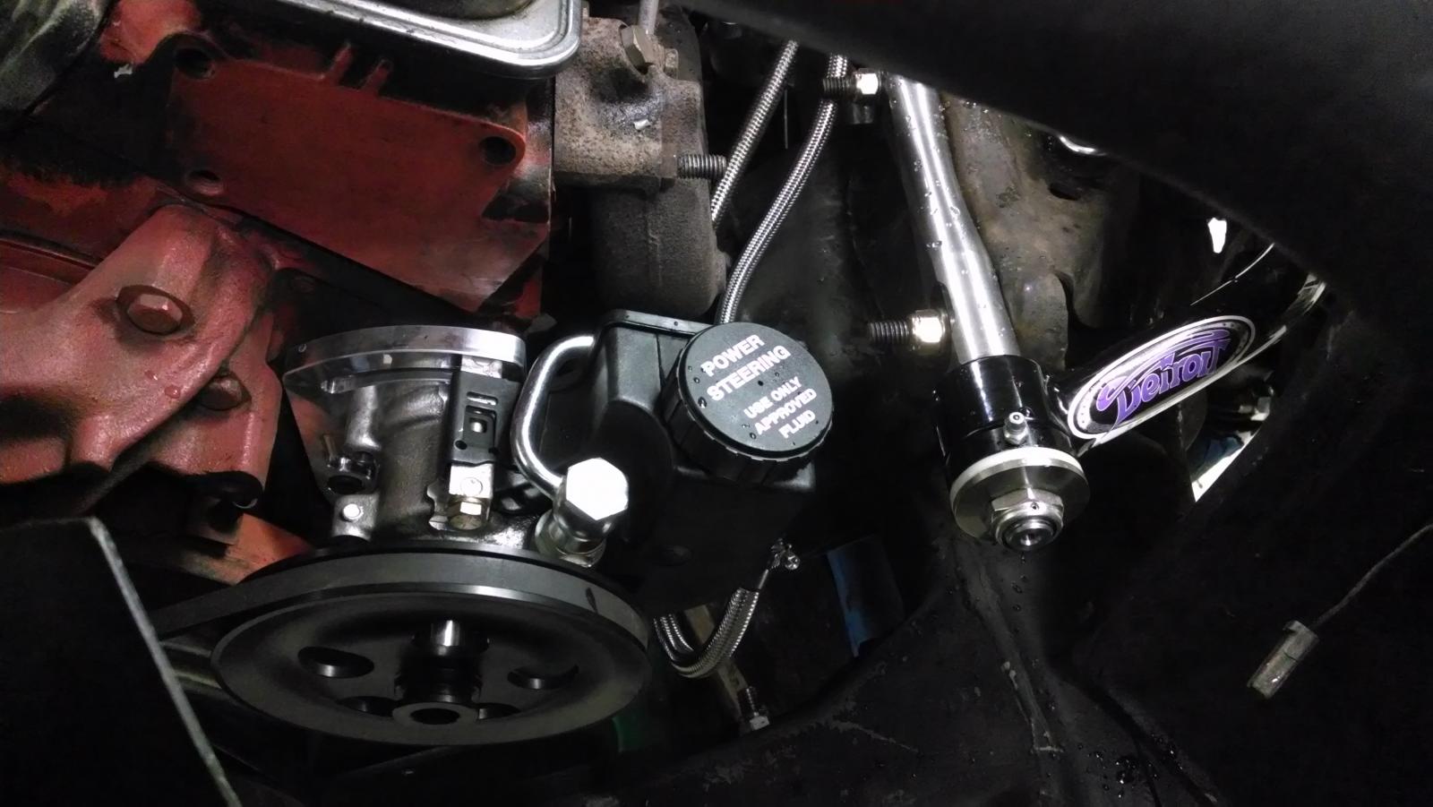

      I also installed a new power steering pump and lines.

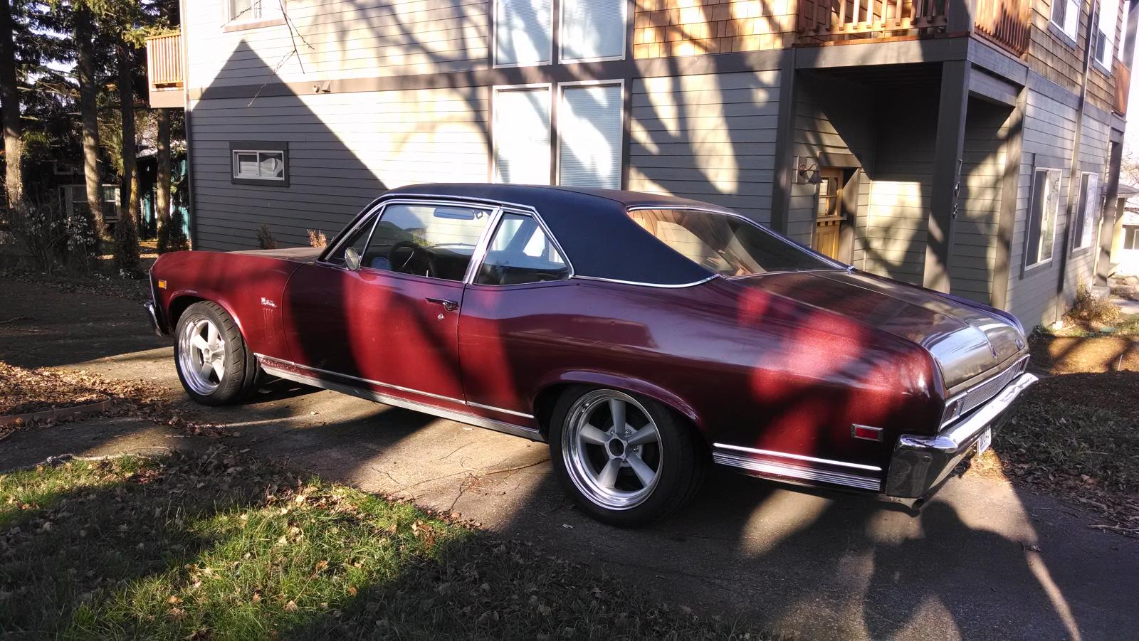

      Now everything is back together and the alignment has been done. Wow! What a difference the steering modifications have made. It feels like a different car. Same goes for the brakes. Everything turned out fantastic.
