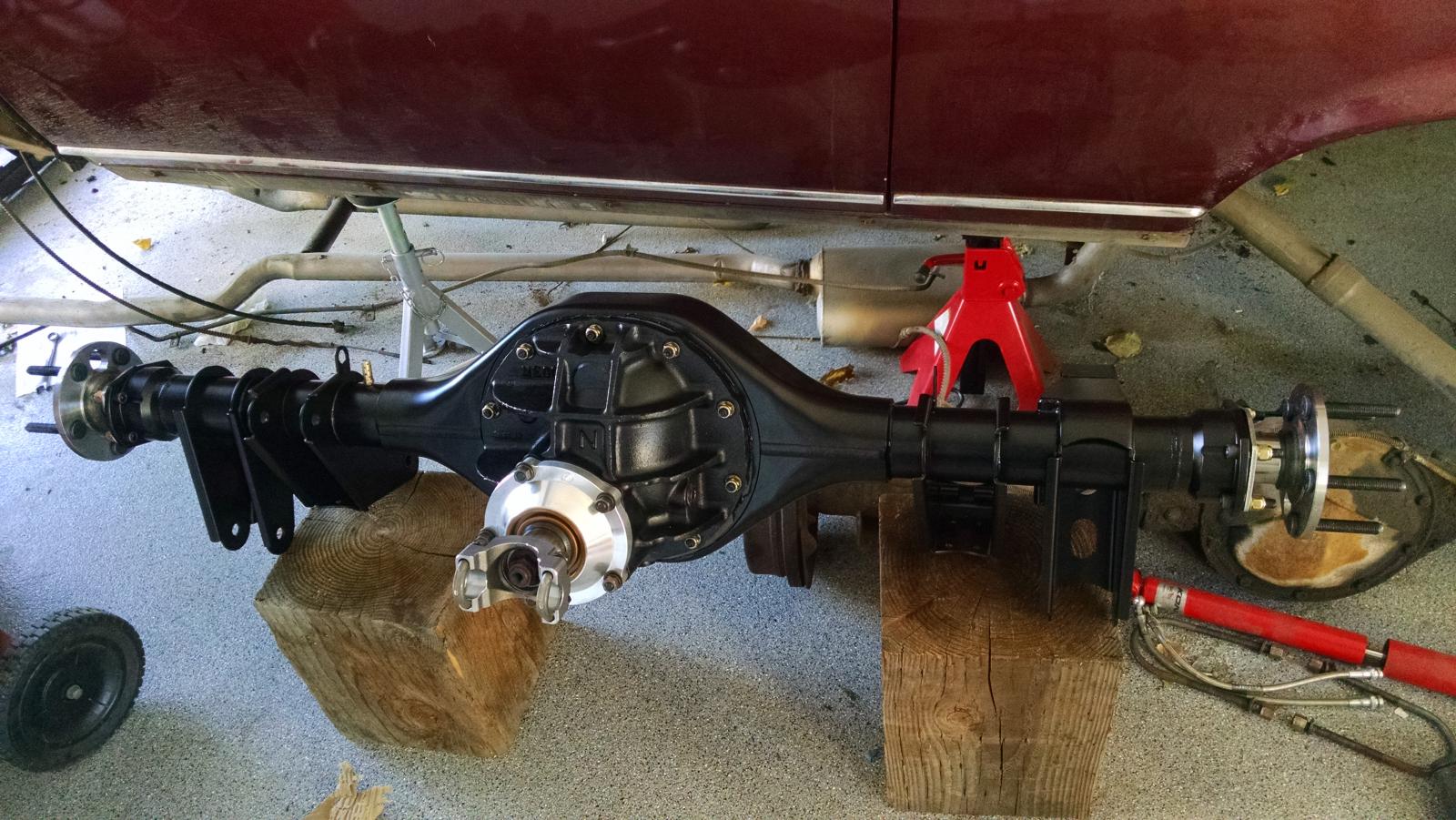

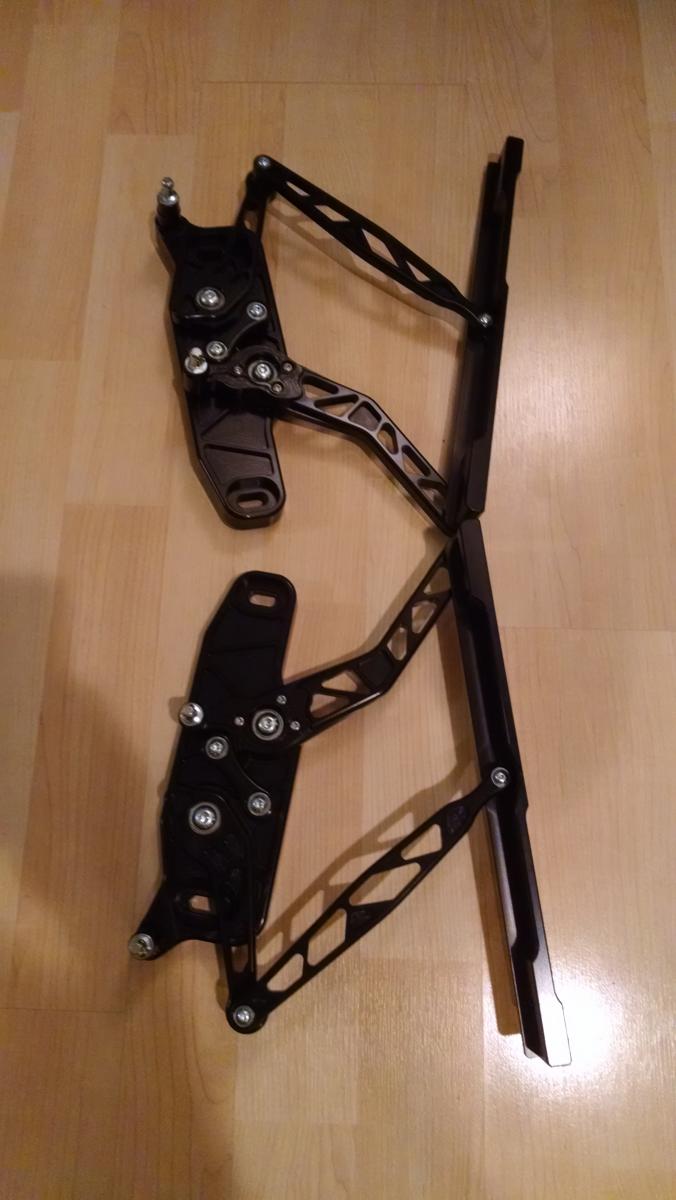

      Quadralink bits and rear end showed up yesterday. Thanks again to MCB. Their service is awesome.
      I guess I better get crackin'!

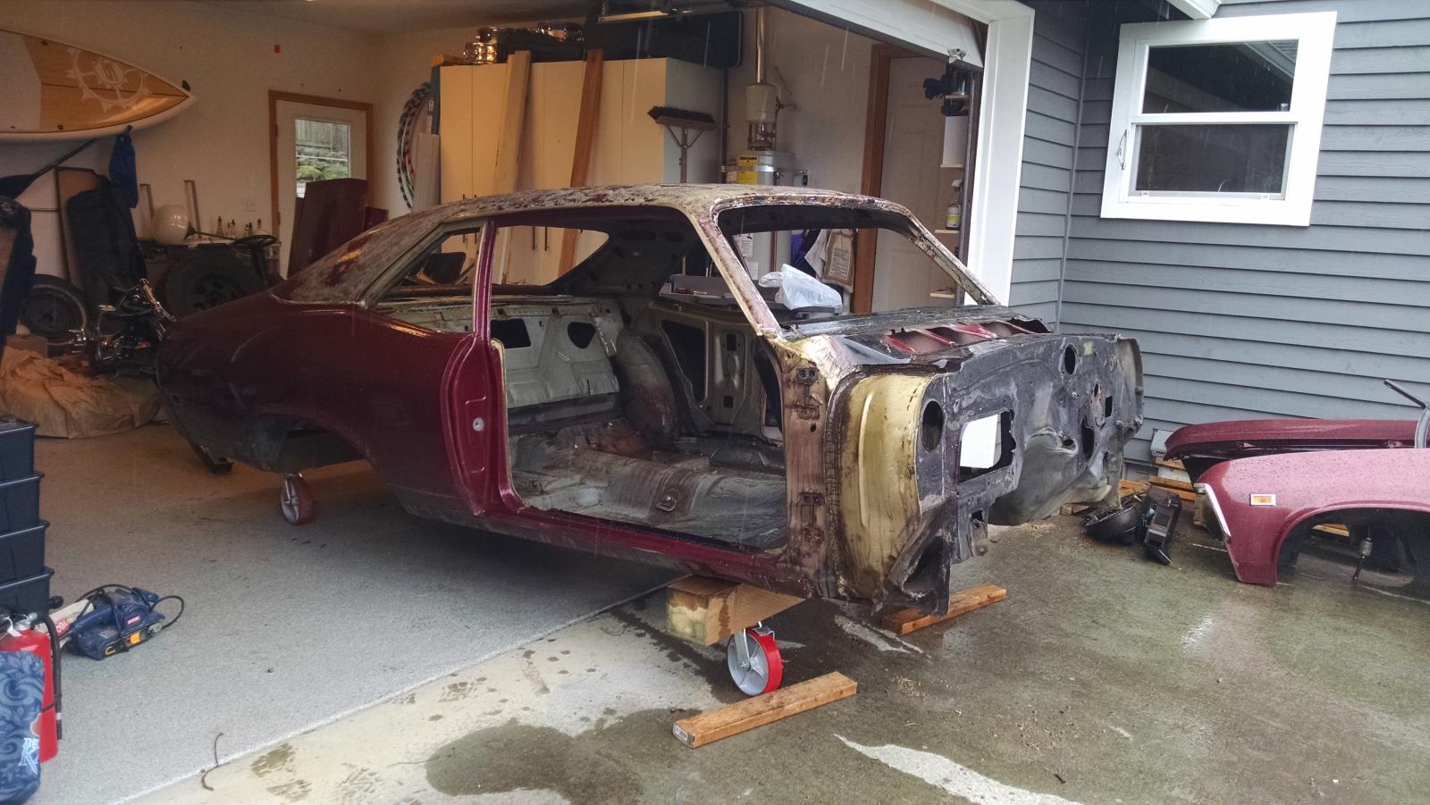

      Well...I haven't made much forward progress but I haven't completely stalled. I decide to just go for it and jump in head first on this build.
      I tore it down...

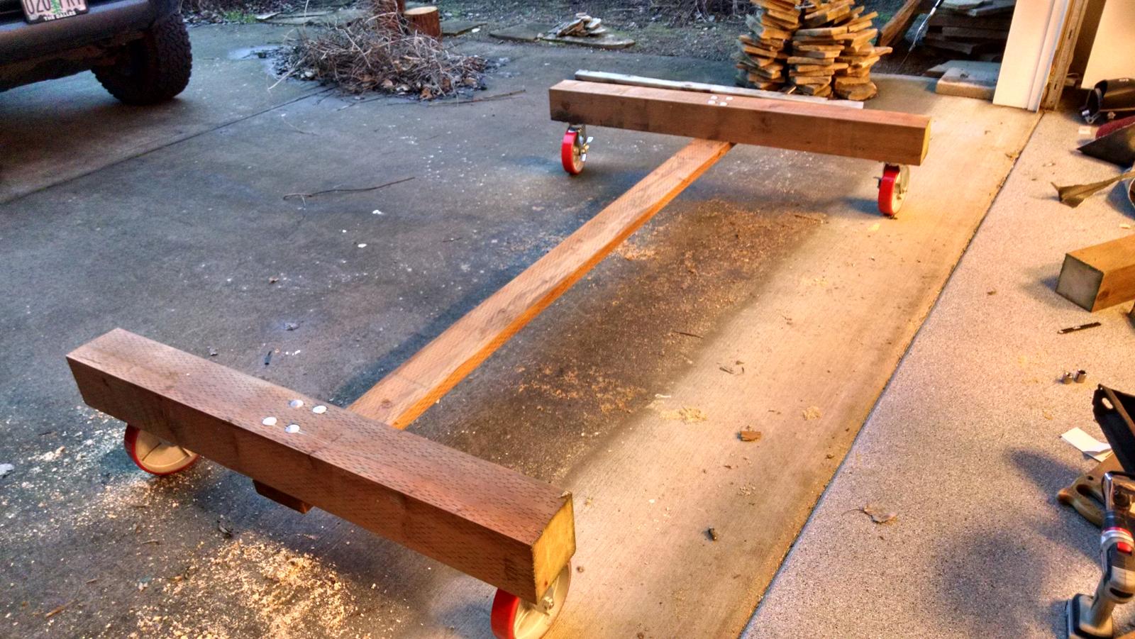

      Built a cart...

      ...and sent it away. I haven't had as much time as I would like to work on the car so I decided to farm out some of the build. It was just picked up by Metal Works yesterday. They will be dipping the car, fixing the rough metal bits, installing the suspension, and a few other goodies.

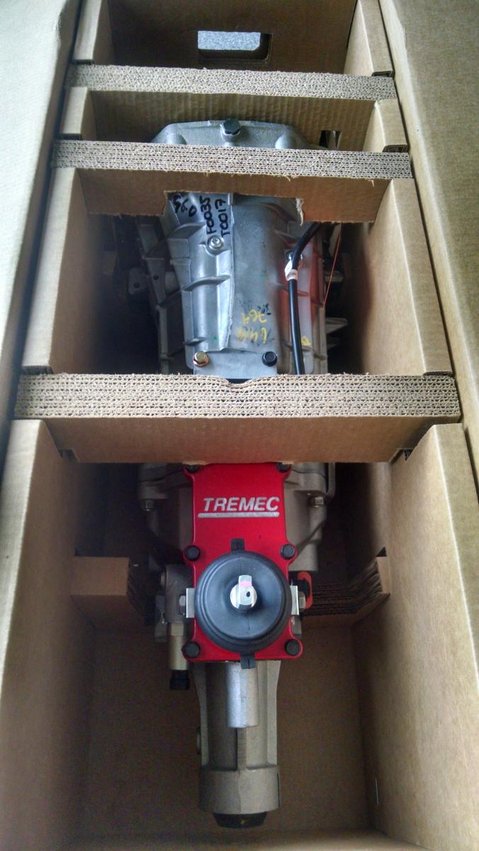

      Many thanks to Bowler for their super fast service on the T56 Magnum.

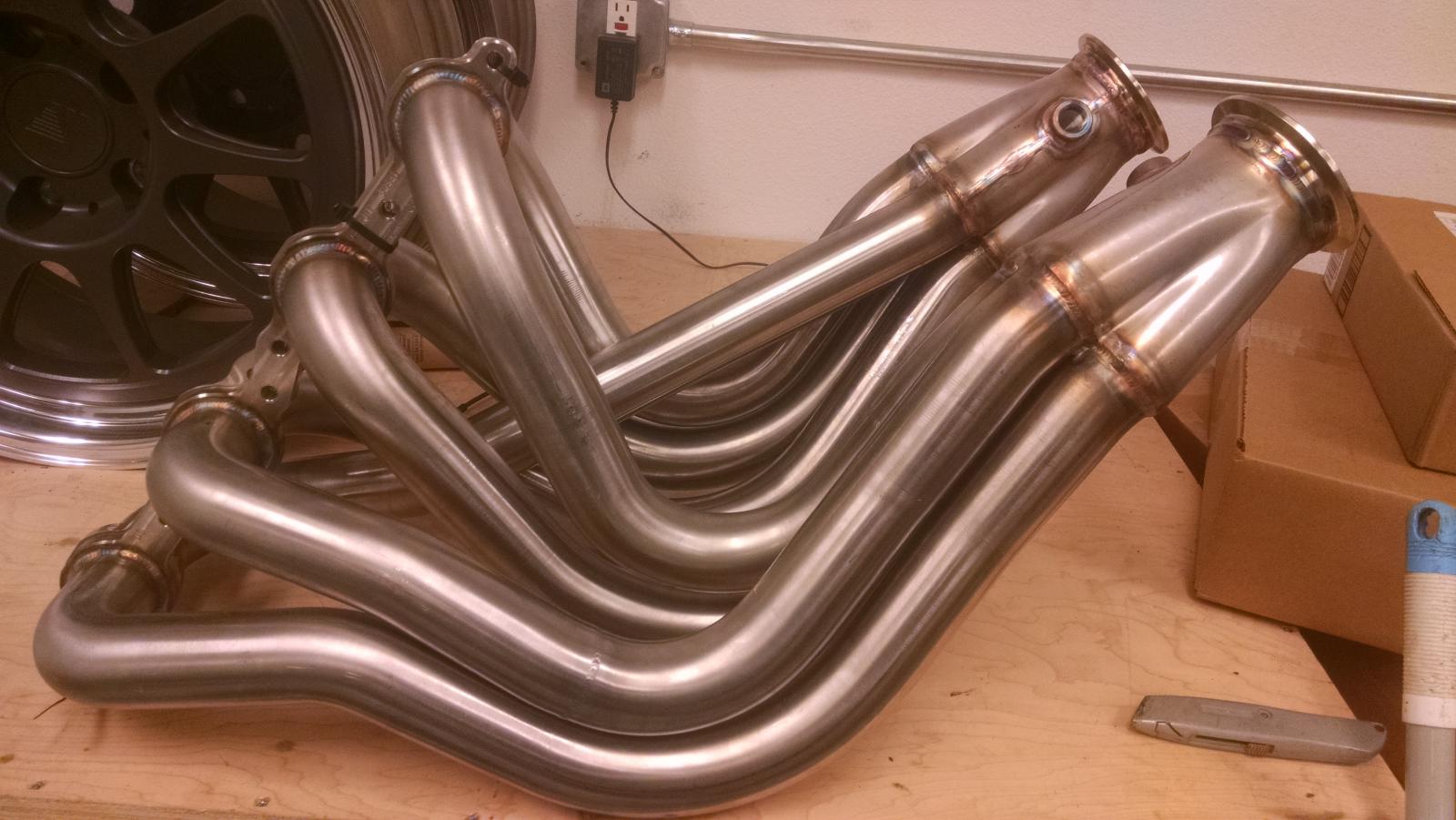

      DSE headers

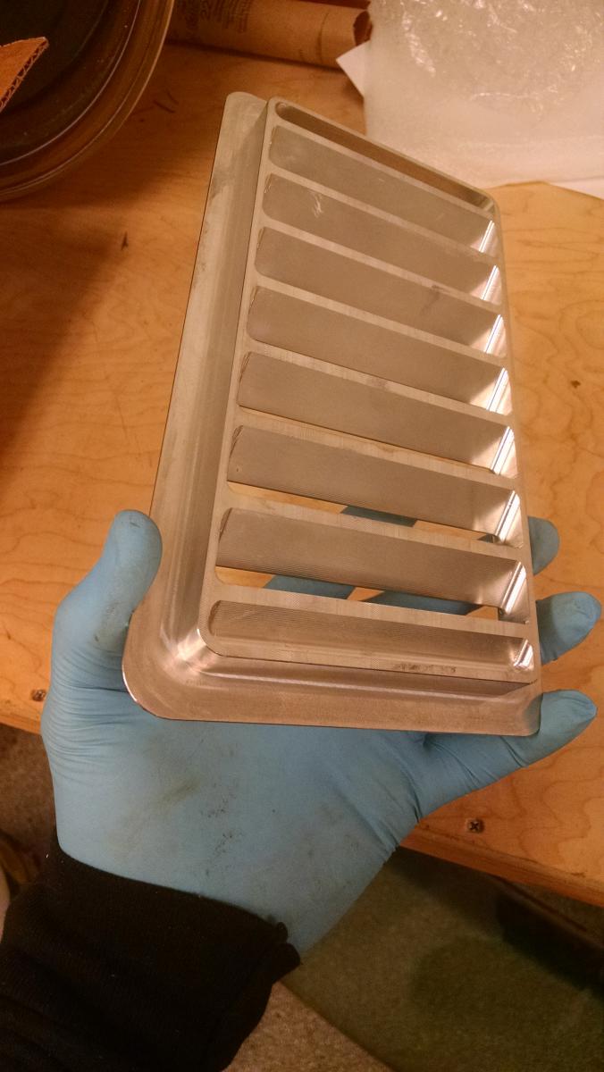

      Here are the awesome hood vents I scored from Billy

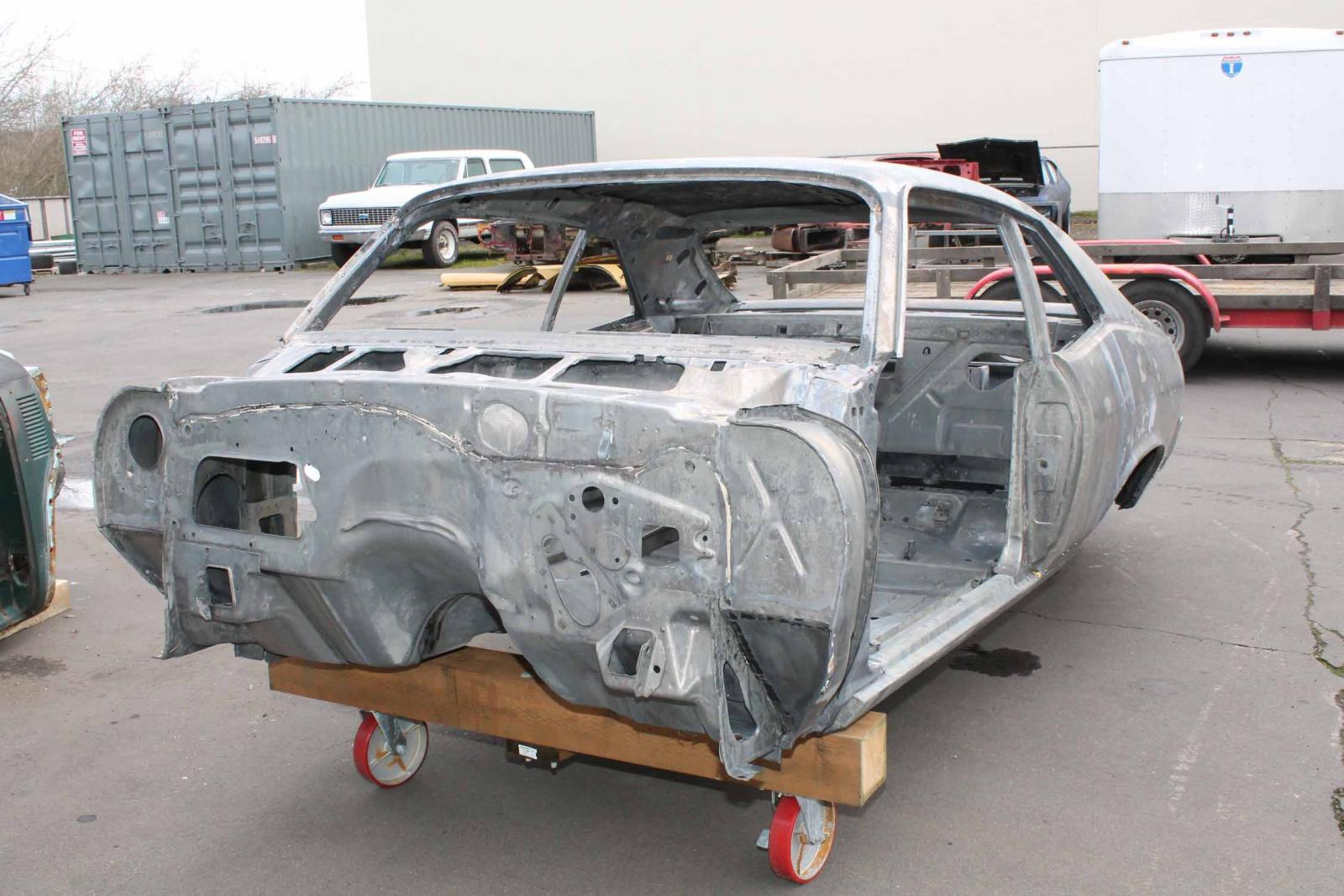

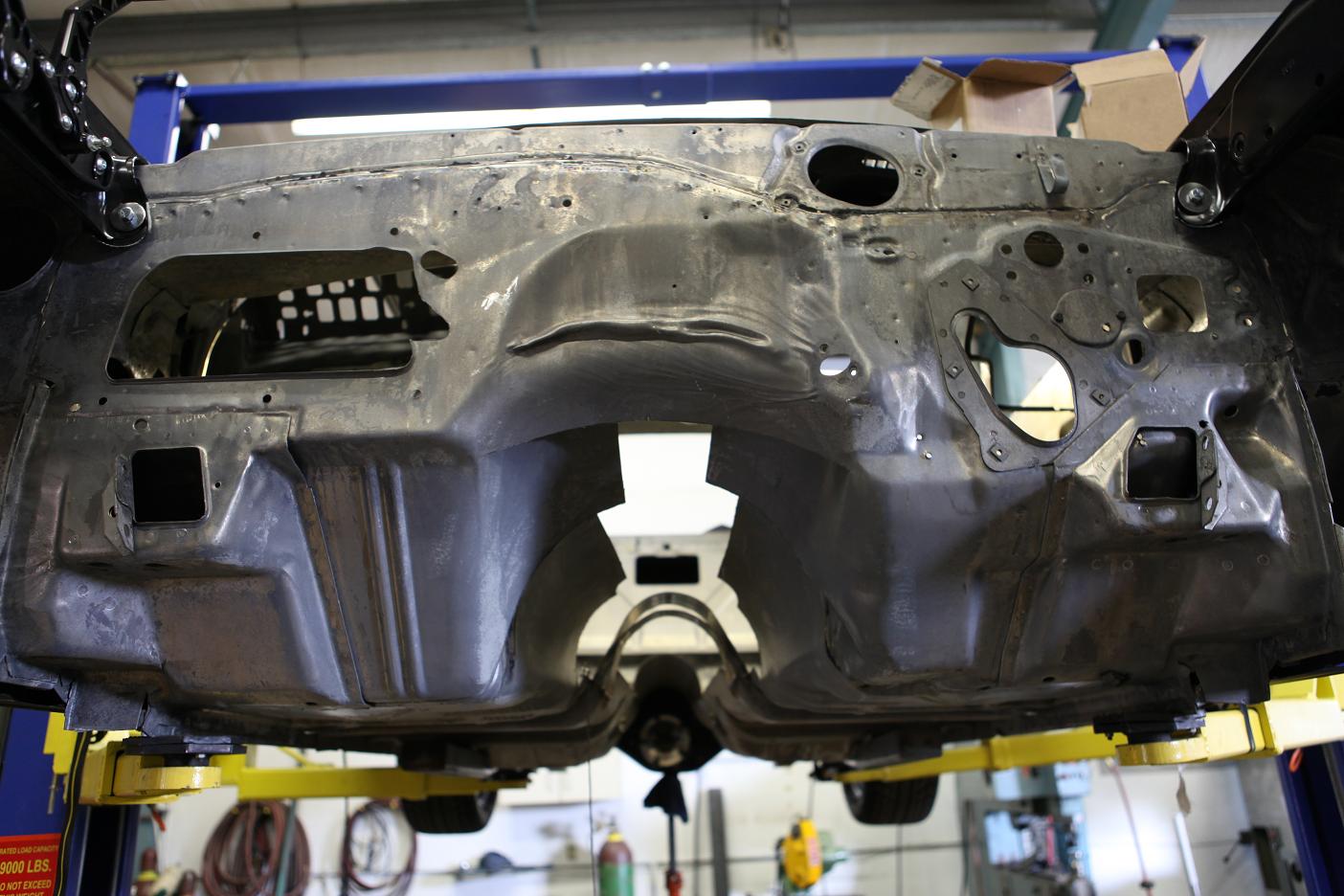

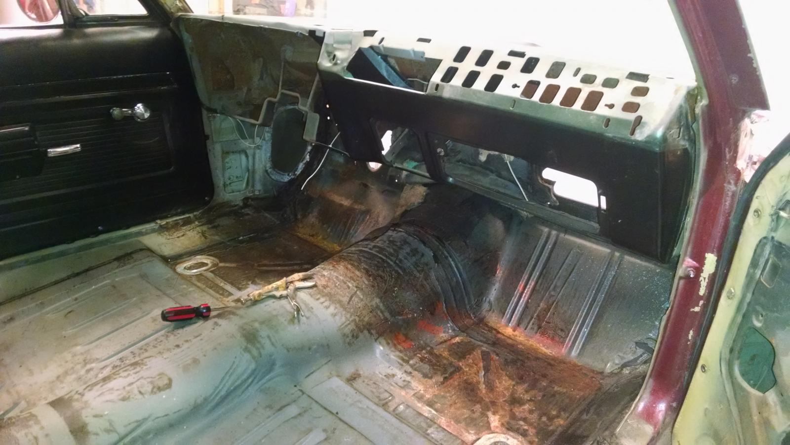

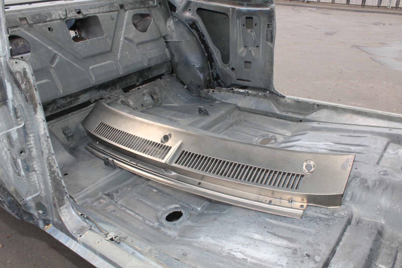

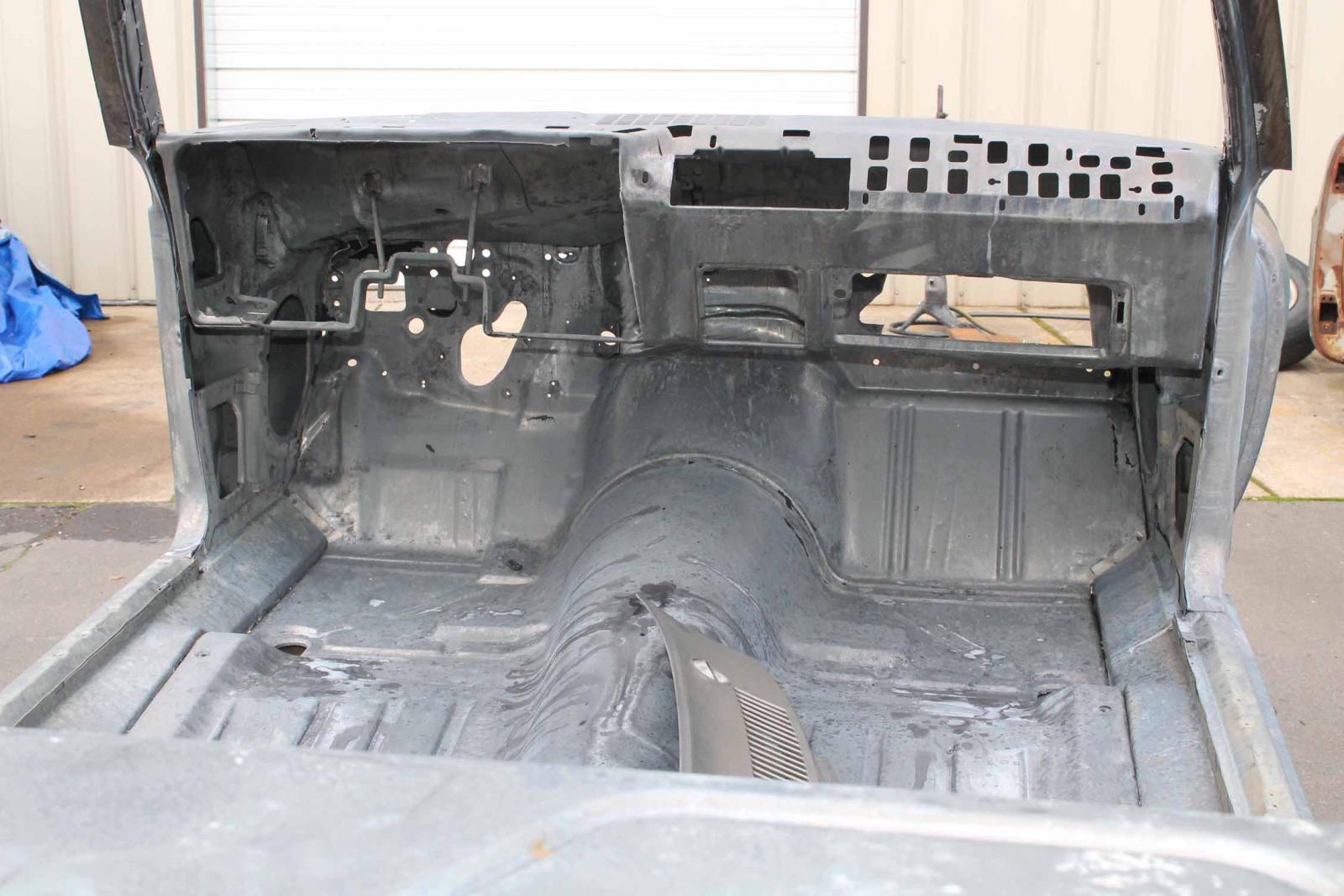

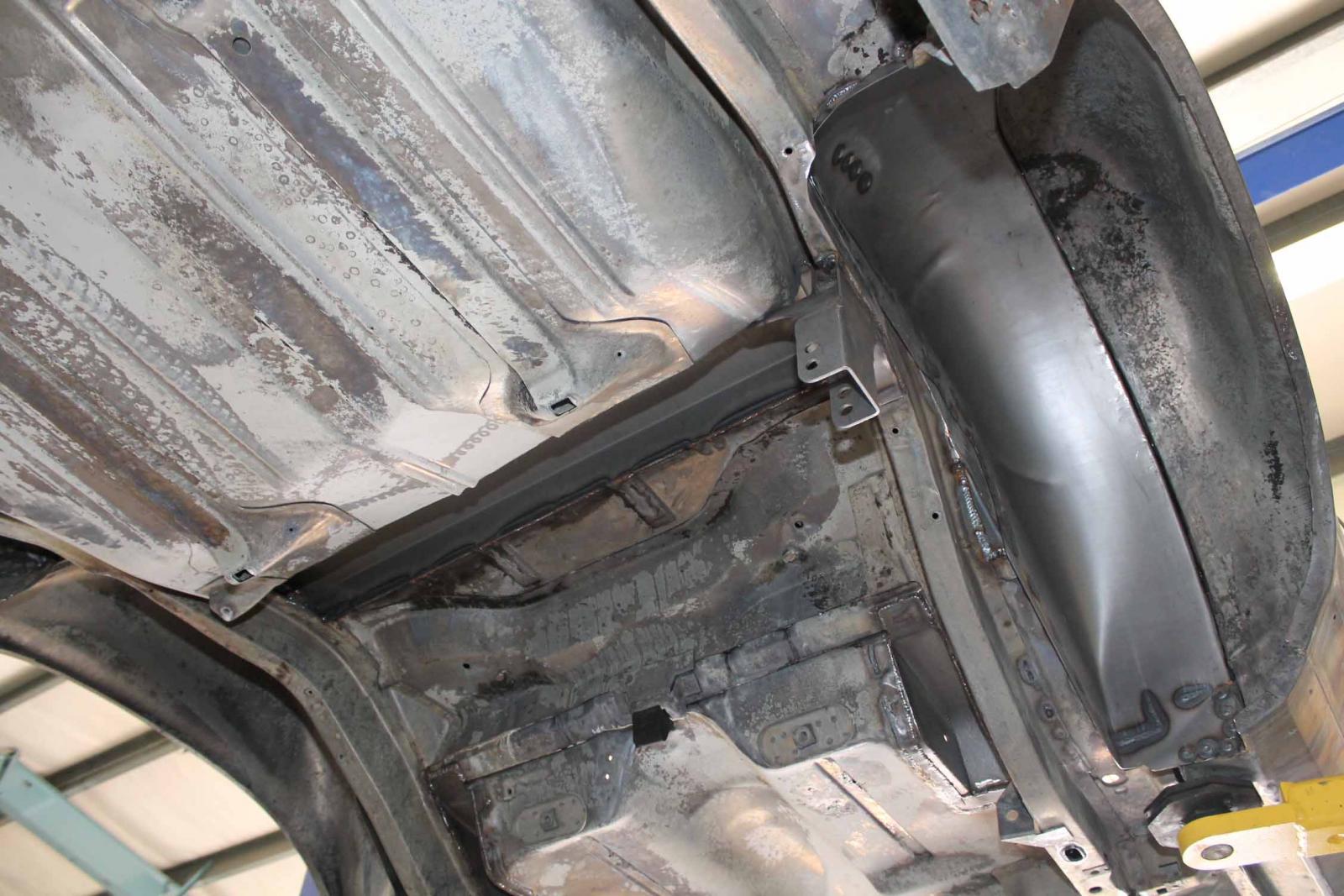

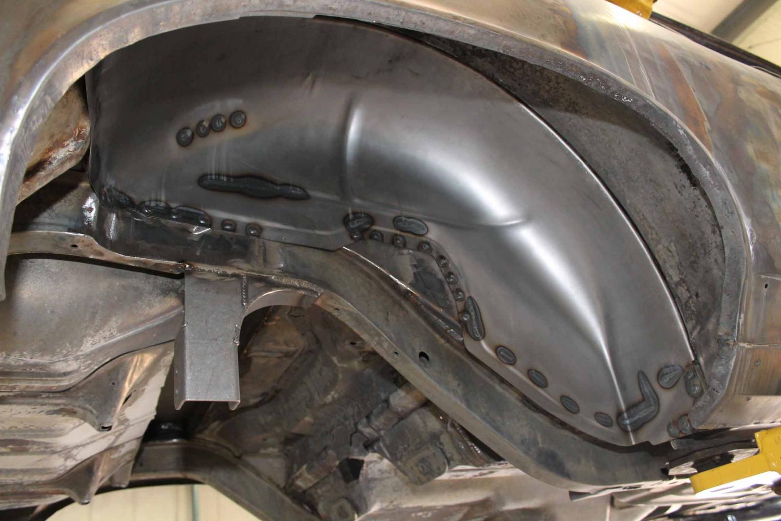

      Car is out of the tank. Overall she's not in too bad of shape. A bit of rust damage around the rear window and a bad repair by the passenger door frame. I figured there was going to be an issue there since it looked like there was a bulge under the paint in that area.

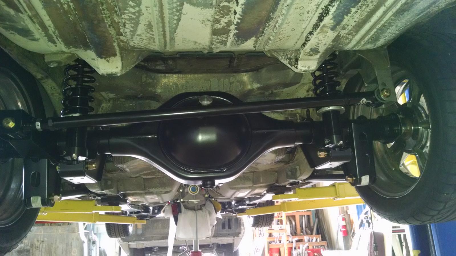

      Rear is done and the quadra-link is installed.

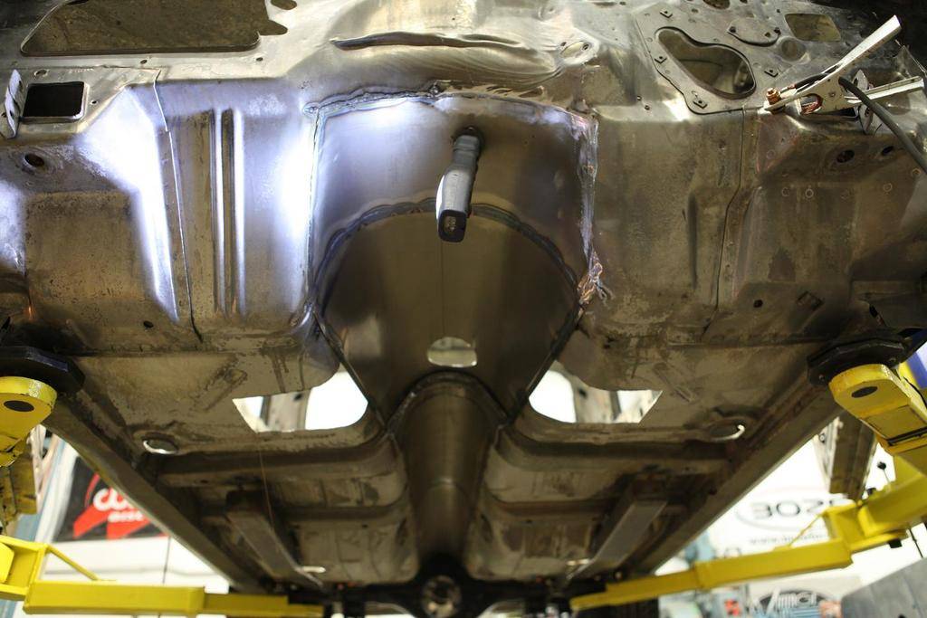

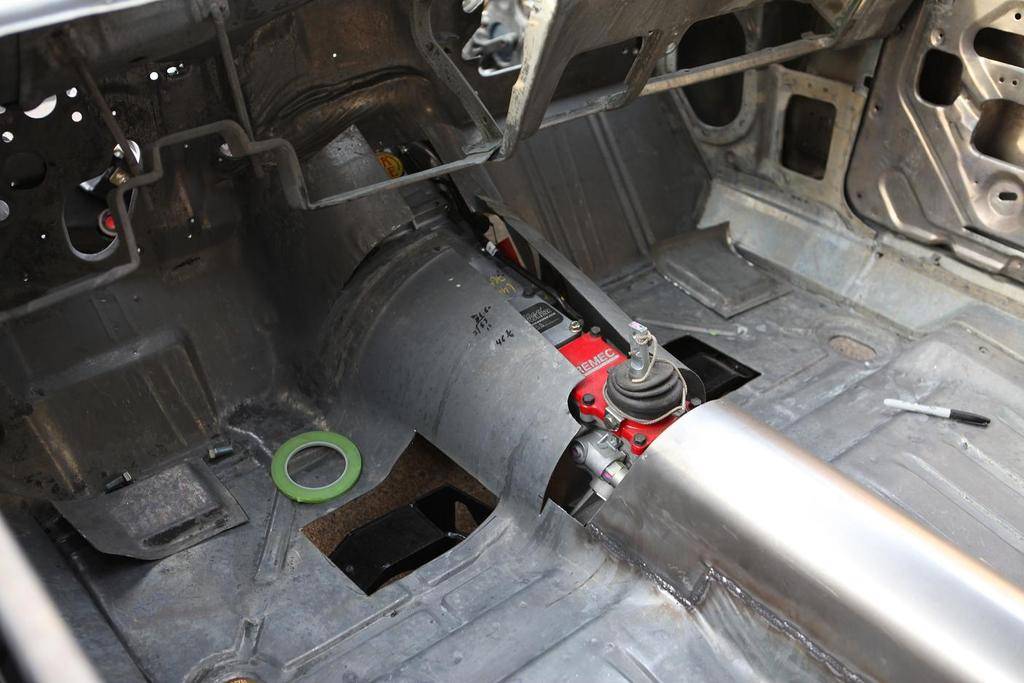

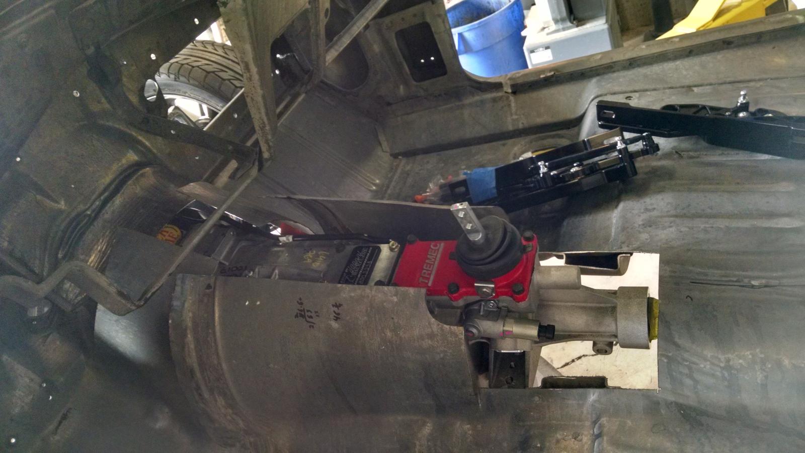

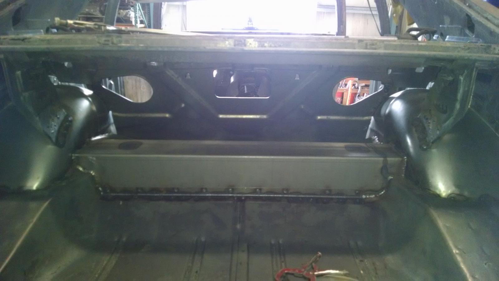

      Transmission tunnel fitting has started.

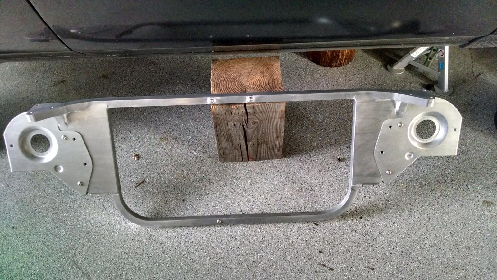

      front sheet metal and core support aligned

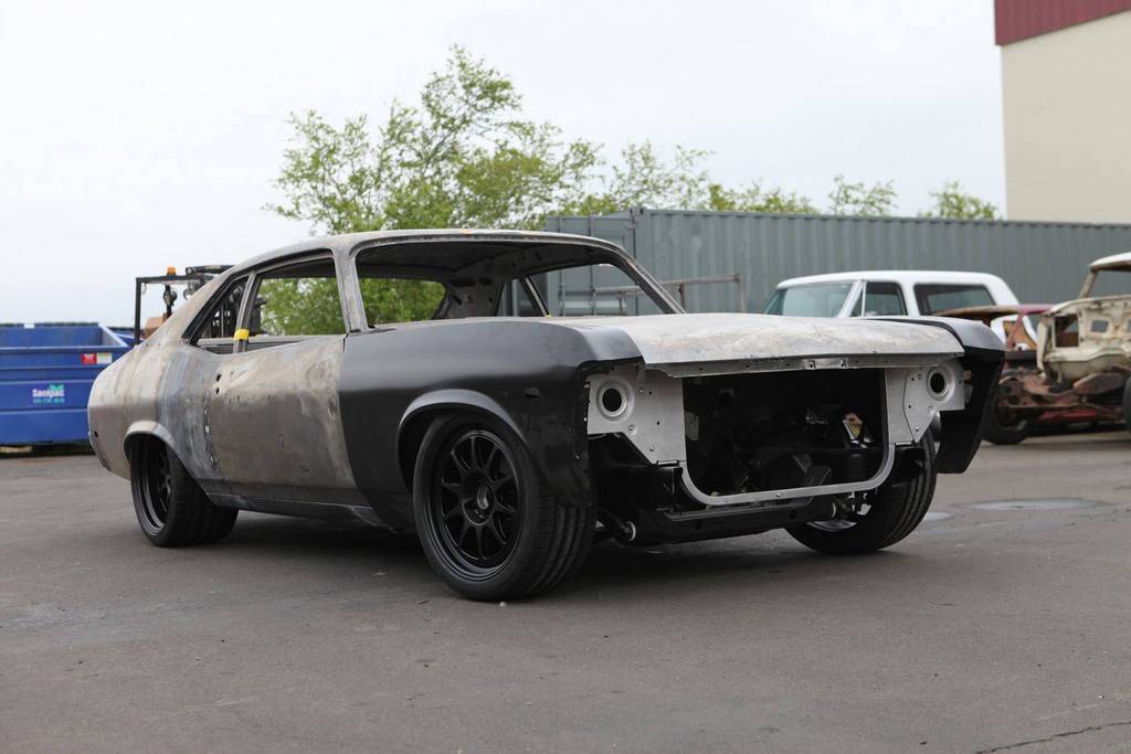

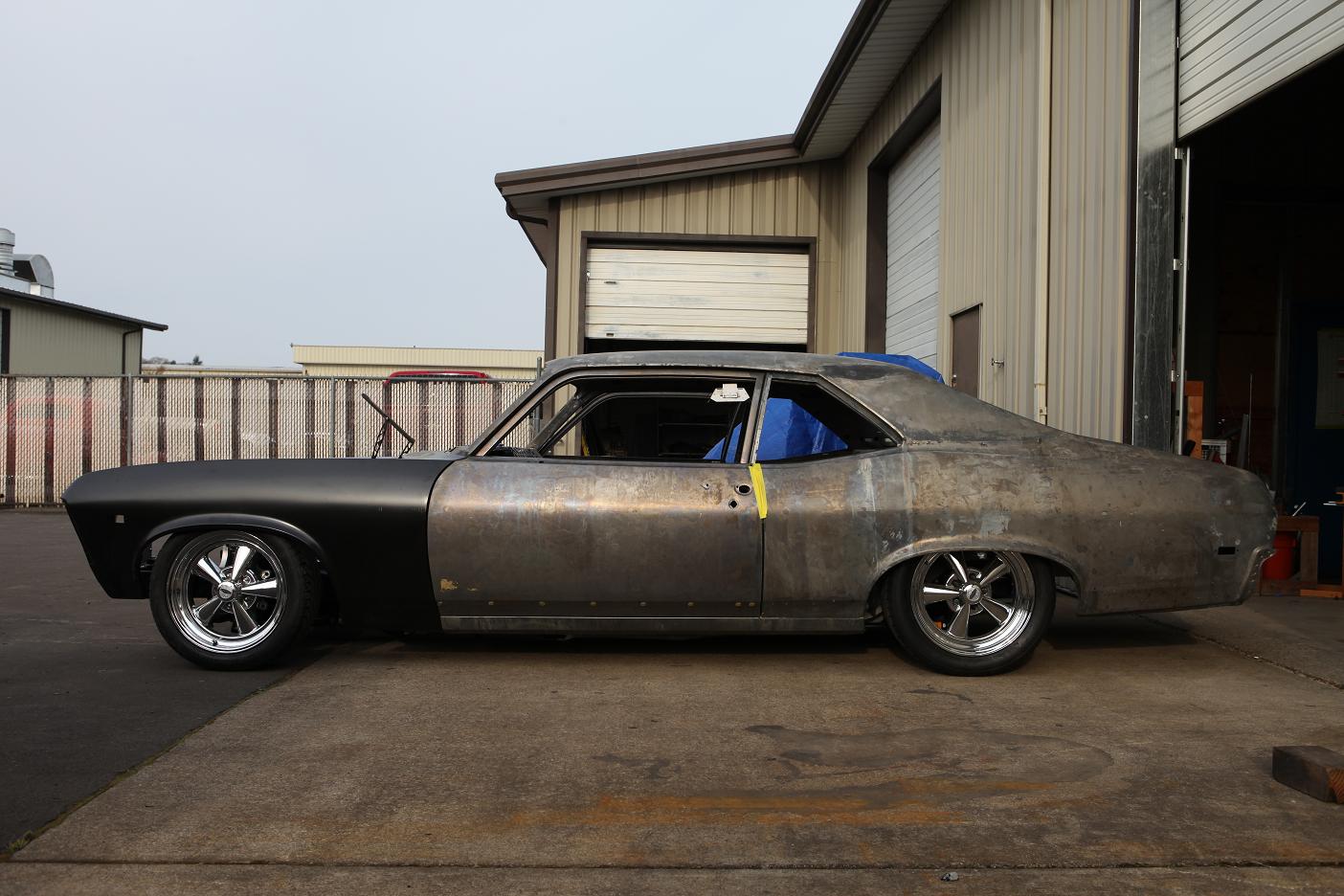

      Ride height is set. Had them do a small modification to the quadralink cross member height and track bar mount. We also used 1/2 height bushings in front. I think the stance in the end was worth it (not my wheels)

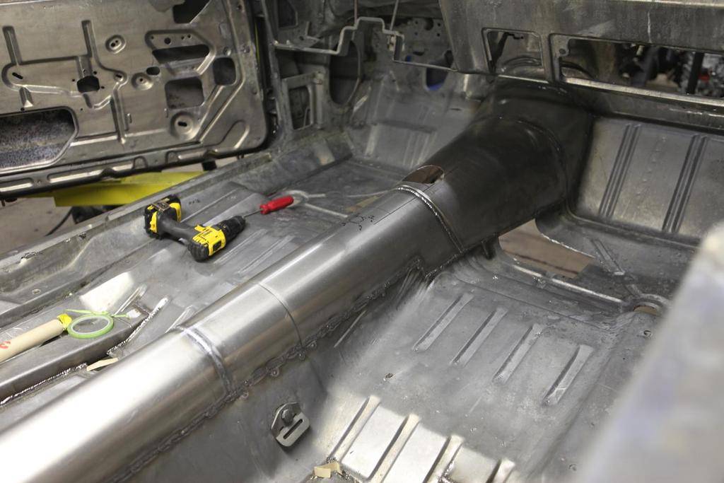

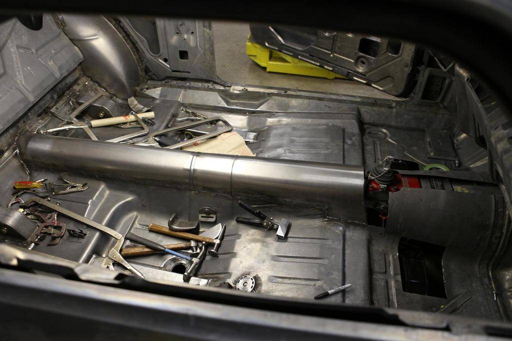

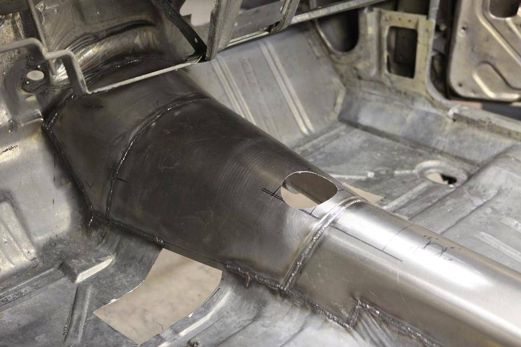

      Transmission tunnel is almost wrapped up!
