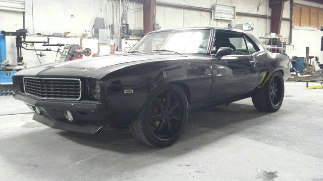

      tried these vossen wheels on what do you think?
      tried a set of vossen and lowered the camaro any feedback?Name:  1383253_615571921815356_855380969_n.jpg

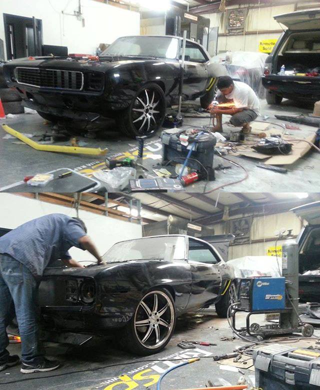

      Here a couple more updates on the camaro

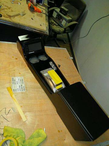

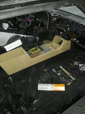

      custom build center console fab by us

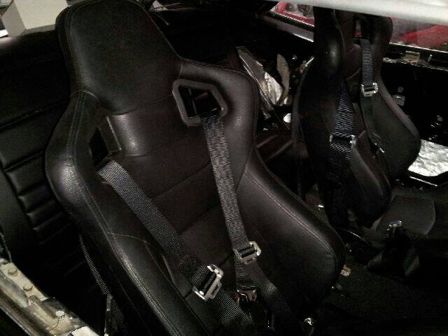

      Some Seats

      any feedback from anyone?

      Nice work, like the wheels in black. (Yellows not in my taste but appreciate the fab work on the vents).
