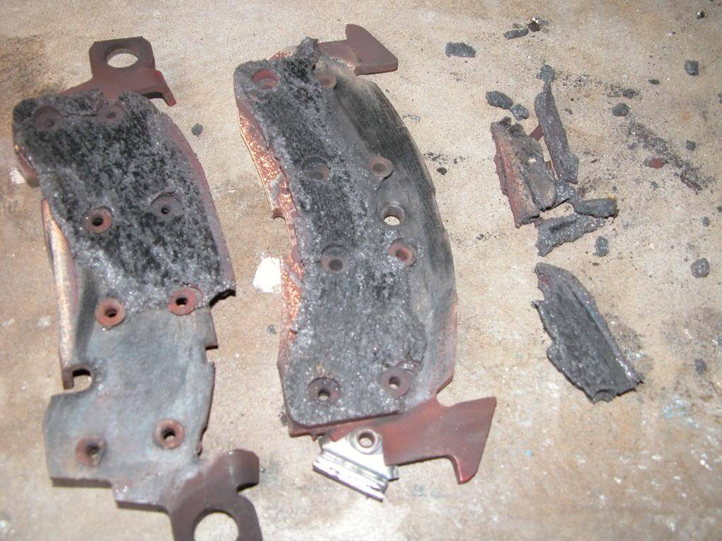

      Quote Originally Posted by Ron Sutton View Post
      John, how did you like the Porterfield pads?
      They worked very well for what I needed and could afford at the time. I had been trying various brands and compounds of shoes and pads but most barely lasted a weekend. The pads/shoes Porterfield sent allowed me to continue to improve as a driver without forcing me to upgrade wheels/tires before I was ready in order to fit bigger brakes. If I had continued to use them on track I would have started using higher quality rotors because the heat was crystallizing the rotors.
      I did not have the brake ducts hooked up at the time and the wheels themselves got so hot the plastic emblems in the center caps were melting and distorting. The pic below is what a new set of most brands of shoes looked like after a weekend of HPDE at places like Sebring that are tough on brakes. The Porterfield supplied pads & shoes held up much, much better but at the expense of the OTC rotors. On the street I use a dedicated set of pads/shoes, rotors/drums, that work without the heat needed to get the performance of track pads and swap for track weekends.
