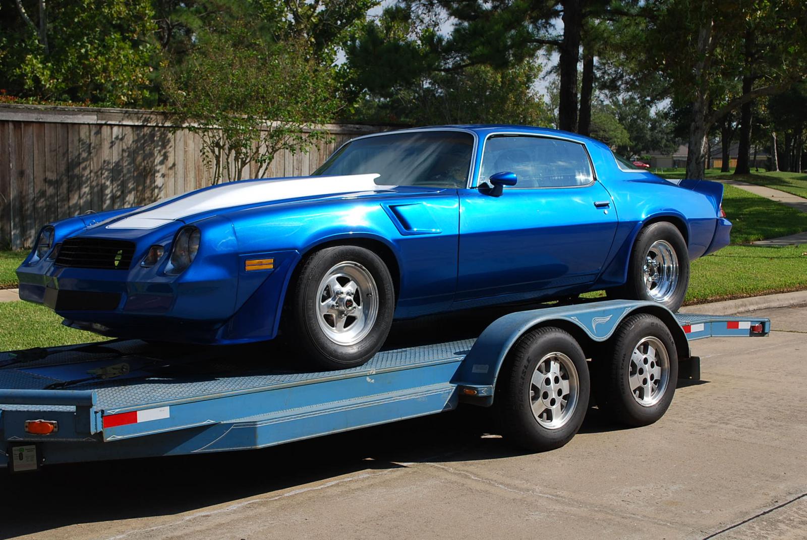

Size:  259.1 KBHere is the previous autocross car now drag car Ron.

      Sweet! Like the style & color combo.

      Color is actually a late 80s Dodge truck blue I always liked. 6 cylinder Camaro front springs cut 1 coil, Globals in upper A arm, lower has press in sphericals, Howe low friction balljoints. Rear CalTrac 1"+ springs and CalTrac bars, CalTrac spec'd adjustable Rancho rear shocks. 12 bolt Chevy rear with 33 splines and a spool. With the manual steering box(had an IROC PS on it when autcrossing) and the spool it is hard to turn into the shop.
      Winter project to pull the SBC 4 speed out and put in the 500" Pontiac motor and TH400.
