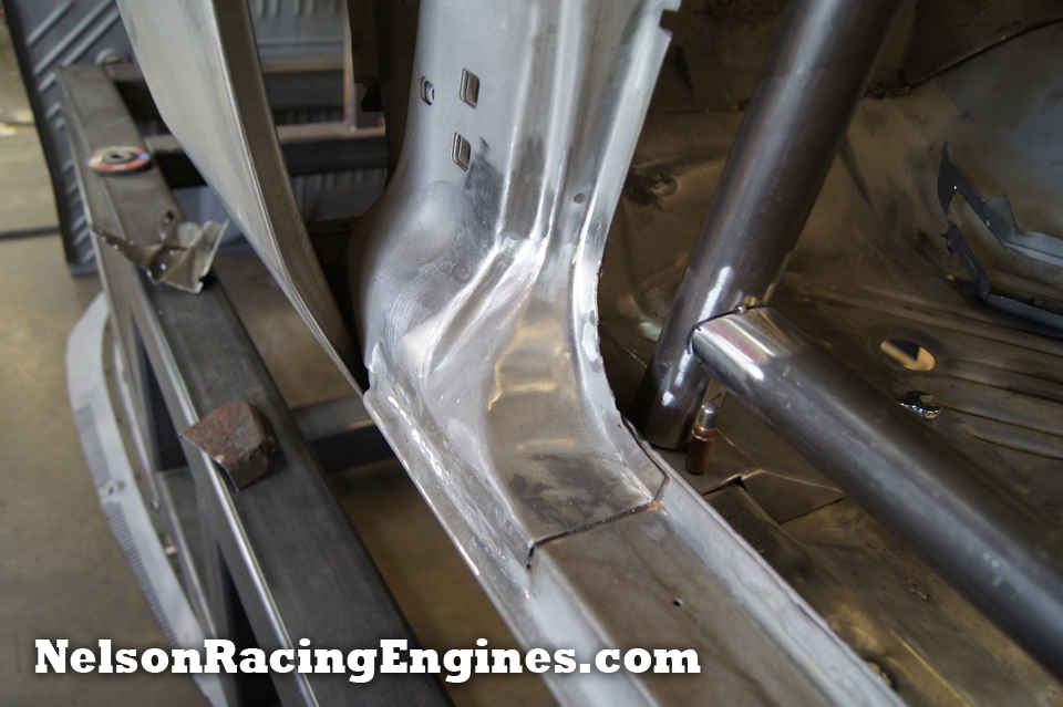

      Fixing the metal
      Here we are removing door box I guess you would call it. The original was to wasted to repair we cut out a good stock one from the junk yard and grafted it in.
