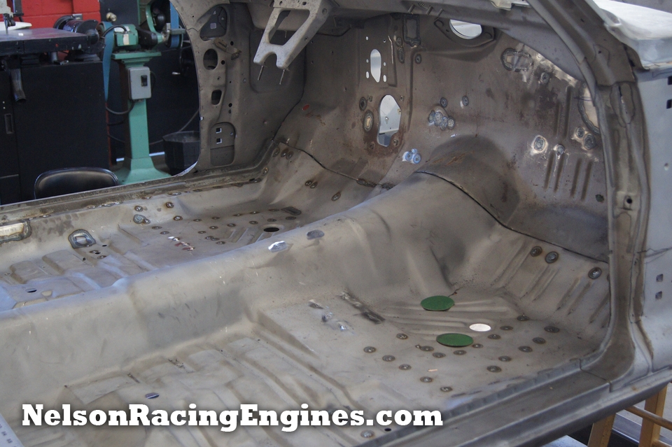

      Okay ,so we got it on the frame table and started basically cutting the car down to nothing. We decided the floors weren't worth saving so we found a really awesome floor section in the junkyard, and cut it out of the car and drilled all the spot welds out then blasted and fit it into the car. I really wanted a stock floor piece because they fit much nicer and at this time in the project we didn't no we were going to go so hog wild on the car. We then just kept cutting because nothing looked good and I did not want to fix some rust and know there was more. So here are some shots.

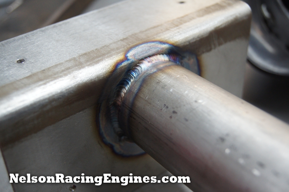

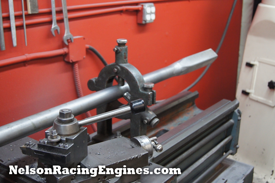

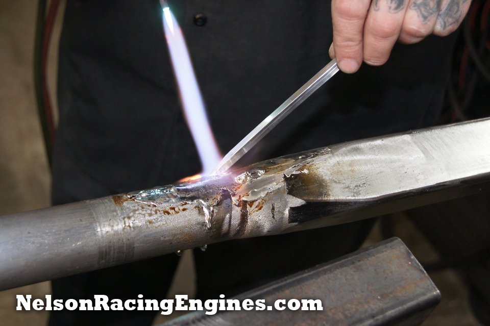

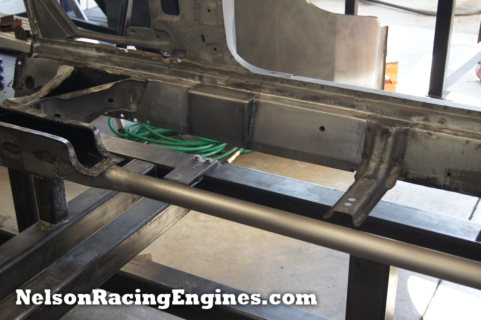

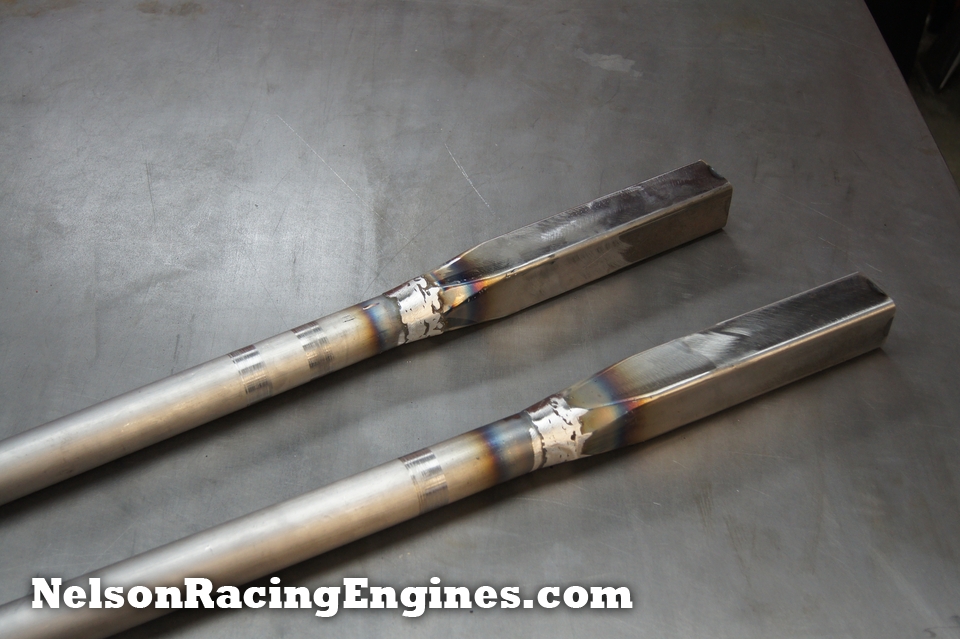

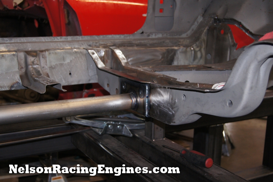

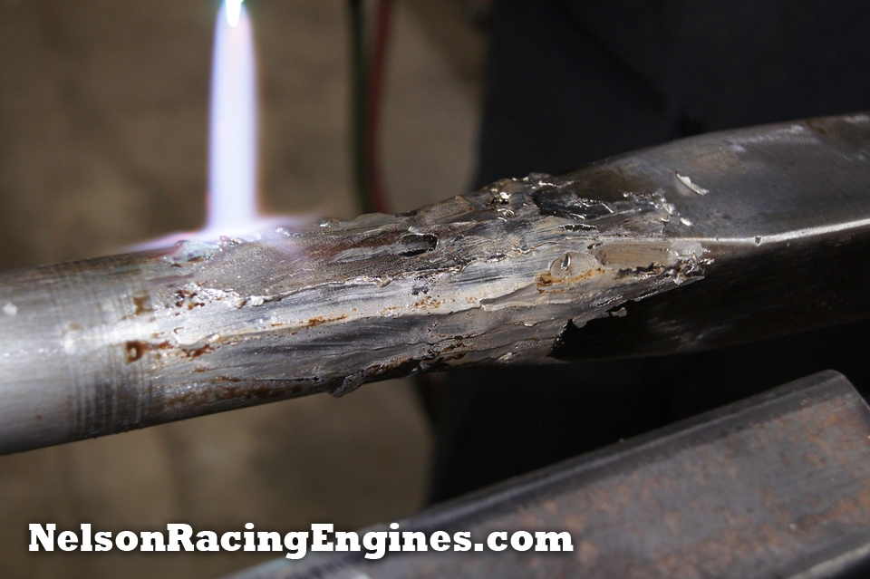

      Making Subframe connector clear the floor
      So while everything was cut out and easy to get to we decided to tie in the chassis with these custom frame connectors.Whats neat about doing it this way is they clear the floor.

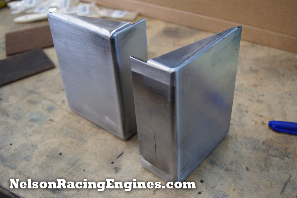

      Making Cage Pads
      Here we made some roll cage landing pads before we welded the floor in. We wanted to get these in solid.
