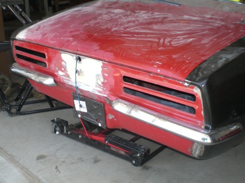

      I knew I couldn't just put a Camaro bumper on a nice Firebird, puritsts and mod-guys agree on ONE thing-that. So I set out to make something that was neither camaro or Firebird. The rear "split" bumper is 2 camaro bumpers that gave their life and were split-chopped-modded-and welded back together. It is tucked in nice and close with 1/4 gap all around and I plan on having it re-chromed. The '68 fuel fill is filled-in and fueling will be accomplished behind the flip-down liscence plate using a '69 Firebird gas tank.
      Attachment 78659
      All/all the cal has the "feel" of the stub-nose Camaro, but still maintaining the Firebird styling. I plan on the original black vinyl roof and a modern charcoal grey paint.
