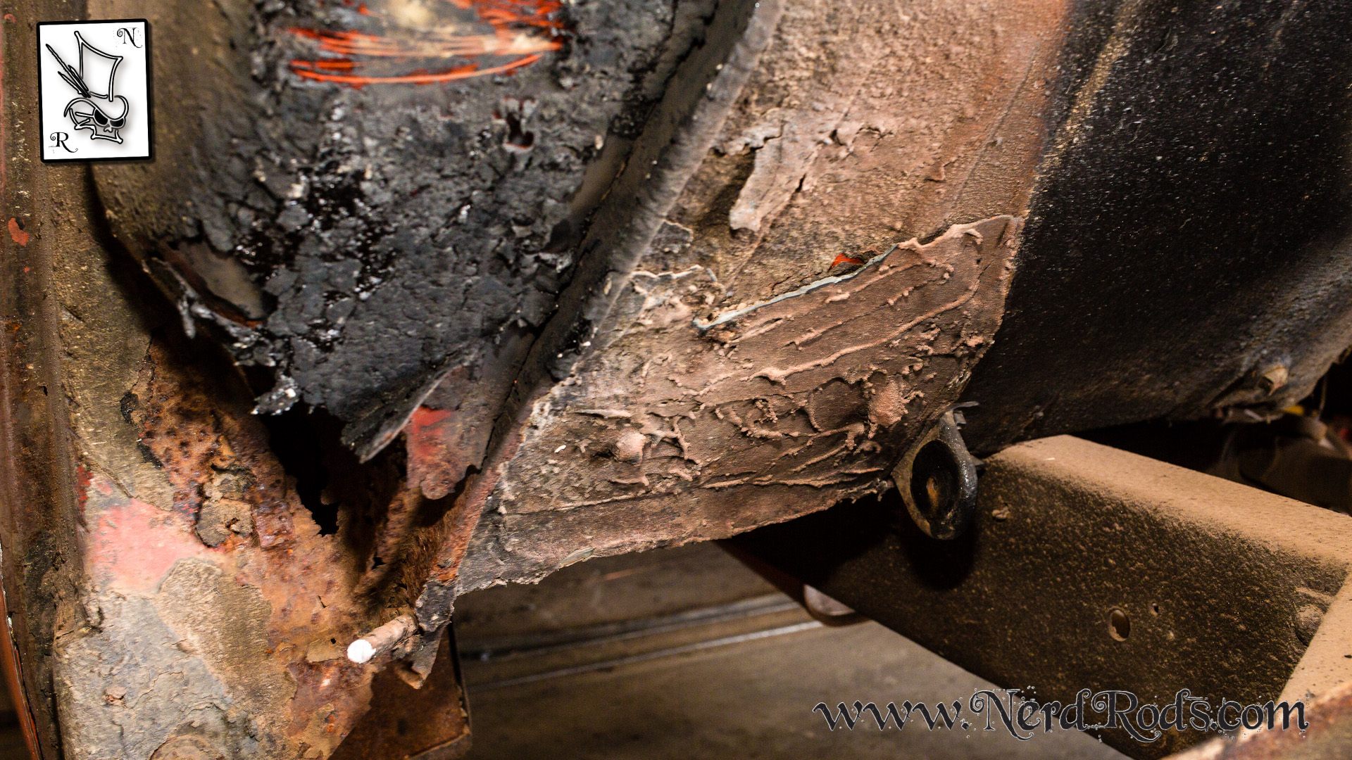

      Looking at these photos again is sad, just wait until you see what was under the paint. Lets just say, we're using the hood....... And that's it.........

      WOW, The sad thing is now that we have it appart the bed is the nicest part of the truck. We can't use any of this. Its going to cost more to fix than it would to just find a better cab.

      Several of the body braces fell out from under the car when we took the body off the frame, the front passengers side fender was braised on to the cab because all the body bracing were rusted through. And thats just a few of the the bad points. I could write a paper on everything wrong with this truck but I'll let the photos speak for them selves.
      We've located a new truck, I'll post some photos up of it soon. Can you say barn find?
      The really sad thing is that we didn't end up using the bed either, just the hood.

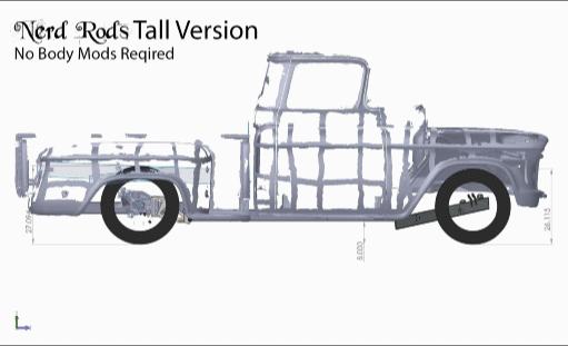

      So I just got a little more data into the computer about the bed and then I remembered. For a no body modifications frame the floor board of the cab and the motor aren't the biggest problem...... Its the bed and the rear suspension. Turns out at 6" off the ground the bed hits the differential pretty badly. So we're going with 8" off the ground as your "I want corvette suspension but I don't want to cut my body period!" option seen here. This will give you miles under the hood and a completely stock bed as well for guys who just want to buy everything OEM stock ish for finish out.
      And 4" off the ground, seen here. The frame will be shaped as such that even this low you won't need to cut the bed steel braces just the wood to clear.
      And just for you guys who didn't know this is 14" off the ground or STOCK!
      And for it to all make more since here's a cool animation. Click to see the 1080 version with more detail, Warning the image is huge by computer standers so it might take a few to download.

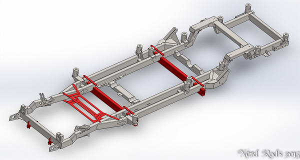

      Update time. I'm having to pocket the suspension cradle into the tubing rail on this frame compared to older designs for other cars. Got room for the air ride on the back for guys who want to run that way and I'm making room for all the body mounts right now.

      Getting close, I've got 280 lbs of frame in the computer now we're just dialing in the fine details, making sure all cuts are normal to the surface, giving the tabs the proper tolerances, and working on clearing some small sections on the body and making decisions on where and if we want to do a little cutting on the bed braces. I also whipped up a set of Foose Nitrous II's in 18's for the customer to get a feel for the look on them.

      Detail work now. I'm happy with the shape and we've taken care of most every clearance issue I can think of with these tucks and got the number of parts down compared to the TriFive frame so there will be less welding and will make it easier to assemble but still similar in several ways to give the frame some parallel to the other frames to make guys who have welded one feel familiar with the other.
      We've got the Corvette stuff dialed in now but we will have life axle support like the TriFive frame as well. I've sold a few of the truck frames besides this project already but they are all welded frames so I won't need to make instructions just yet. I'll do a time lapse of the second frame I weld for you guys to see how I do it.
      You can see two key thinks with this frame in the fuel and brake system support, still working on where and how to place the fuel tank and the 4" tall tubing risers to give the optional ride heights for different builders.
      But I know what you all really want, pictures, lots and lots of pictures. So here's your fix.
