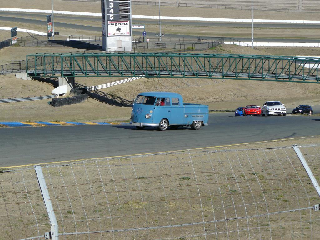

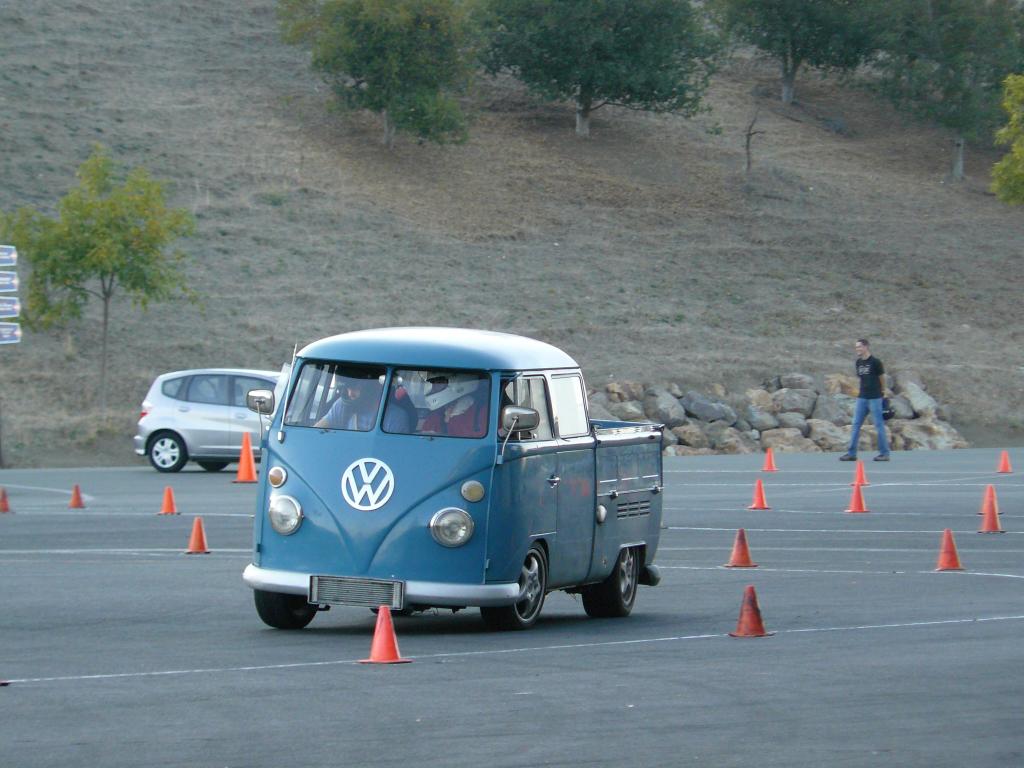

      Took the d.c. to a autox test day at Sonoma raceway.
      I have not done any tuning to the chassis/suspension since I got it running, so this was a chance to find a baseline before I start optimizing.
      The truck ran well and put up with being flogged for over six runs and some figure eight skidpad laps.
      In it's present form it has heavy understeer and the rear is too stiff in comparison to the front and just spins the inside tire.
Size:  89.5 KBName:  P1190065_zpsf02267e6.jpg
Size:  108.4 KBName:  P1190198_zpsbb8abc03.jpg
Size:  97.7 KBName:  P1180910_zpsedf67549.jpg
      The big track shot is some low speed laps during lunch break.

      very cool, thanks for sharing!

      It is mid-engined, can carry a load, and has a trailer hitch. What's not to like?
      Keep us updated with your chassis tuning. This should be interesting.

      Thanks all for the kind words.
      I will start my chassis tuning by swapping out my front springs from #220 to around #275, I am still running torsion springs with the coil-over shocks and my calculation that the front and rear were close at around #300 effective wheel spring rate each may be off. I will still need a higher rate for the rear as I carry loads (and will tow a trailer) just need to get them closer (I think).
      Once I am happy with the spring rates I will get it corner balanced and aligned. I need to get the front roll cage fabbed in first as it will add some weight, and stiffen the front up a bit as I had both doors pop open during the autox run (at different times, when one of the staff mentioned it I told him I thought I hit a cone and wanted to get a better look!).
      I have a few build threads, one on The Samba V.W. site and one on Pelican Parts, a Porsche site, if you search "Porsche Powered mid engine double cab" it will get you there for those interested and I will keep posting up here further refinements and modifications.
      The "race taxi" mentioned by BMR Sales is a full on racing bus built in Germany, with lots of good video online.
      Split window buses are going up fast in price, and a few people winced when I started cutting this one up, but I to me it is a tool that I use and admire every day, I just wanted to make it a bit sharper.
