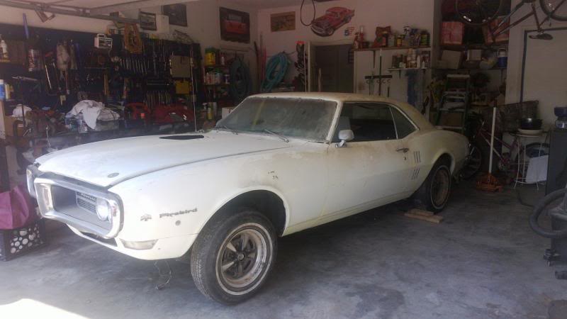

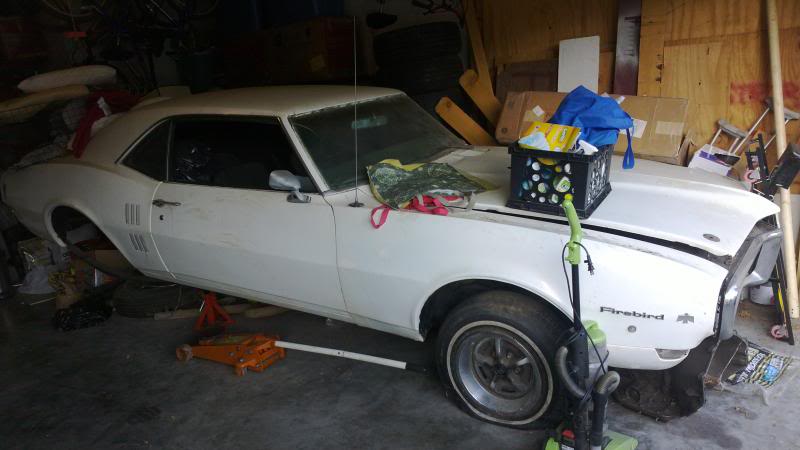

      So I got to my parents house and this is how my poor car looks
      (I built my mom some really nice shelves so she would stop putting stuff on my car, but alas, it was still a 1968 Pontiac Firebird Shelf and storage unit, haha)
      My plan to get it ready for the transporter to pick up the cars was to get the rear axle back under the car, leave the rear drums bare, and fix the front brakes just enough to get them ready to get on and off the trailer
      I bought the heavy duty 1/2" u-bolts which gave me some problems I had to drill out the shock plates, and because the ubolts were thicker they didnt shift enough so I had to elongate the bolt holes on the shock plates, but finally I had them on and torqued them down. The tires I had surprisingly were still ok and held air, so I saved some money there.
      when I jacked it up to put it back on teh ground, my leafs were almost so soft that the axle was only an inch or 2 away from the bump stops, haha
      But FINALLY after about 10 years of being on jack stands and having no rear axle, it was back on all 4 wheels!!!!!

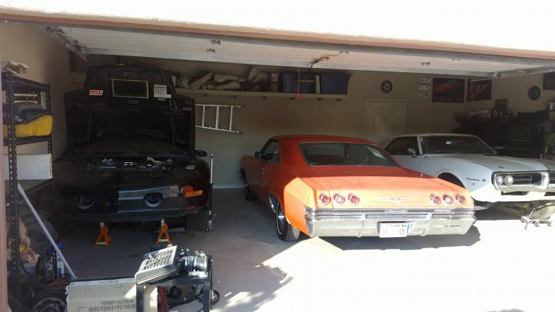

      well guys Monday morning, after a stressful weekend filled with delivery delays my cars showed up

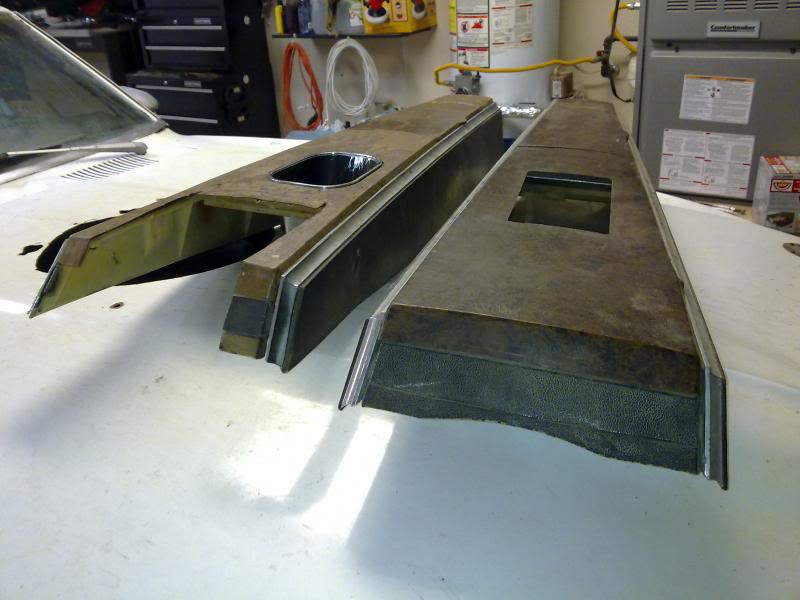

      When I first bought the car, it had a 68/69 Camaro center console in it, and I never thought those consoles matched the 68 dash. So I traded it for a 68 Firebird console, but an auto one, and I thought I would be able to find the top manual trans plate, well no dice, nobody makes them, and up until this year nobody offered a repro manual (classic industries has them now, but they are like 700-800 bucks)
      SO I was looking on ebay and I would always get outbid on manual consoles in rough shape, UNTIL now
      I got 2 consoles, a beat up auto, and a cut manual, but my plan is to fix the manual one and use it.
      The guy told me that the manual trans car had an AC unit and the dash and console were cut to fit it in there... sad, who would hack up something hard to find like that. anyways
      Here are some pictures:

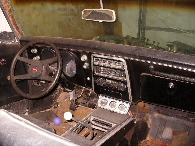

      one of my coworkers was suggesting that I install a gauge pack in the cut out area instead of going with the stock look
      for anybody who doesnt know what the original console looks like, it is this:
    11. #31
      Oct 2012
      164
      Country Flag: Australia
      I vote Gauge pack.
      The clean center console is nice sure.
      But without an aircon unit between the dash and the console there's a massive hole. Could tie the two together with a gauge cluster?

      There is a bit of a gap between the console and the dash, when I bought the car, it had a little gauge pod, and didnt look too bad
      if I do the gauge pack on the console, they will be directly forward of the square hole for the 1967 style shifter location

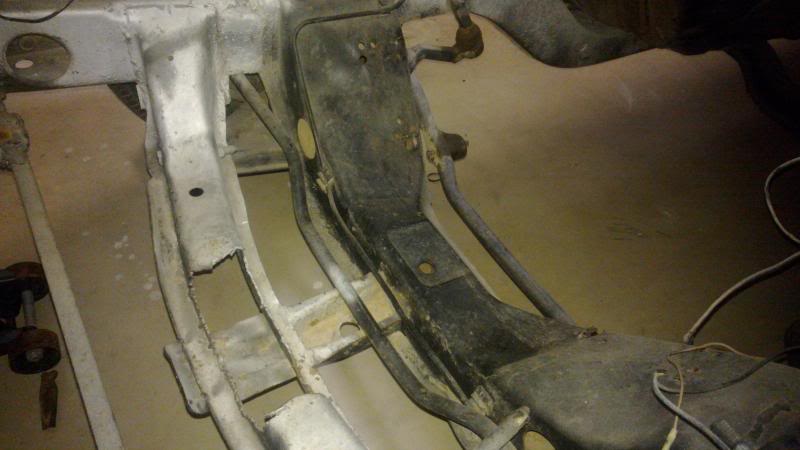

      So I was able to work on the car a little yesterday, but not by choice, I was in the garage getting some stuff and my wife was leaving for work and locked the door to the house, LOL, so I was locked out without my phone
      Anyways, the previous owner of the car put in a BBC 454 in the car, so it had some "custom" work done. The car is from upstate NY so it has corrosion issues which Im going to deal with.
      Here is some of the stuff that I found yesterday:
      First thing is the giant "custom" radiator that weighed a million pounds. I think it was out of a Truck
      after I pulled out the radiator I found all sorts of interesting cutting and welding
      So Im gonna have to replace the radiator support, thankfully the idiot previous owner didnt cut the frame to wedge in the radiator, he did hammer in the bottom corners to get it to clear the frame
      But he did cut up the cross member, shouldnt be too hard to patch up
      And finally he did a custom heater/AC delete, which was riveting in a hand cut piece of sheet metal, which was cut horribly and crooked
