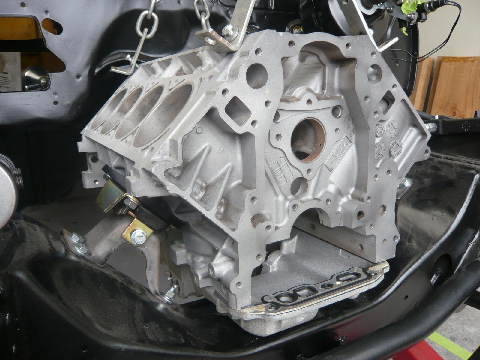

      You shouldn't believe everything you read on the internet. Fitted my mockup LS1 with TKO 600 and LS7 oil pan over the weekend. With a small modification to oil lines, the pan fitted in easily to my stock 1st Gen subframe. Clears all steering components, including the ridetech Tru-turn parts.

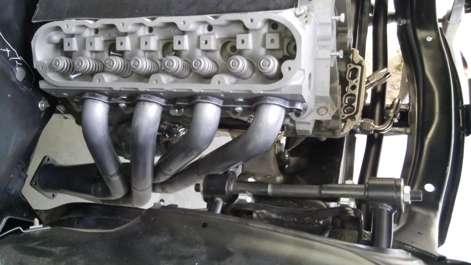

      Making pretty good progress now. Have finished sub-frame connectors, fuel and brake hard lines, Ls7 Oil pan needed to be modified for steering clearance and made my first set of headers. Pretty stoked how they came out. Will get them HPC coated when I pull it down to paint. Started aligning body now for paint prep, finish mounting RS grill and lights. Big job but i'm getting there!!!Name:  IMG_20150309_180835.jpg

      Did you make them sub frame connectors Damien??
      Mar 2013
      Napier, New Zealand
      220
      Country Flag: New Zealand
      Yeah mate..drew them up an had them laser cut..Folded them up. There is smaller ones on the inside to create the box..tried to make them look like they were fitted original..

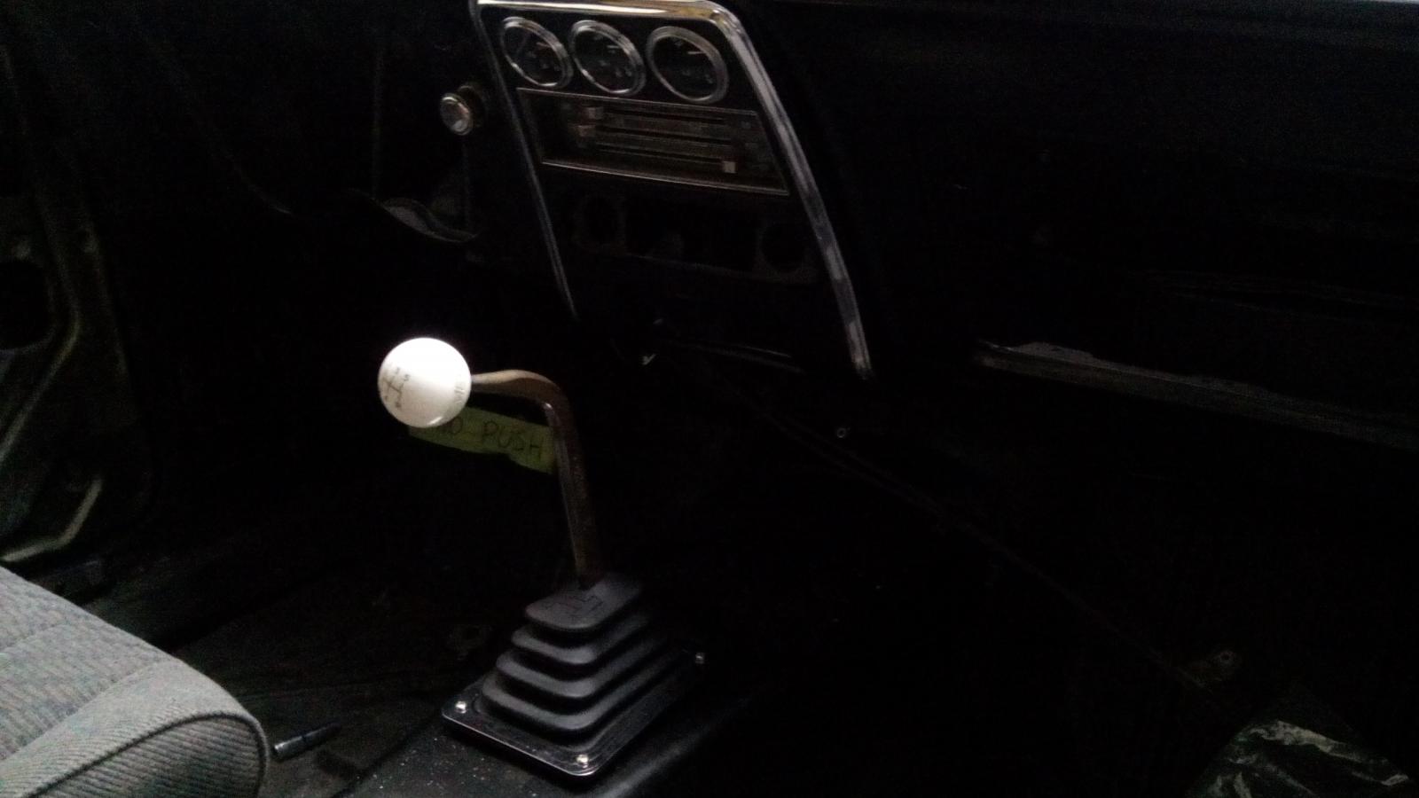

      Small update..fitted Stewart Warner accessory guages an vintage Hurst Indy shift stick..guages upsidedown.but easy to read..I reckon they look pretty factory..Name:  IMG_20150411_160040.jpg

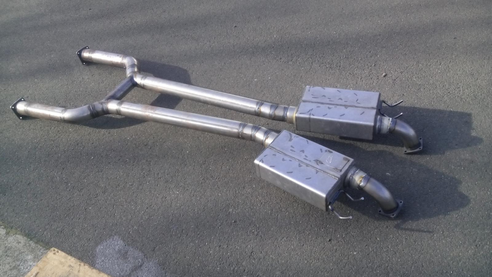

      Got exhaust all completed today. Huge job with only axle stands but really stoked with outcome. Nothing hanging down below chassis..Name:  IMG_20150529_201329.jpg
